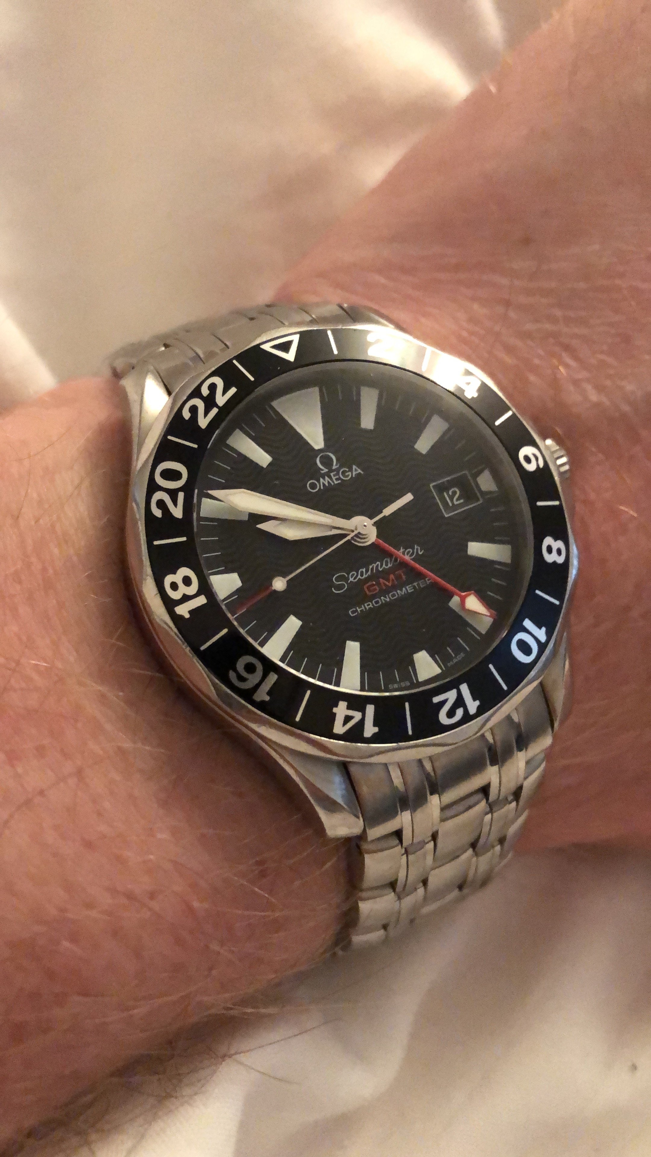

The insert should just push out. Although on some cheap watches I have found some inserts to be glued in. In that case I used a very thin (and sharp) craft knife to gently prise the insert up from the bezel. If you’re unsure about it, have a local watchsmith change it for you. Here’s mine with an all back GMT insert.

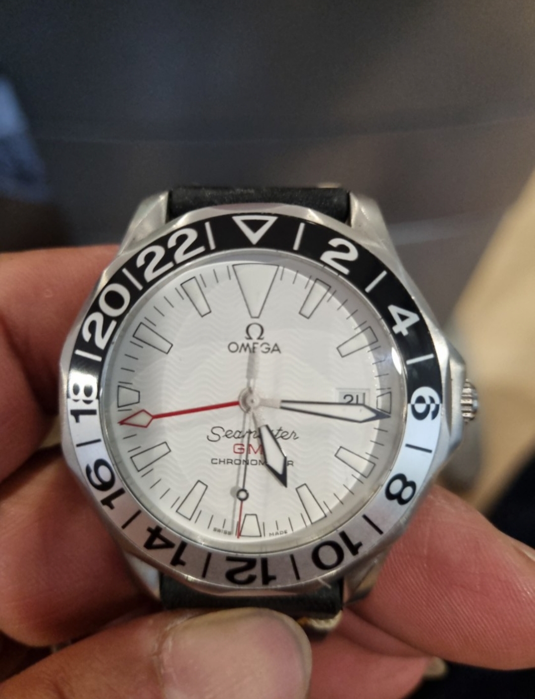

Not require glue removal, just push from rear with abit of pressure, see my diy great white with day nigjt bezel.

Did you have to glue that bezel in? I’ve just picked one up from eBay and I need to know if it’s a perfect fit or if I need to find some glue?

I was referring to @gpssti4’s post, in which he showed off the aftermarket bezel. I understand genuine ones are pressed in, but I’ve just bought an aftermarket bezel (like gpssti4’s) and had heard that they glue in.
However, so do and some don’t, it seems. I was trying to find out if his (the aftermarket bezel) glues in or presses in!
