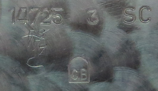

I have had two Seamasters de Ville (Is that the correct plural?) which have had "waterproof" cast into the case like this one (This one is not mine):
Does anyone have pointers to where I can get some information about the casemaker?

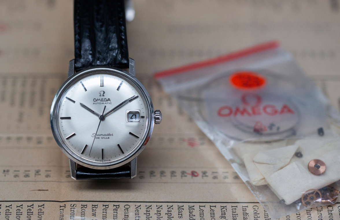

This is my watch (the parts bag is for a 1968 constellation):
Thanks for your help.

The case makers mark is on the inside of the case back. These SMDV’s are a one piece monocoque case which means the movement comes out through the front. If you want to find information about the case a watchmaker will need to take it apart for you.
Nice watch btw.

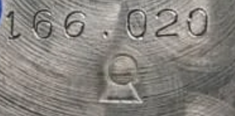

I did some search and got a lot of help. In that specific thread somebody posted a lot of possibilities. Looks a lot like the 166.020 I ended up ordering. No idea how to cross reference. Sorry.

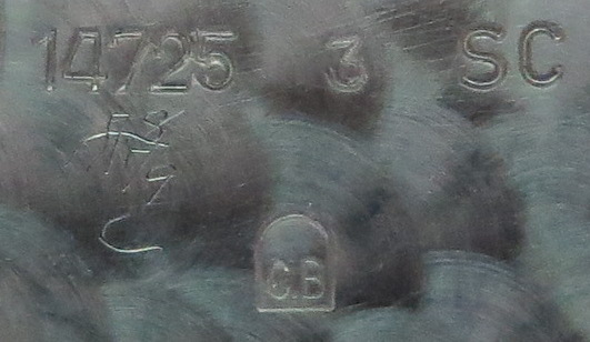

Ervin Piquerez S.A., Bassecourt, Switzerland - marked with a diving bell icon
La Centrale Boites, Biene, Switzerland - marked CB
