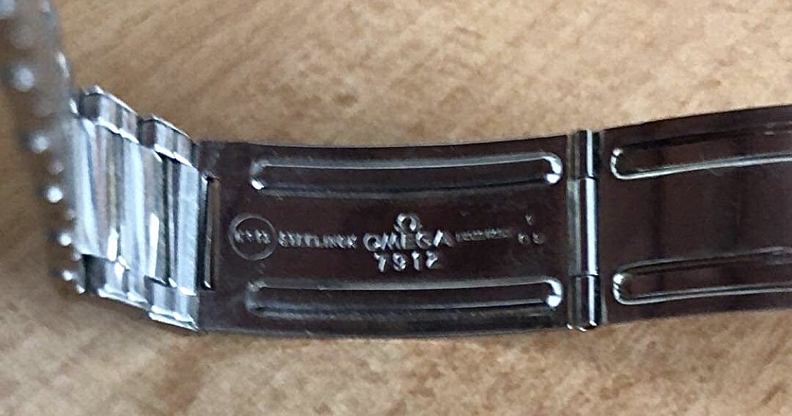

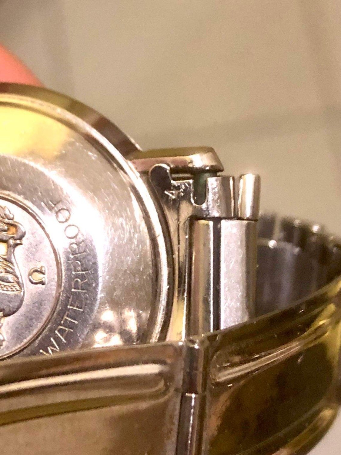

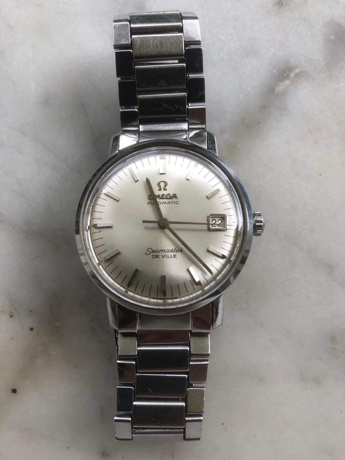

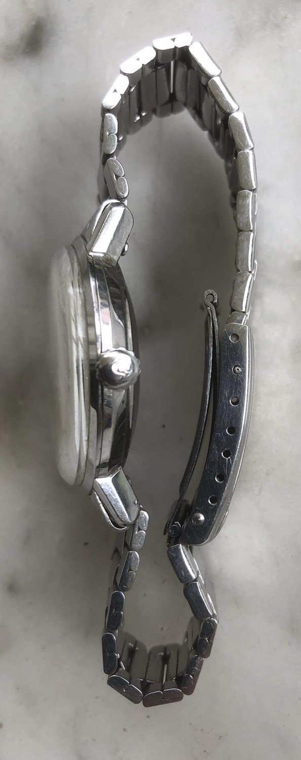

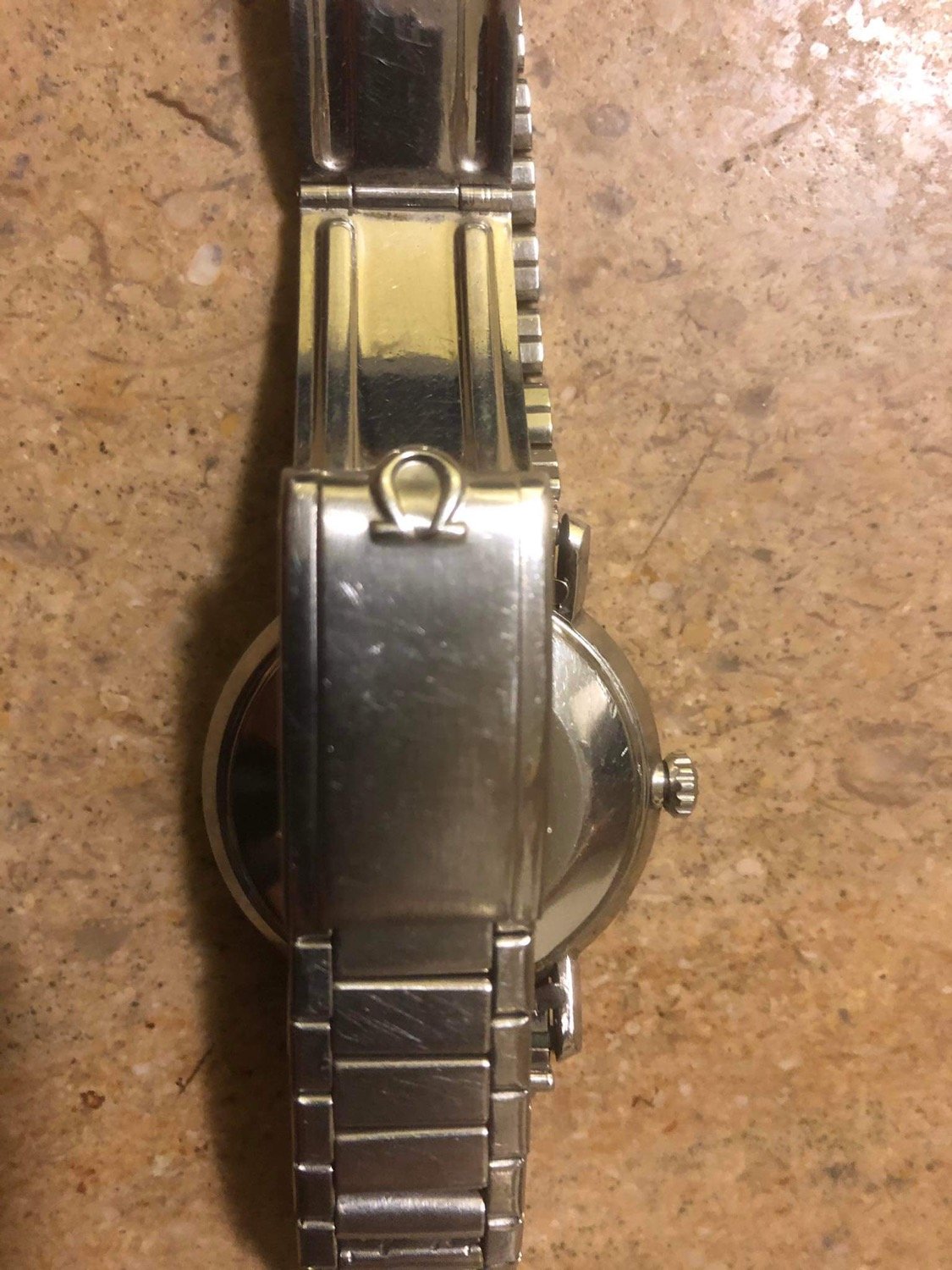

Hi guys,
I find this Omega seamaster de ville with strange long indexes and the famous bracelet 7912.
The watch seems ok but I don t have any pics about internal case and movement, so I don’t know which is the reference and the caliber.
The common seamaster de ville is 166.020 with automatic caliber 562.

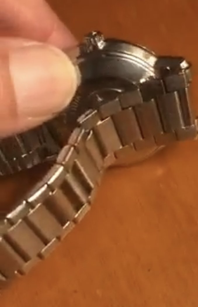

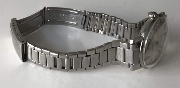

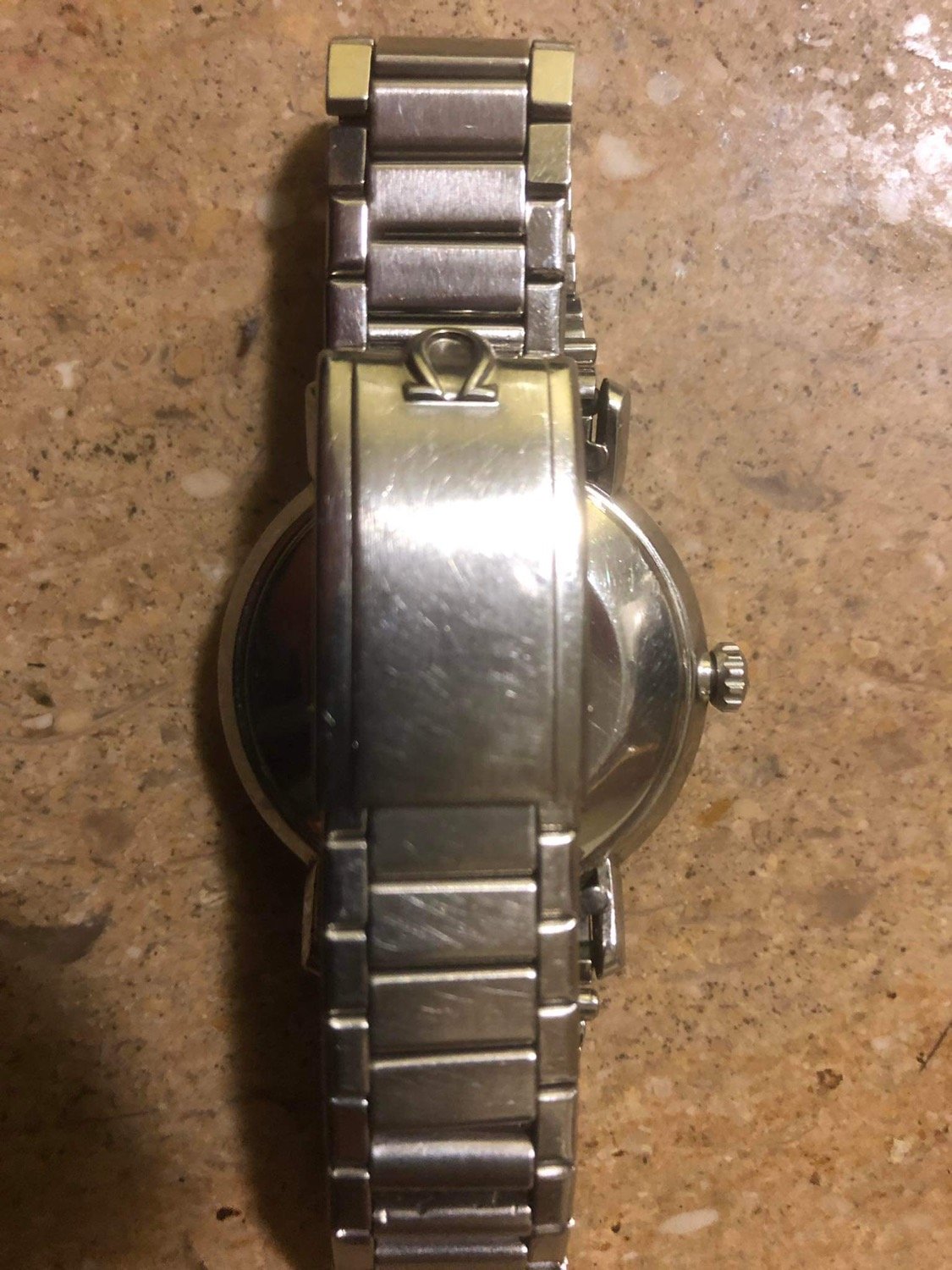

about the bracelet 7912 with 4 endilinks I don’t have many experiences, I see that 2 parts are not correct, but I see the same one is selling at 1000€ in better condition
I read that it could fit on vintage speedy but depend on clasp code (seems no.13 and 09)
what do u think?
I d like to keep the watch and sell the bracelet at the right price.
8,175
36,709
Well it's a 7912 bracelet with a couple of wrong parts to it. Those parts can sometimes be found on Ebay for not too much money.
There's been so much written here about these 7912 bracelets and the watches they are correct for I'm not going to write it all again, a quick search and you'll find all you need to know.
Value €1k-€1.5K
