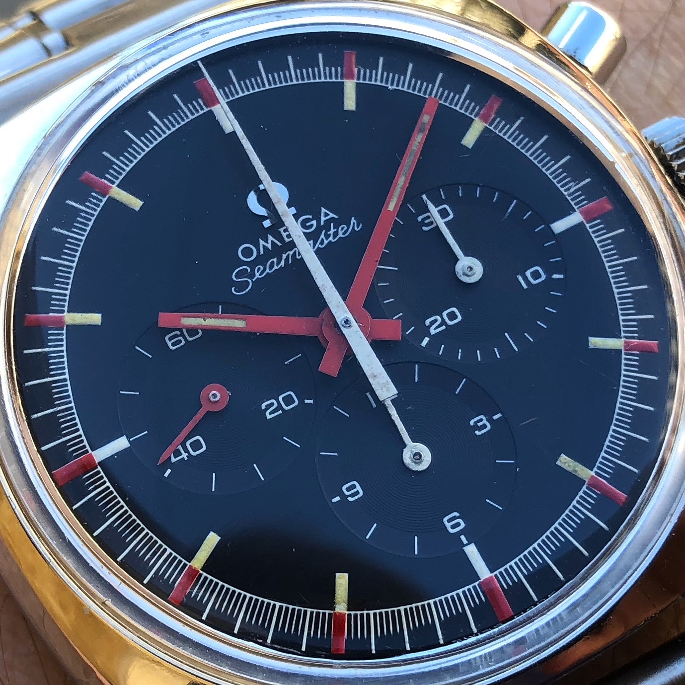

    Hi,
    not familiar with Seamaster Chronographs so far.
    Saw this one (drawer find, on sale right now) but couldn't find another example with this red half indices.
    Lume missing only at 3, 6, 9 and 12??
    No other information available from seller, no movement pics :(
    What do you think?
    Thanks for looking, take care
    [​IMG]
    [​IMG]

  2. Foo2rama Keeps his worms in a ball instead of a can. Jun 18, 2018
    17,105
    25,349
    Run

  4. Foo2rama Keeps his worms in a ball instead of a can. Jun 18, 2018
    17,105
    25,349
    Really? Case looks odd even if a 145.029 or a 145.006
    dial seems made up, should be a radial at least. Crown appears wrong.
    What am I missing?

  5. Sharp Jun 18, 2018
    255
    980
    +1
    Looks like it is slightly brown as well :eek:

  7. ConElPueblo Jun 18, 2018
    9,587
    26,978
    I am not a buyer for this - had it been a low BIN I might have taken a punt, but not in an open auction as I am not totally comfortable in the watches of this era. But I'll say that the browning of the dial, the subdial and dial print all looks good to me; too good for it to be a fabrication. The possibly missing T's and the weird quality of the red markers are worries of course - I would suggest that it could well be a (old) put-together with an original dial...
    If I was a more courageous soul, I'd throw out the "P-word" about the dial. And no, not "Pisstake" ;)
    EDIT: My guess is that this will probably end early and the dial will end up in a different watch in either a large auction house or with an online dealer.
  8. ulackfocus Jun 18, 2018
    25,983
    26,974
    It could simply have been relumed. Everything else looks correct to me, except maybe the crown and/or hands. A little poly watch or a new crystal and that will look pretty damn good IMO.

  9. Speedmasterfan88 Jun 18, 2018
    1,294
    4,358
    Calling @kov ! Interesting, unknown dial variant?

  14. kov Trüffelschwein. Jun 18, 2018
    4,113
    16,085
    Absolutely not imo. Juste a fakked up Exotic dial with wrong hands in a tired case...
    So now you have another one for reference ;) it is normal that there’s no lume at 3-6-9-12 as you can see. The movement can be either 321 or 861. Besides the one we discuss :
    There are 2x 321s known so far
    There is 1x 861 known so far
    I have seen it appearing on the bay about 10 days ago, even didn’t watch it, considering the condition... ::facepalm2::

  16. ulackfocus Jun 18, 2018
    25,983
    26,974
    If the seller were shipping to the US, I'd have replied to your post with a "SHUSH!!!!" and tried to bribe you to delete most of it. :p
    Those hands could be sold to some Speedmaster Junkie who "sources" parts like that, so you could charge a kazillion dollars. Then, you could take your time and "find" the correct hands. After what the Fan Boy paid, less the cost of the correct replacement hands, you might very well have covered most of the cost of the entire watch.
    Isn't the first time; won't be the last. Same for all of us.
    kov and Foo2rama like this.

  20. kov Trüffelschwein. Jun 18, 2018
    4,113
    16,085
    I should have made a photograph of David’s face (the watchmaker at The Omega Museum) when he checked my red hands and said... « Mmmmmmhhh.... Whhhaaat the heck ! Those appear to be original. UNOBTAINIUM !!! » His face was totally priceless.
