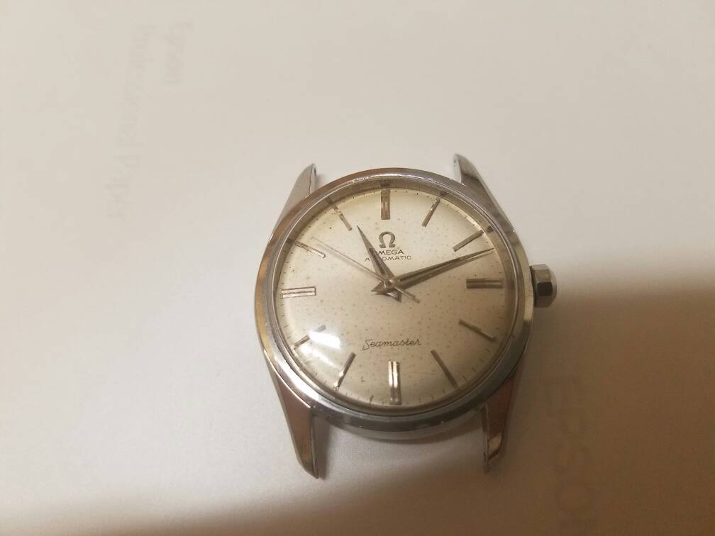

    Hi everyone,
    I would like to share my new find with you guys and would love to hear your opinion.
    Here is what I think about it:
    Reference 2869 SC 4
    Dial looks original to me, bubbled like all Seamasters do.
    Not sure about hands and what happened to the lume (why it's turned out black).
    Case is unpolished with some scratches from animals tried to open it with pry bar or something.
    Crown seems to be original.
    Crystal looks OK, but has no Omega logo.

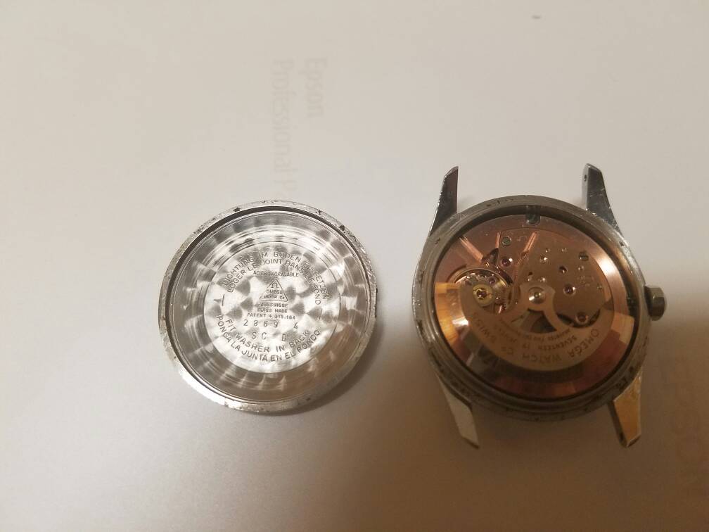

    Movement Omega call. 500 fits the deal, need to be serviced, because rotor is started touching the case back.

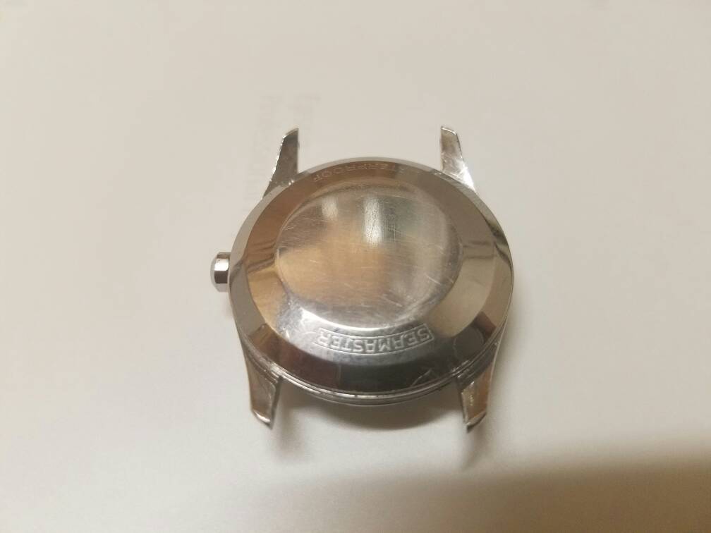

    This watch is probably from 1957.Looks like it has been serviced back in 1965 (according to the scratched date on the inside of the case back.)

    Is there any lume on the dial at all? If not, the hands might just have black inlay. Lume can easily turn black from moisture, however.
    Uniqez likes this.
  3. Uniqez Oct 27, 2016
    1,440
    3,710
    Most likely it is a black inlay, there is no lume on the dial.
    Sent from my SM-G930T using Tapatalk

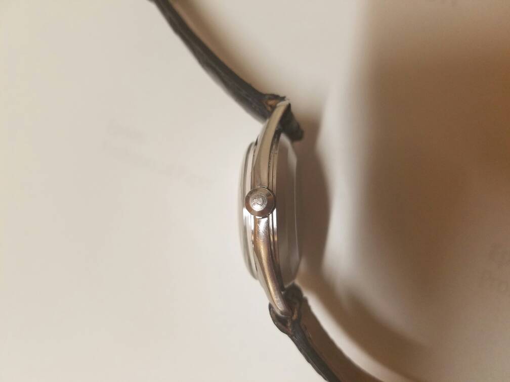

  4. Lessismore Pro Constellation picker-outter! Oct 27, 2016
    287
    164
    I don't think the crown its original to the watch, but the rest seems fine
    Uniqez likes this.
  5. Uniqez Oct 27, 2016
    1,440
    3,710
    I've actually seen some watches out there, with the different crown, but it was a little bit different reference number.
    Thanks for an input though.
  6. Lessismore Pro Constellation picker-outter! Oct 27, 2016
    287
    164
    I could be wrong, but it looks like it has a connie crown, I know some of these reference have come with this type of crown but I think those are flatter than the one on this watch (at least from what I can see in the pictures)
    Waltesefalcon likes this.
  7. ConElPueblo Oct 27, 2016
    9,587
    26,978
    Didn't even look at the crown - it's clearly for a fifties/very early sixties Constellation... I've actually just bought one for my 2852, otherwise I'd sent you an offer :D
  8. Uniqez Oct 27, 2016
    1,440
    3,710
    Since, I didn't decide what to do with it yet, looks like it would be a flipper))))
    I've seen so many seamastres out there with the same crown, so I didn't even payed attention to it.
    Thanks guys for replying to this thread.
  9. Waltesefalcon Oct 27, 2016
    3,108
    8,415
    Is it possible that the Connie crown was also used for some Seamasters, or was that a Connie only part?
  10. Uniqez Oct 28, 2016
    1,440
    3,710
    That was my question also).
    When you put ref 2852 in the Google search, you would find most of the Connies with crown like I have. However, I found few connies with the crown that belongs to my seamaster.
  11. ConElPueblo Oct 28, 2016
    9,587
    26,978
    Constellation only.
    Uniqez likes this.
  12. Peemacgee Purrrr-veyor of luxury cat box loungers Oct 28, 2016
    5,159
    7,890
    The Connie+Clover (Seamaster) crown debate will linger on
    But the consensus is that although appear in Connie adverts (generally hand drawn) they are replacements
    Possibly because the Connie crowns are bugger to use
    Uniqez likes this.
