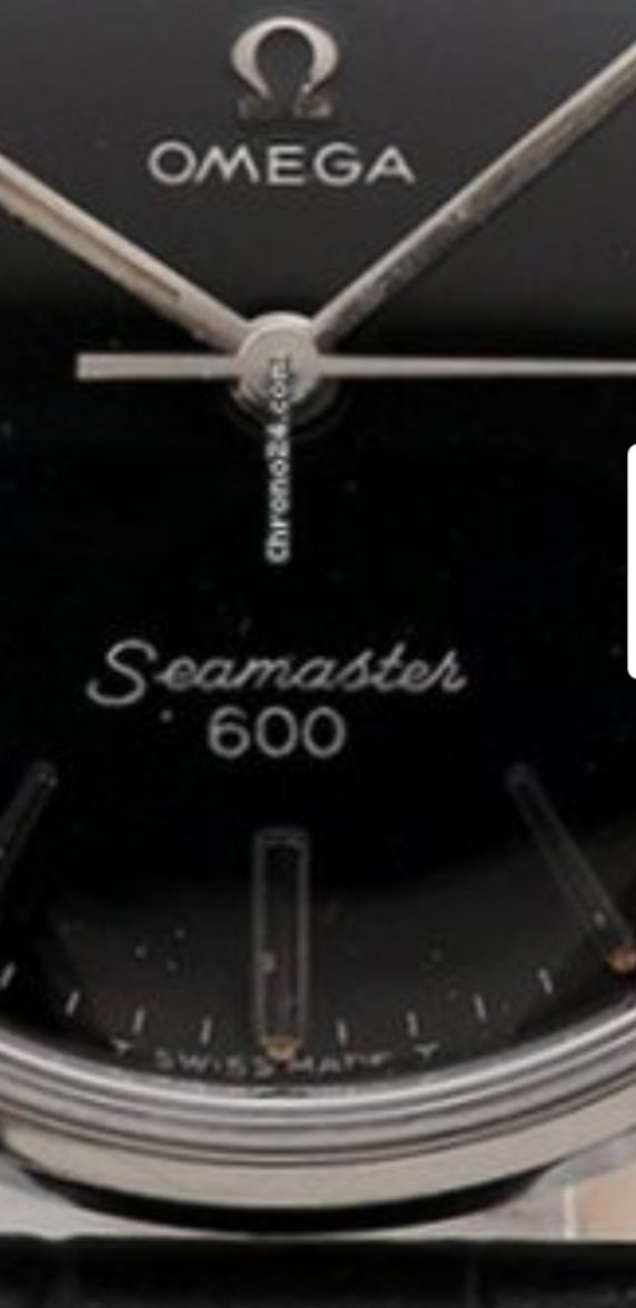

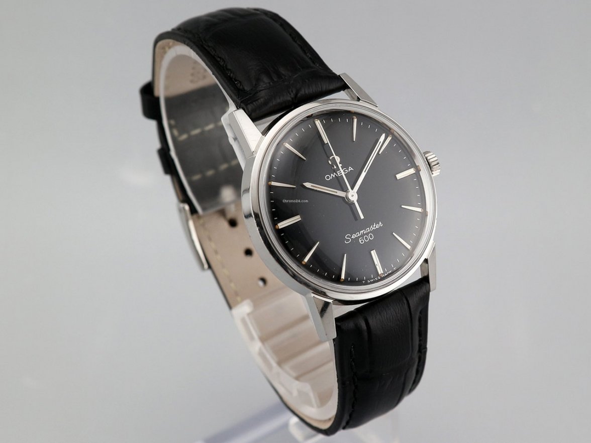

Hi all,
I'm looking to pull the trigger on this one but would like some reassurance from you due to my knowledge still lacking.
Do you believe the dial is original or repainted?
Been told it's approx 1967 and the crystal has been replaced with Sternkreuz crystal.
Price is currently at £800

I would say that's a well executed redial. It looks like the swiss made touches the marker. And the font and text looks a bit off as well.

I think it is all original dial and case looks good also.
Lume plots are all in place and all aged. I see nothing wrong with any markings. The swiss at 6 marker sometimes looks like it is touching but it doesnt. It is the angle.
Plexi non Omega is no problem imo.
800£ is on the high side. If you like it a lot....try get it for 600.

Although I’m always concerned about vintage black dial Omegas, especially when the finish is in such good shape, this one looks legit in my eyes.
214
426
It is true that many black dial Omegas are “doctored” but in this case nothing stands out as an obvious redial.
Hard to say without inspecting the watch. I tend to think it is a good one.....but lets see what others say.

I'd say it is good but I'm not 100% sure without handling the watch myself, or high-res pictures. If it is a redial it is a good one, the lume plots are very believable. There may be an inconsistency between the white tick marks and the 20 minutes index, or is it the picture angle?
An OEM crystal would be easy to source.

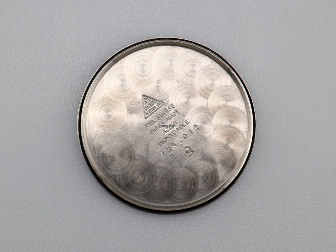

Notice, this ref. 135.012 is very small about 32-33 mm.

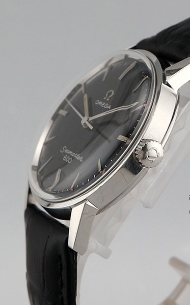

I think the price is a little bit to high, otherwise it is an fine 601 Omega caliber. The dial could
be original. I think so, but i am not 100% sure.
That was also my first impression but this is a very difficult one. The spacing looks wrong between O and M of Omega and S and e of Seamaster, likewise the 600 seems a bit cramped, the text of Seamaster looks just a bit off and the black finish looks very matt. We know that dials were supplied by various contractors and there were sometimes minor variations, but for me there is too much room for doubt.

Some inzooming
Wow, you have a great eagle eye, I see what you mean about the distance between O and M, although could be the photo as one of those in the link you provided also has similar small gap.

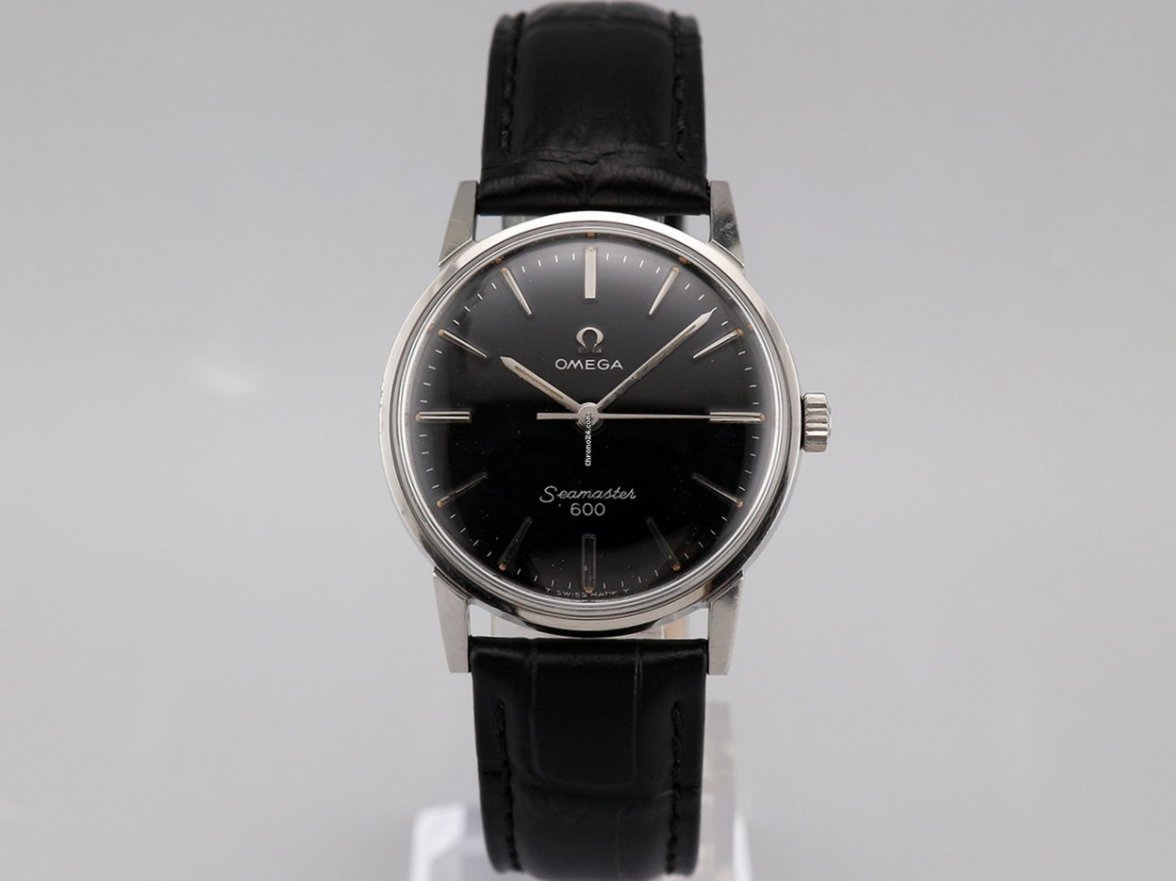

Sounds legit and honest, so I think just ask if the dial has been restored and maybe a higher res photo?.
As a few have mentioned, this one doesn't seem obvious enough and I'm having difficulty finding an exact comparison.
Added couple more photos.

I find it slightly odd that they haven't mentioned the dial, as an original one in this condition would be a strong selling point. There are some exceptionally good redials being done in Asia. I think that's what this is but you'll never know for sure until you see it first hand. Depends whether you feel lucky....

They mentioned as such:
>> rare, all original Omega Seamaster 600 from 1967. The black dial is in very fine condition, with a steel Omega logo and just a few marks hardly visible to the naked eye.
steel dauphine hands with the original lume, original crown <<
Hope a higher resolution photo will help to see more detail but would be great to find an advert or catalog to confirm about he text from source.

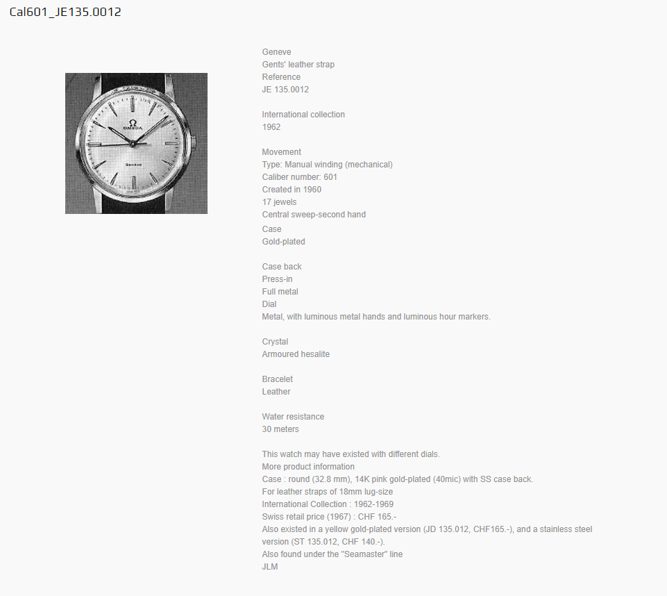

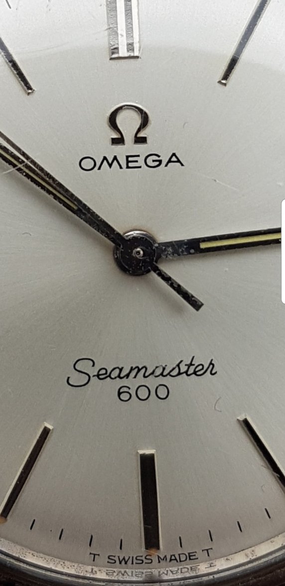

This is a 15$ flea market find (sadly not my find), I consider the dial original
13,492
31,811

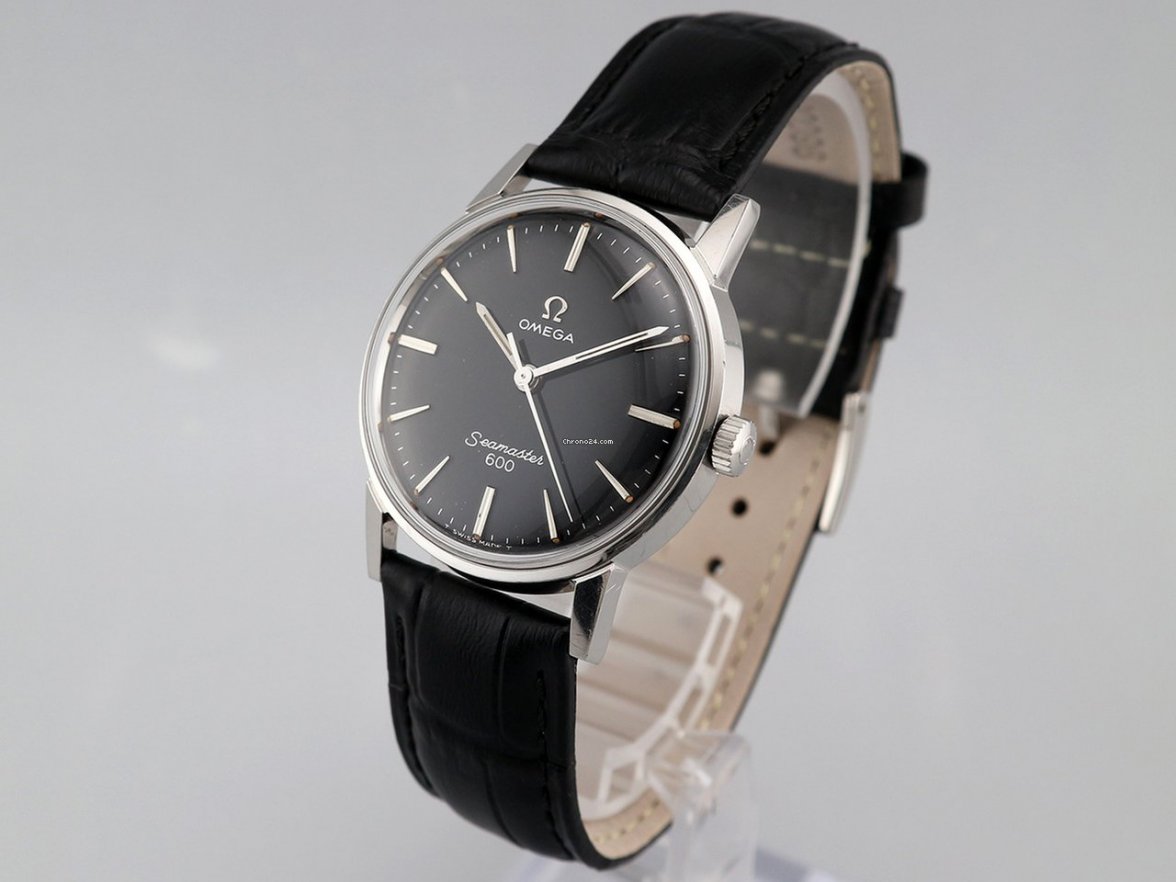

Looks like an original gilt dial to me, just the way the print picks up the light a certain way. Also the figures, which on these dials are integral to the dial itself and not applied are far to crisp to have been subject to a refinishing.

Looks like an original gilt dial to me, just the way the print picks up the light a certain way. Also the figures, which on these dials are integral to the dial itself and not applied are far to crisp have been subject to a refinishing.
Sorry to ask, are you referring to my OP or the photos kust posted by tdn-dk?
