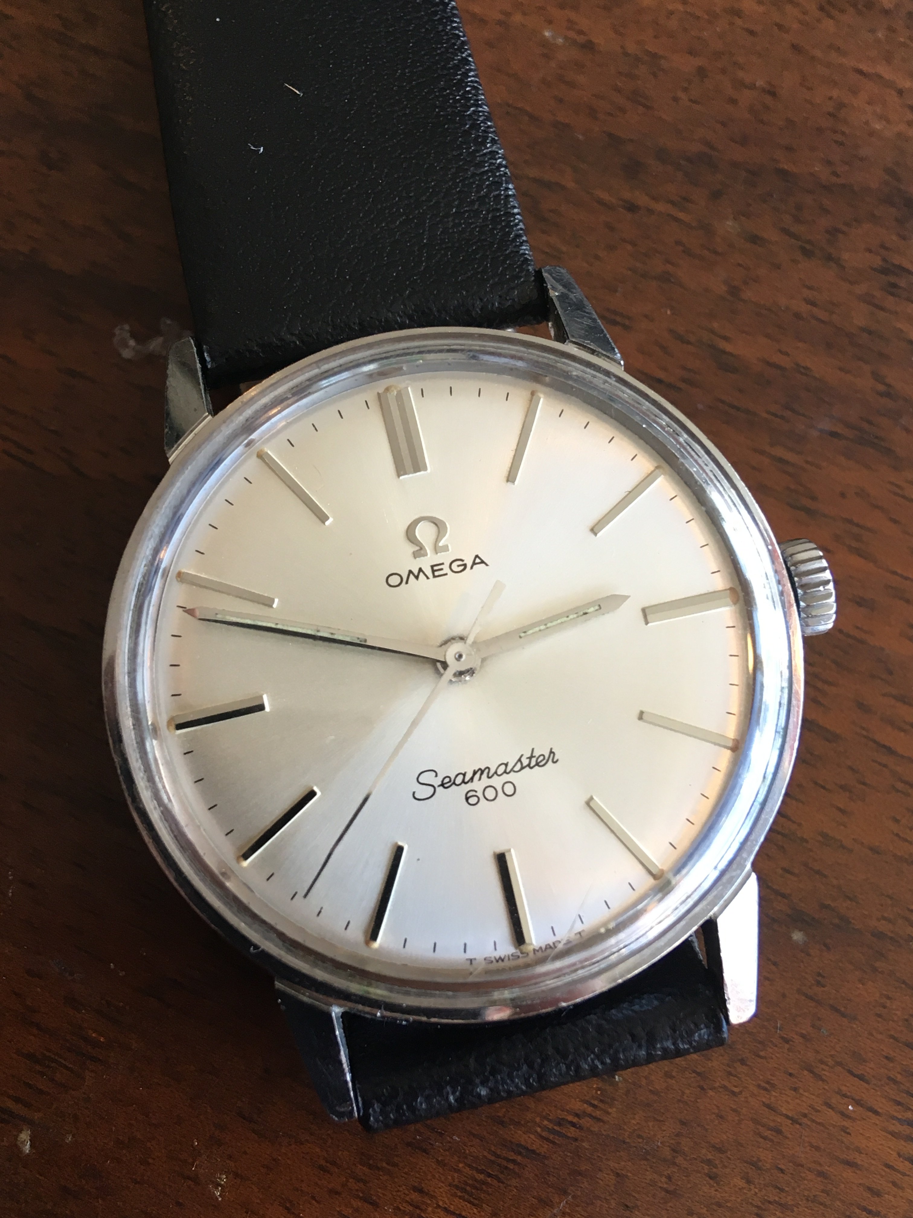

    I have owned dozens of these Seamaster 600 with the silver indices. Here is one of the current ones that I got:
    Shabbaz, Waxtactic and jimmyd13 like this.
  7. jimmyd13 Mar 18, 2019
    3,147
    7,133
    Then I concede. What's the year and story behind that one? I can't think of any example I've seen with that font.
  8. Hnansen Mar 18, 2019
    980
    2,089
    Honestly, I dont think there is anything special about the piece :) It looks just like the maaaaany other SM600´s that I have owned. It's from 1968, according to the several number.

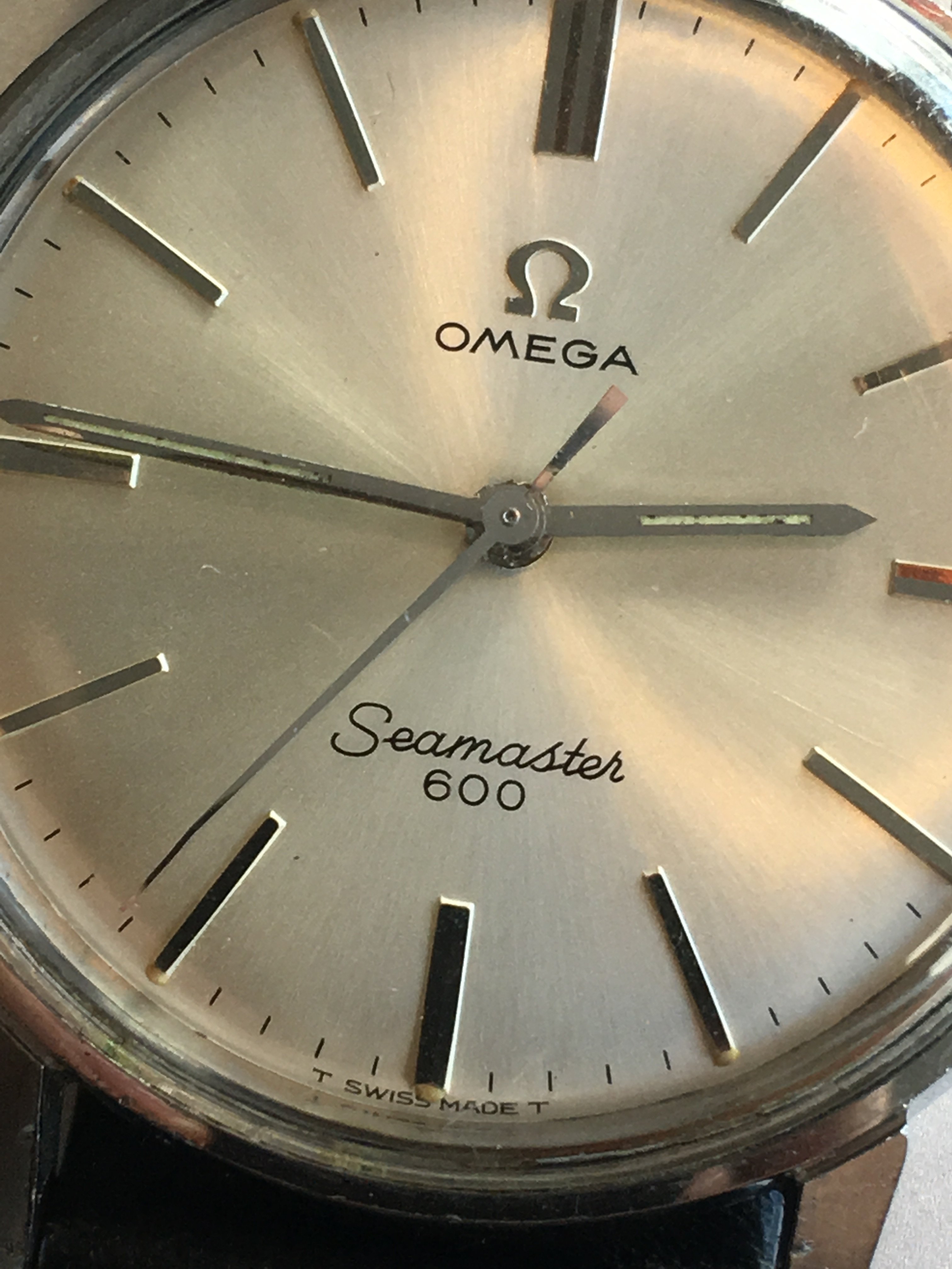

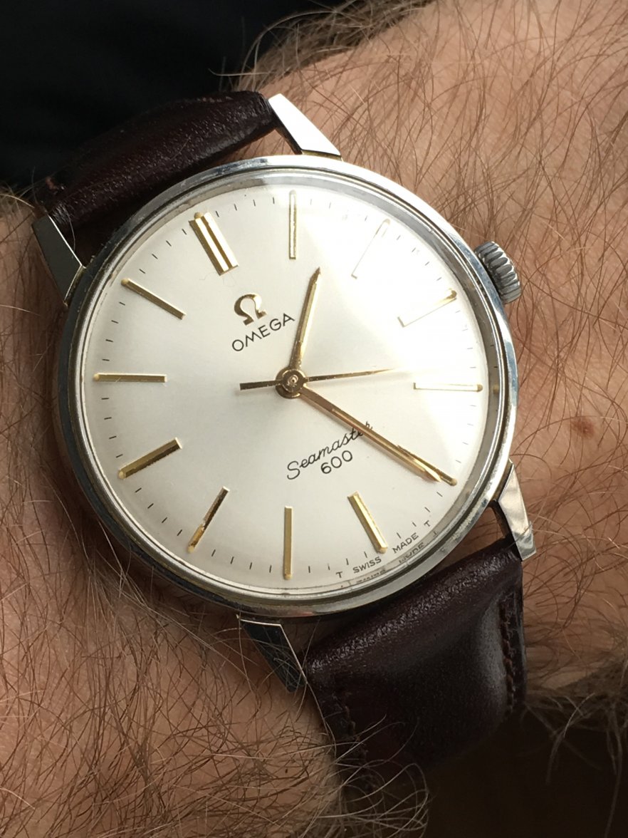

    Here are a couple more:
    Shabbaz and jimmyd13 like this.
  9. jimmyd13 Mar 18, 2019
    3,147
    7,133
    OK - the middle example of the three above is the one that I've seen, and the only one I've seen. In addition, on the other two examples, that second 0 does look out of line. Obviously there were at least two prints for that dial. It's just odd that I don't recall ever seeing the one that you say is more common to you. I wonder if there's any geographical reason behind it? Simply because I've only handled examples in GB.
    Hnansen likes this.
  10. Hnansen Mar 18, 2019
    980
    2,089
    I think the angle of the photos, distortion of the crystal and other factors could matter as well :)
    But I am absolutely certain that all of these I have showed had 100% original dials. There were many different dial layouts of the SM600 and since they were produced in such great numbers for 7-8 years, I wouldn't be surprised to see small differences in the prints.
