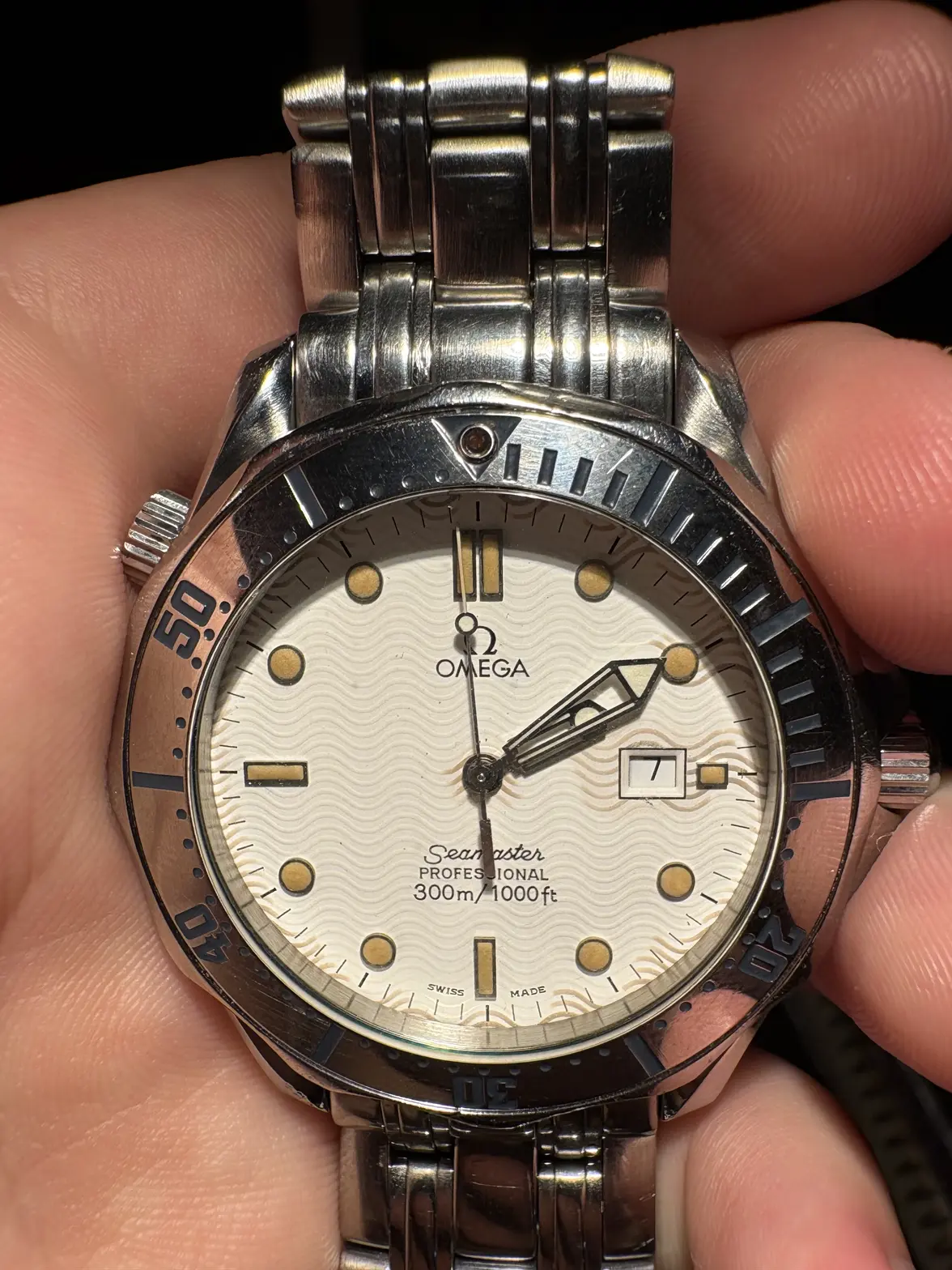

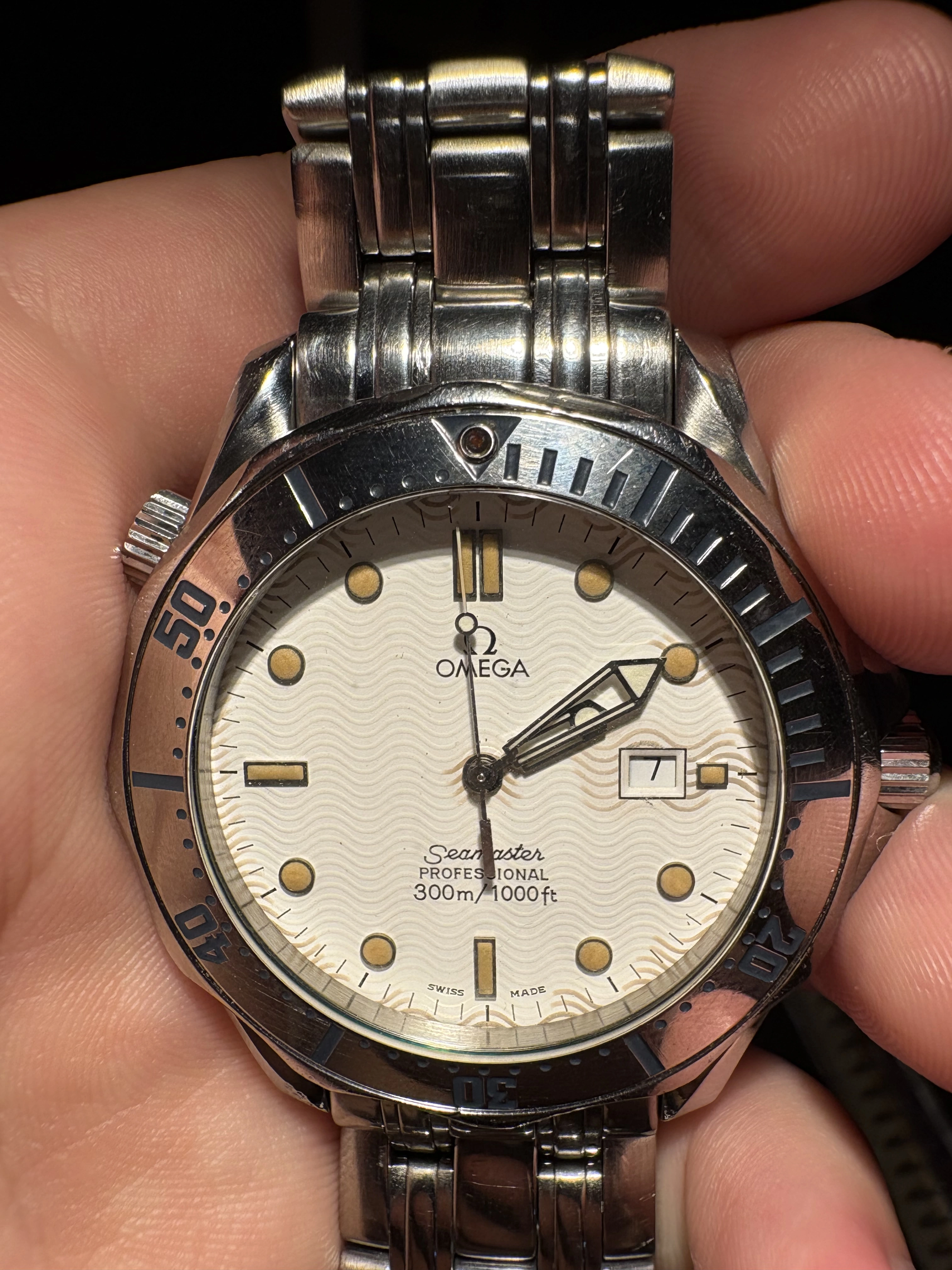

• White wave dial with gold/yellow indices
• Blue rotating bezel with RED dot at 12 o’clock
• Stainless steel case and bracelet

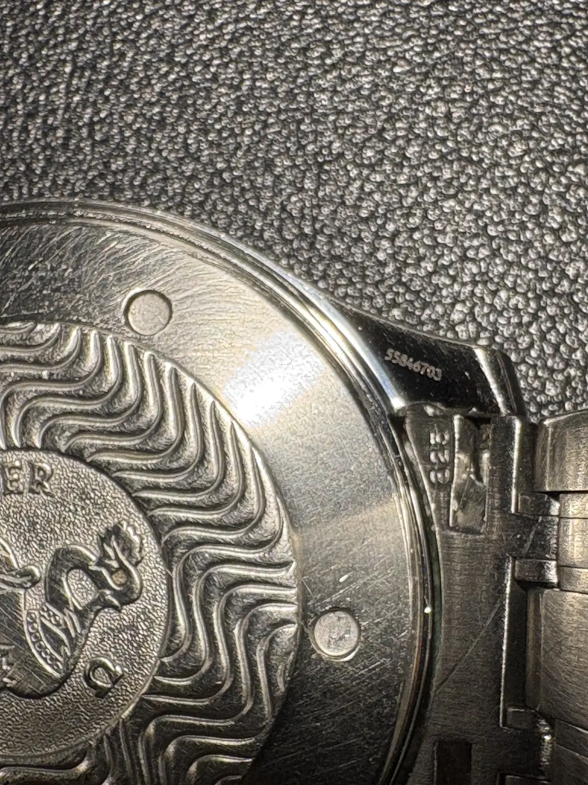

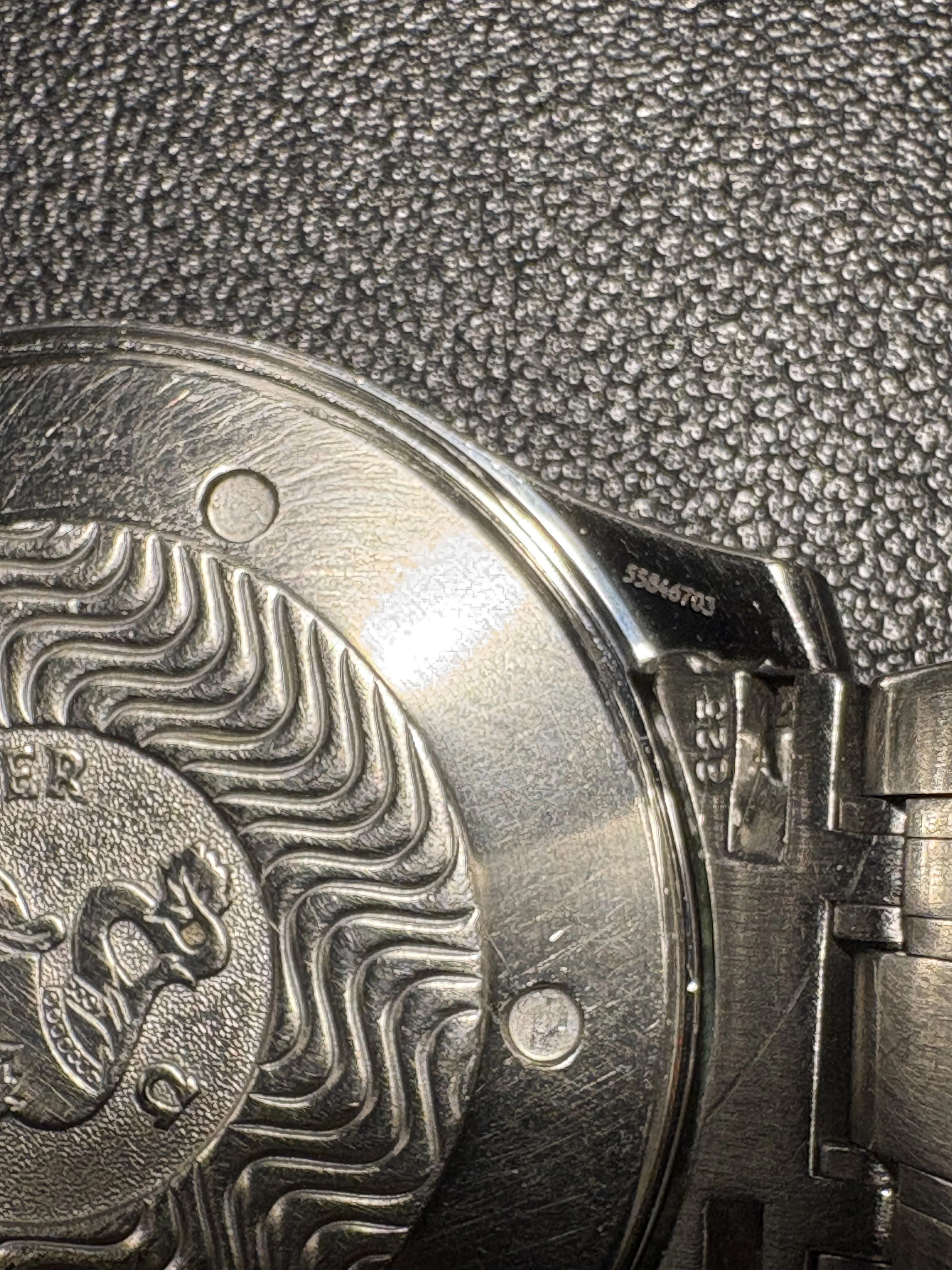

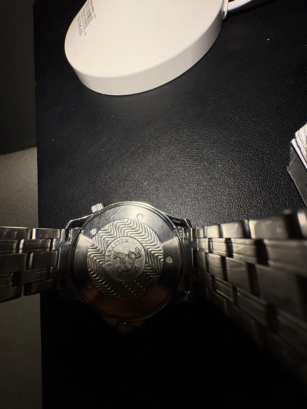

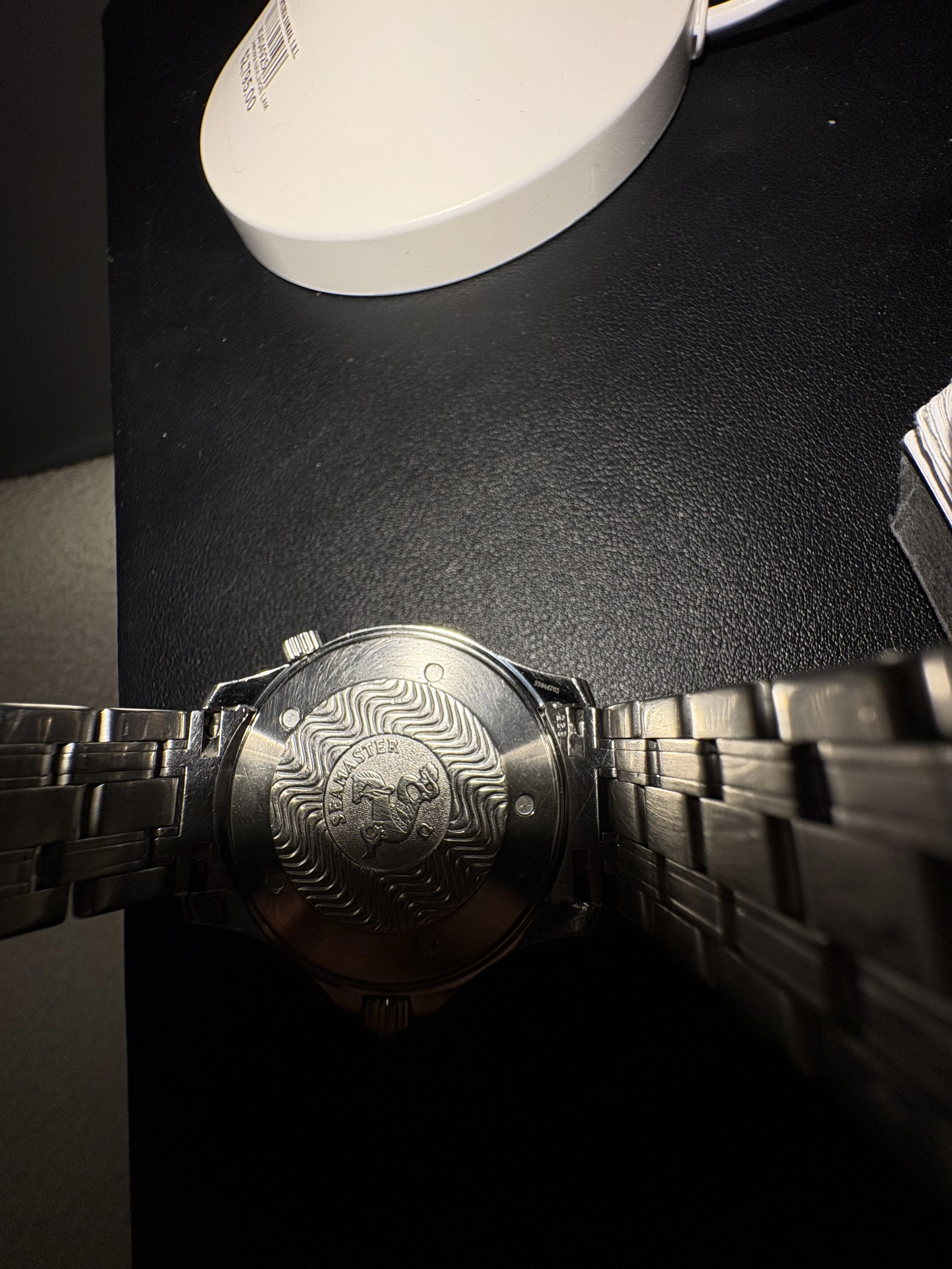

• Caseback shows seahorse engraving with wave pattern
• Caliber should be 1120

1. Is the red dot at 12 o’clock on the bezel a known variant of the 2532.20.00, or a different reference entirely?
2. Most 2532.20 examples I find online have silver/white indices - mine has gold. Is this a specific sub-reference?

I think it's a case of the luminous dot fell out, and what you're seeing left behind is likely the glue that was previously holding it in place. There wasn't a variable that looked like that from new, but lume dots falling out happens to a lot of different watches over time. Omega don't sell a bezel insert, only a full bezel complete which isn't cheap but there are aftermarket inserts available that are quite close to the original.
Thank you so much for the info! That makes total sense I never considered that the lume dot had fallen out and what I was seeing was just the remaining glue. Really helpful to know about the bezel options too. I’ll look into the aftermarket inserts. Appreciate the quick response!

To answer question 2: Your indices didn’t start that colour. The tritium lume has changed colour to beige over the years as it has lost its ability to glow. ie it has patinated. This varies from one watch to another which is why some look paler than others. Also later examples of the model used a different lume formulation called SuperLuminova which doesn’t fade and stays white indefinitely.
The darkness of your lume and the slight discolouration of the waves at the edges of the dial may indicate historical damp ingress, though the picture might be making it look worse. I wouldn’t wear that in water before getting it checked or serviced. The discolouration could also be the result of an old leaking battery let’s hope not.

It looks fine - nothing wrong there just some age.
