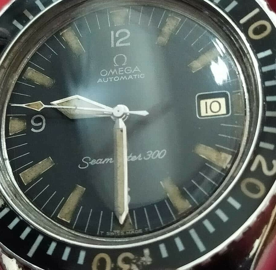

I'm trying to hone my skills at detecting fake dials. I'd appreciate others' thoughts here.
I was worried about this one for two reasons:
(1) Blotchy tritium over-spilling marked edges
(2) Possible lack of density of print
But, having done some research, I would guess this is a tired, but original dial.

I'm guessing that this has either foxed OF viewers or is genuine.
I think you need to give it a bit more time for members to chime in… it’s only been two hours and it is Good Friday.
I’m not an expert on these, so can’t comment, but a tired dial that’s had a hard life would be my guess. Ultimately, it’s not going to be attractive to everyone.
You could ask the seller to open the back and show you the movement 😀

The dial is original. Simply has mouldy lume.
If I understand your question about ‘density if print’ it’s actually the reverse. Genuine dial text is rather fine. Redials tend to have thicker text.
