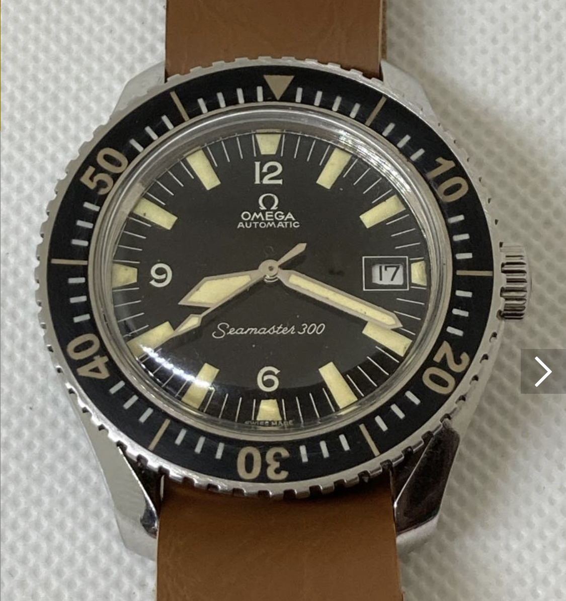

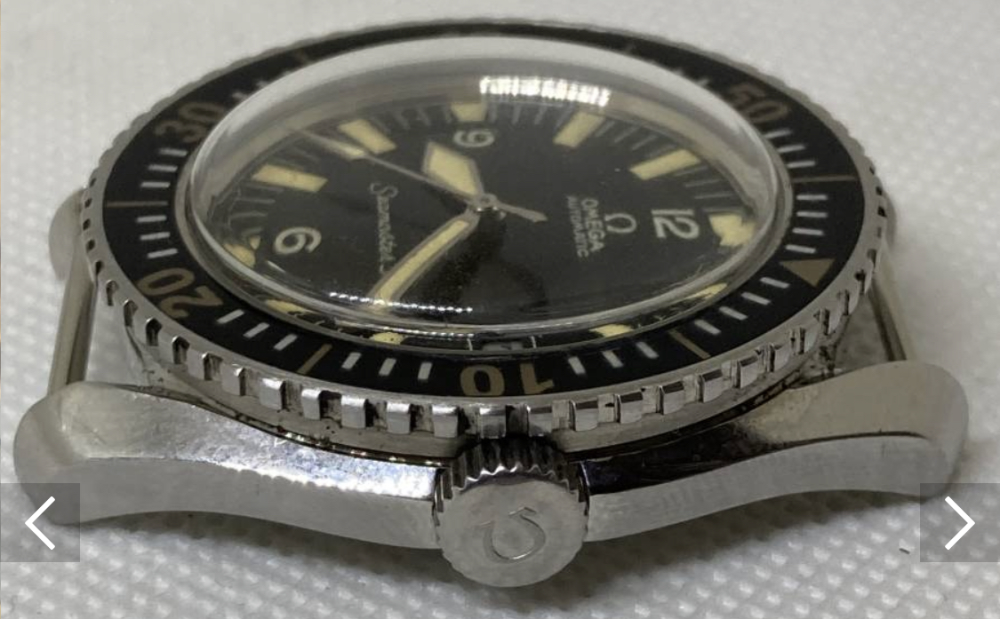

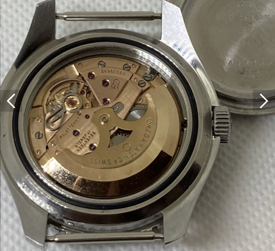

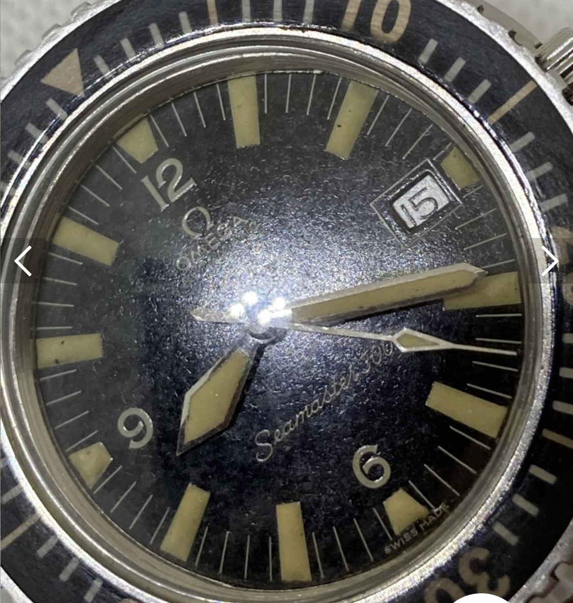

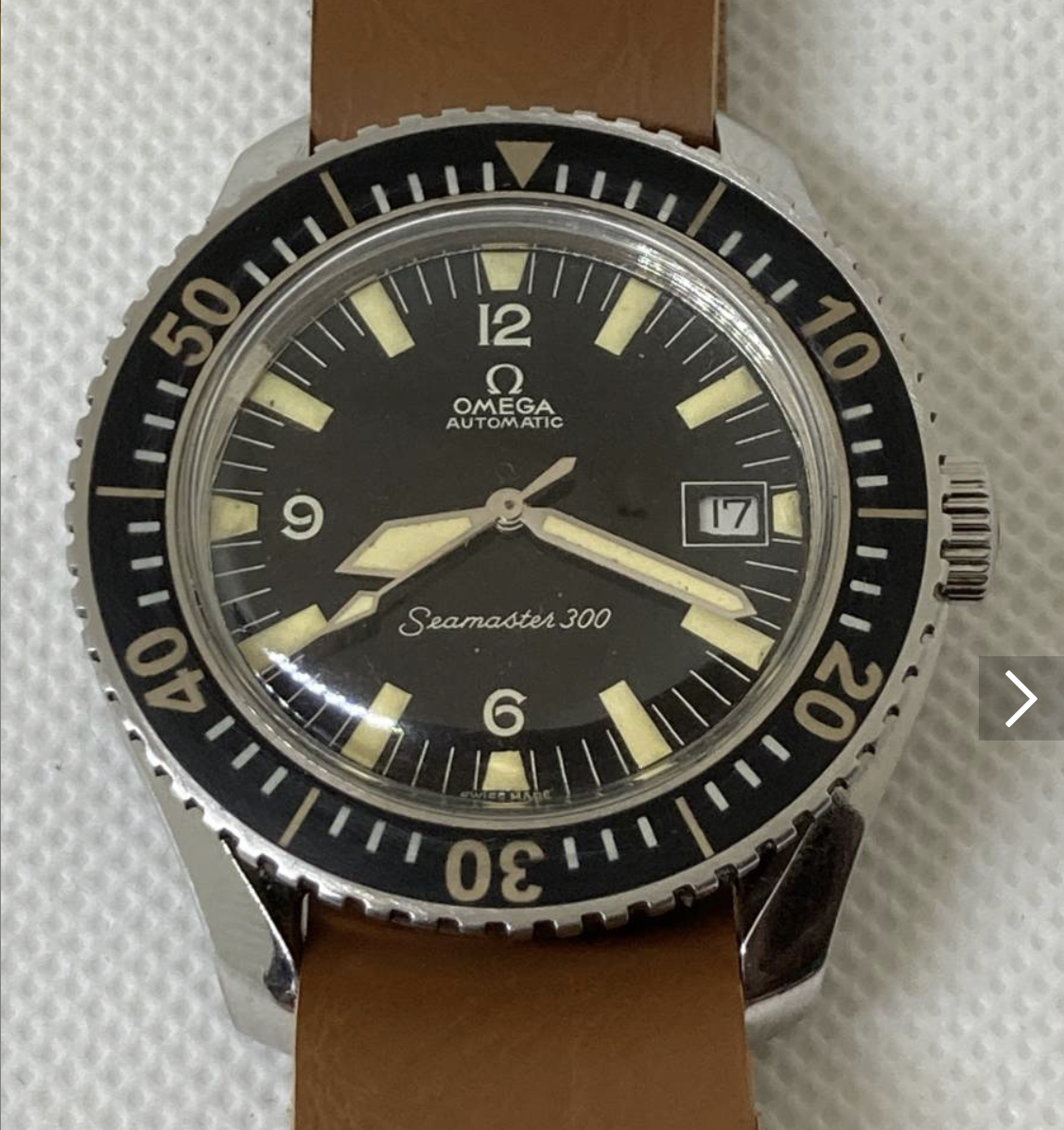

What do you guys think of this that I have a chance to buy? You thoughts are most appreciated.
2,346
1,475

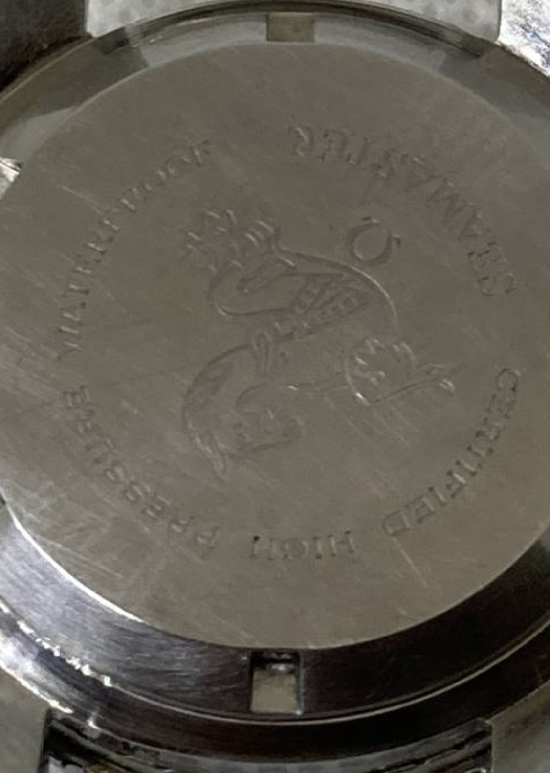

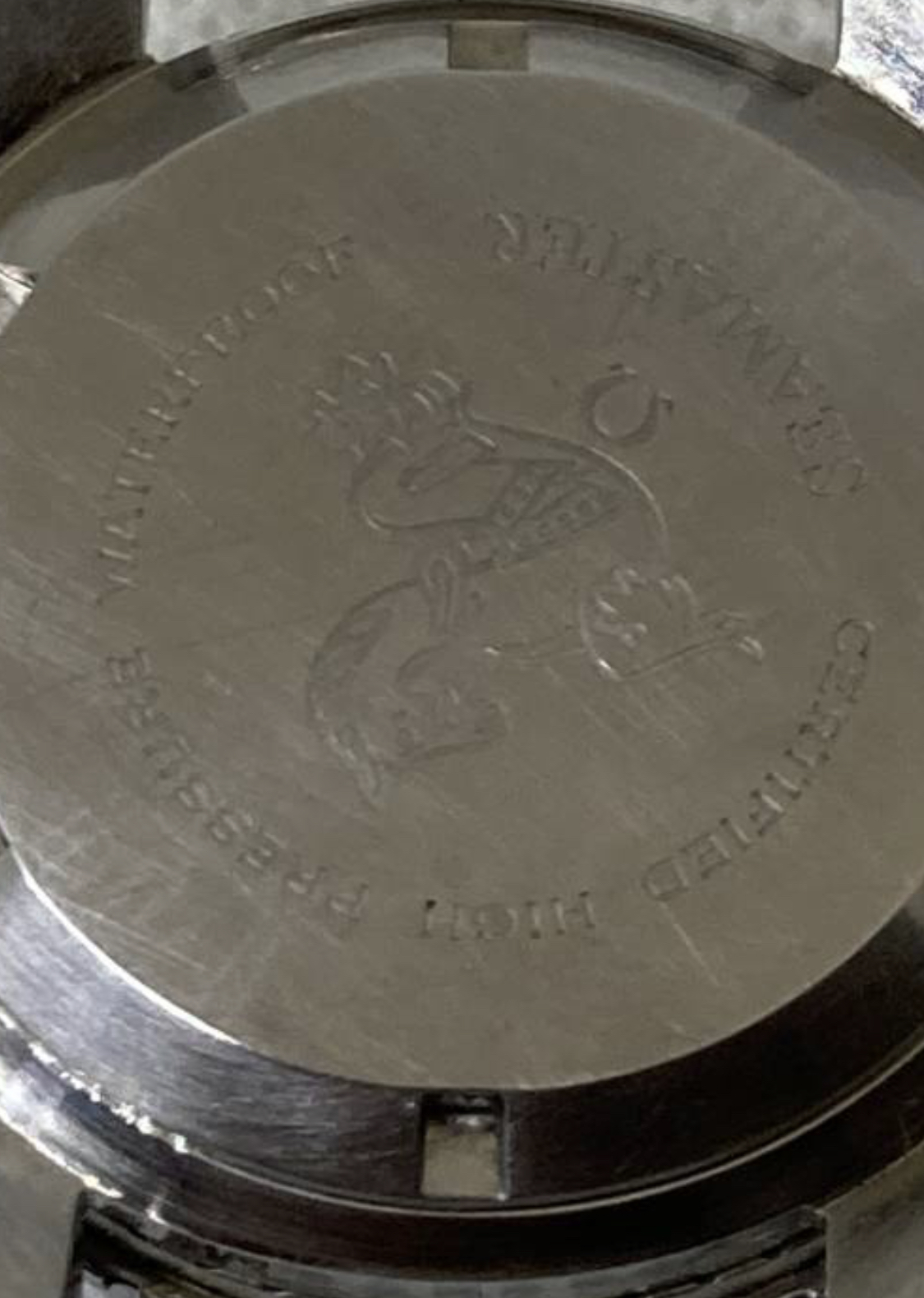

Not sure about the case. Fuzzy back image. A in wAterproof looks to pointy. Not flat enough, but hard to tell without better images
No proper reference number in caseback.
I haven't bought an original one in 17 years and last one I bought was a reissued case from my parts supplier in 2009

Just for ref, what else rings the alarm bells on this one. Apart from the date window, the dial looks okay. (perhaps the white minute markers don't line up with the ends of the 6, 9 & 12 lume plots). Bezel numbers a bit big??
