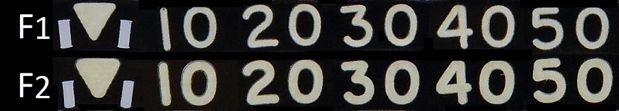

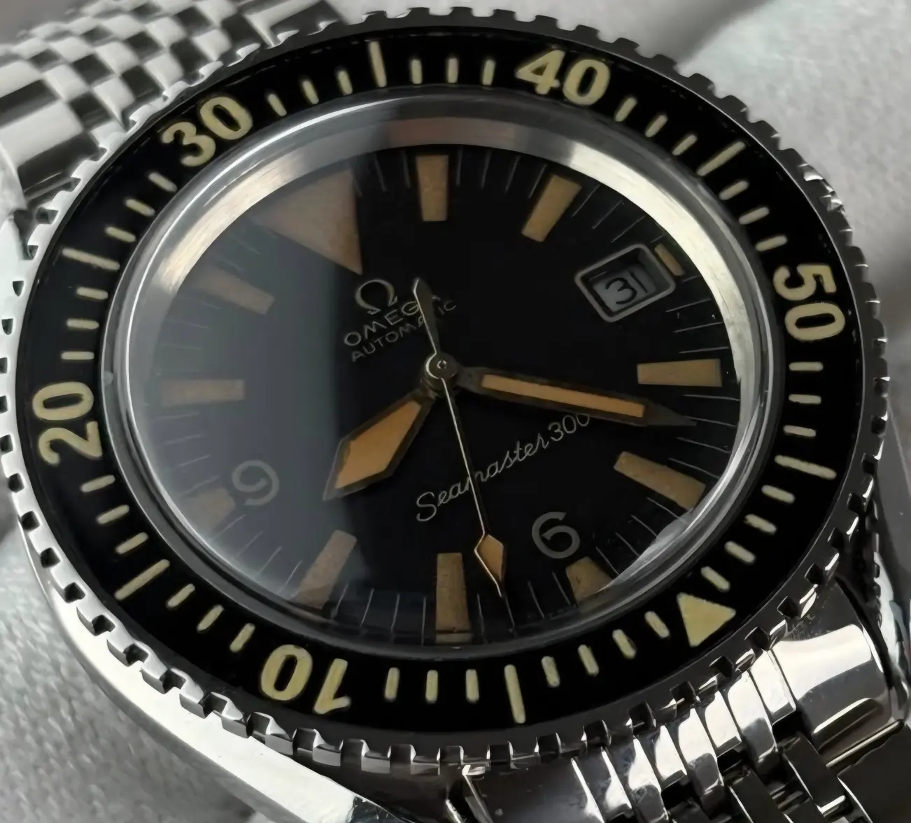

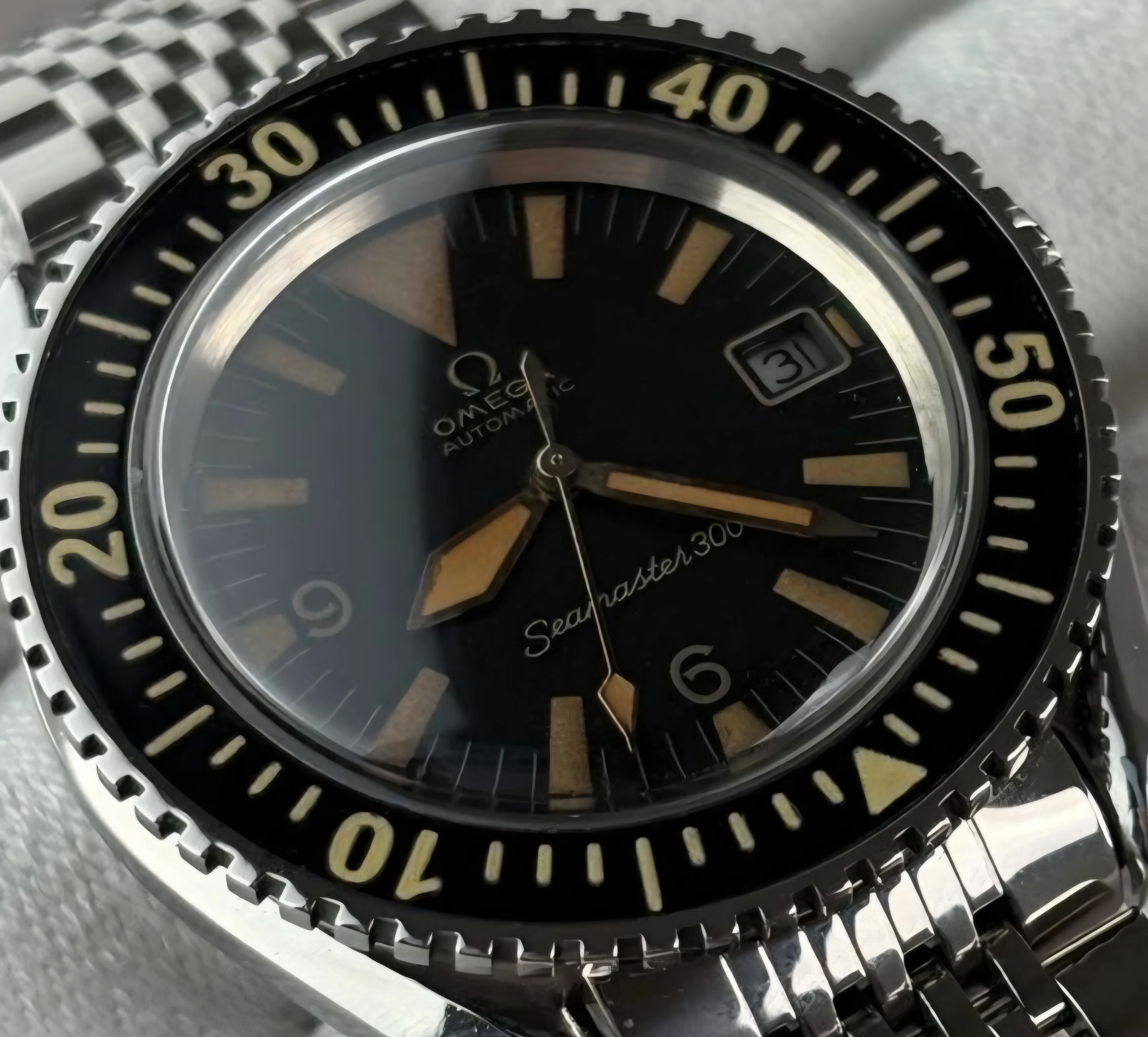

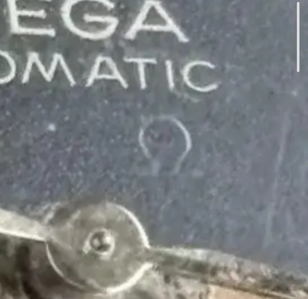

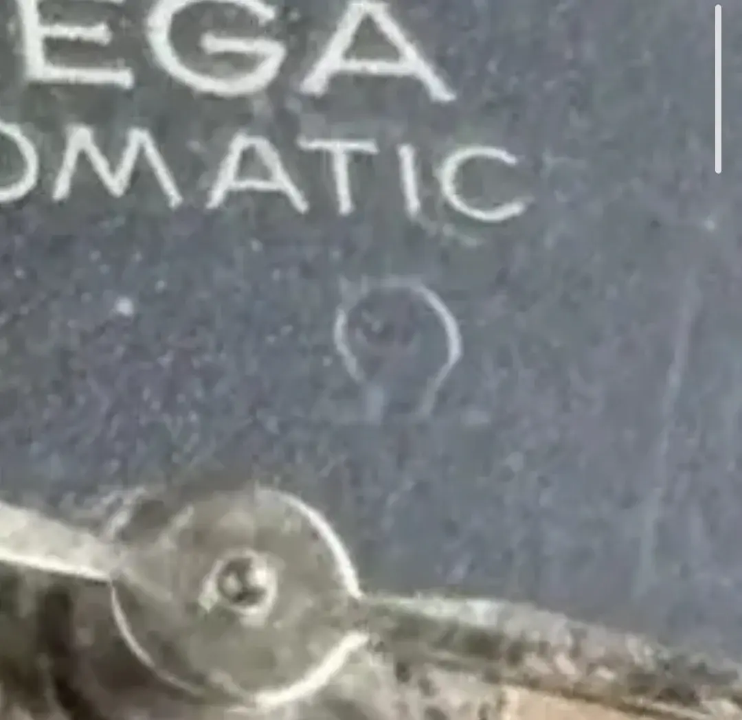

Does this look right to you guys? I've always wanted one but I know there are a huge number of fakes out there.
It's literally in my cart right now ready ro checkout 馃ぃ馃ぃ
Case with the twisted lugs seems right, caseback seems right with the HF answer SP2 stamp, serial number is spot on. I'm just not certain on the dial and bezel.
151
84

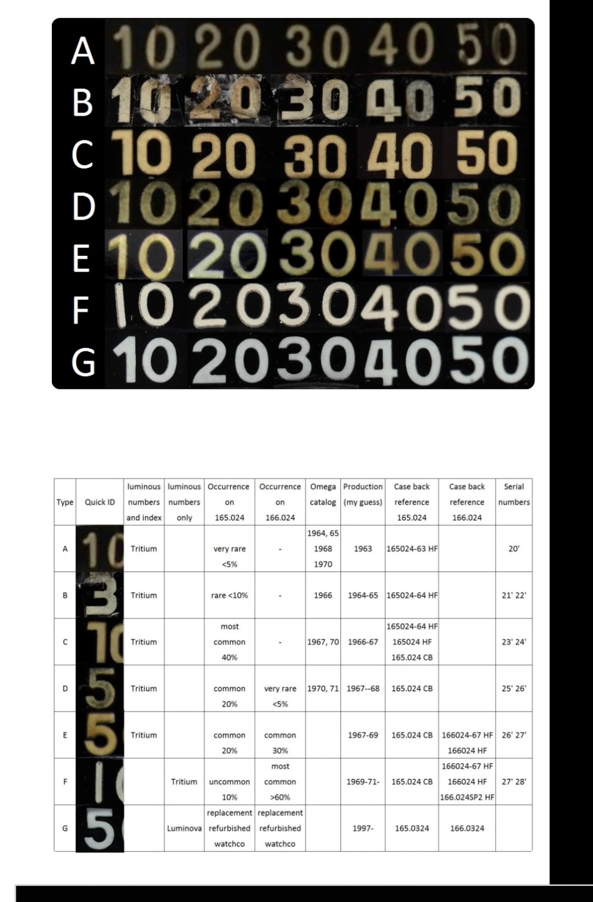

Hmm鈥hich bezel type would you say it is? 馃
I'd say B or C maybe? Does it look good or am I going to have to keep looking?
128
82
I am not an expert, but everything looks a off when compared to an original. The bezel, proportions of the dial markings, texture of the lume. The case looks poorly defined etc.

As already explained in detail at Reddit: fake.......

If you picked B or C, I鈥檇 just go ahead and buy Brand New and be done with it.

the movement and crystal are probably originals though 馃榿
771
827
If you鈥檙e seeing a big triangle for a really affordable price, then that鈥檚 your first red flag. Half the reason there are so many of these posts is because people get suckered into the low prices.
One with a nice, clean patina dial and a clean original bezel is easily worth around $7k to 10k these days. If it鈥檚 on ebay, it will be snapped up relatively quickly.
If you see a watch like the above around $5k or under, it is most often fake.
