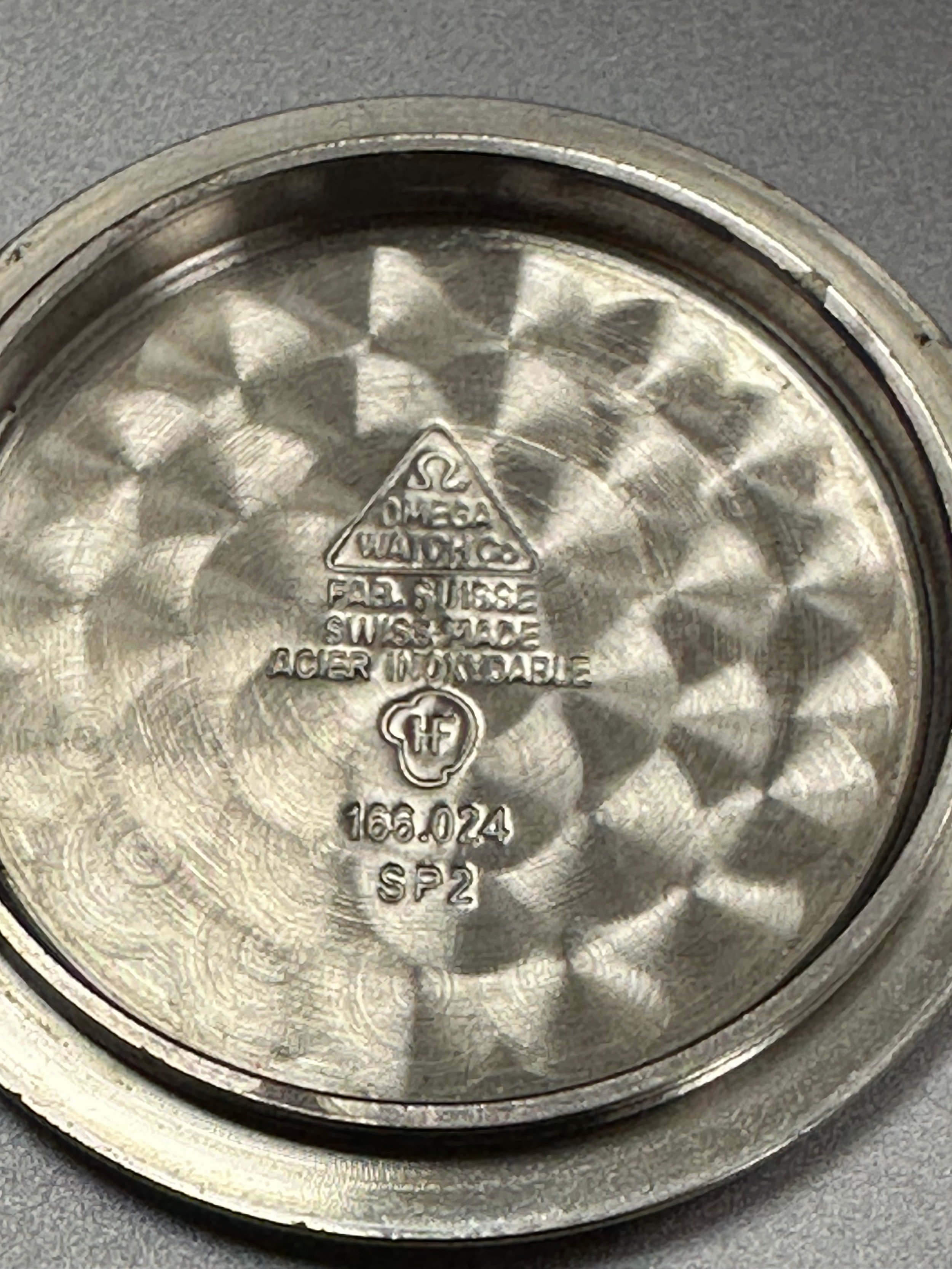

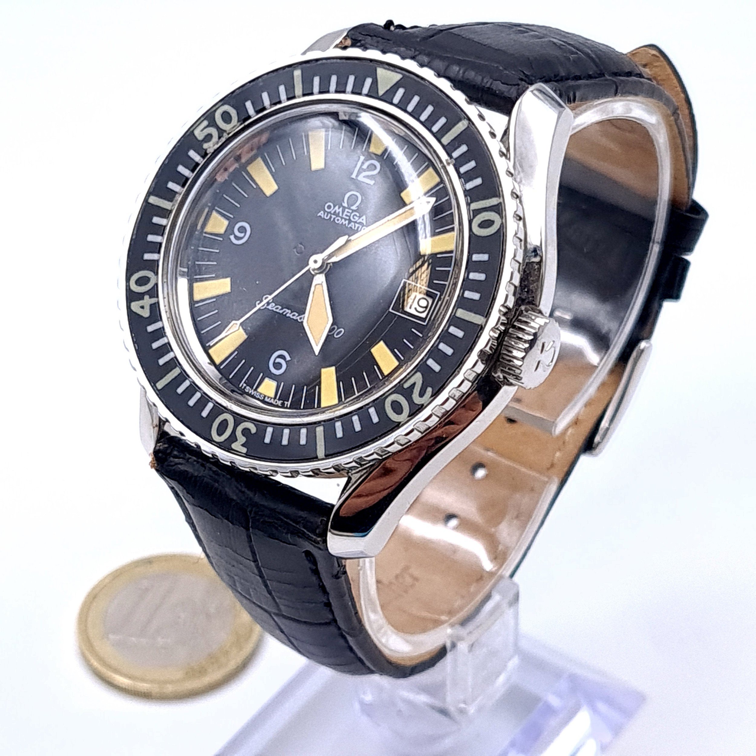

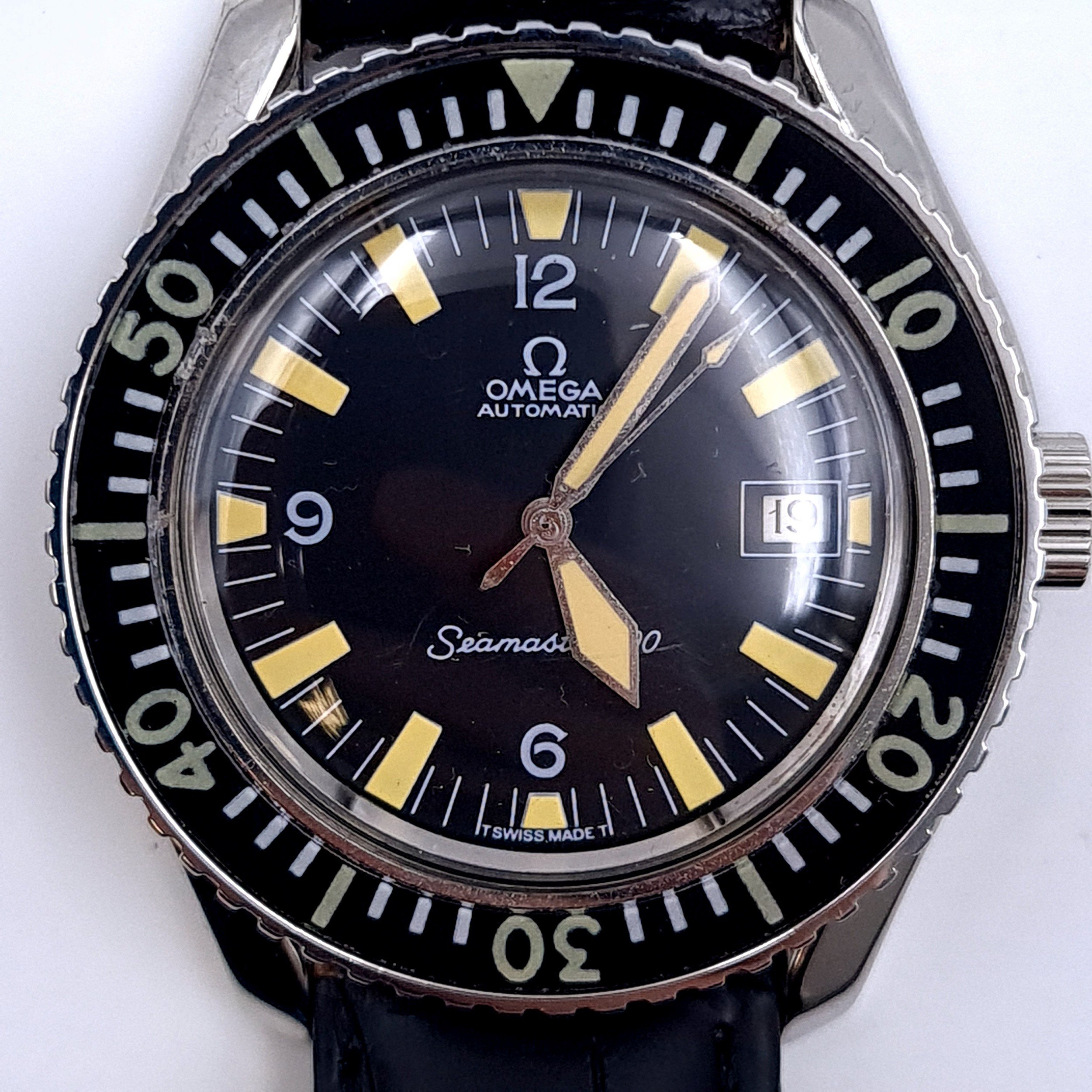

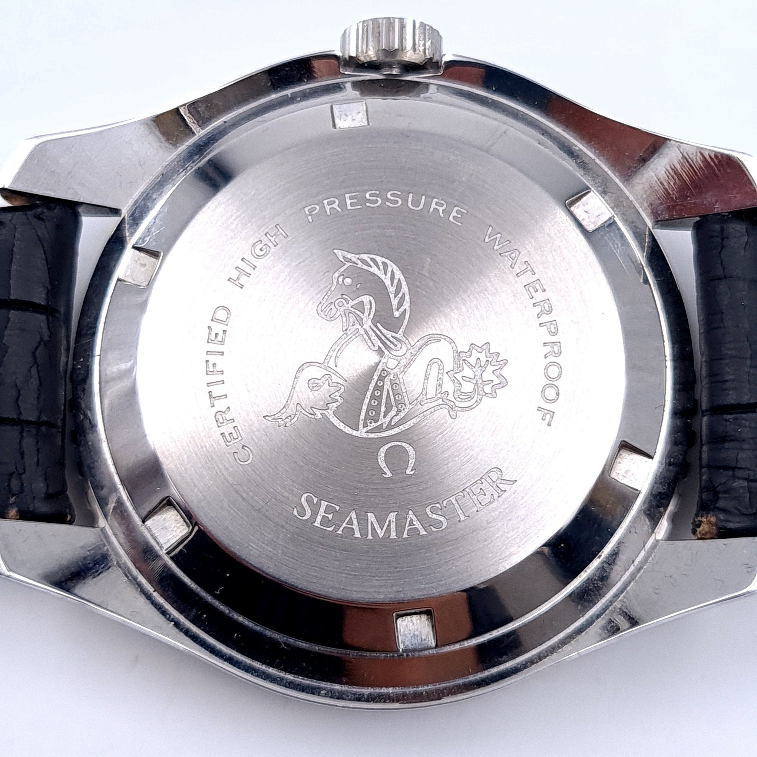

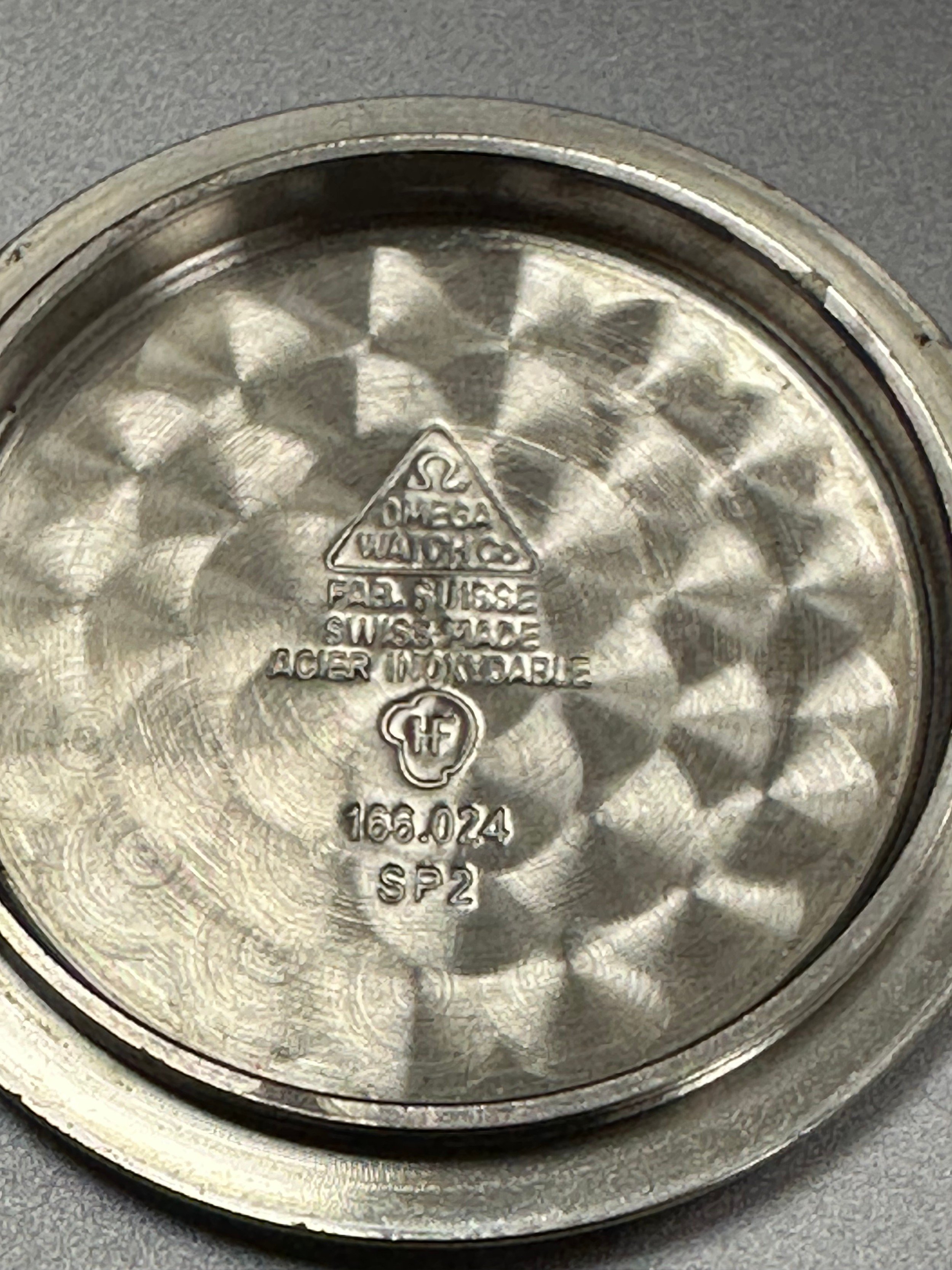

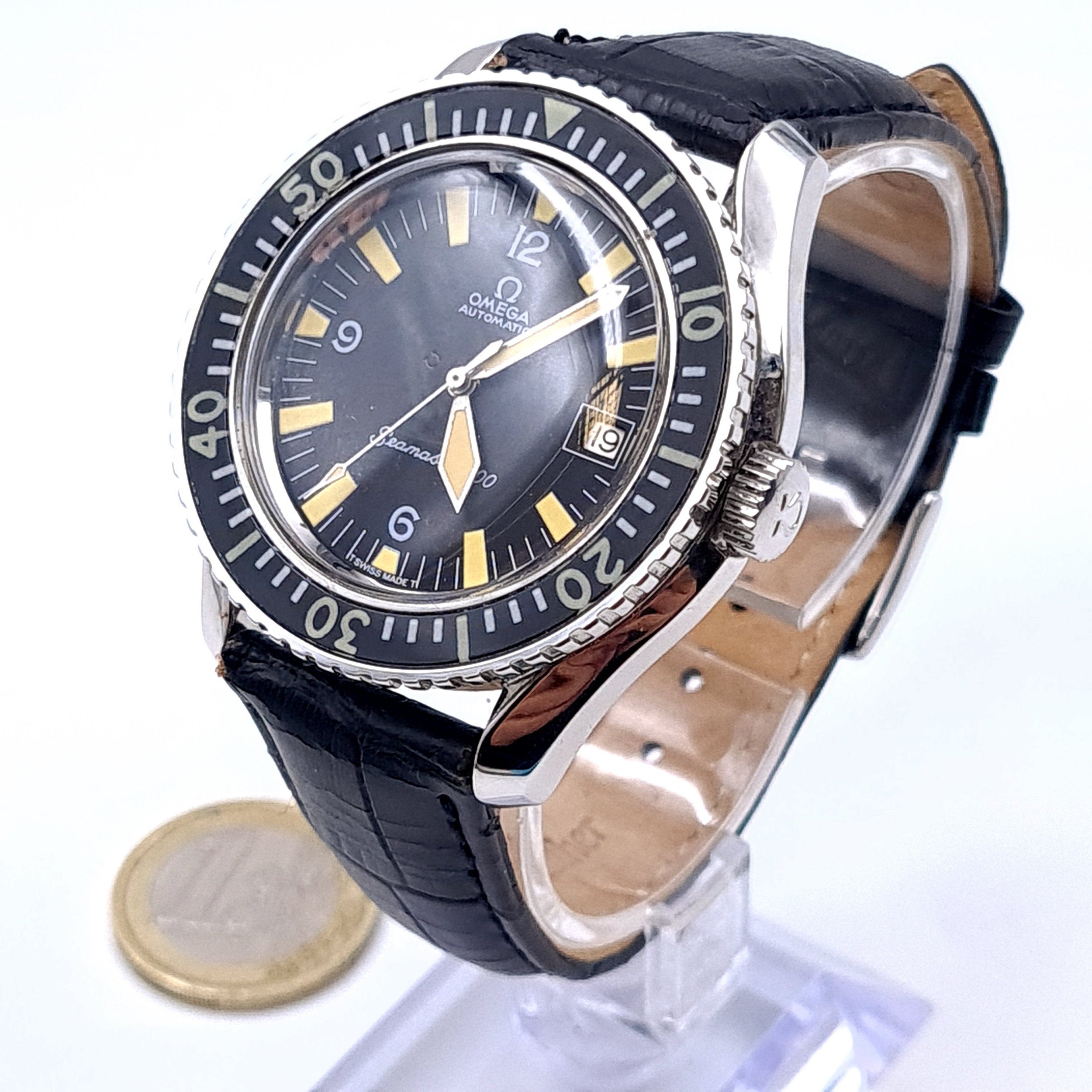

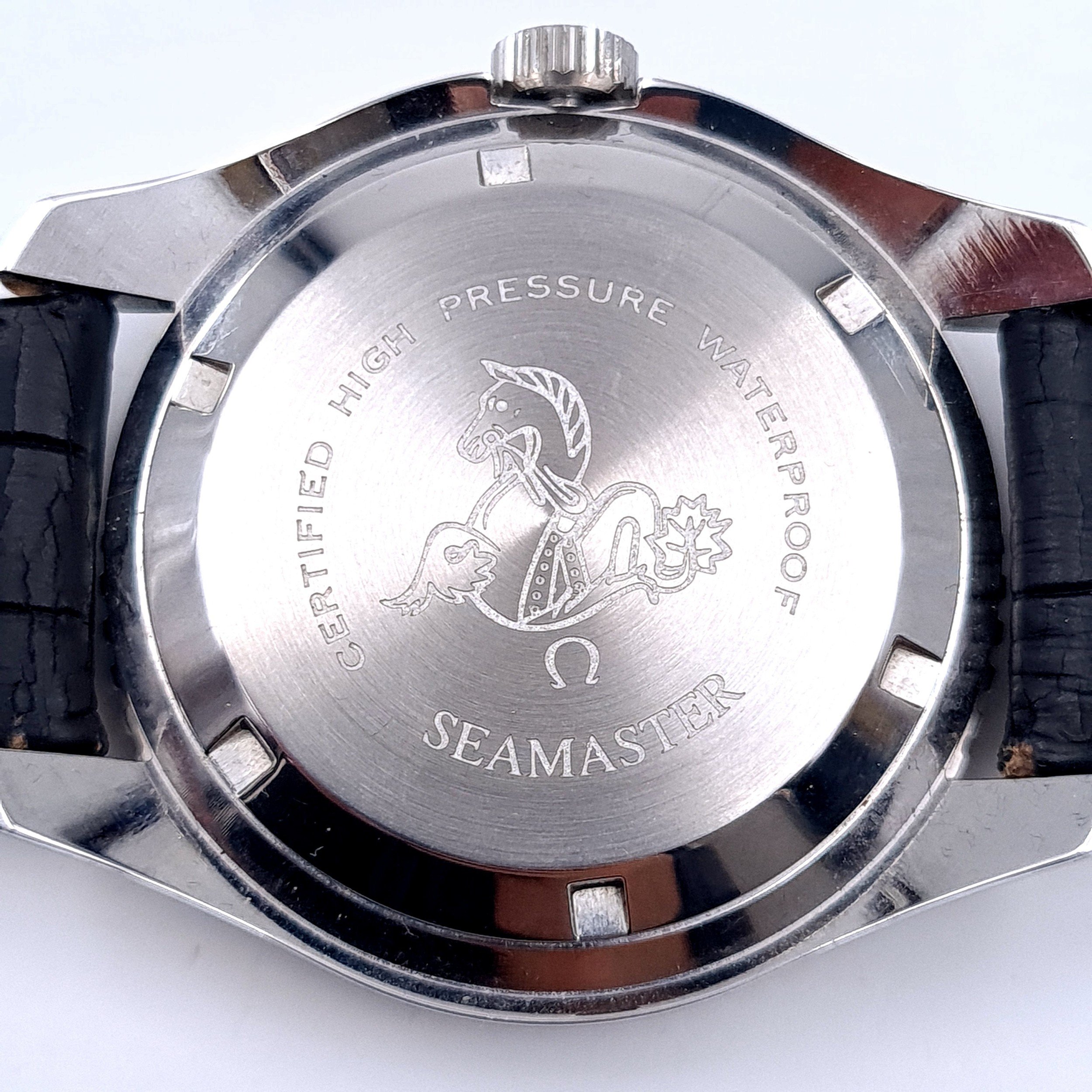

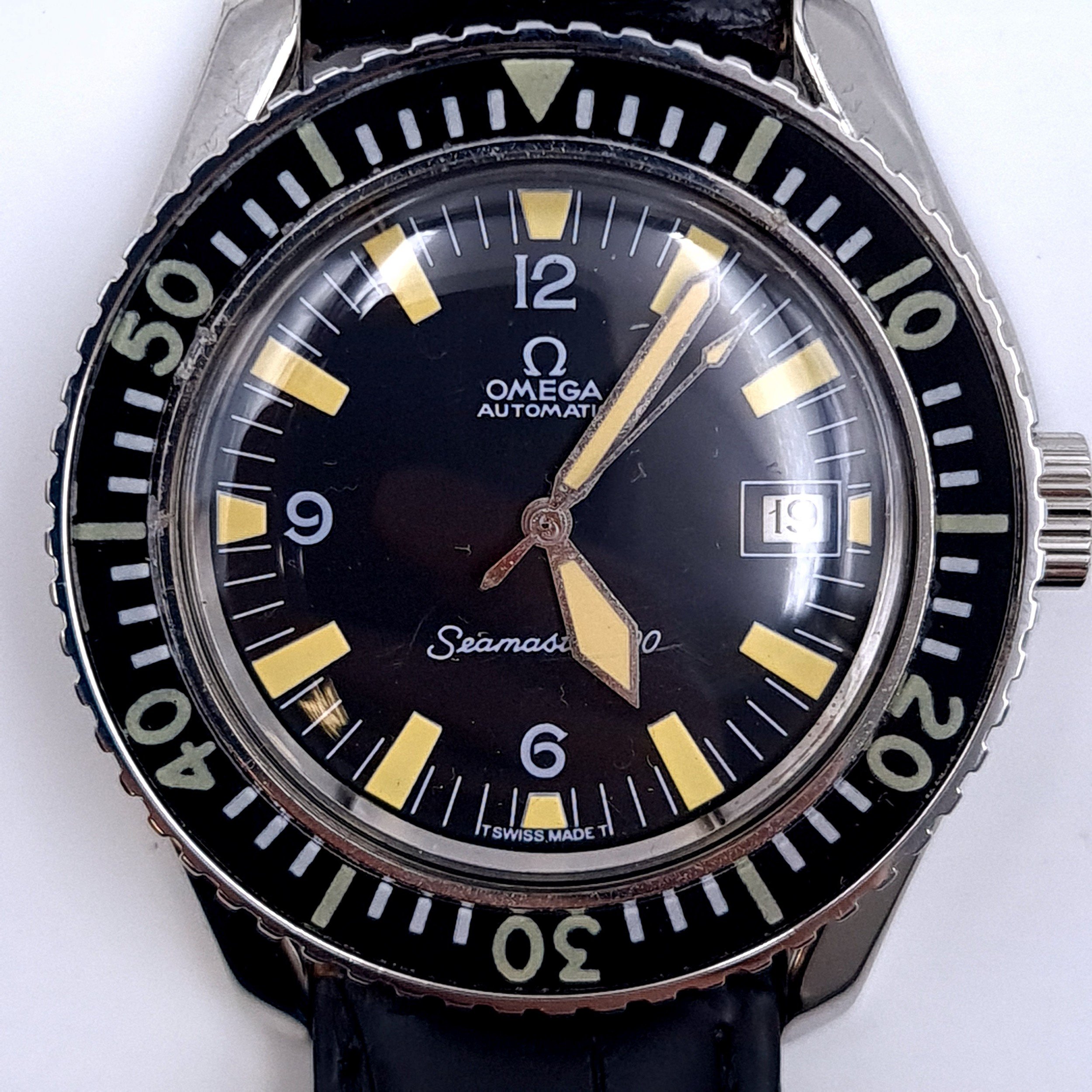

Hi, I'm interested in this watch but I have an uneasy feeling about it, there's no papers and the case back looks new, I'm not sure about the face either?
Any advice would be welcome!
308
230
Yes, it is a fake. This examples can be found also on chrono24 etc time to time. I`m trying to report those.
663
1,239
https://omegaforums.net/threads/omega-seamaster-300-165-024.164722/

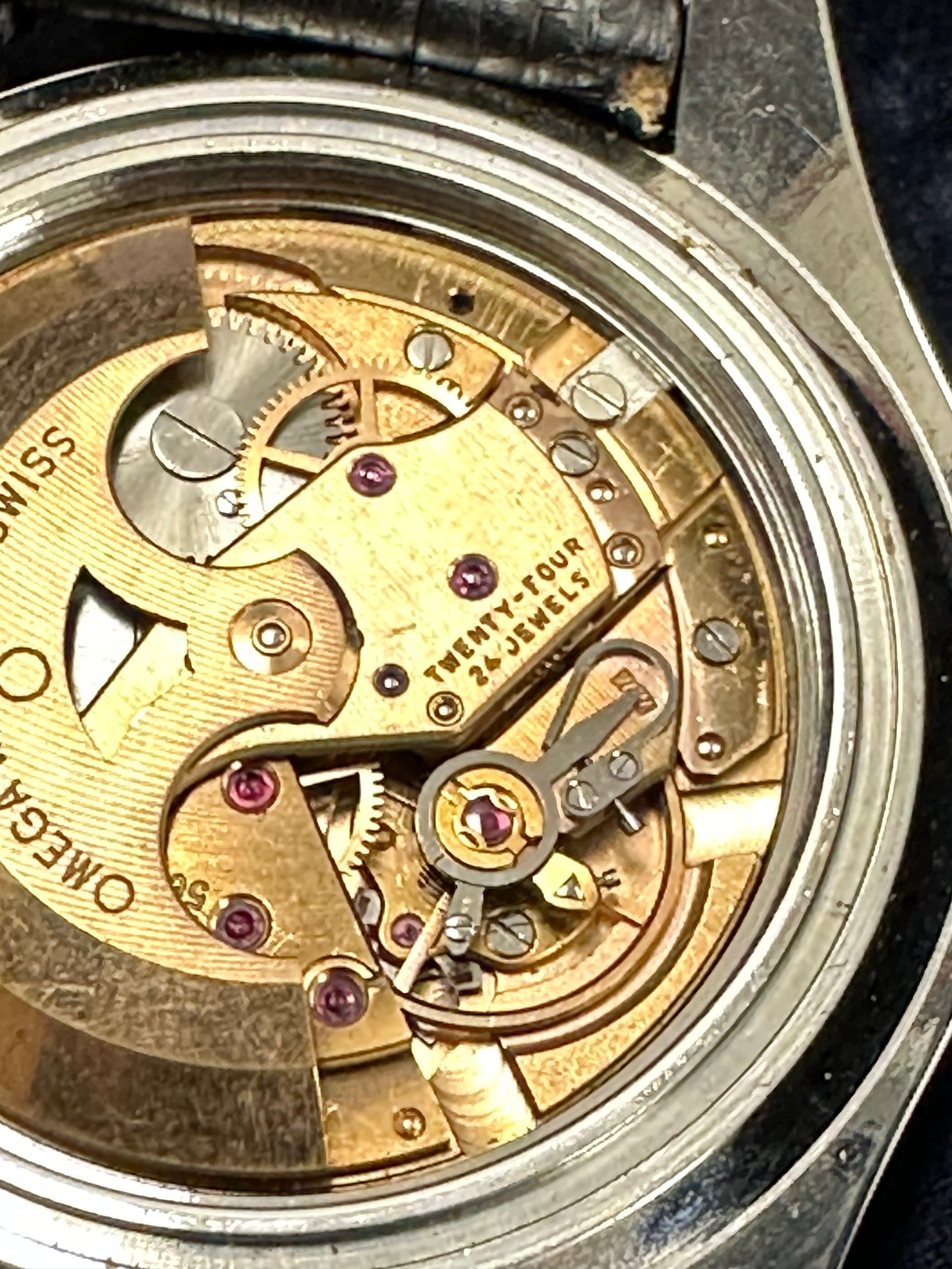

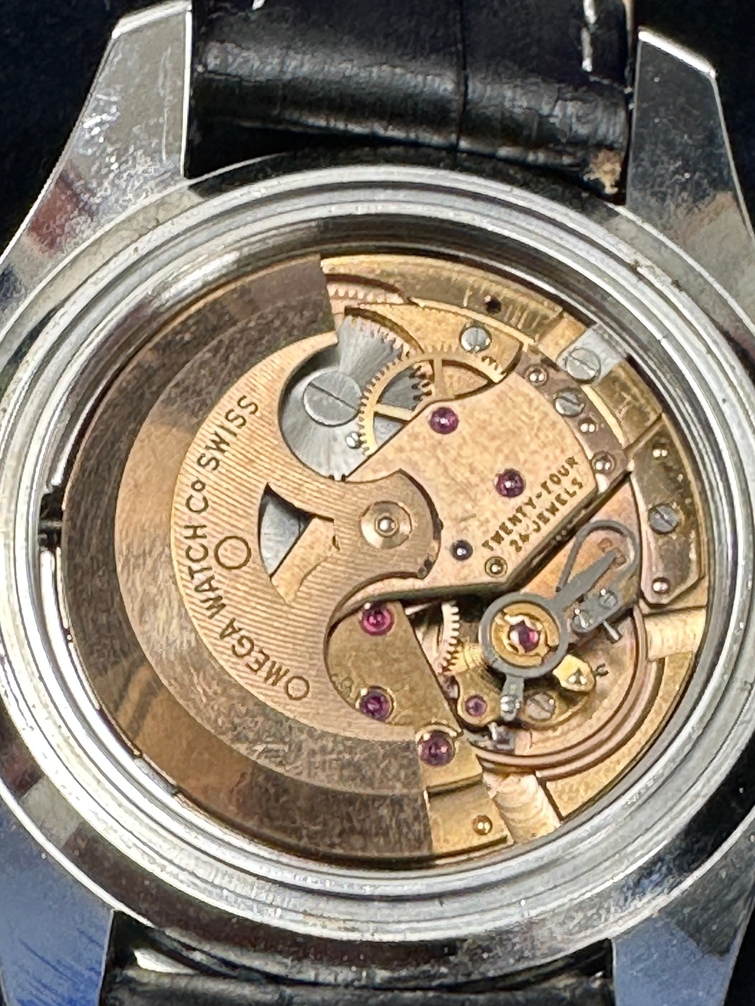

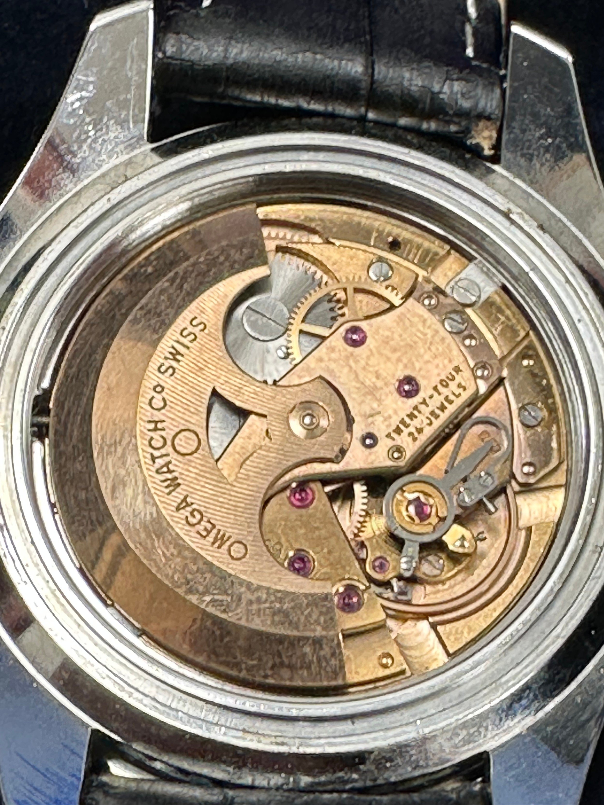

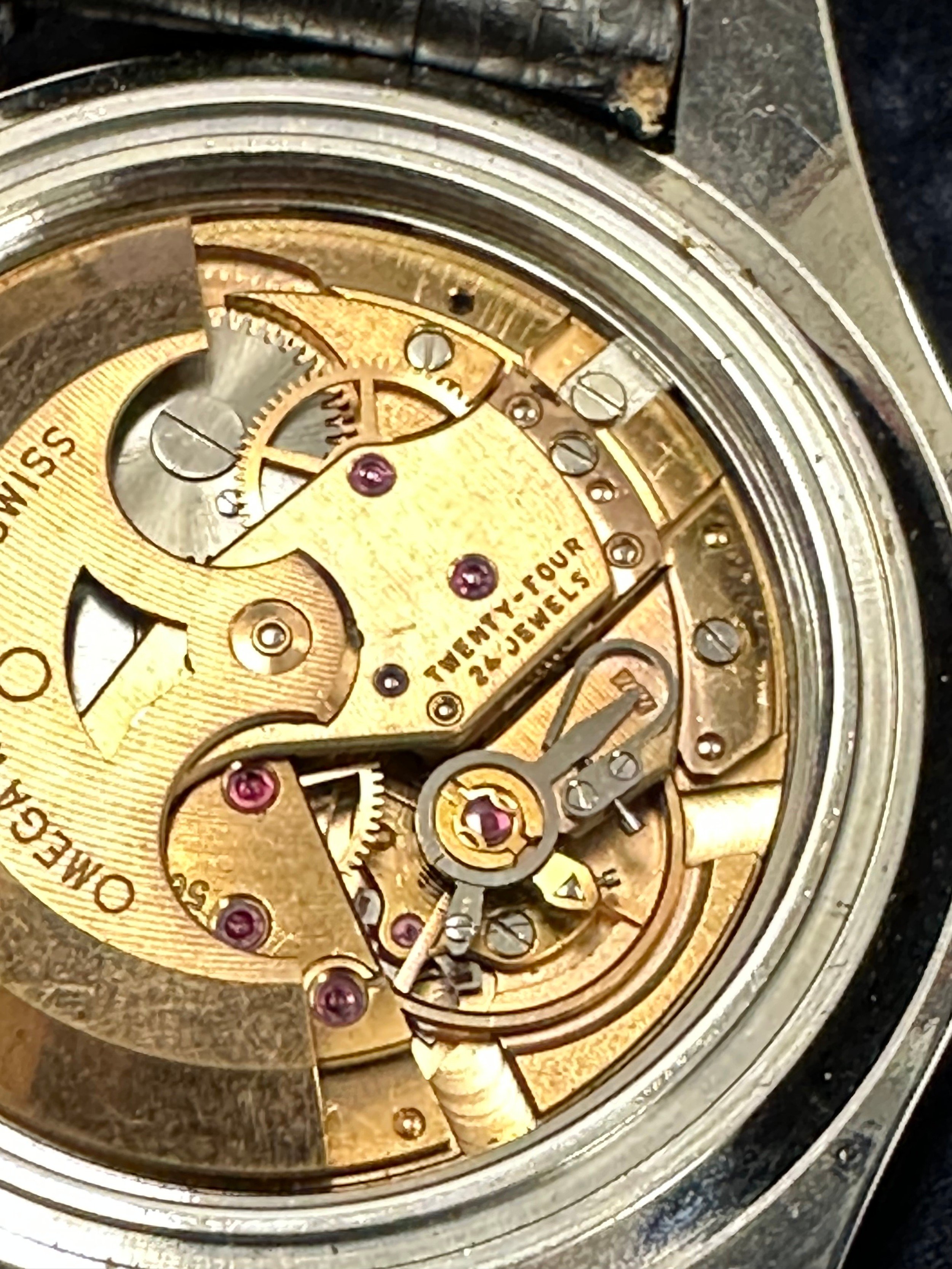

This one is legit CB case+dial+bezel, unforunatelly the movement has been changed, the serial number is way to early for this model. You will never be able to get the Extract for this watch, if this service is back, of course 馃榾
Exact, the serial is too early.. so I didn't ask a EOA on this one.
But as you can't get an extract, you can have the box to be comforted 馃榿
