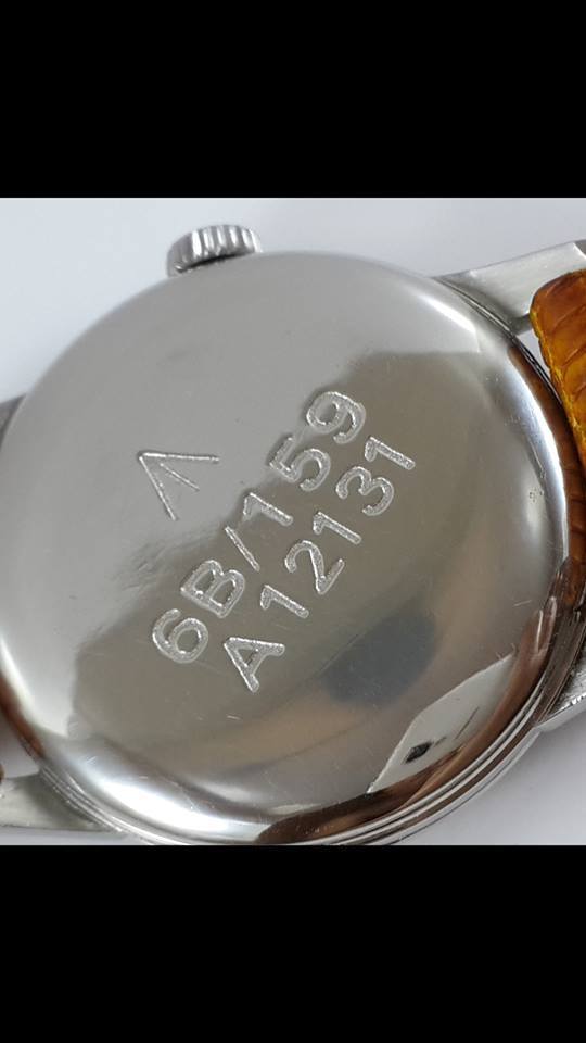

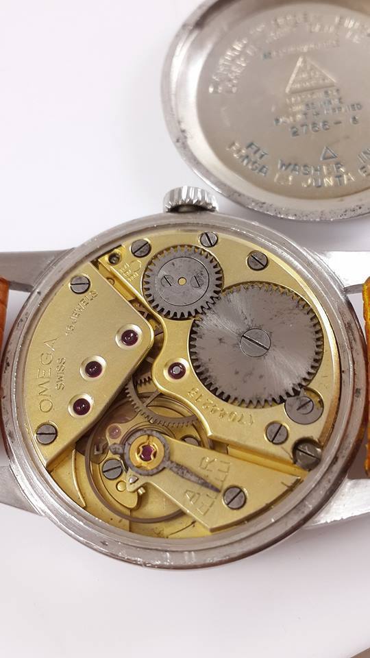

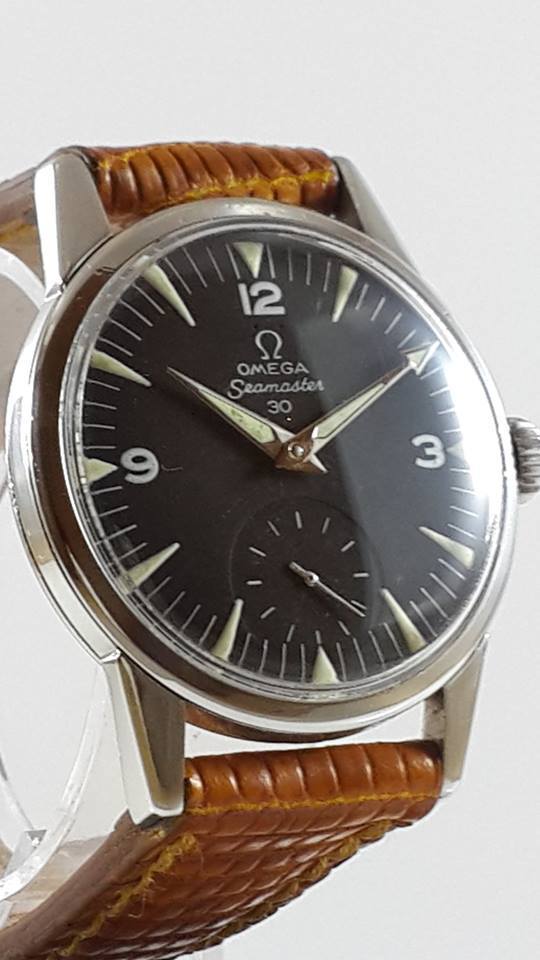

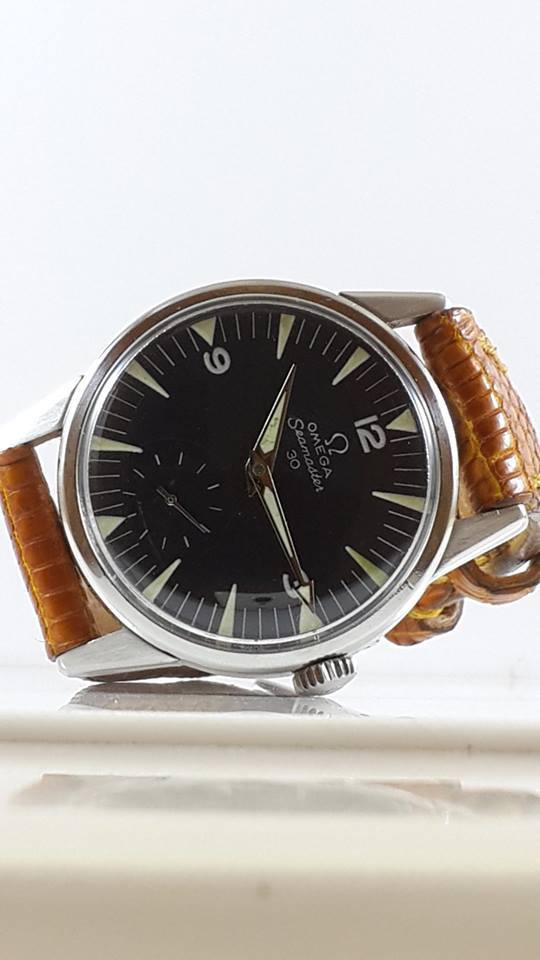

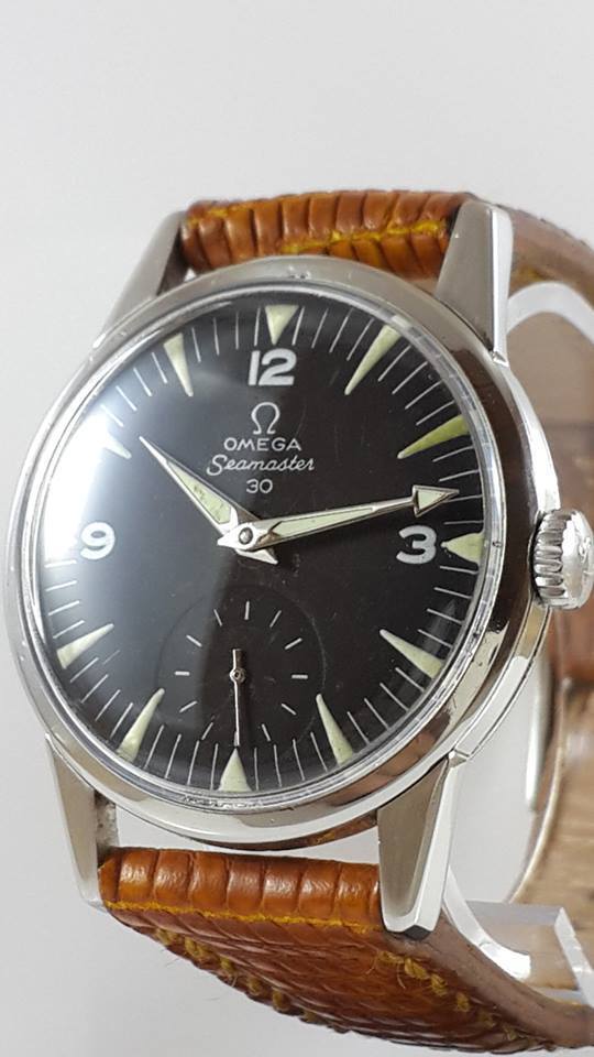

    Hi Folks, recently came across this Omega Seamaster 30 Sub Seconds, which runs on caliber 268. Does the watch looks genuine? Are the inscriptions in the back related to a military unit (have seen similar on the Railmaster models, but not on the 30 series)
    Thanks

    Hi, it is not a genuine military watch. Case inscription is done most likely during the re-dial period. Movement and case is omega.
    Hope it helps.

    Fantasy refinished dial and fake military markings, why would you even want it?

    Only you can decide if you like it enough to buy it. It has pretty much zero collector value or kudos though. Only really worth the value of the average case and movement, but I'm sure the price is much higher.

    Casenacl engraving doesn't seem right. Also the lume is very sloppy. Notice it spilling into the seconds register and over application compared to westmtn's post.

    And the hairspring seems bent.
