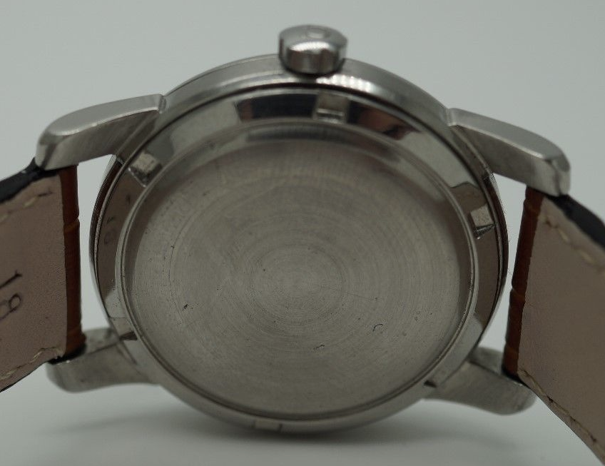

    The crown seemed the right one and besides the case looking quite overly polished to me (what do you say?), i wanted to find out more.

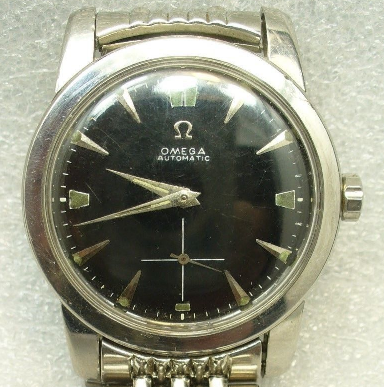

    just noticed this one in another thread
  4. chipsotoole May 11, 2018
    1,061
    1,924
    Welcome to the OF. Very interesting dial on this one.first impressions: It simply looks too clean to have survived from the 50's, the case has also seen some grinding and lost it's sharpness. I don't know if they're original (I don't think so), the shade of lume doesn't match the ageing on the dial.. but I do like the hands style...We need to see the inside and caseback.......let's hear from the experts...
  5. ConElPueblo May 11, 2018
    9,587
    26,977
    I am pretty sure it is a redial. The white text on black background is always a warning sign, as is the inconsistent condition of the dial in relation to the case. The lume dots ought to be bigger too, as can be seen on the last one in this thread; the cut-outs in the markers should be filled completely. The hands are completely wrong too.

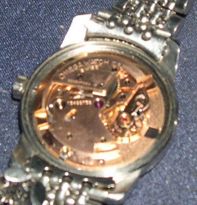

  12. X350 XJR Vintage Omega Aficionado May 11, 2018
    12,586
    29,832
    Movement is missing the adjuster screw on the regulator, never a good sign.

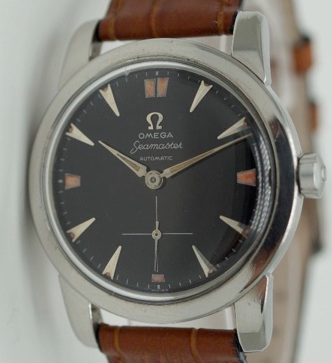

  16. kosmar May 14, 2018
    22
    6
    just collecting another black example.
    any thoughts?
    no good mvmt pic, suspicously
