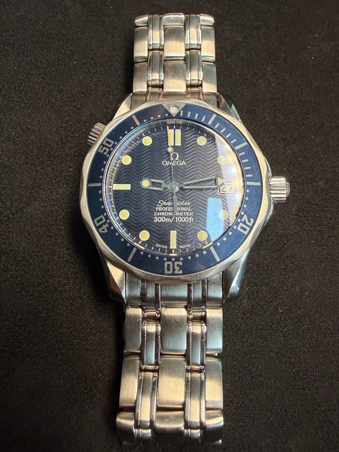

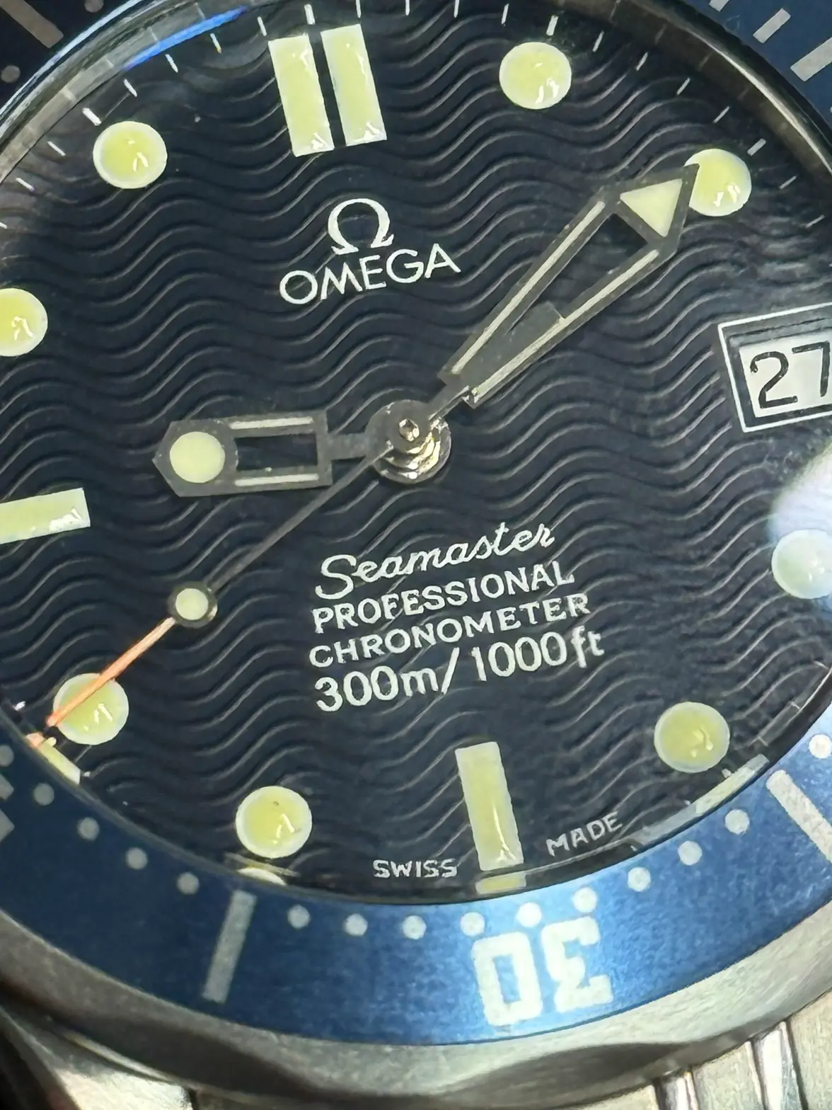

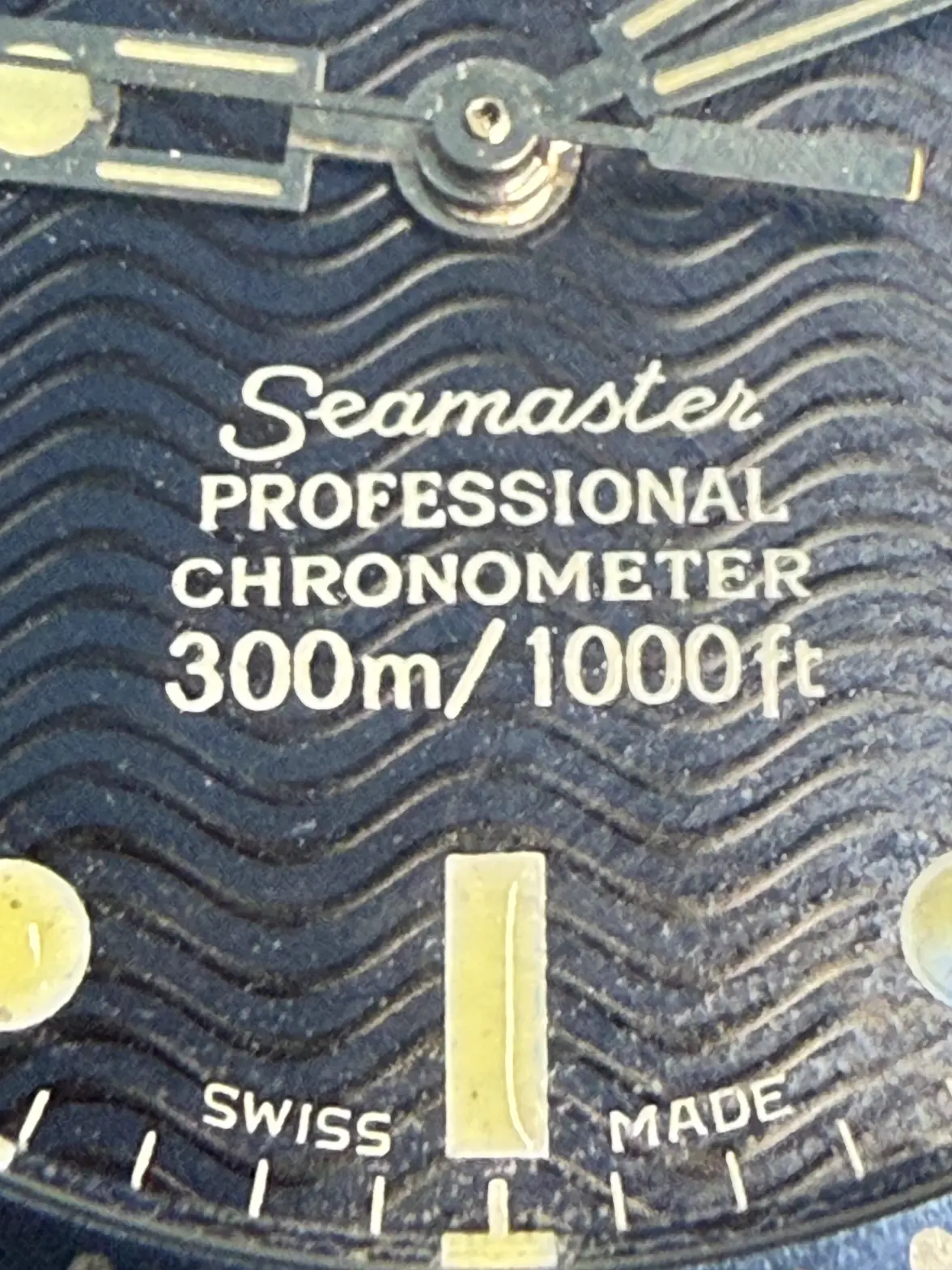

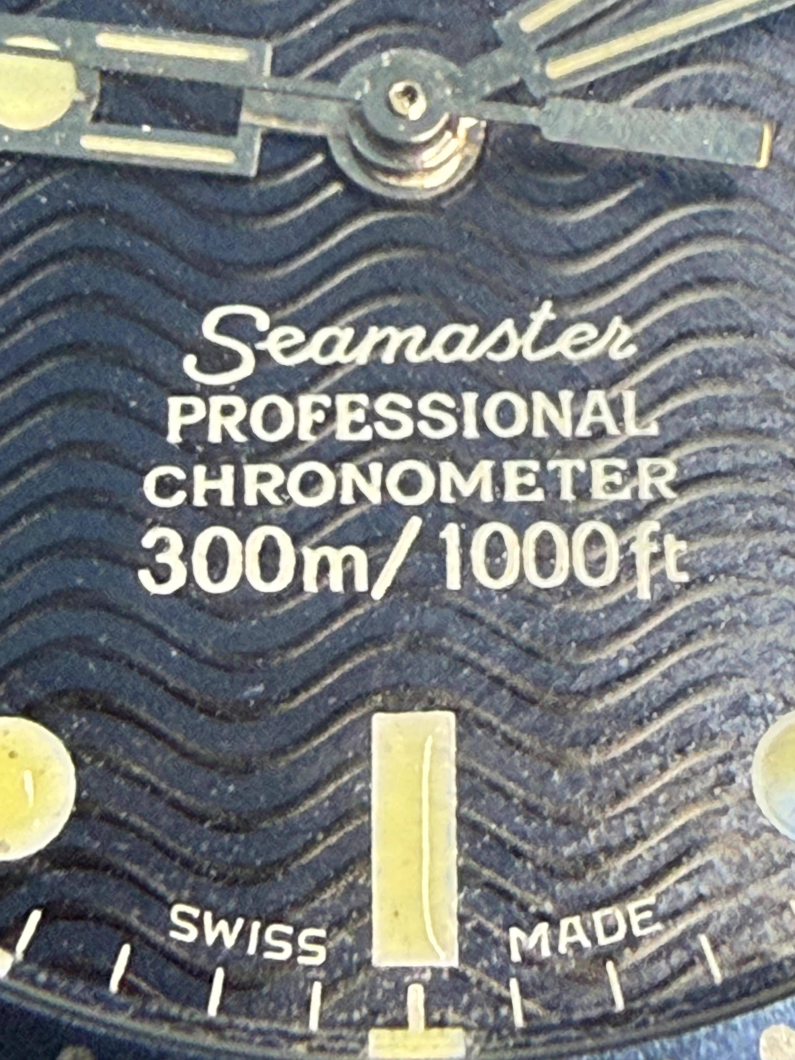

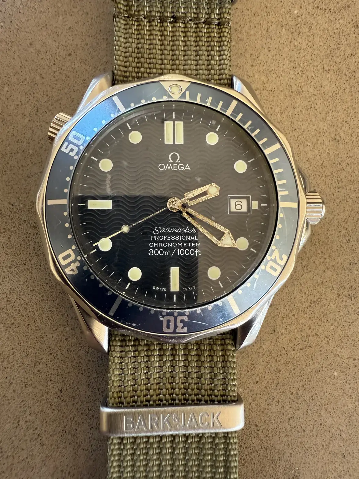

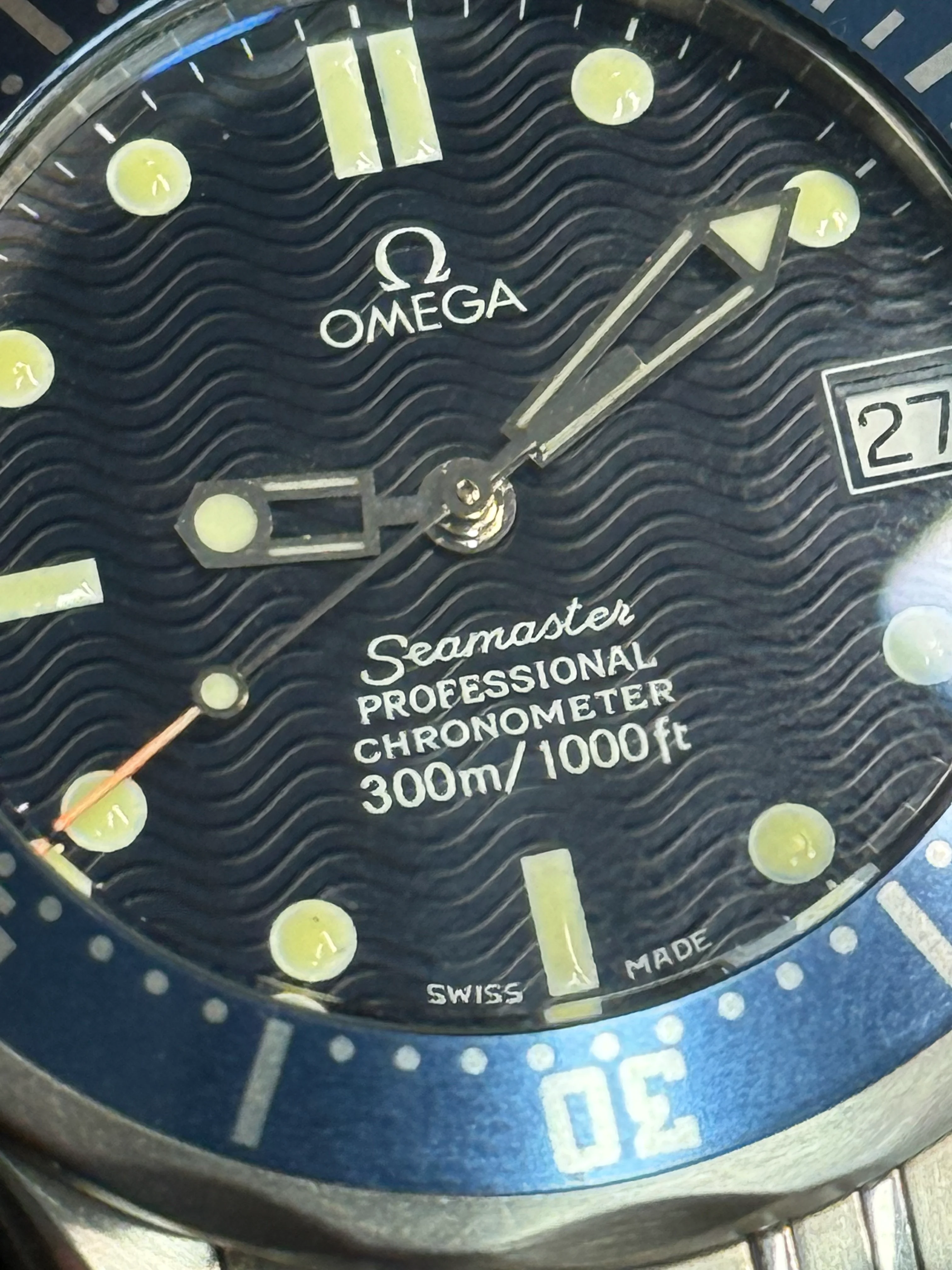

Dear all -
I can't decide if this is real after seeing it in-person. The watch dial font for "Professional Chronometer" is serif, versus sans-serif (example) for most listings I've seen online.
E.g., in the "L" in "Professional", there's a curve up at the end of the stroke. The only similar serif fonts I've seen is this at Chrono24 and this on SwissWatchExpo. The former looks like it has a service card.
If it helps, the serial number is 80029xxx (dating to 2006 from some sites but am not sure). The lume is also a bit yellow and the seconds hand is a bit faded, and running at -10s/d.
I would greatly appreciate your assistance!

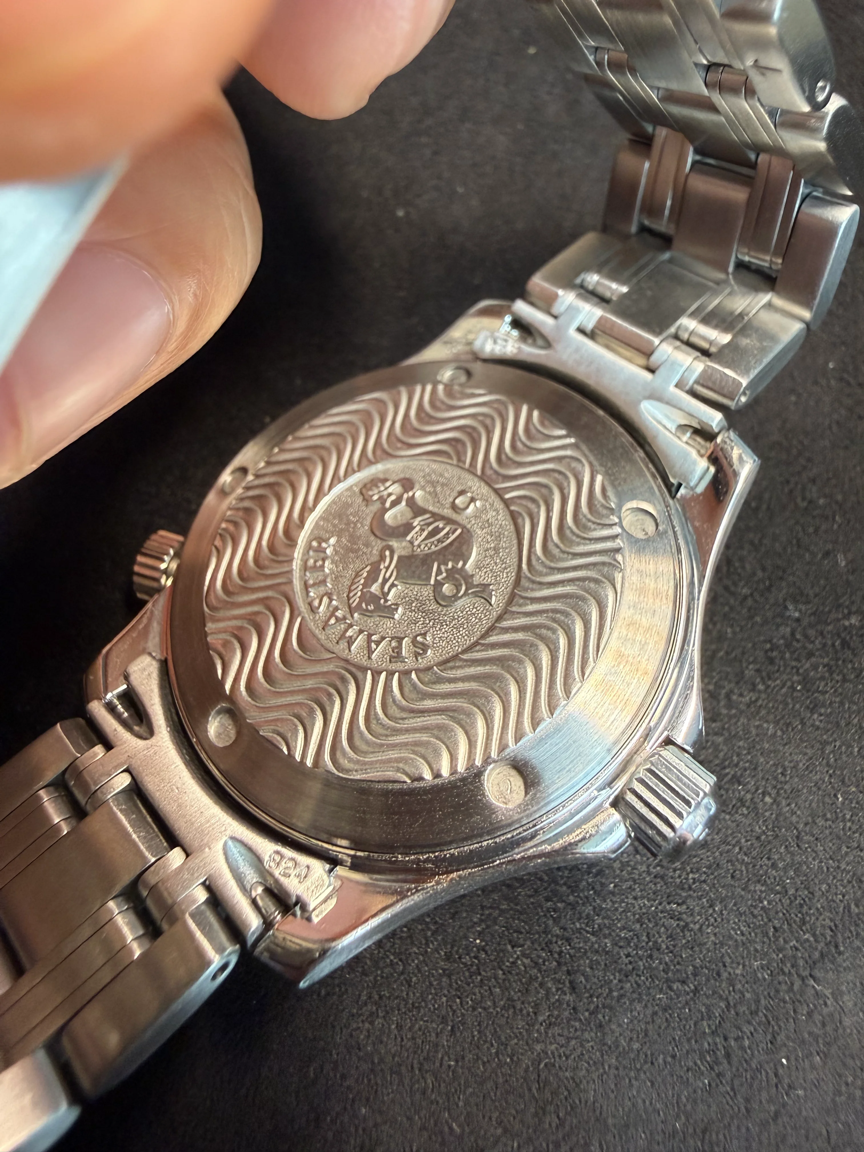

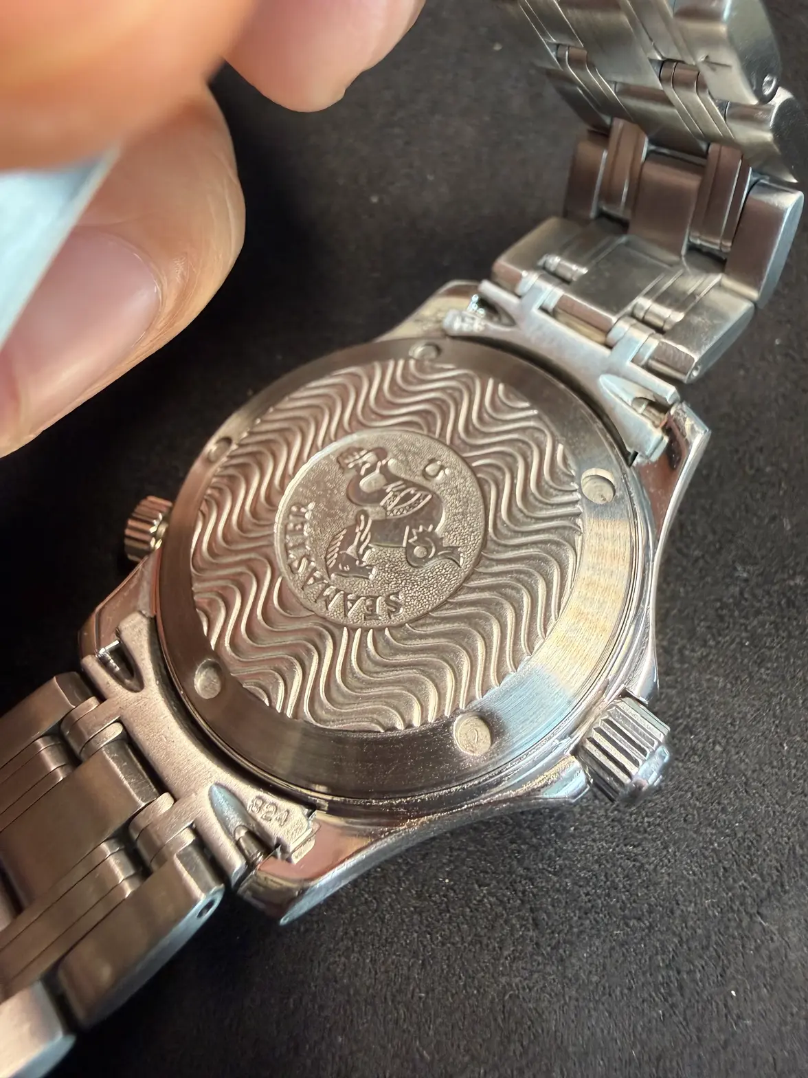

Also - dealer opened the caseback and serial on the movement matches the lug. Movement 1120 and 23 jewels. Unfort. didn't take any photos.

8002XXX probably puts it at 2000 or 2001. Online serial databases are straight wrong. AND a date around that time would make sense- there was a different font used early in the 2531 run in 1995, that re-appeared briefly in 2000-2002 or so. Could be true for the midsize as well.
Here's another shot of a 2531 with font like yours:
From this thread also discussing the font variation:
I also don't think there was any sort of convincing fake of this model.
3,974
8,611

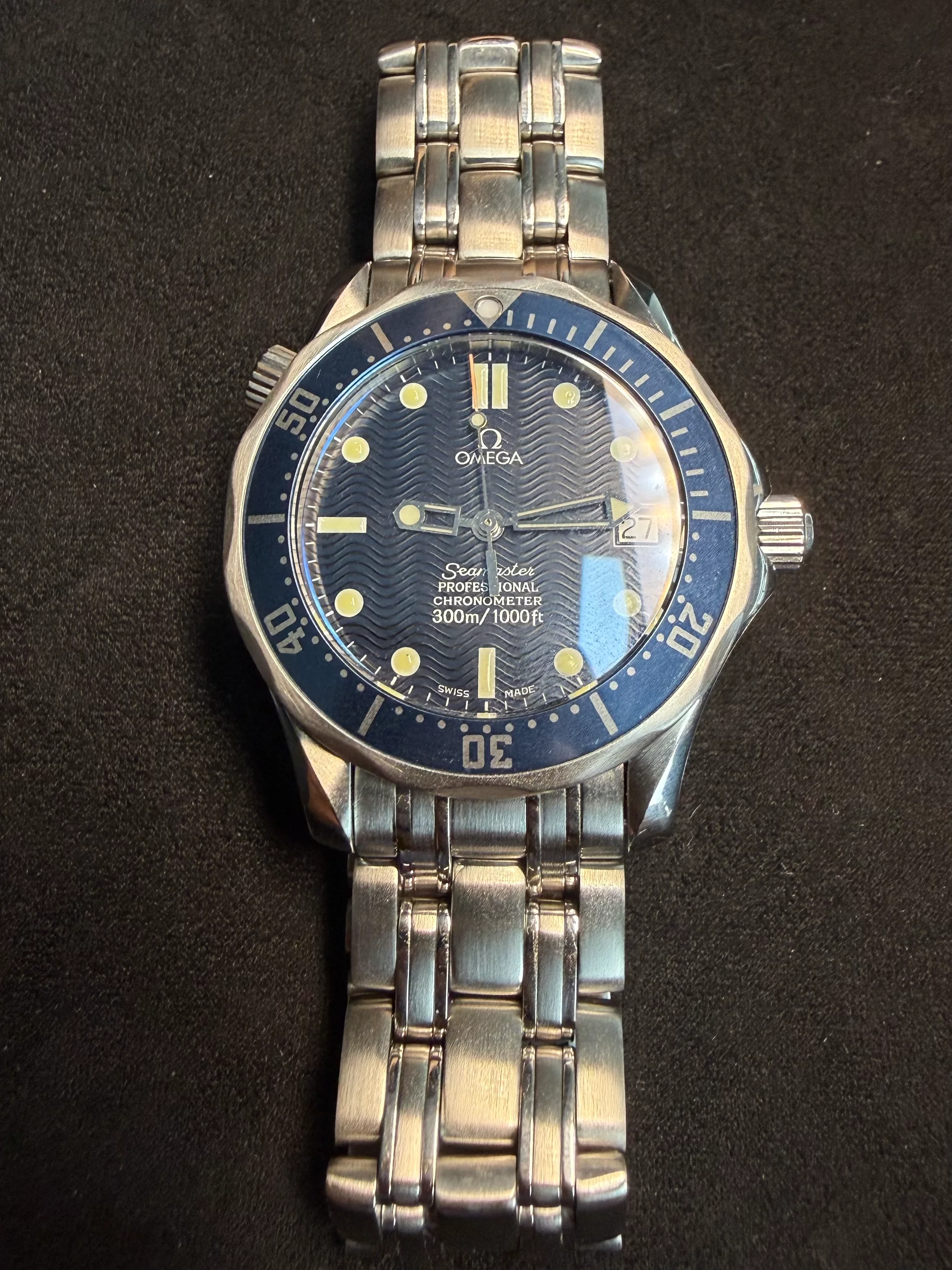

NOTE: that said, I do have some concerns... the bezel pip is wrong, and at minimum that is likely an aftermarket bezel insert (not uncommon). This has also been pretty heavily polished, and not well. The date wheel looks like it may be degrading (could just be the pictures) which could be an indicator some water got in there. These things would probably cause me to pass on this one- there are plenty of 2531s out there.

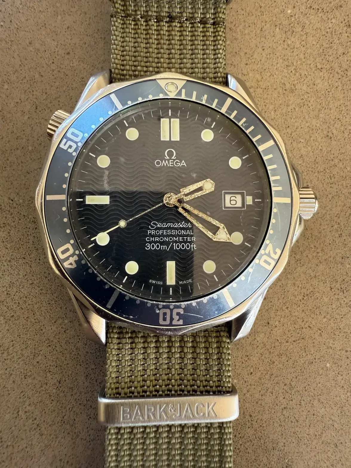

Adding a video for more clarity - is the issue that the bezel lume looks much newer? How bad is the bracelet?
This 2551 is $1900 and in otherwise decent condition, so thinking about it!

So, the issue is that the PIP looks too low in the Triangle to me. When I see fake or replacement bezels, the circular pip almost always touches the sides because it is positioned too low within the triangle. If you look at a couple of real ones, you'll note that there is a space between the triangle and sides.
The other issue is that the pip lume appears to be the wrong color.
It's not uncommon to see replacements, Omega does not sell the insert separately and you have to replace the whole bezel so a lot of times aftermarket inserts get purchased if the insert is beaten up.
In the video you just posted that watch looks like it is in much better condition than the pictures led me to believe, could be bad quality pictures make the Finish look worse than it is.
I think you are right Erich, its probably a replacement insert and its been mounted wrong. The pip should be next to a "top" not a scallope.
