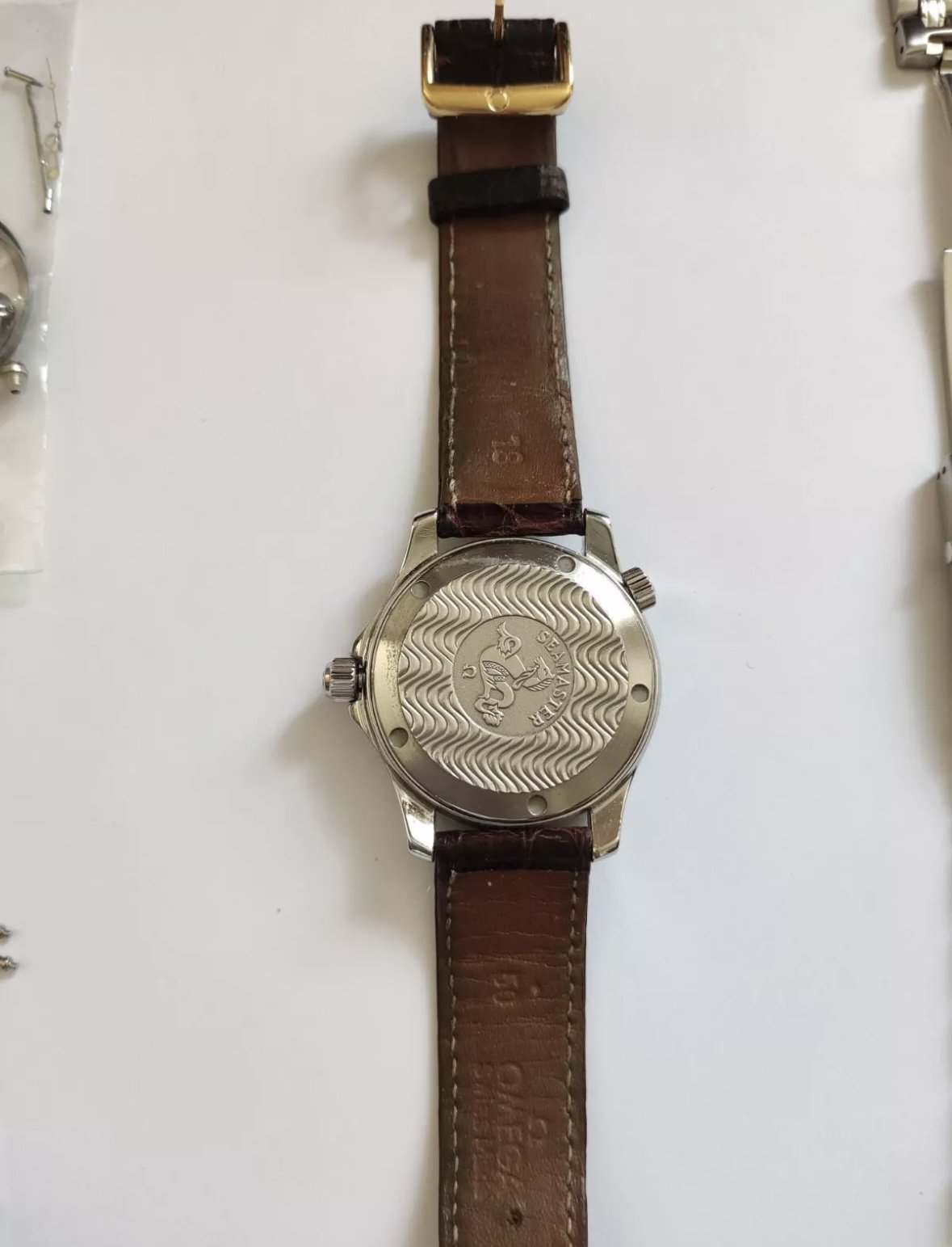

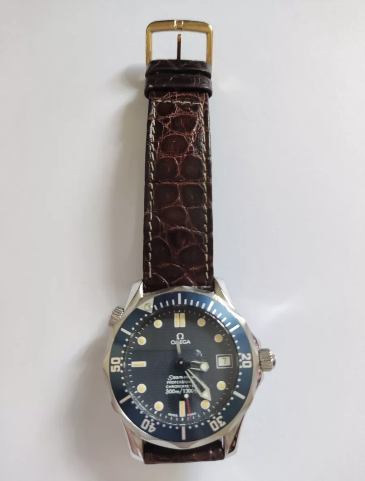

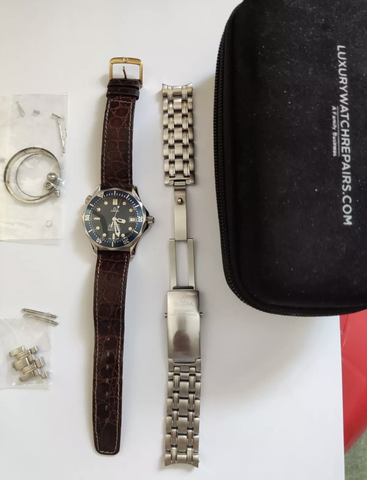

I am looking to obtain my first Omega. Currently I’ve found a seller selling a Seamaster that has got a crown that doesn’t screw all the way in - problem is not very clear. Price most certainly reflects that. I’m aware that service could be costly, but that could possibly lead me to a great serviced watch for a reasonable price. Currently the watch is offered at £1.2k with an extra leather strap. Last time it’s had a service was in 2020 and from what I understand runs well except for the crown screw in problem.
I’d appreciate advice if this seems reasonable, if anyone knows what the crown not screwing back in could be and anything else anyone could add.

You know it’s a mid sized model right? Its not a 2531, it’s a 2551.80. The middies trade around £1600-1700 even when mint as a full set which is around £400-500 less than a full size. Either the tube or crown need replacing. Or both. Reckon on £200 minimum at a guess, though it may still need a full service which would be rather more. It’s still quite cheap but it’s not a 2531, and those are nicer IMO.
