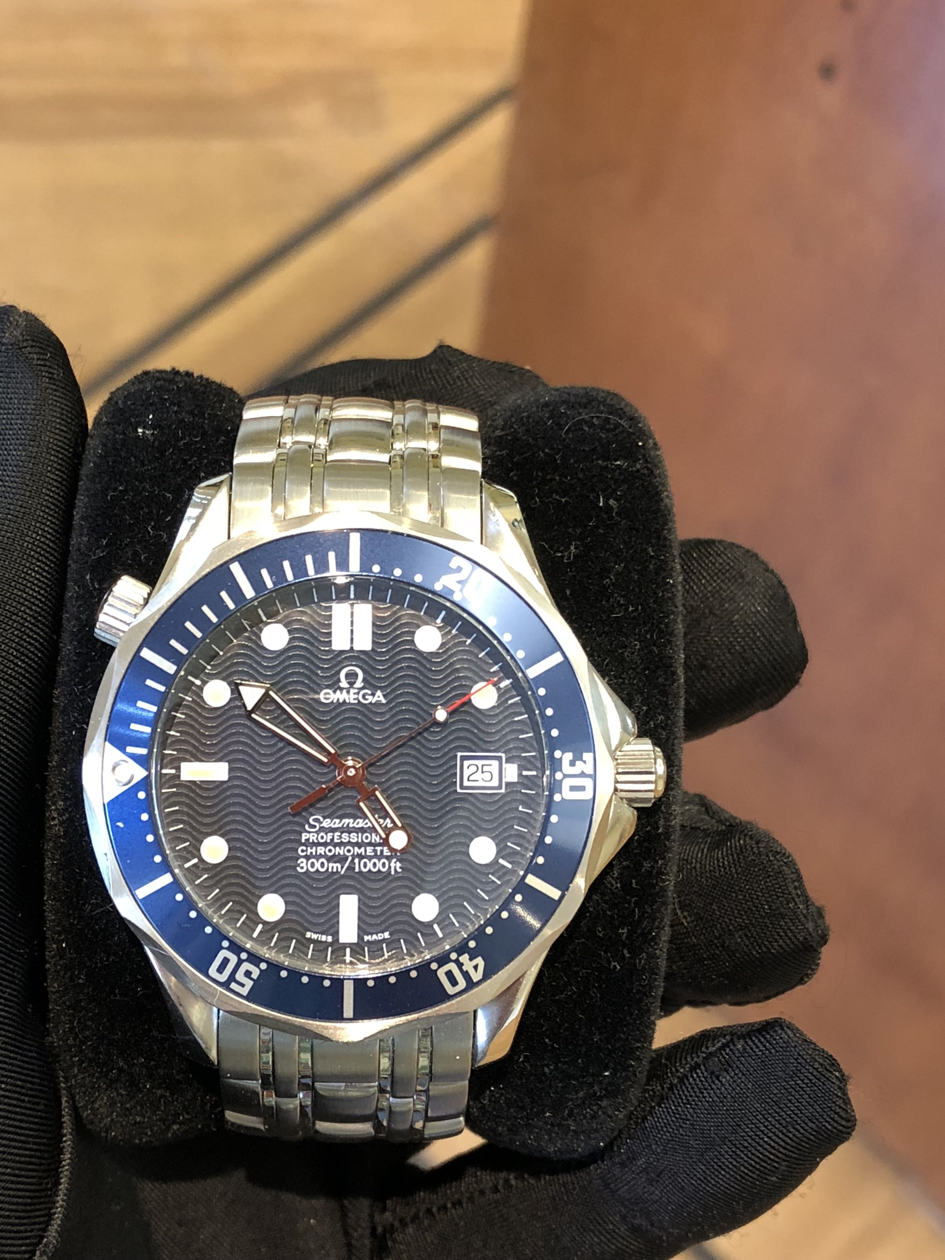

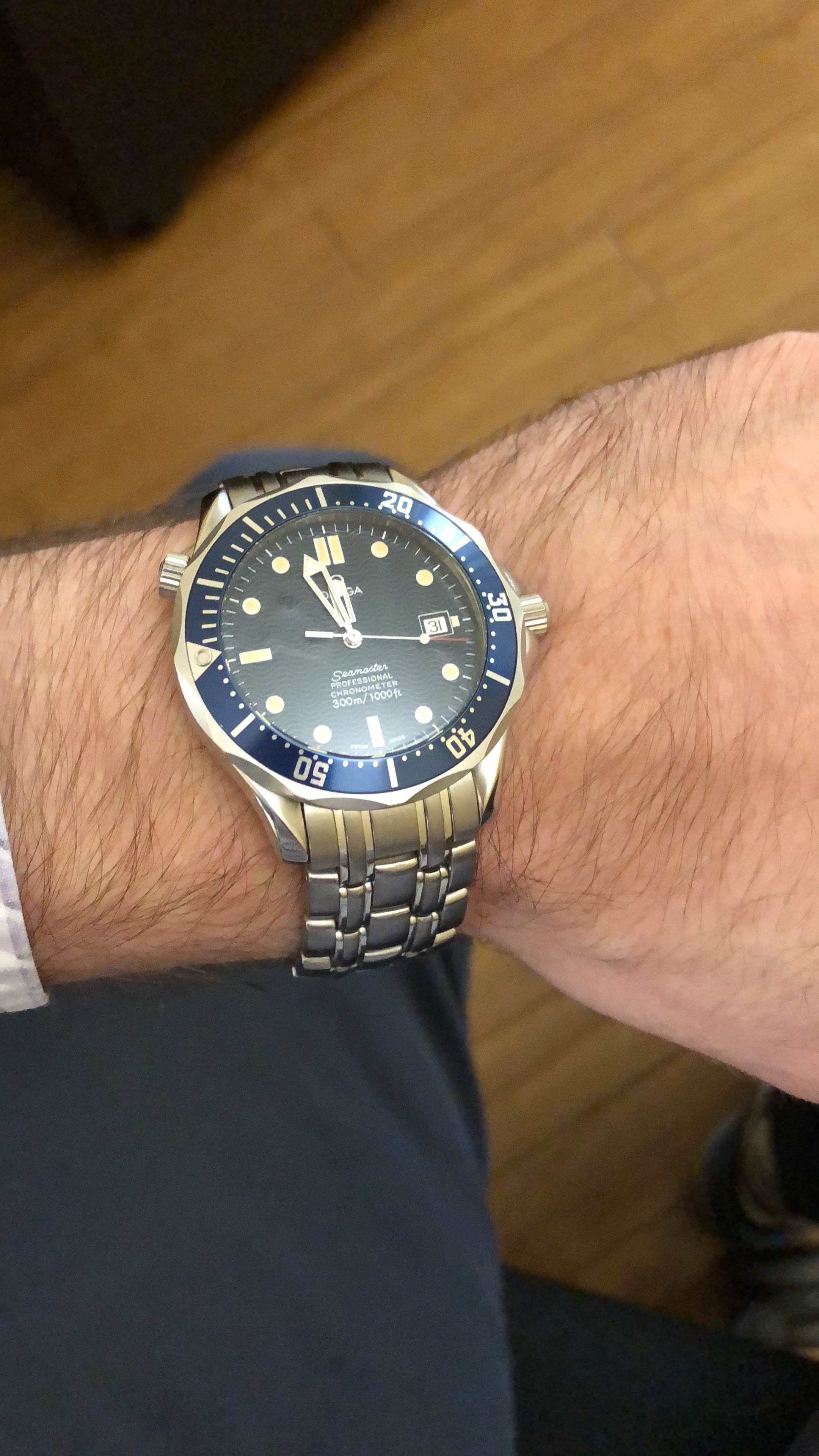

Like stuart70 said they do this, I have a 2000 seamaster with lume bezel pip and hands but on the dial its completely dead

I think that is because you actually have a <1998 Seamaster which has had the hands and bezel changed at service for SL lume items. That dial lume plot colour looks like tritium to me, in the first picture at least, the second is too washed out to judge. I would say that yours isn't one of the more obvious ones though, it is only a faint tint.
@Dr. K
Most tritium dial SMPs can be spotted by the slightly (or enormously) beige tint on the lume plots, the hands, even the tritium originals never seems to fade as much and often remain greener. Superluminova doesn't noticeably lose potency over time, not does it appreciably change colour unless it gets damp. If your lume no longer works and/or has faded to beige, it is more than likely not SL but tritium.
There is a way to spot an early SMP 2531 from the depth rating text, the font changed at some point in the 1990s, I think the tell was the loops on the 3 and the f in ft. I'll see if I can find a link to the info. The very earliest even lacked the Chronometer text in some cases and used a slightly different movement.
