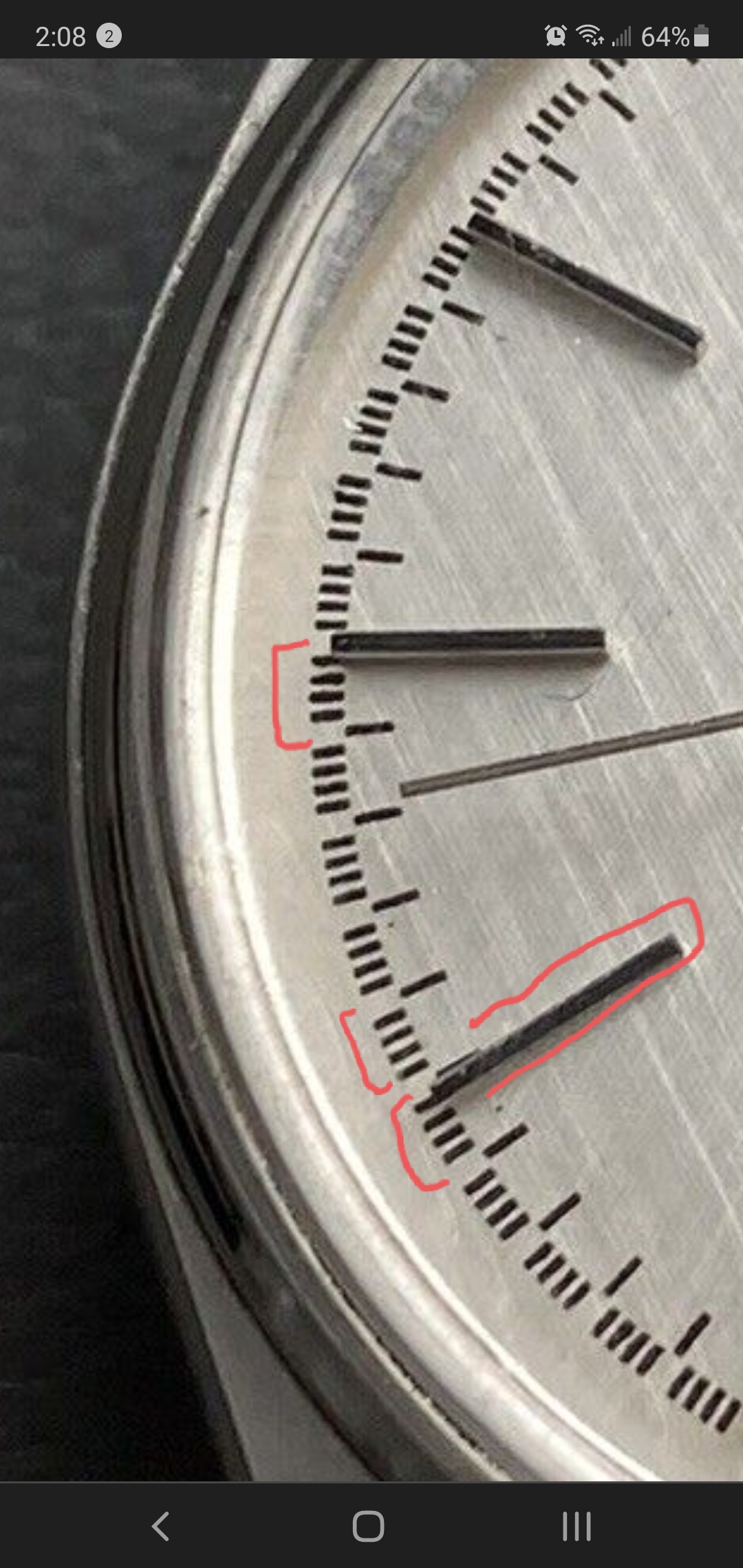

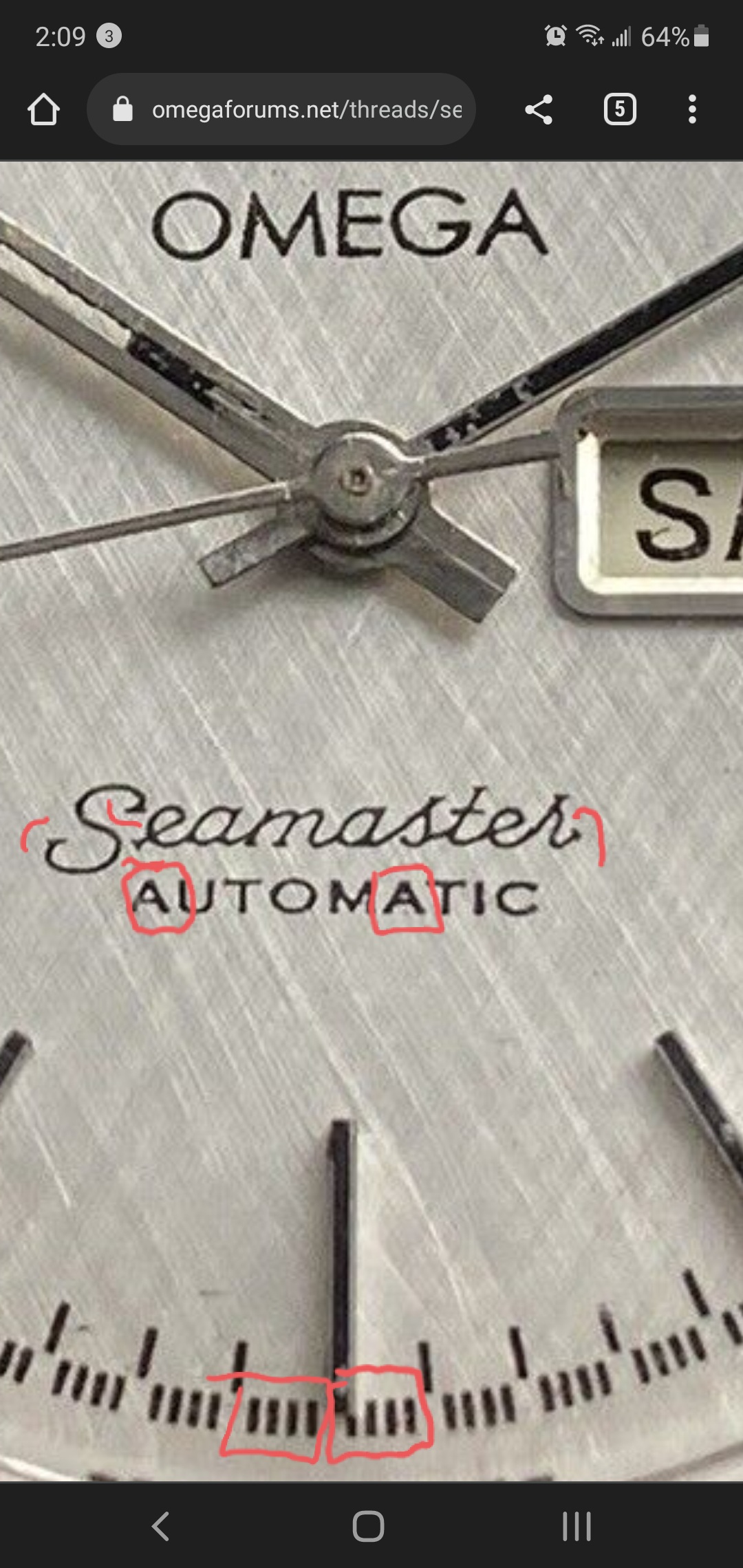

I came accross this vintage Omega Seamaster 166.0210 (cal.1020) for sale, the watch looks very nice to me but I am wondering about a possible redial because after a bit of online search I wasn't able to see one similar to this, it kind of looks like a linen dial to my untrained eye.

This is certainly a redial.
1) Serifs in the test where there shouldn't be.
2) Different sized A-holes.
3) Minute track isn't aligned with the indices.
4) Blurry minute track.

...................2) Different sized A-holes.............................
Worth repeating 😁.
