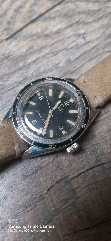

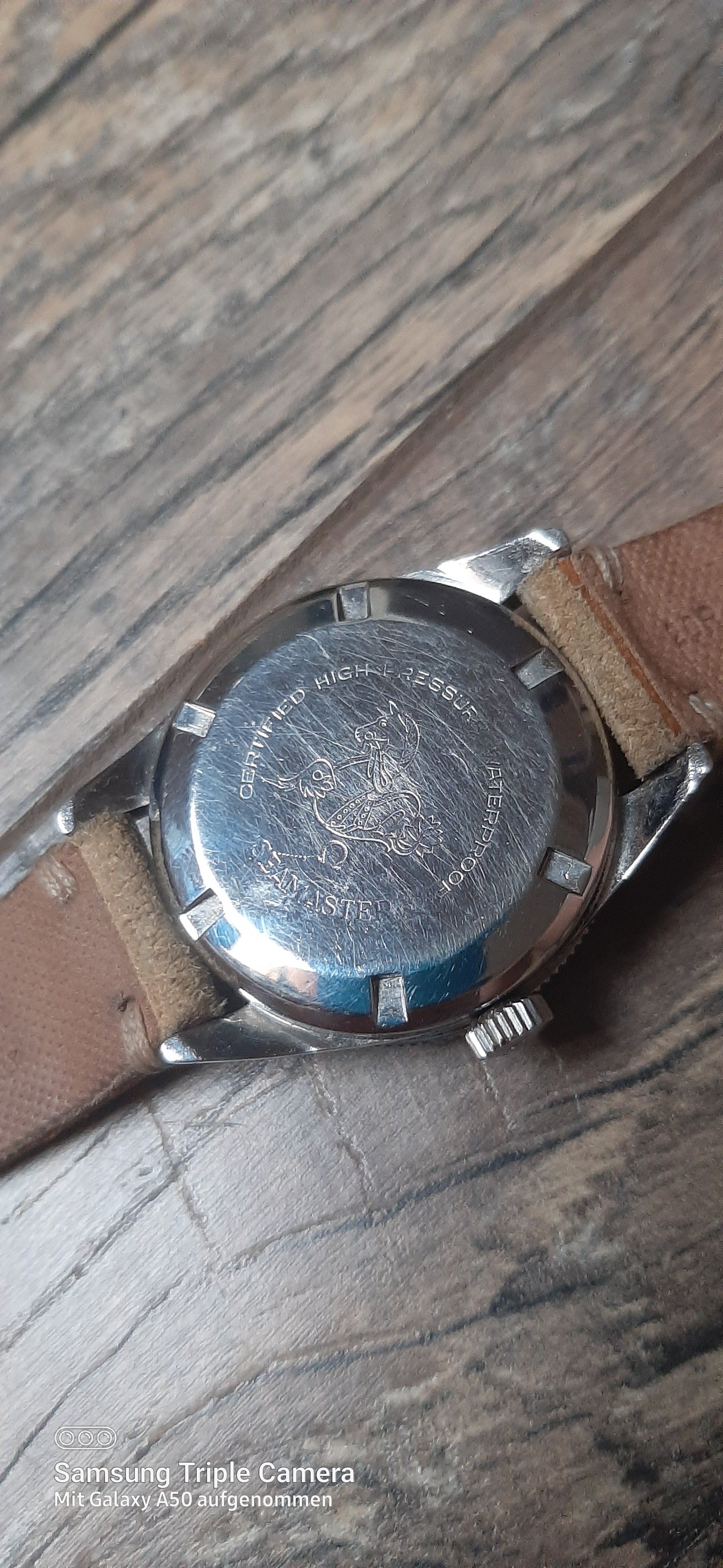

Hi friends,
looking all the time for a birthyear 1963 watch. Now got offered a Seamaster 165.014 without certificate but a serial# starting at 203...Do you think it is really a 63 or is it a 64? The bezel is a spare and I have doubts about the second hand. Price is at the lower side. What do you think about this watch?

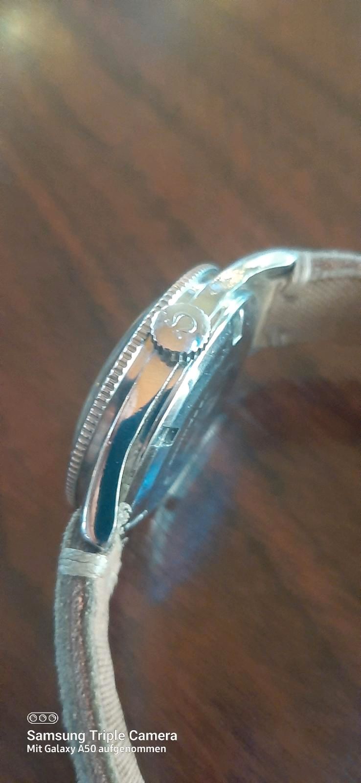

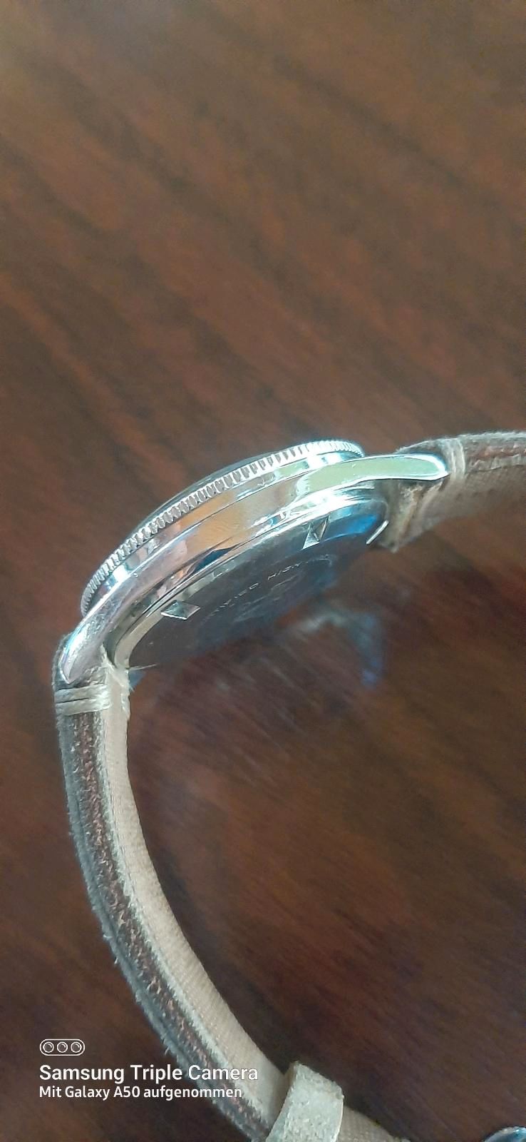

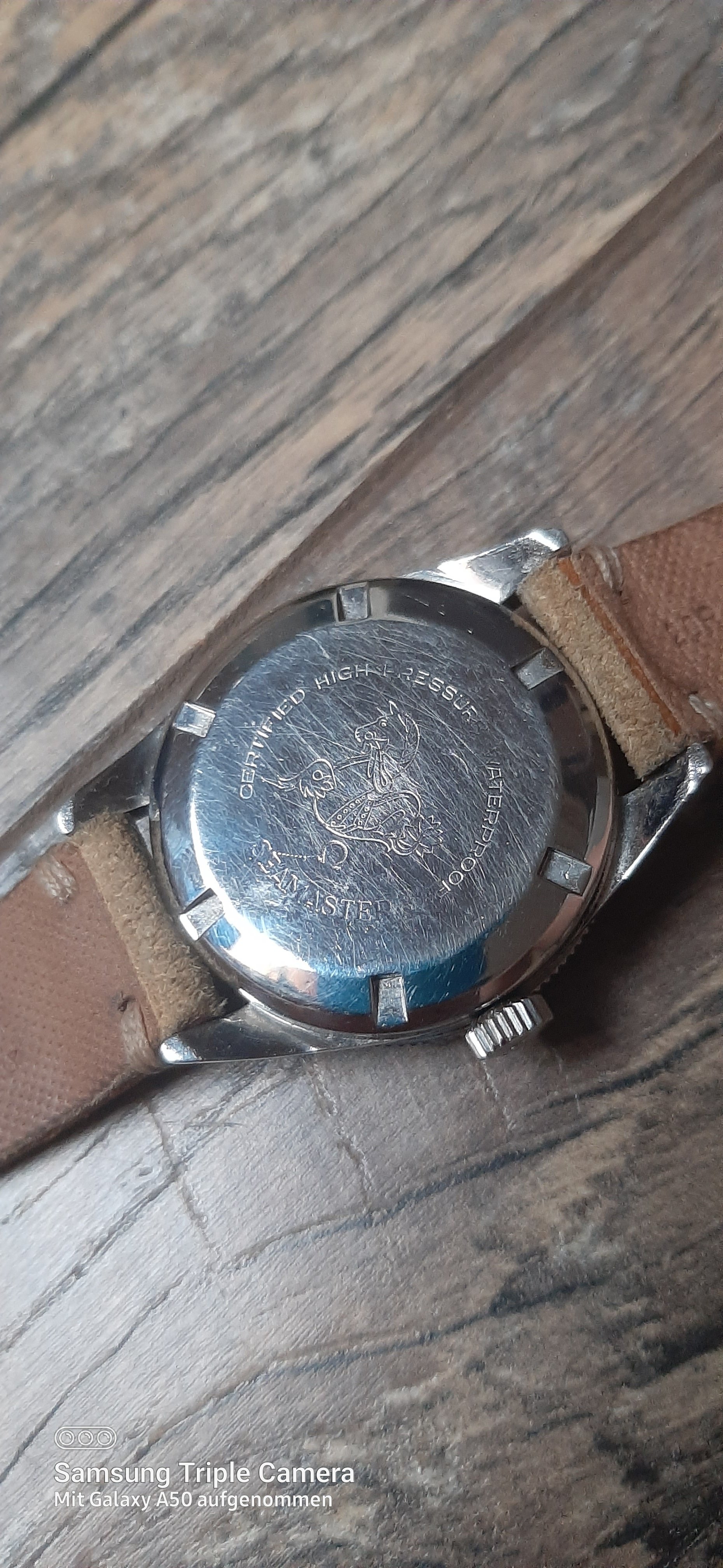

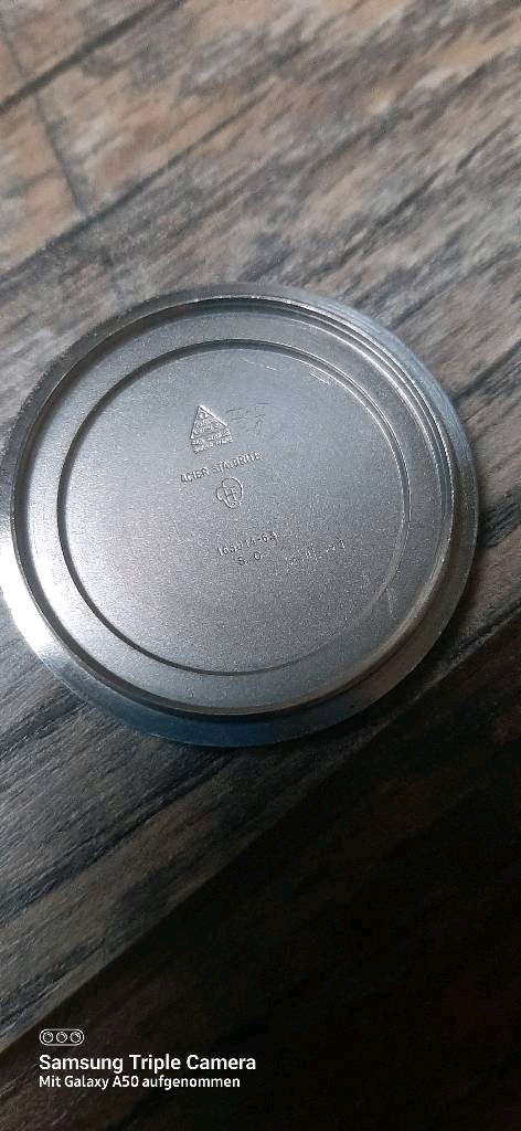

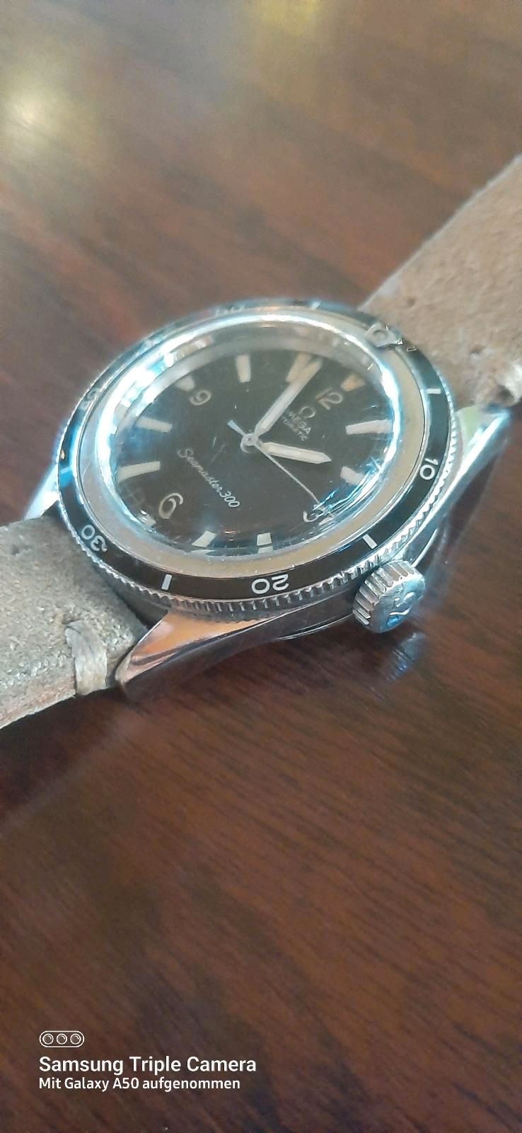

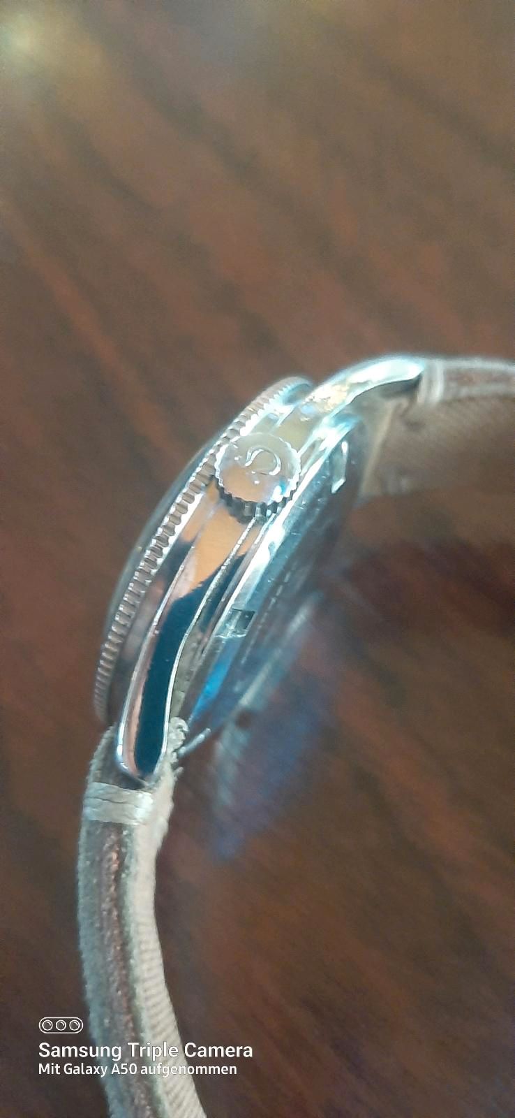

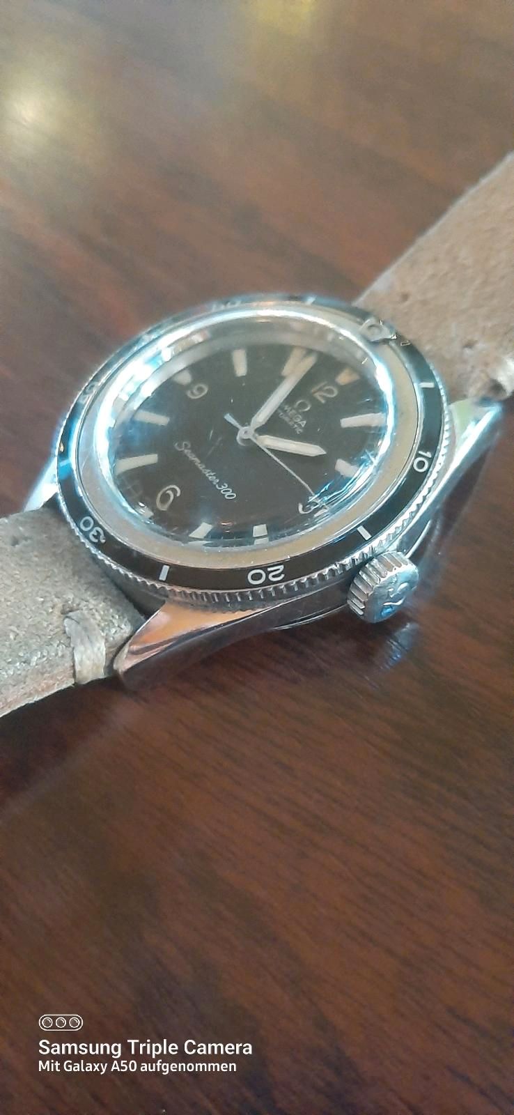

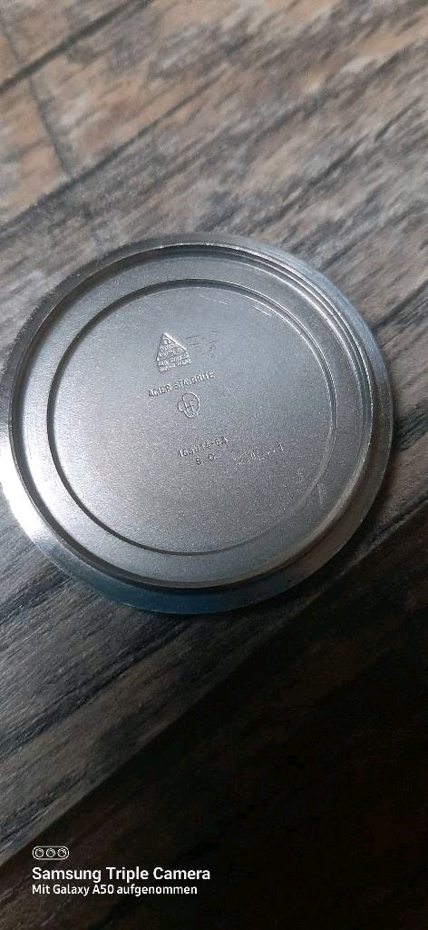

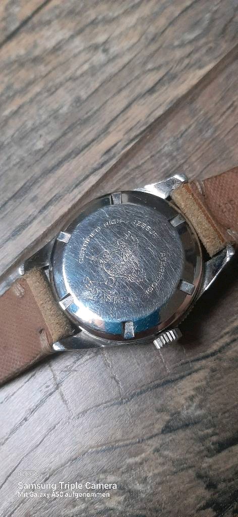

He sent me the other fotos with higher resolution now. I try to explain what I want to see.

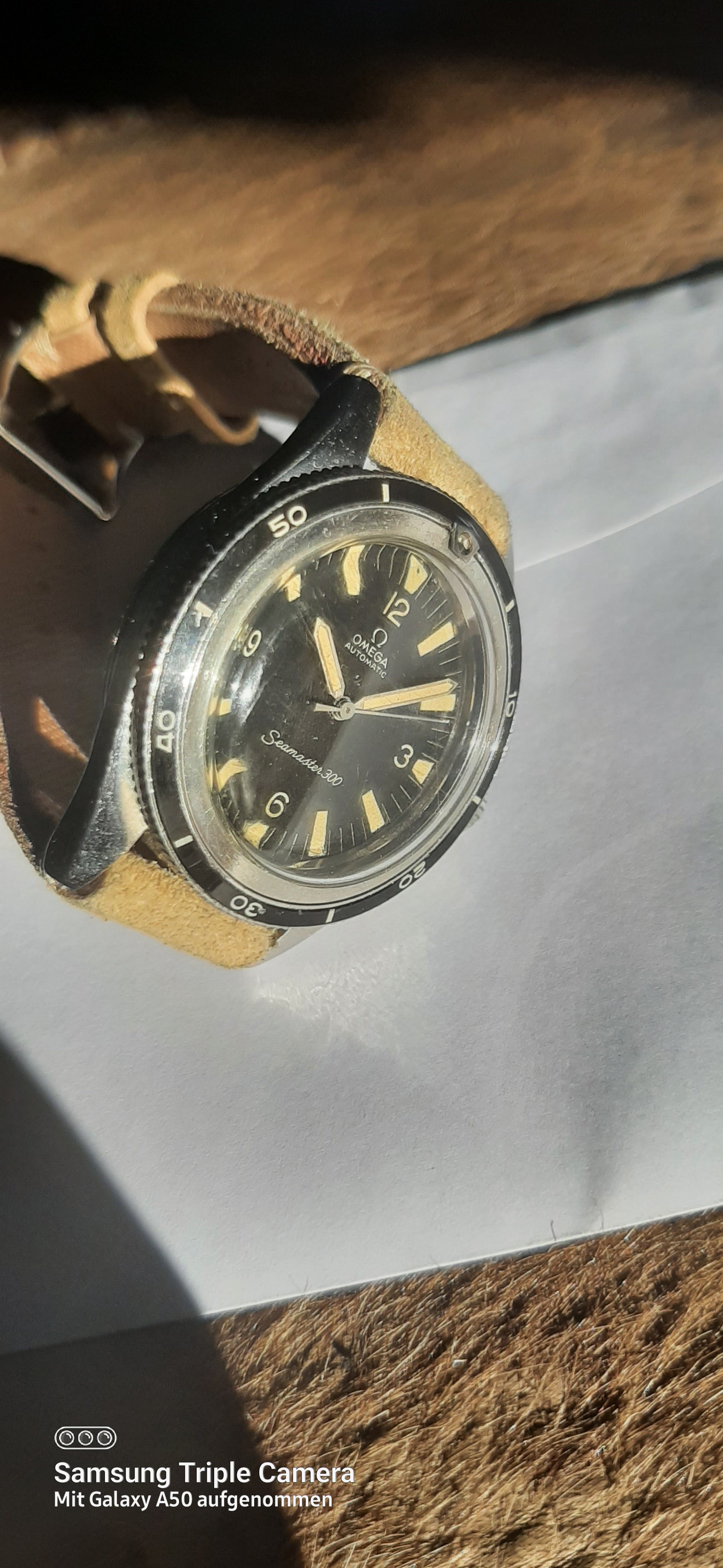

Looks nice and honest to me.. certainly worth considering at the right price.

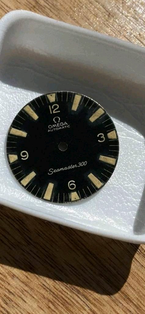

Looking at the dial: the ereas around the hour indices look to me like the dial has been relumed
Pinholes at 6 and 12 on a -63?

THX! Yes I think as well it is relumed. The color is way too nice and there is abrasion visible arround the indices.
We have to work with the fotos given by the seller...me too. What would be a fair price for both sides?

Again you cant see much from that photo.. certainly doesn’t appear ruined.

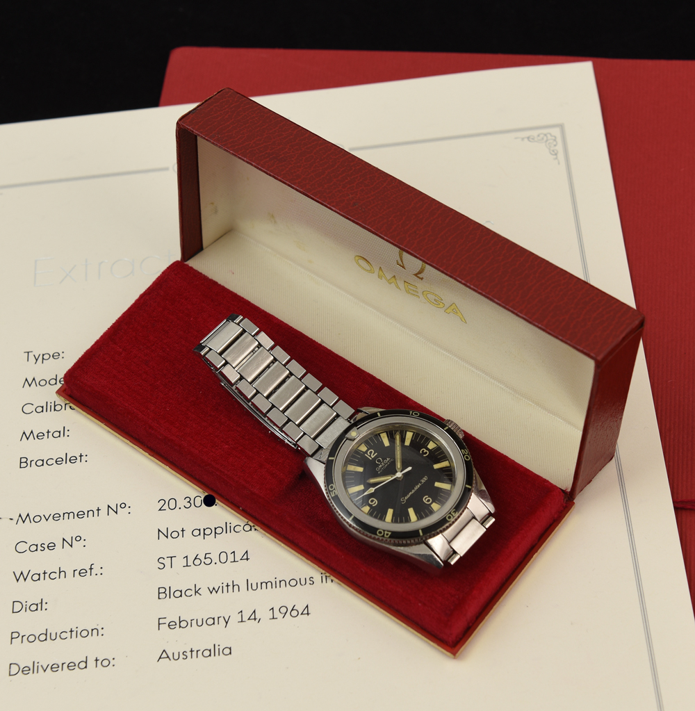

20.3 serial is early 1964.

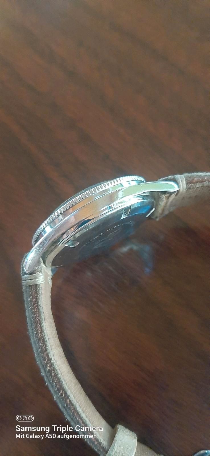

The bezel is not original. Looks like an aftermarket metal insert.
Sweep hand not original.
Dial lume cannot be determined based on these pictures.
Here's a perfect one from the same serial range for comparison.

Thank you all for your great help! Havn't bought this watch an look further.
@ndgal: special thx for the info about #203.... Do you think all 203 are made in 64, so I need to have a look to max serial# 202?
