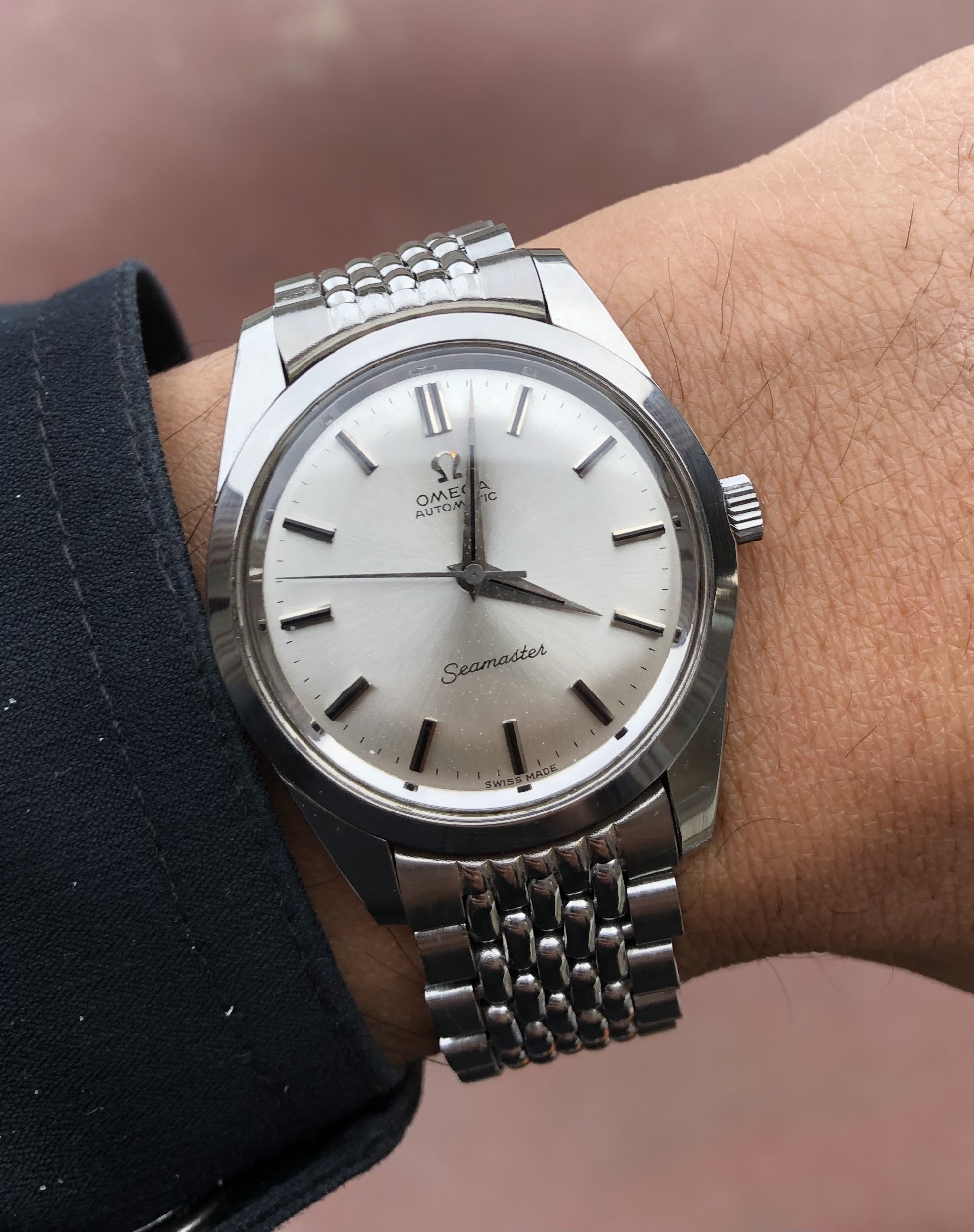

1502, 1036, 8220 or 3010 are the bracelet references that’ll work for your watch. They all look basically identical.
1,306
5,826
Here is mine with a 1502 bracelet and unnumbered end links.

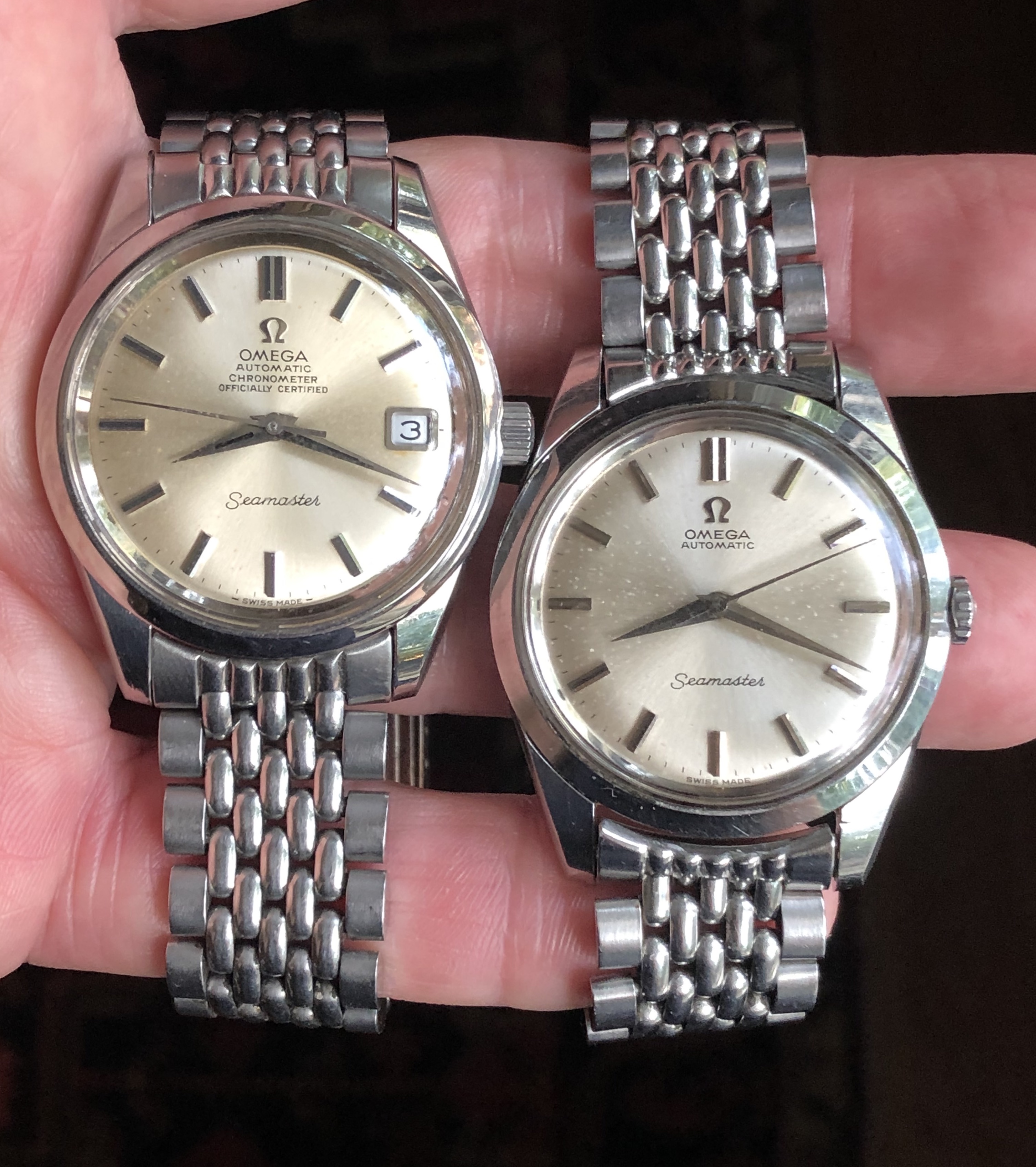

When your watch was new, it probably had #11 links on it. 511 is later, and there can be differences in vintage vs new examples.
In this pic of my two 166.010 watches, the end links have a folded lip on the top "inside" of the end link. Later versions omit this lip. For that reason, if historical accuracy is your goal, then you want vintage #11.
For steel bracelets, don't be afraid to get it refinished if it's in crappy condition. Mine above was refinished, and the case gently touched up. I am a firm believer in "life's too short to wear a crappy-looking watch", but others seem to value the life it's led and the markings to show for it. Always up to you which path you want to take.

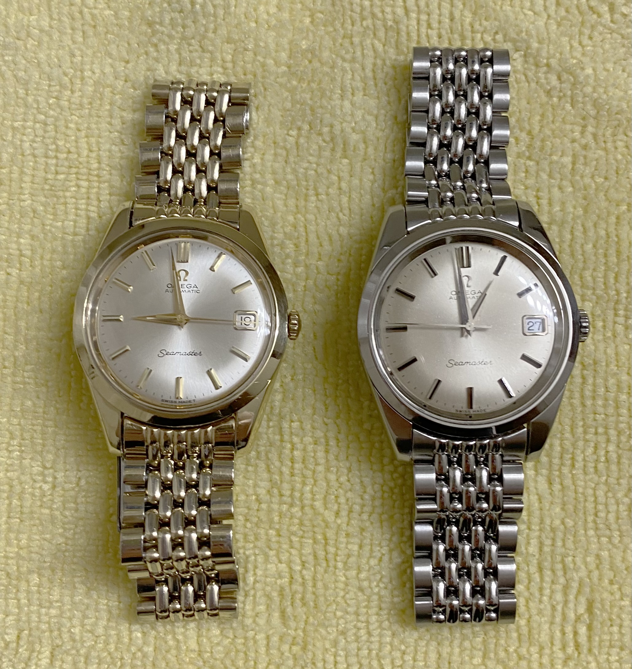

Date and no-date versions with #11 end-links. But I wouldn't hesitate to use 511 endlinks. Perhaps the OP can contribute some photos as well.
