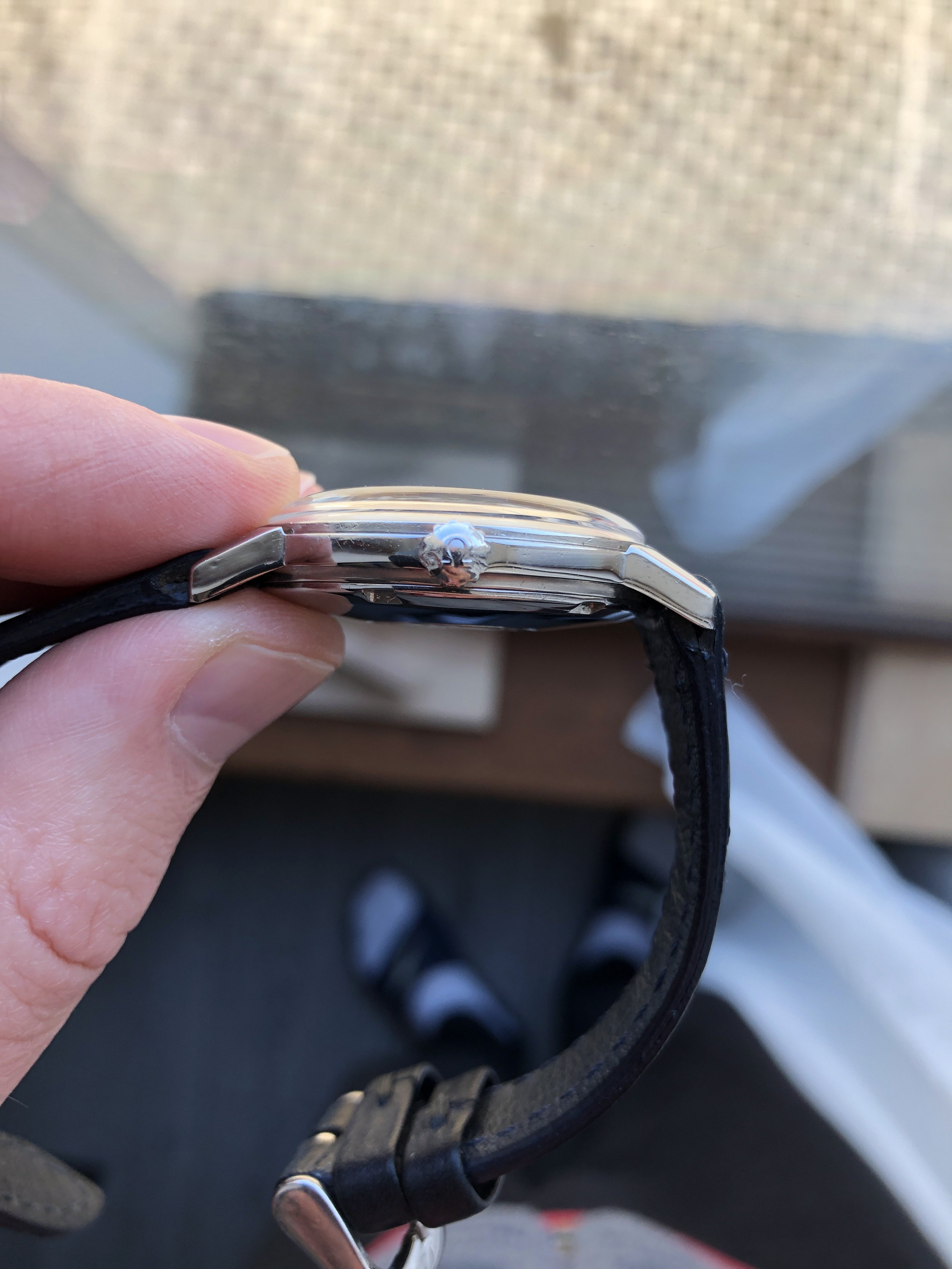

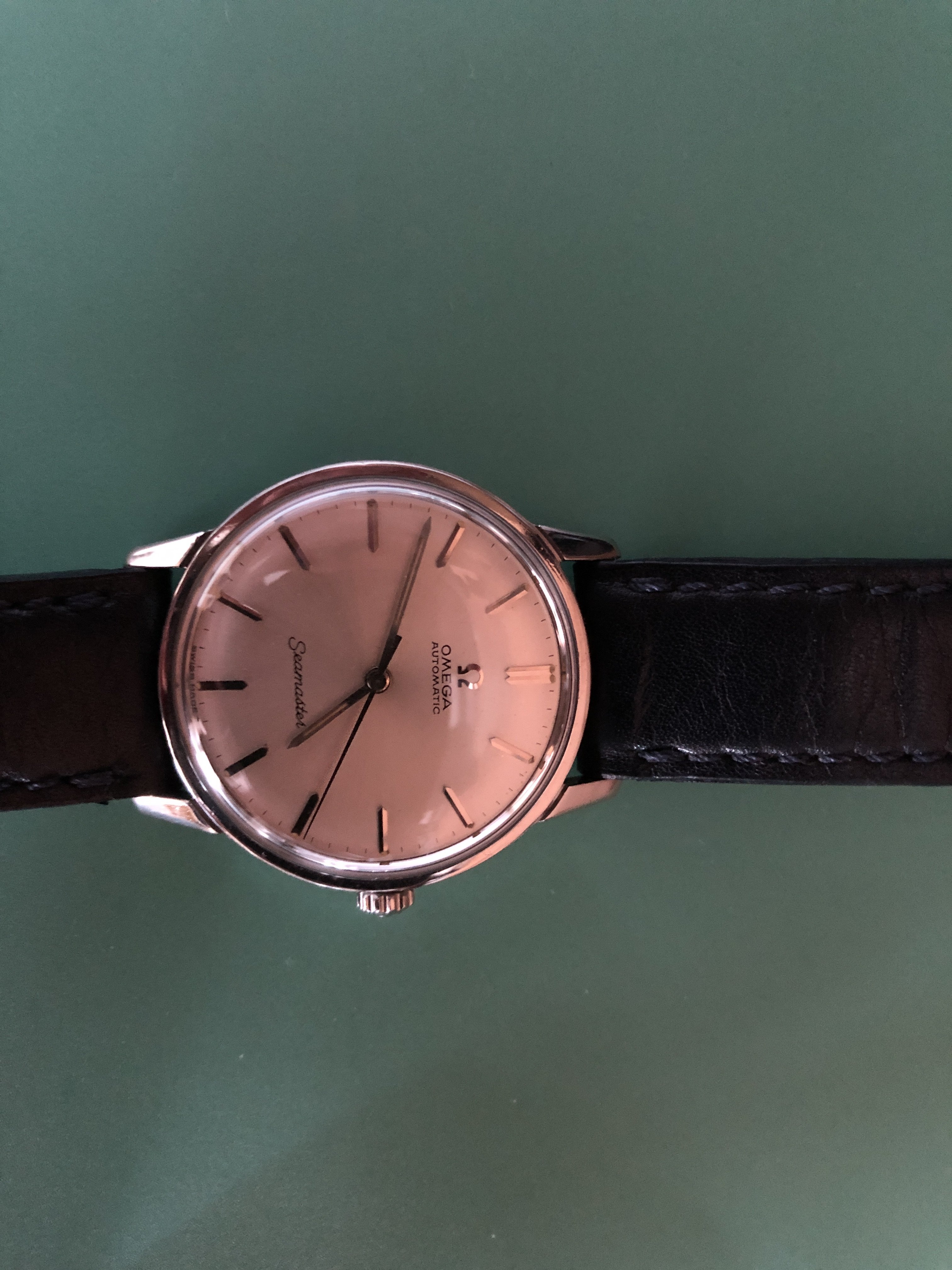

I want to replace the crown for my Seamaster 165.002 because it has a nasty ding.
This is the crown that is on the watch. It's like a star with 12 edges.

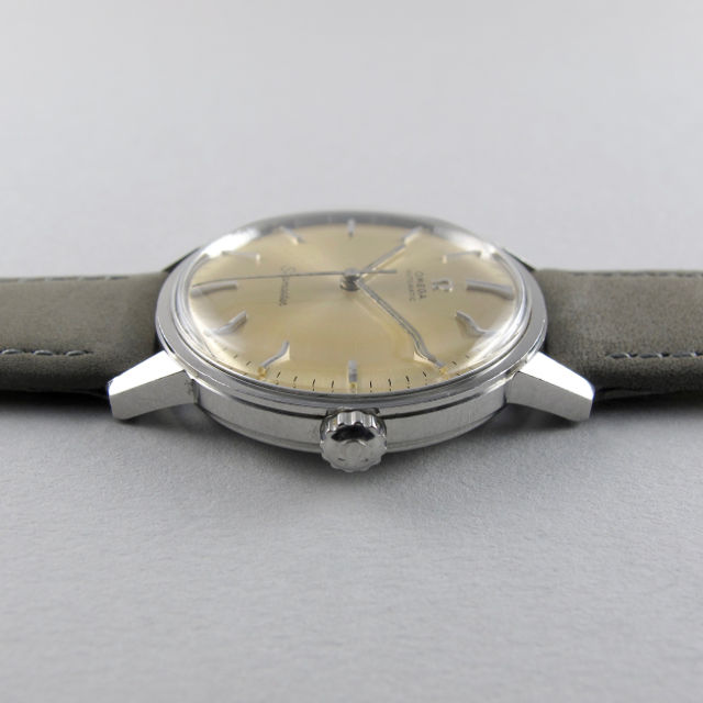

I'm pretty sure it's the crown that came with the watch because I saw it on various posts from the internet like the ones bellow:

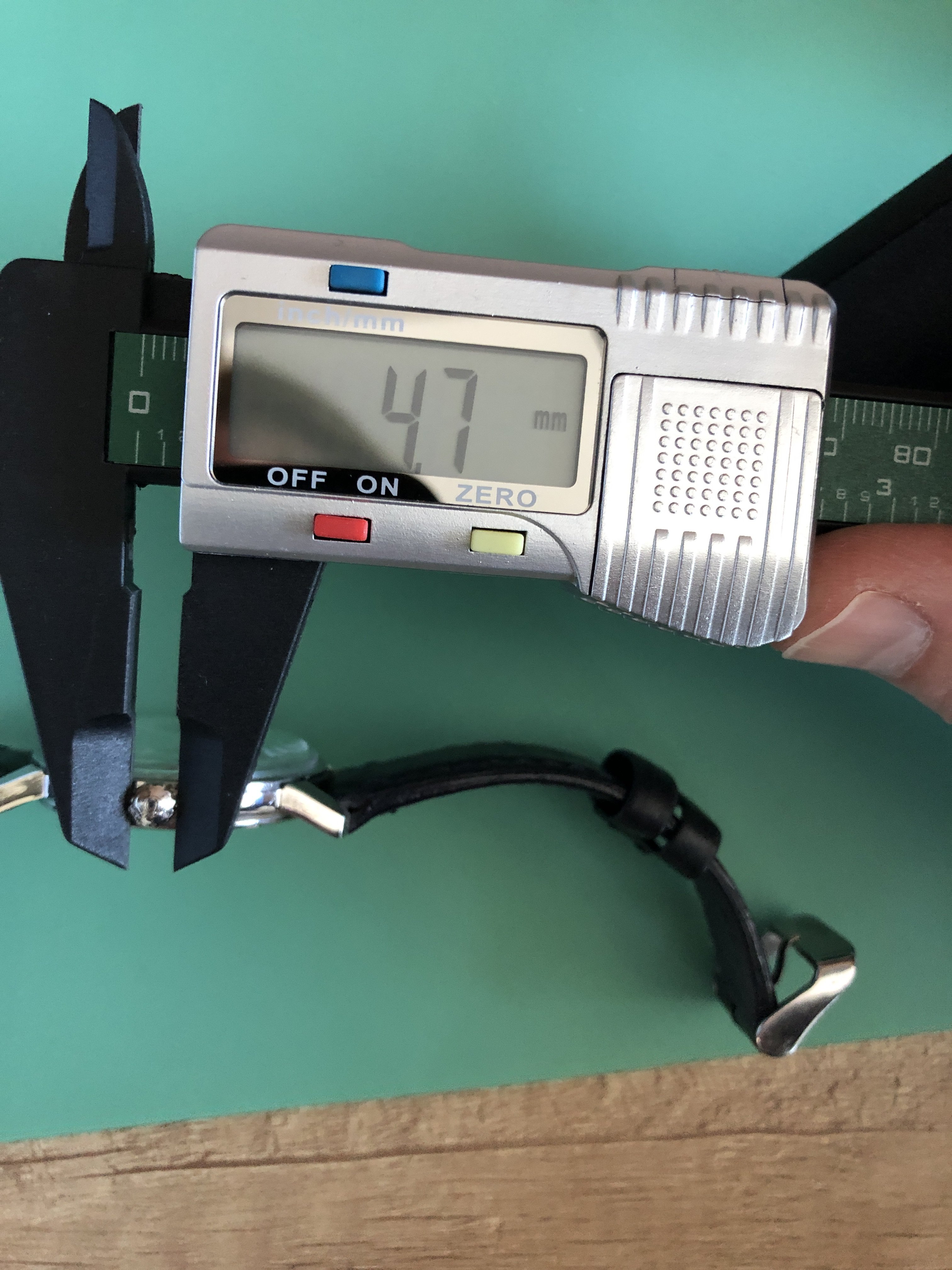

My issue is that when I measured the crown the diameter is 4.7mm.

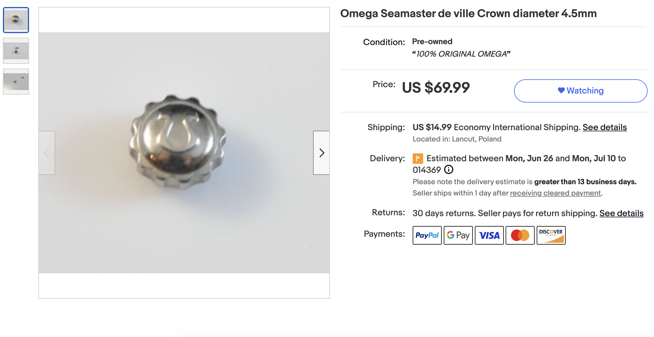

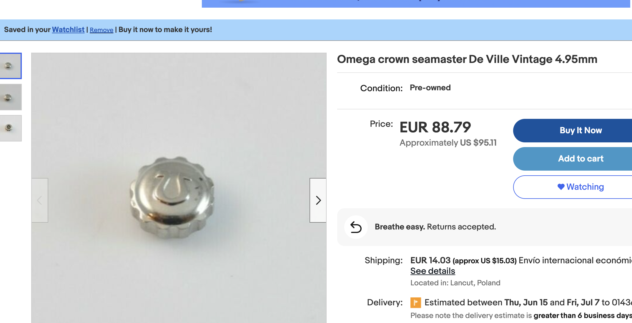

When I searched on ebay for something that looks similar at least in appearance I only find 4.95mm and 4.5mm.
https://www.ebay.com/itm/255217332598
https://www.ebay.com/itm/255901778817
Am I missing something? I am searching for the right thing? Or should I look somewhere else?

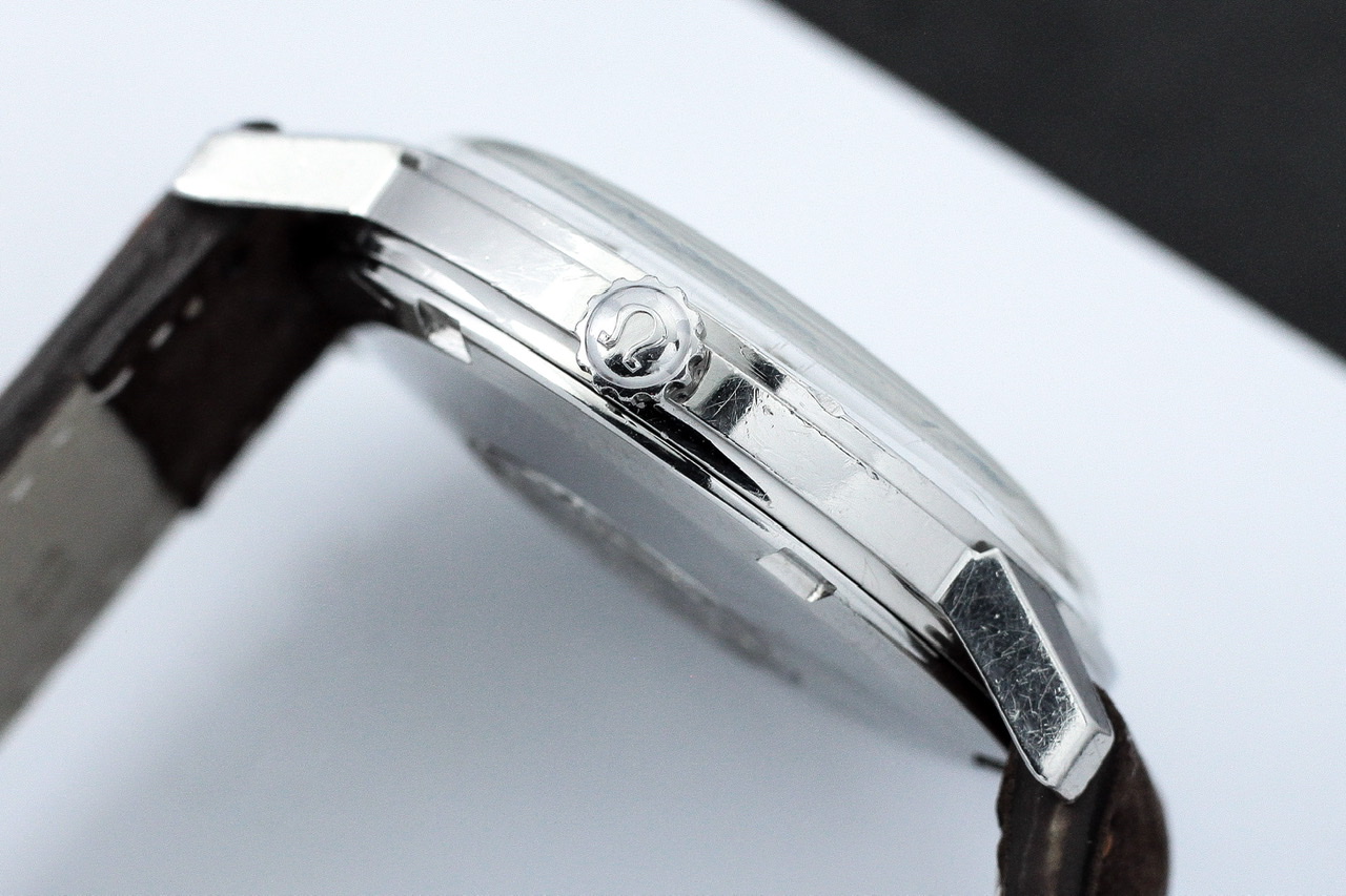

@rendo I saw that one, but honestly I haven't seen any Seamaster that looks like mine equipped with that model.
I also have a 166.002 and has exactly the same crown as the 165.002.

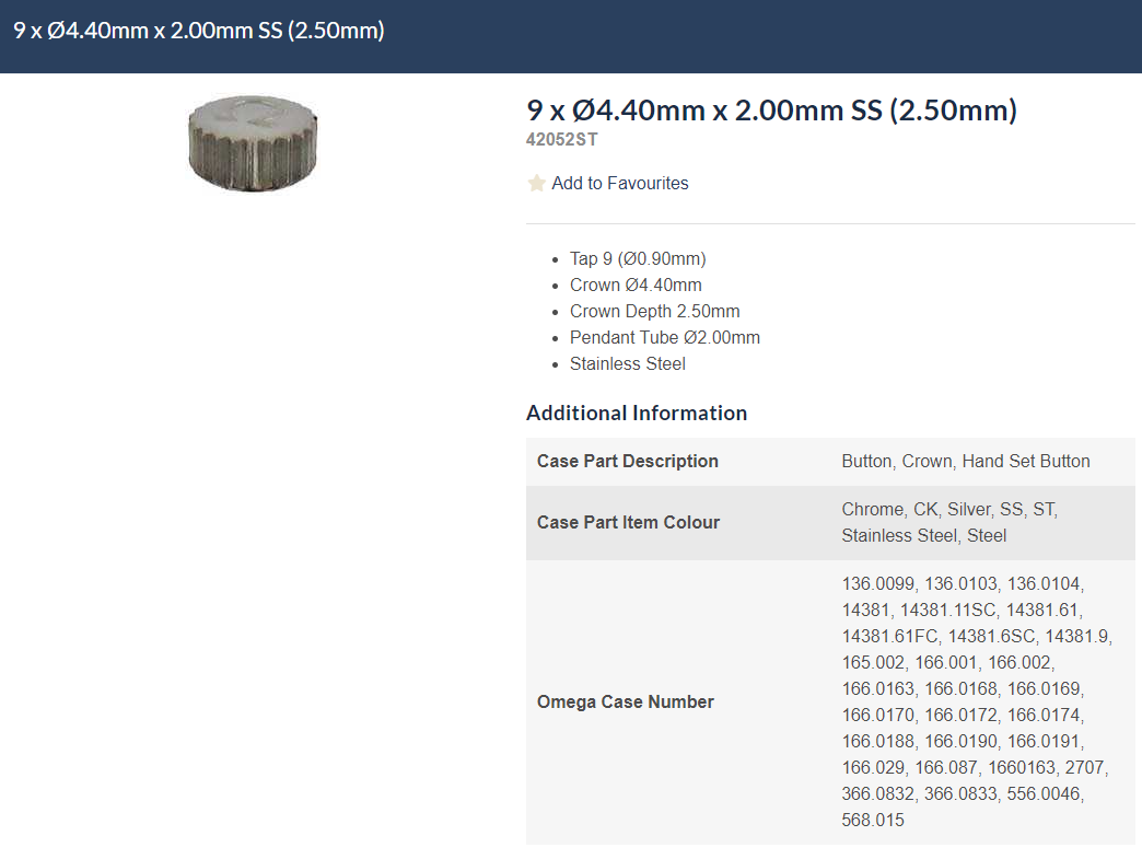

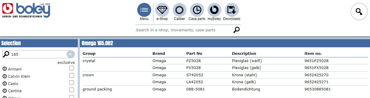

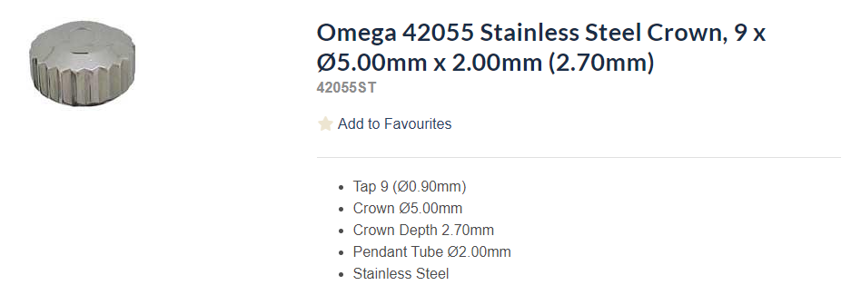

That's interesting. Boley also lists 42052 as the right crown for 165.002:

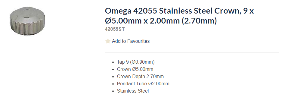

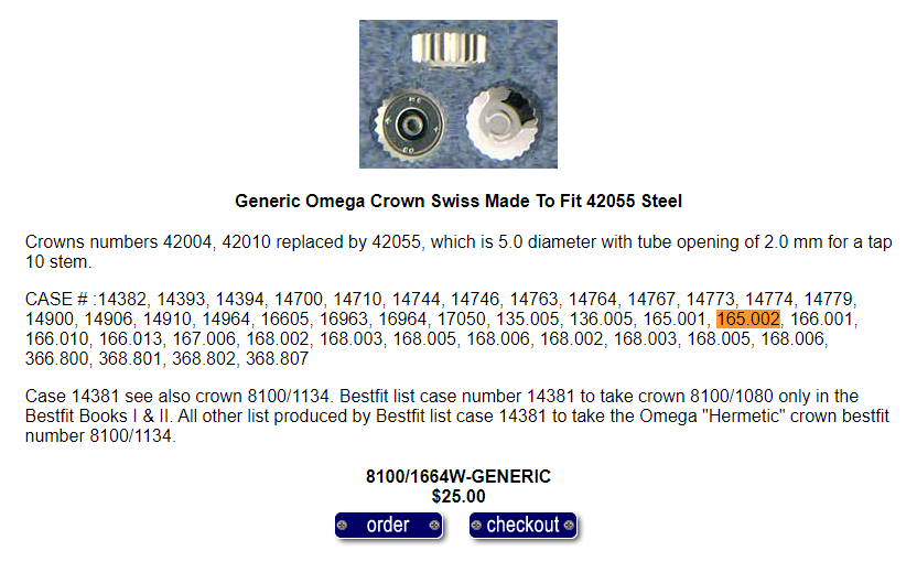

However, Ofrei shows 42055:
42055 details from cousins:
Hopefully someone with access to the Omega parts catalogue can provide the official answer for us.
13,555
23,503
They’re the modern service crowns. Different from the original vintage items.
