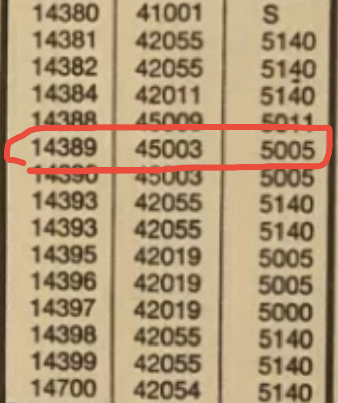

Out of curiosity @Archer , has the part number (or the part) changed? This is from the list I use (and that can be found somewhere here in the forum):
Not trying to disagree with you, just interested where the difference comes from. 馃榾

This is what Omega lists on the Extranet - no idea why your list has something different.
So this is what Omega calls out currently:
063PZ5007 | GLASS PLEXI ST RING D31.62 H5.1
This is what you had stated above was the right crystal:
063PZ5011 | GLASS PLEXI ST RING D31.62 H5.2
But that is actually for the case reference above the one asked for, so this is the correct one per the list:
063PZ5005 | GLASS PLEXI ST RING D31.62 H4.6
They would probably all work.
