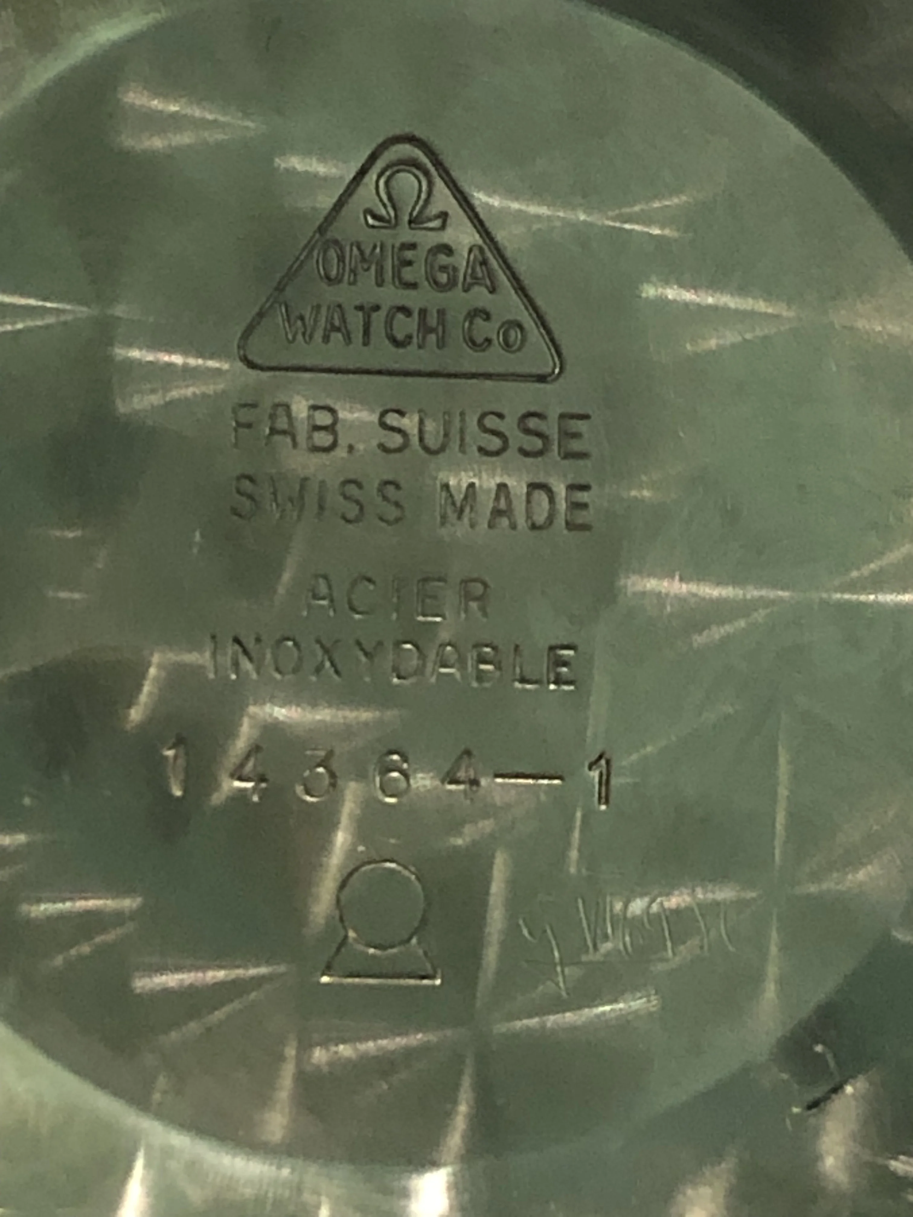

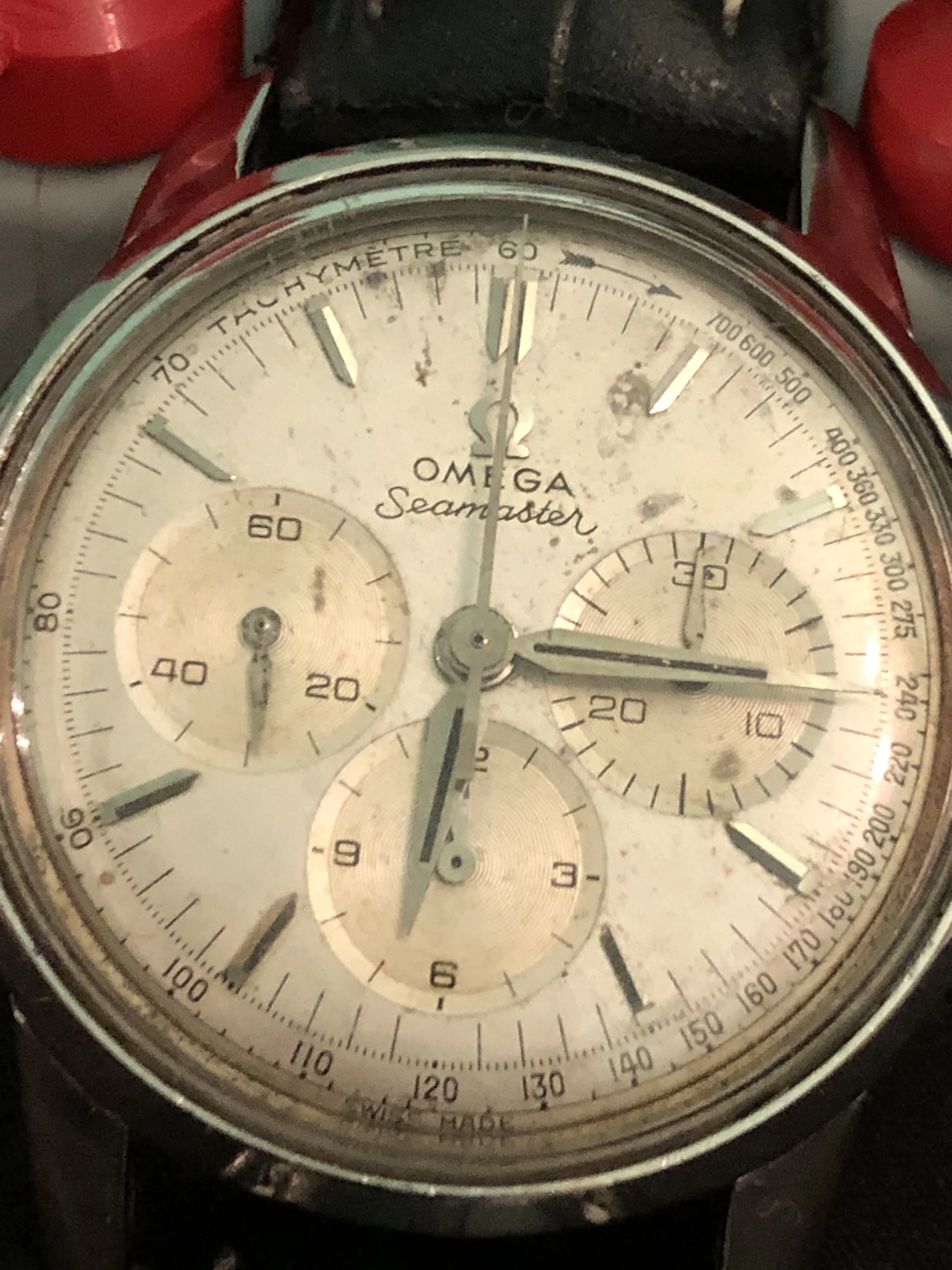

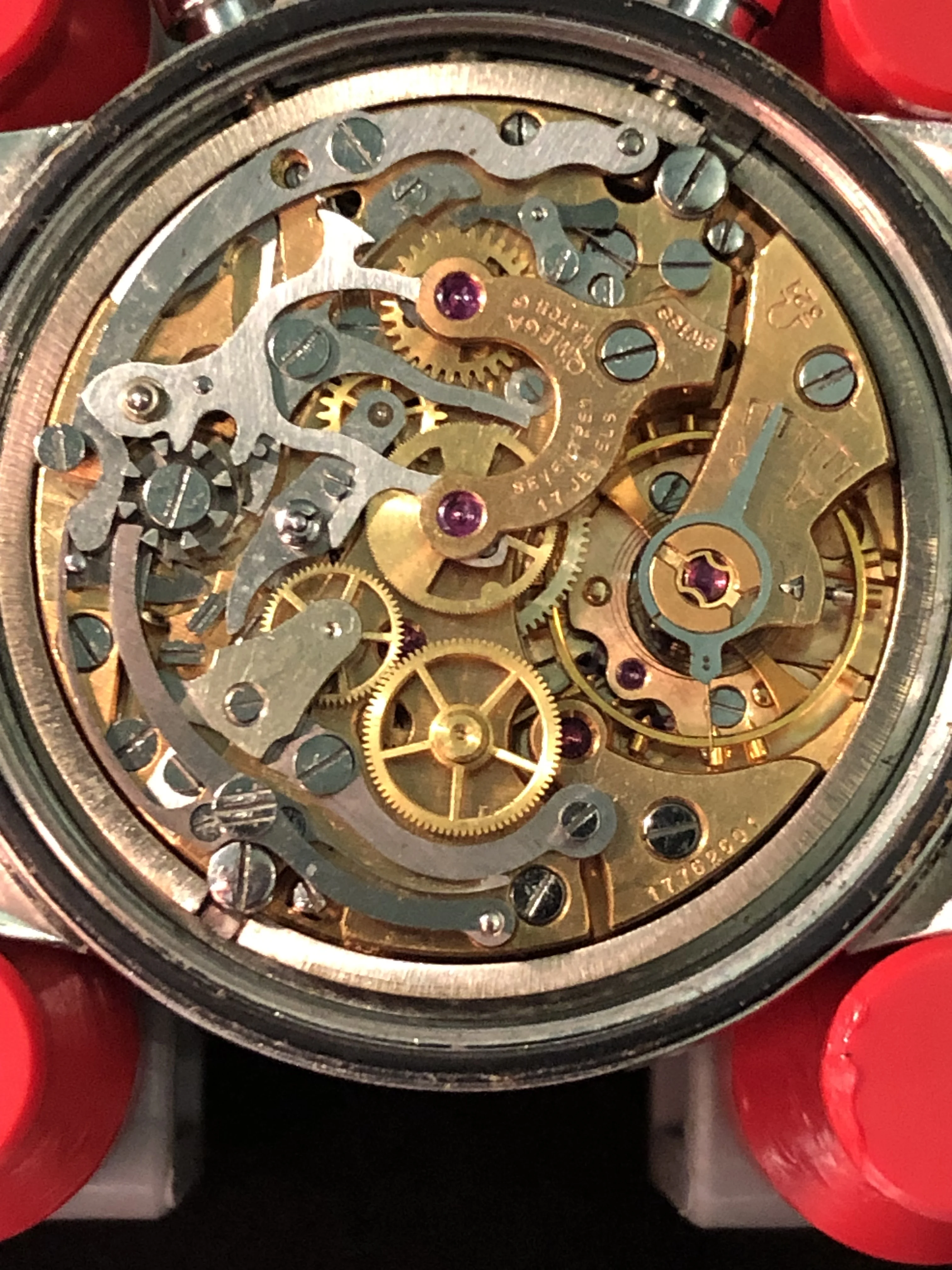

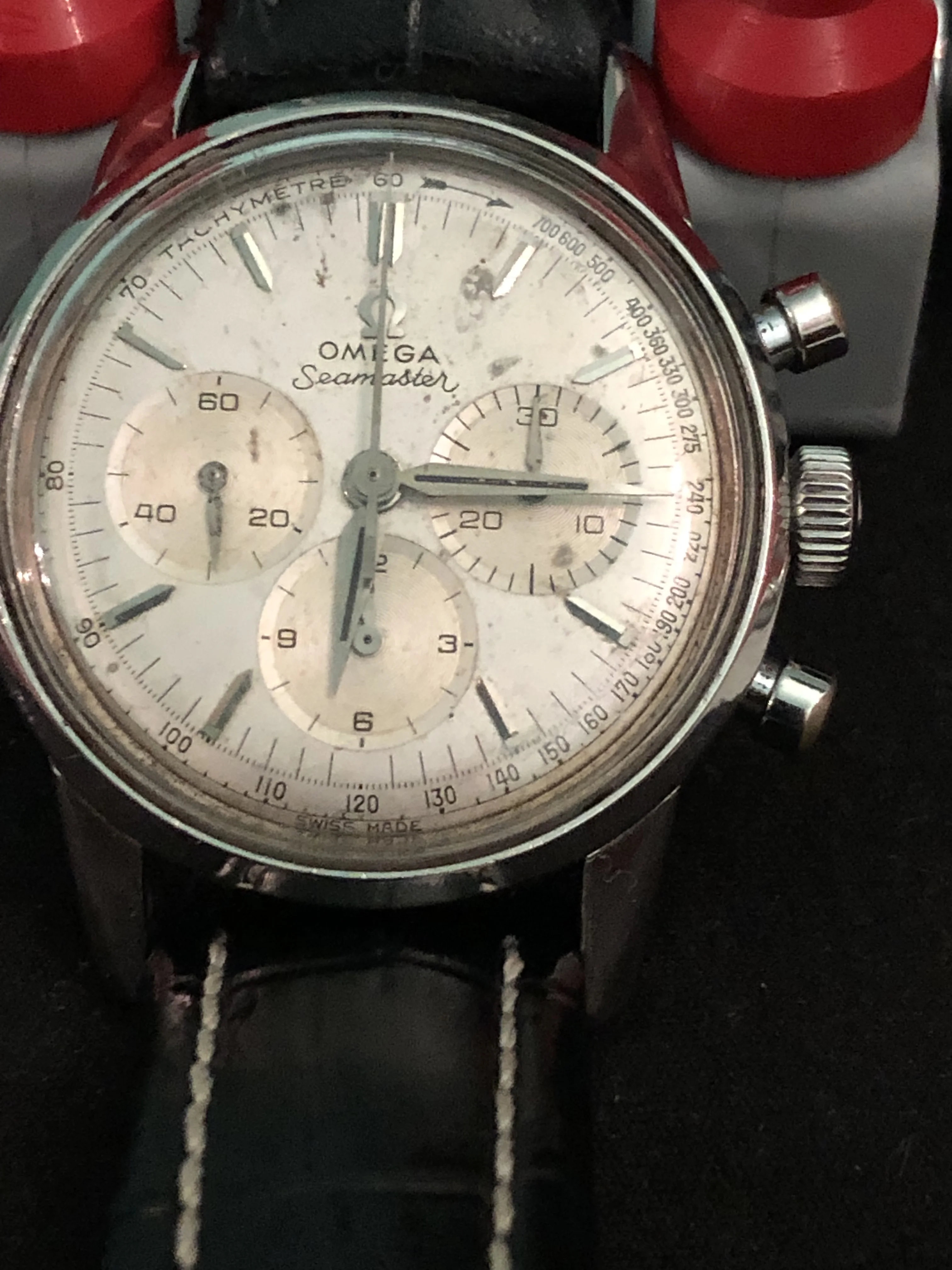

Hello there members , my another seamaster , 143.64-1 here , I installed new complete balance I purchased many years ago , hairspring was damaged , I got nos one, still have the old wheel , also I posted before the other one , 143.64-61 that I have, they look the same ,only why the one has , -1, the other -61, ?? , this one is in untouched original condition , with poorly aged dial , I got the balance for $300 and installed it myself ,runs ok, was it worth the fix ? , and is it possible to find just the hairspring as the balance wheel and staf is perfect , opinion please, what you think about overall condition of it , thank you , best regards to all , good day, kazd

The hairspring and balance wheel are carefully matched at the factory. Hairsprings are not generally properly matched to an orphan balance wheel. You can try, but expect it to not be a simple swap.

The first version of the 320/321 regulator arm touches the overcoil at a different location than the later version.

you will need a dedicated timegrapher if you are doing any meaningful time regulation. One with an articulating arm, is also important to properly regulate a watch.
You can drop in a newer service balance into an early 321 and it will run, but you will likely find yourself needing to max out the regulator toward the "R" and even still might not be able to achieve a correct rate.
I don't want to be discouraging but I would recommend learning/practicing on something other than 320/321 caliber. Any mistake will be quite costly, and there are a lot more opportunities to make errors. 200-500 series is a great place to practice getting down time properly cleaning and regulation, along with the process of sourcing old parts individually, or from donor movements.
Making a error like bending the forth wheel on a 321 from un/install could be a magnitude order of cost increase on price vs something like a 286 movement.

The 321/320 has a singular regulating arm but there is an early and later version of the regulating arm. The regulating pins are located in a different position relative to the center of the balance cock tick marks. Hence, when installing a more modern 1327 balance complete into an older 321, you will find yourself maxing out the regulator in the 'R' direction. Adjustments are needed to have the regulator pin centered.
