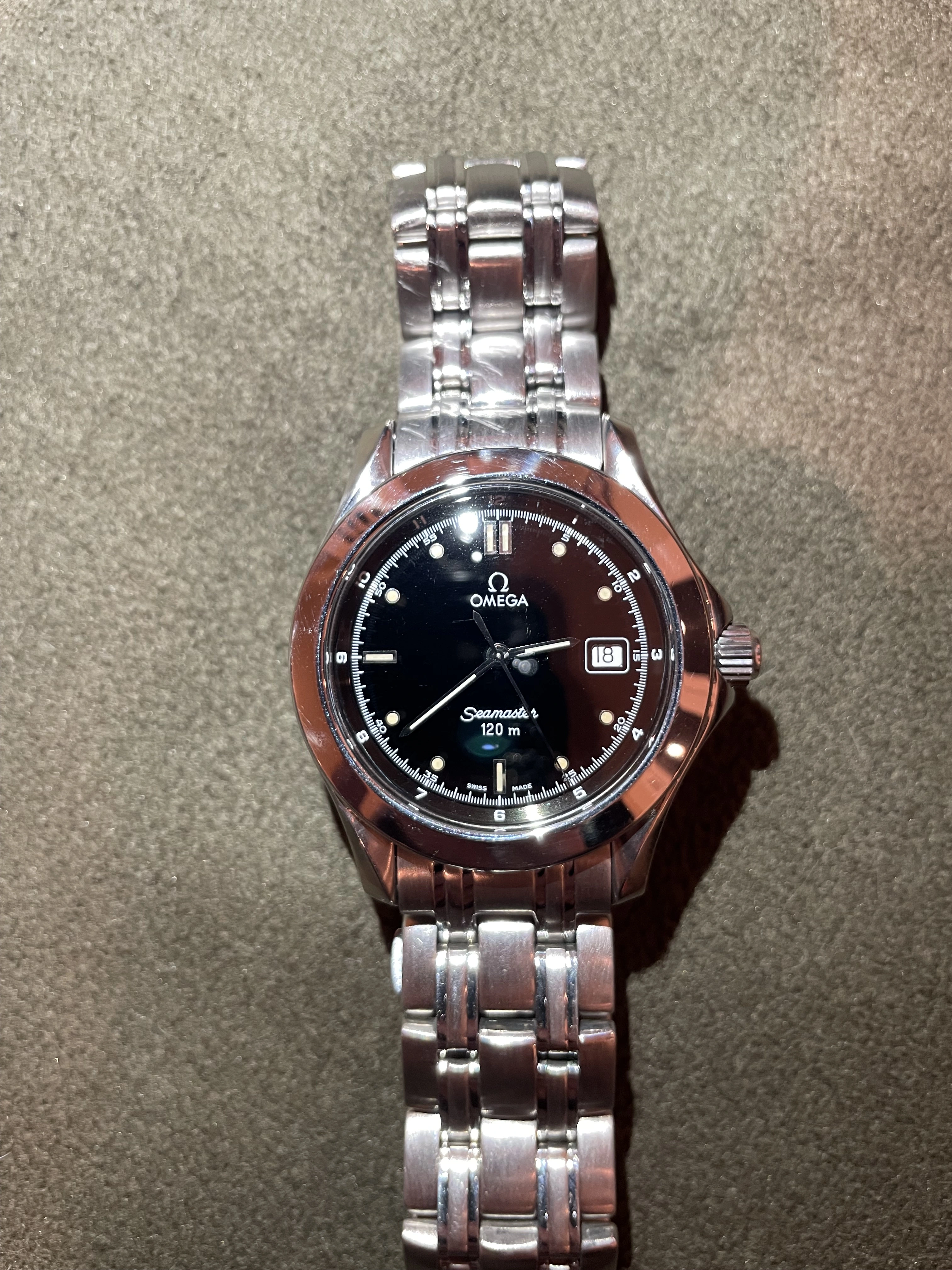

Hey guys, I have a Speedy Pro Hesalite that I wear every day except for when I go swimming or skiing. I wanted an Omega that was affordable, but would be more water resistant than the speedy and something that I wouldn’t worry about taking on ski trips, so I just purchased a quartz Seamaster 120m 2511.50. I have 30 days to return this and so far I’m super happy with the cosmetic condition of the watch, but I have a couple questions regarding the movement.

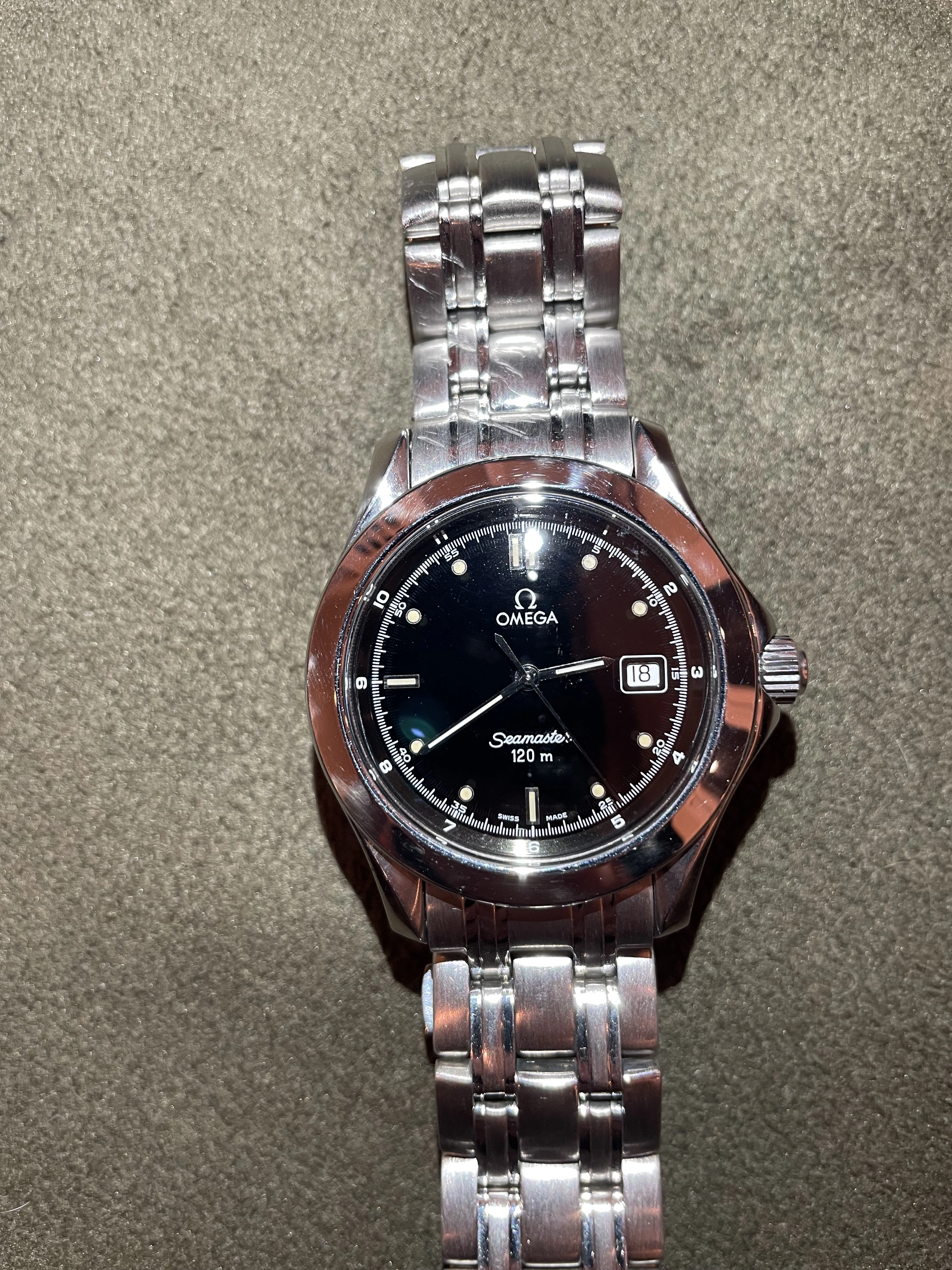

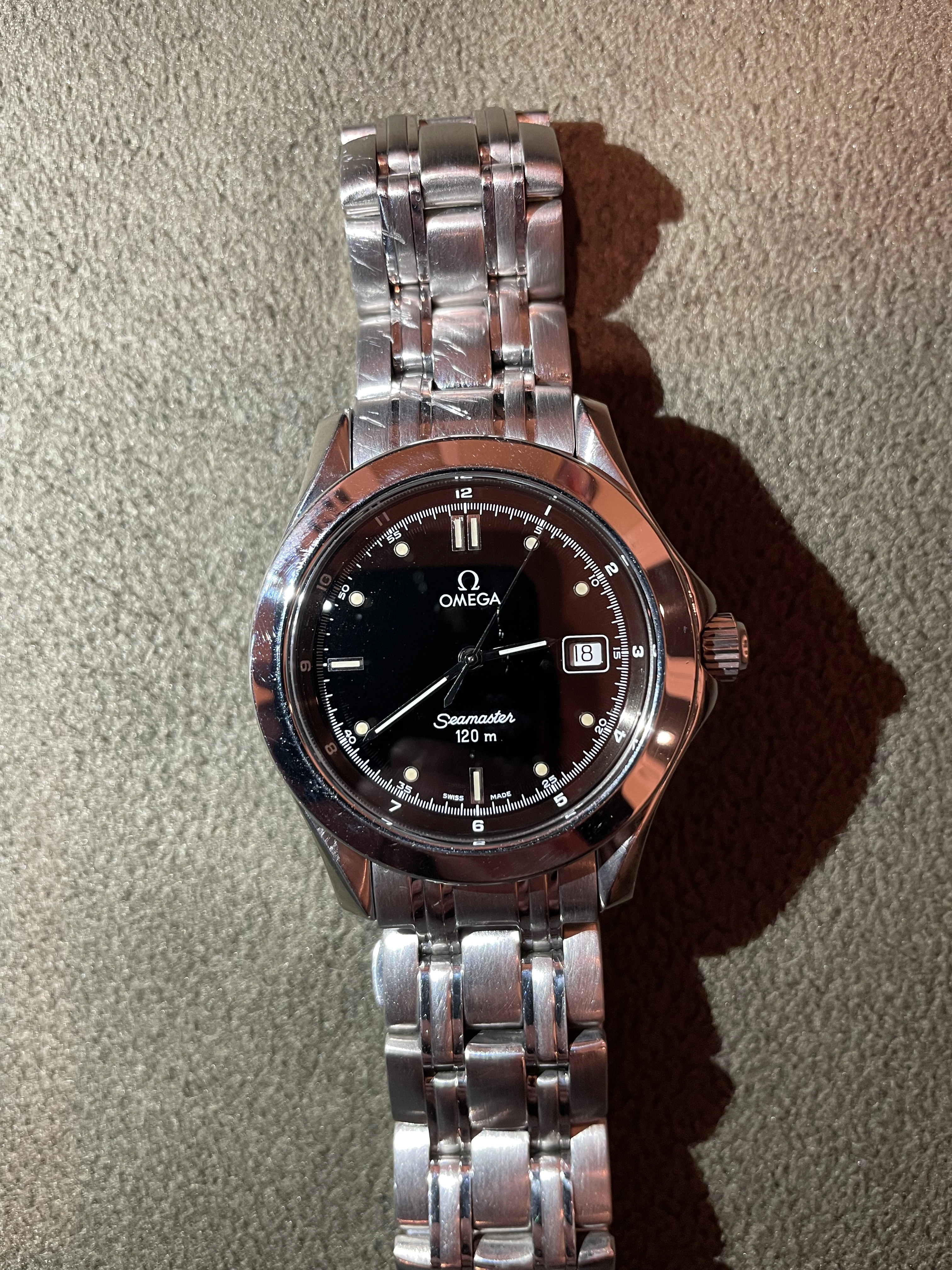

1) The seconds hand does not align with the seconds markers. I’ve attached some pictures of this misalignment but it can be up to almost half a second off on certain markers around the dial. Looking at some other images of this watch on Google tells me this is probably normal, but what are your thoughts on this? The watch does keep good time from what I can tell so far.

All sounds fairly normal but I would take the precaution of getting that pressure tested for water resistance. It is now a ~25-30 year old watch.

Thanks for letting me know! And yeah, this one is from 1993 so I was planning on getting it pressure tested before doing any kind of water activities.
