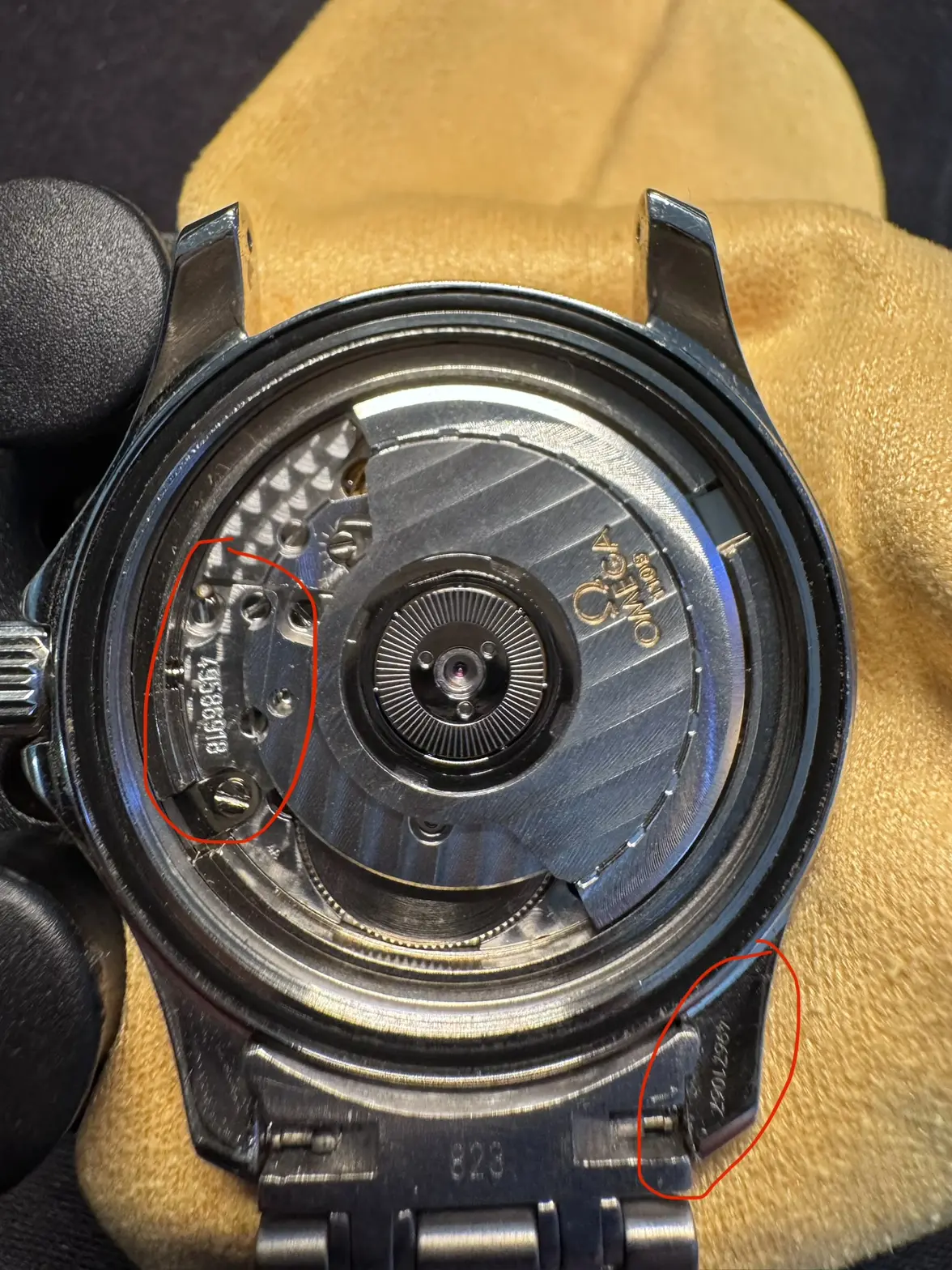

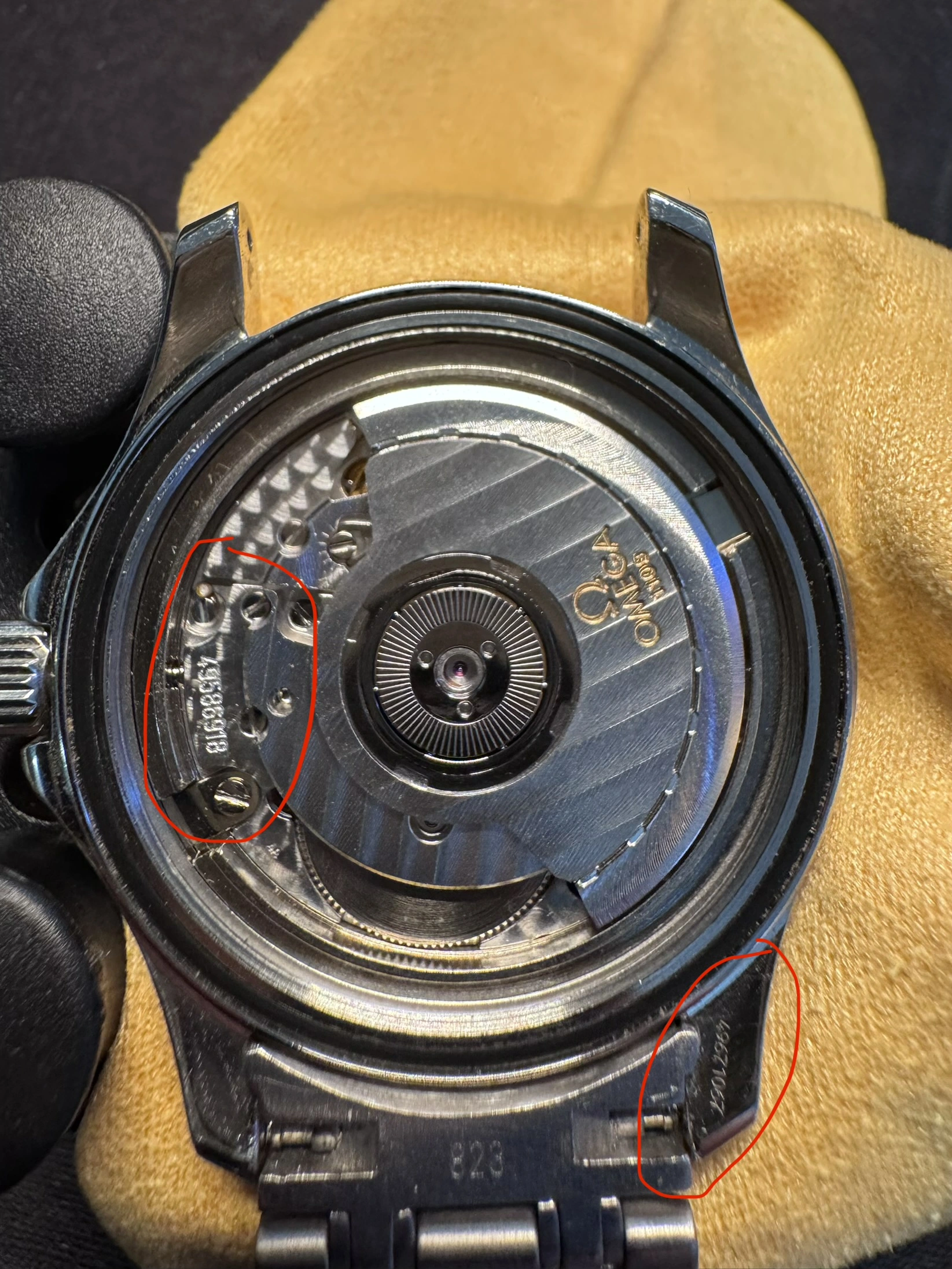

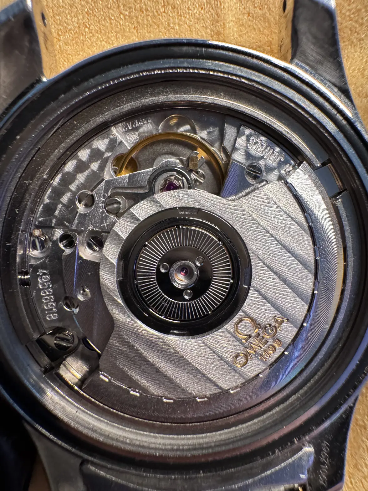

I just bought this omega seamaster 120 ref 2501.20.
I opened the case and check for series number today and found the mismatch! i trusted the seller so did not ask for movement serial number check, now i found this.
Is this a frankenstein watch ?

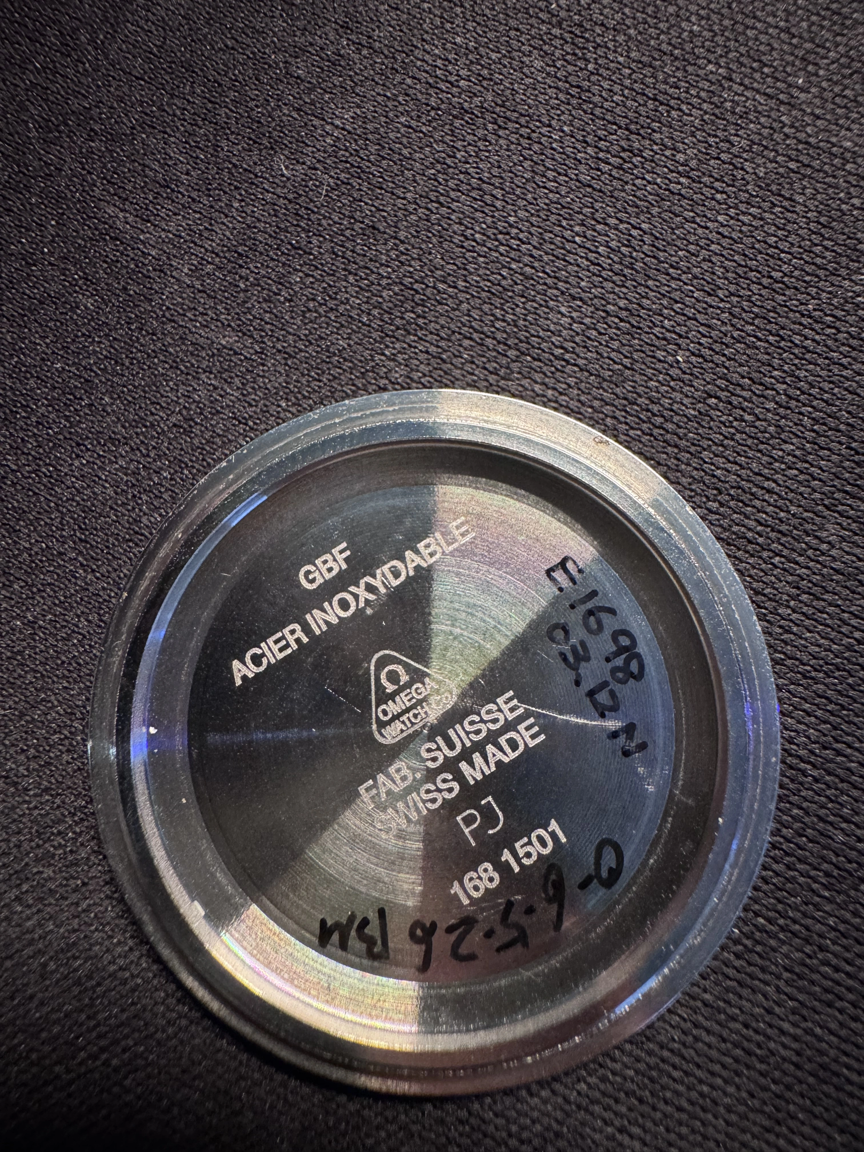

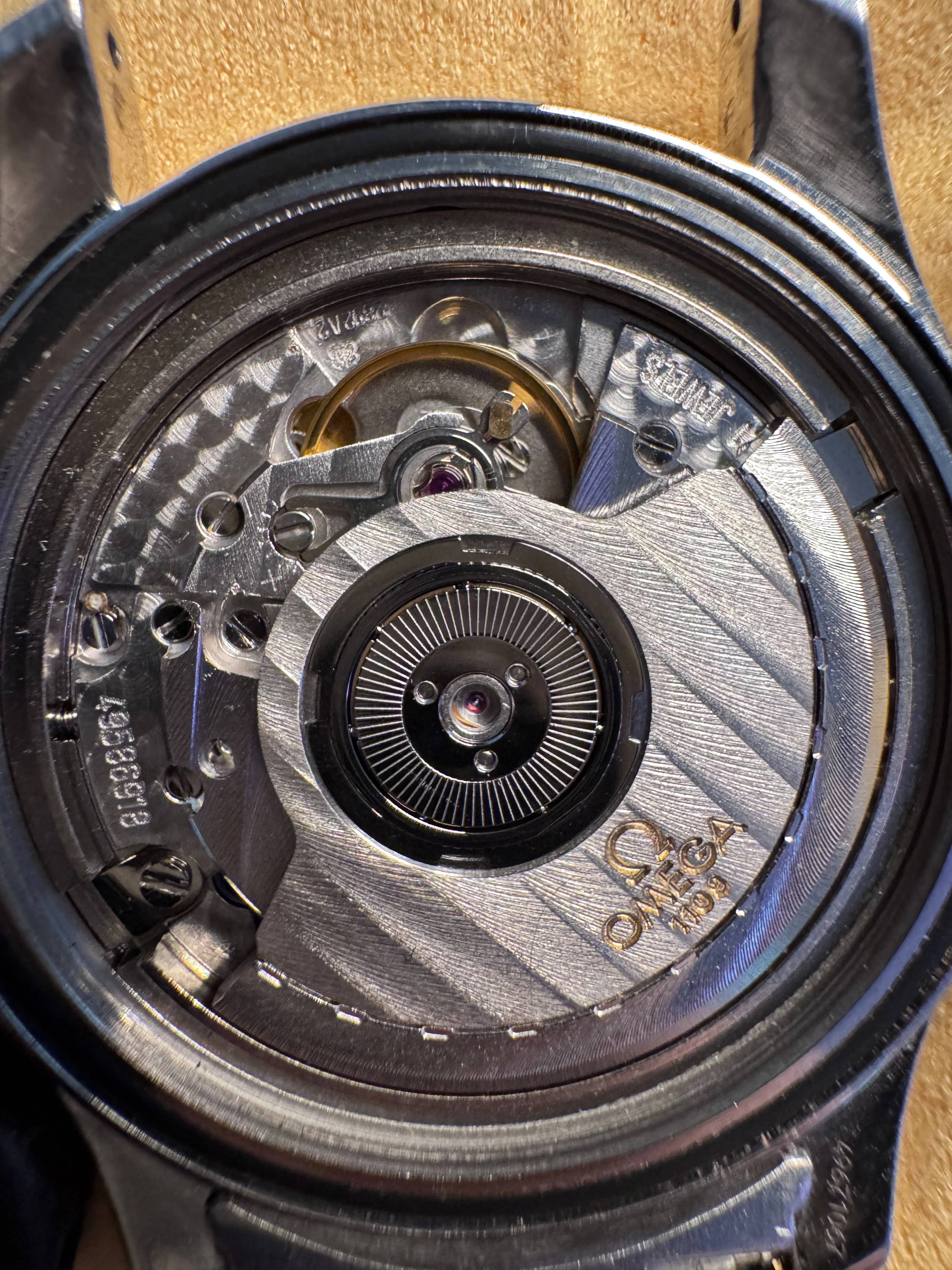

A few more pick on the case!
Please let me know what your guys thinking of this one ?

I would assume it had the movement replaced at some time in the past. A good seller would have disclosed the numbers don’t match and if they didn’t know, would offer to take it back.
Yes. The serial number on the movement is this:
Serial number: 49586918
Article ref: 25012000
This is the white dial version. The serial number on the case is this:
Serial number: 49671067
Article ref: 25018000
This is the blue dial version. So someone has swapped the entire movement, dial, and hands into a case from another watch.

Thank you so much!!
