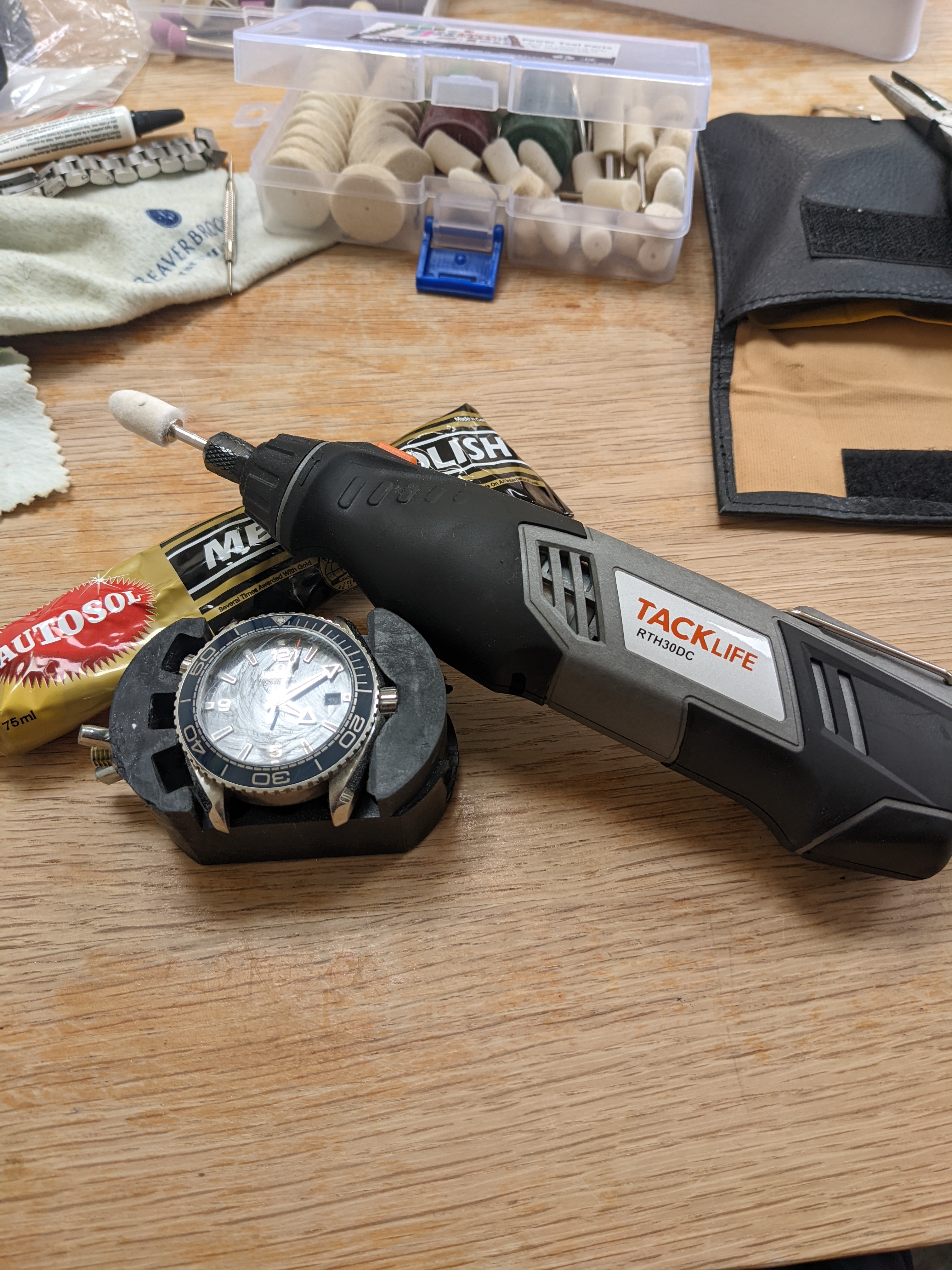

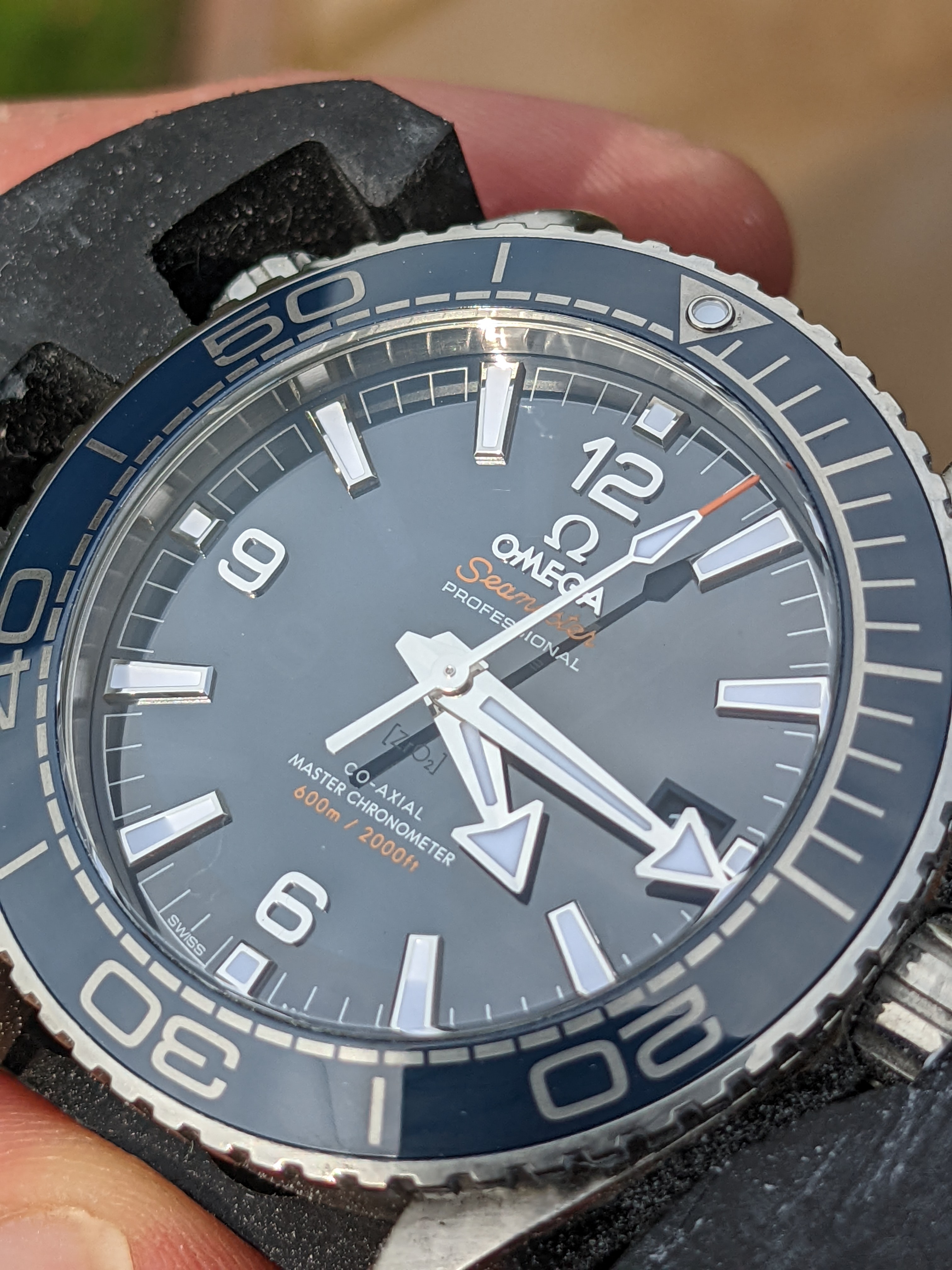

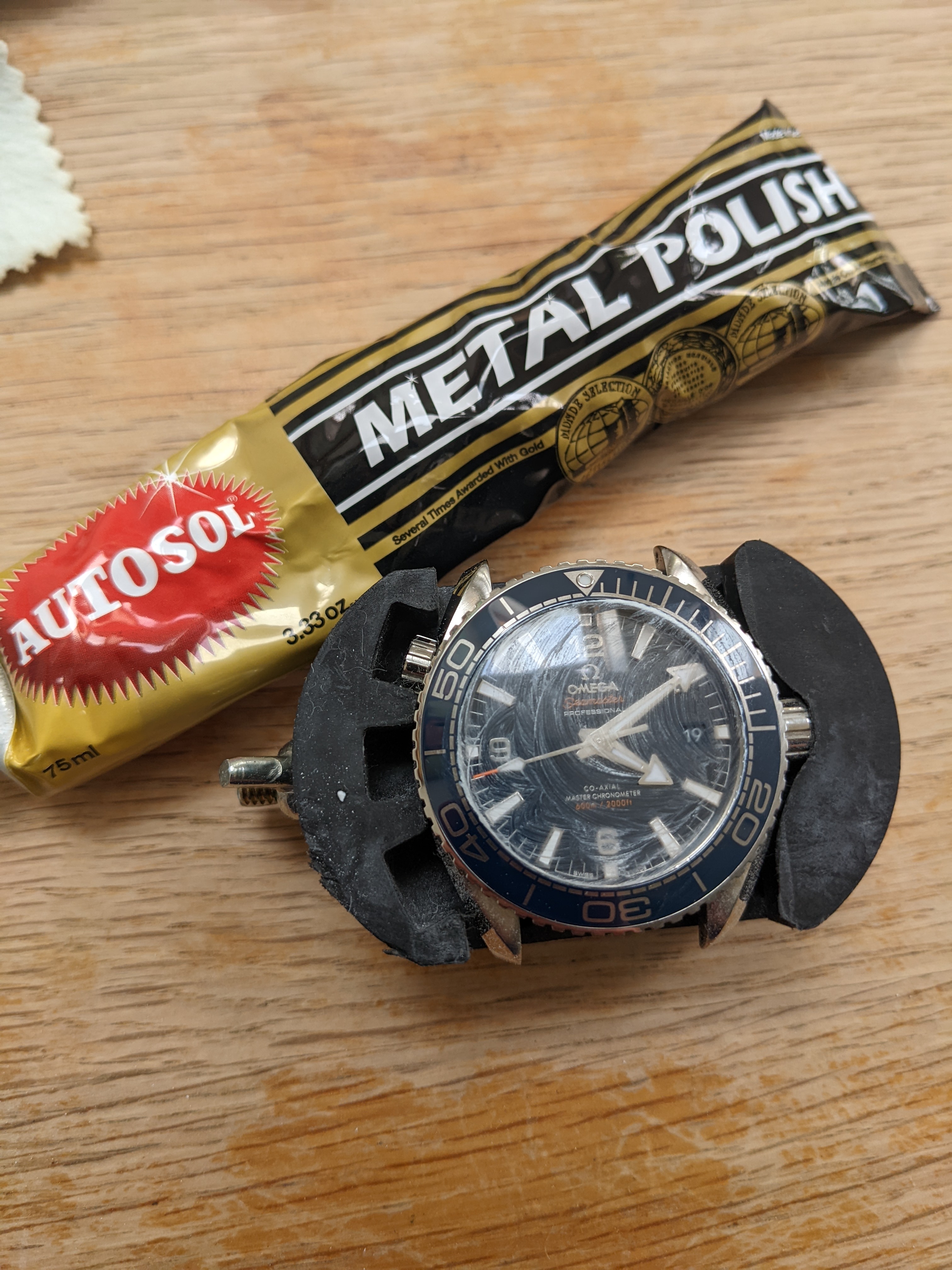

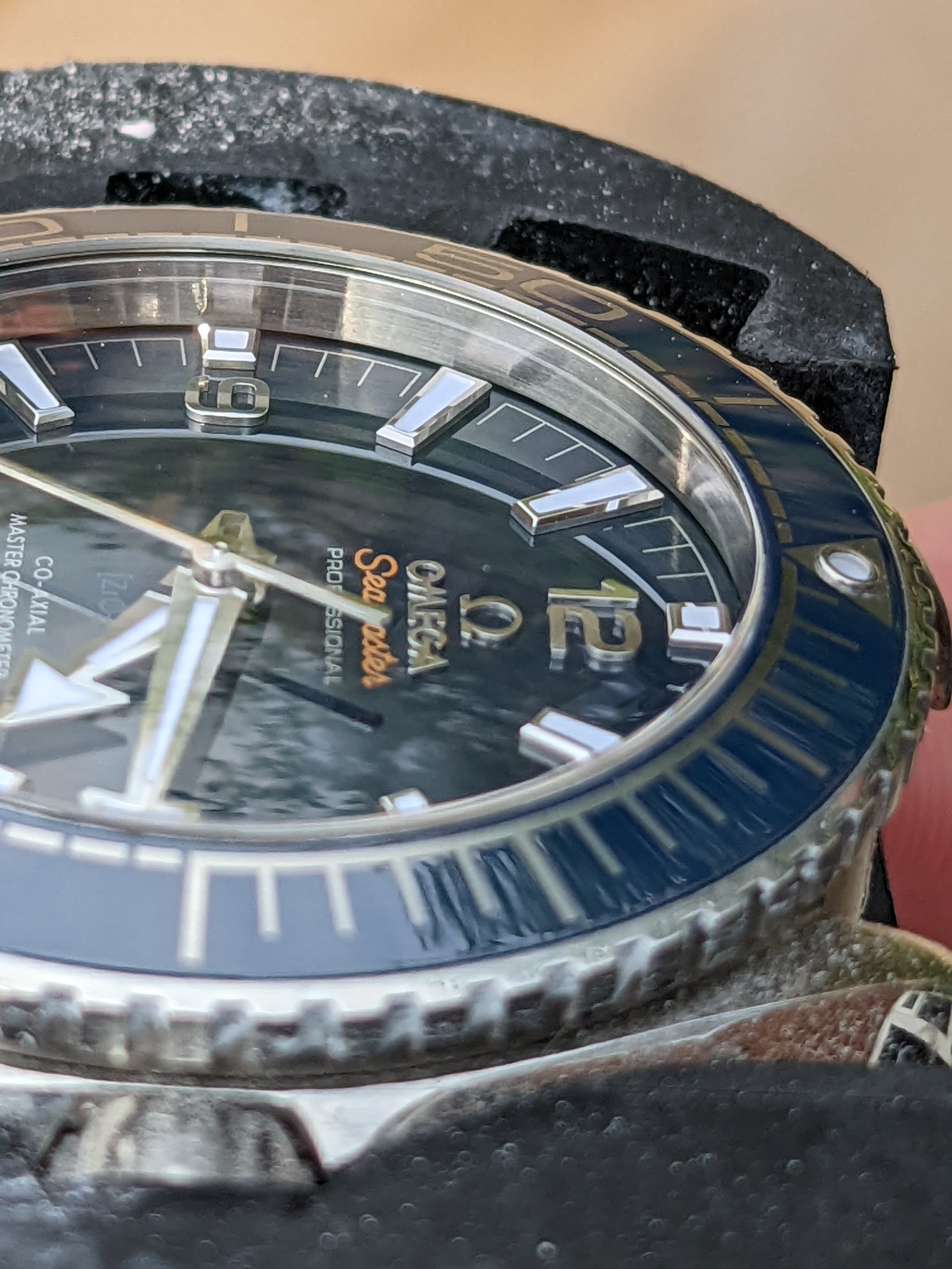

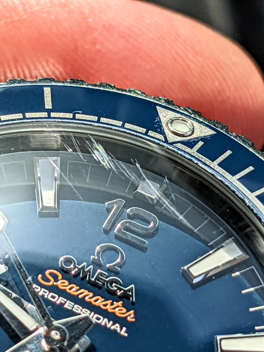

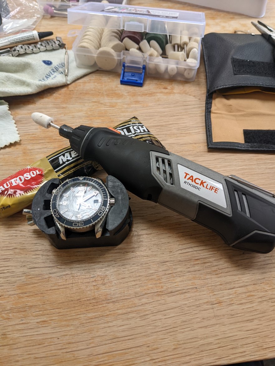

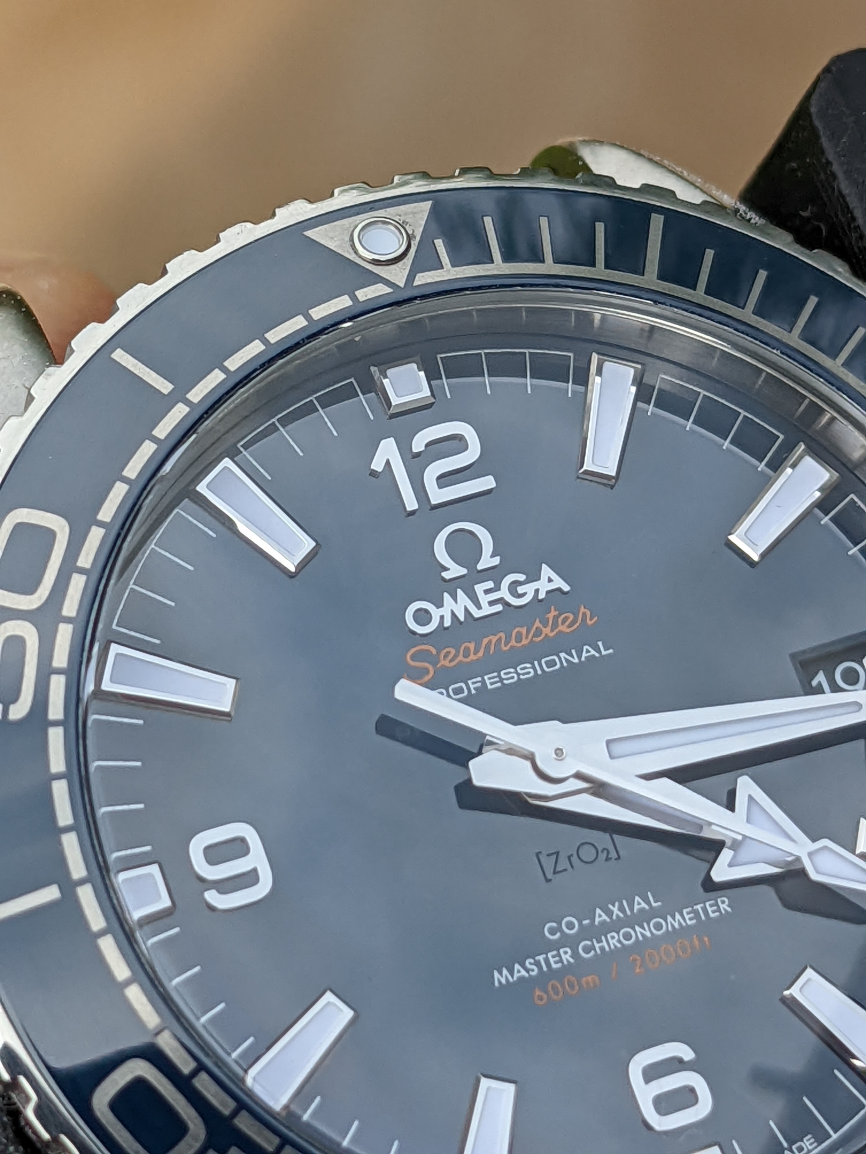

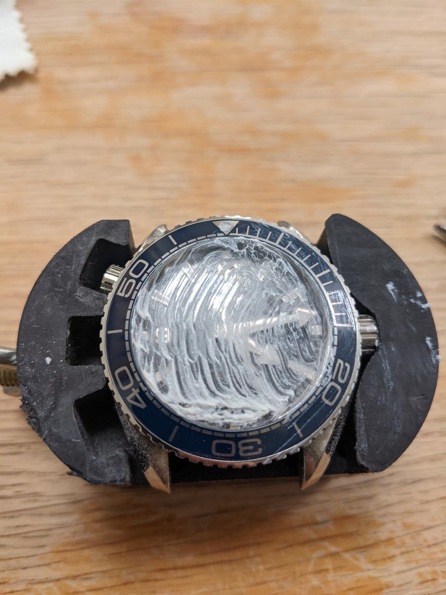

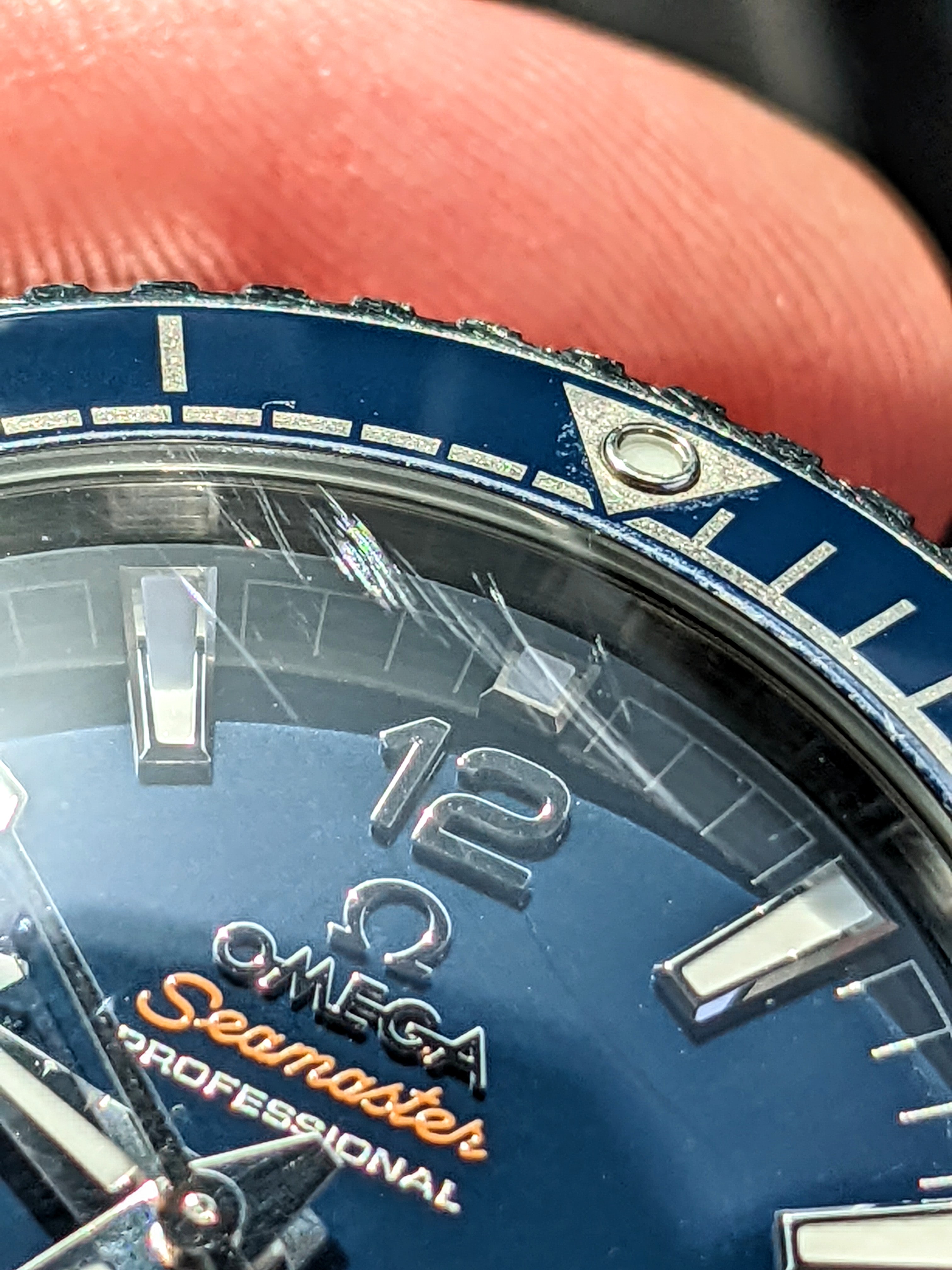

Managed to scuff the NR coating on my PO crystal. Will be removing it now. I'll post final result.

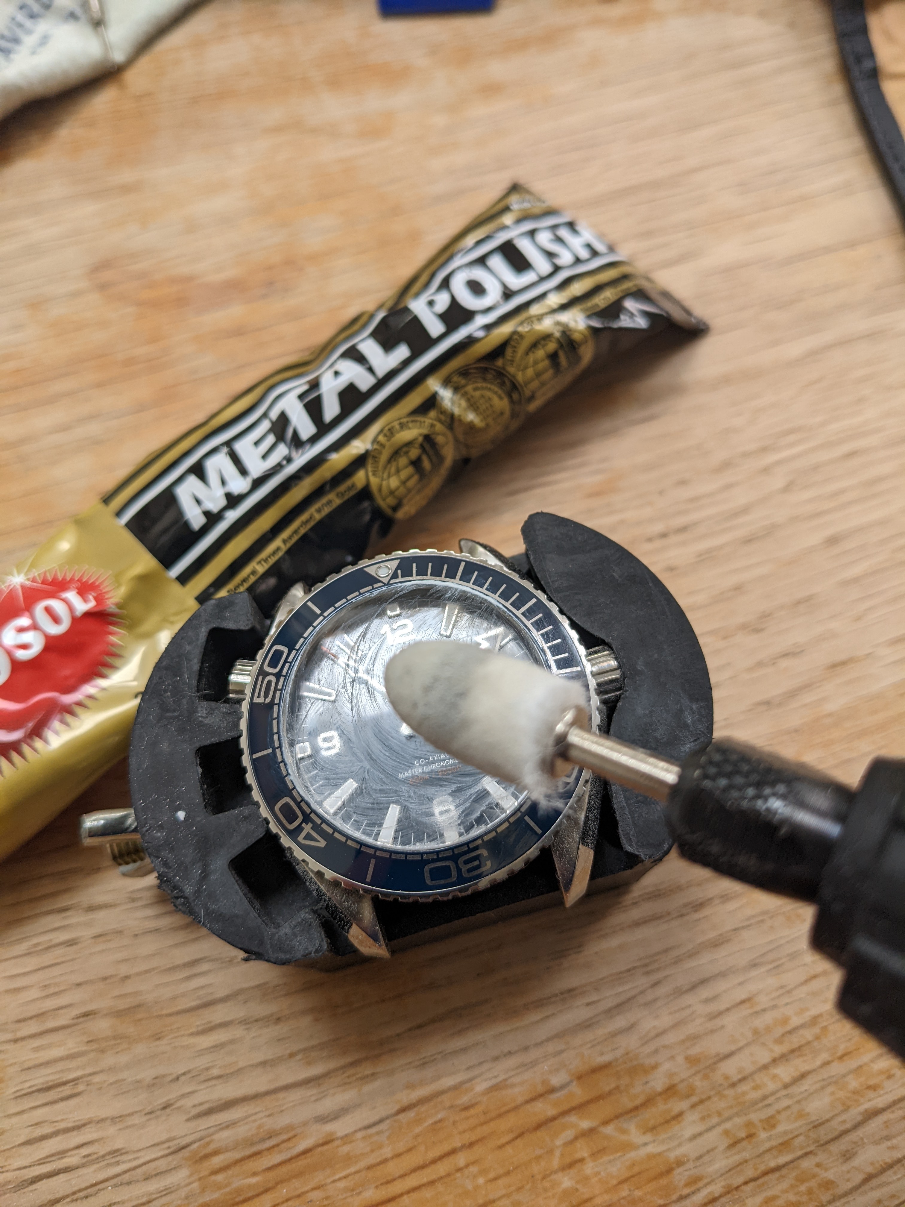

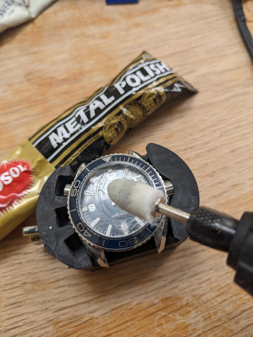

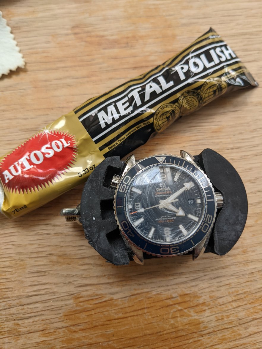

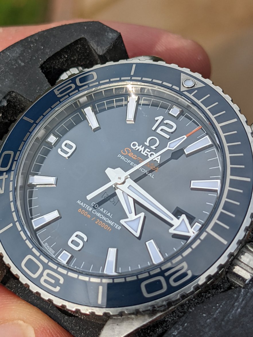

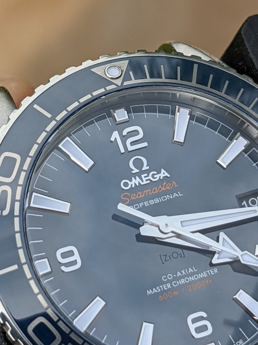

I'll admit it - when I saw METAL POLISH and the bezel not being taped off, I cringed. However, you can't argue with the results.

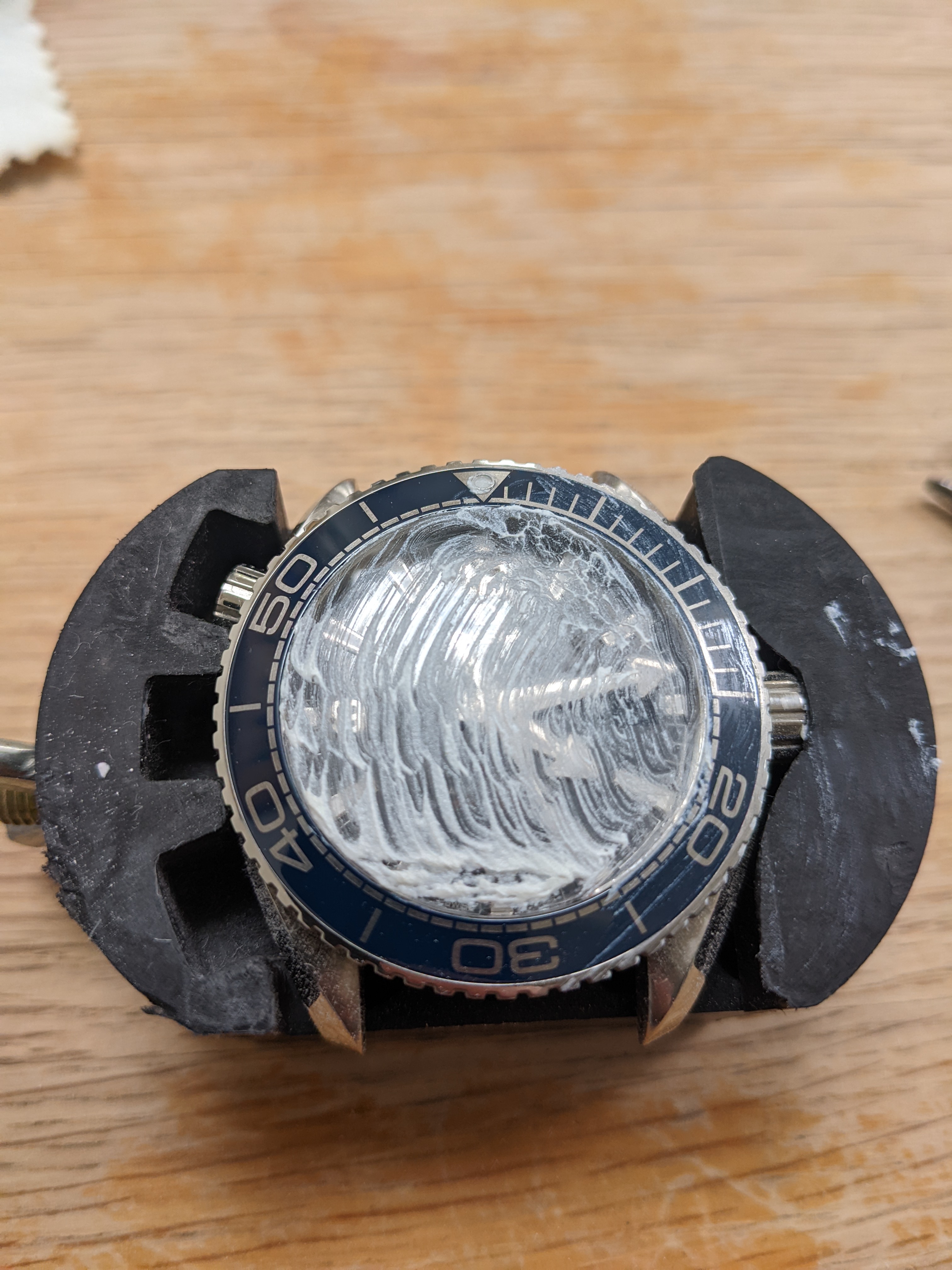

It's just a watch. I always have a go myself with anything like this, if I make a mess it goes to Omega anyway. So far, all my efforts on various watches have been successful.

Would it work the same way with Polywatch?
Tried Polywatch and did very little. I think Polywatch is for plastic?

Indeed. It is very efficient on hesalite.
Good to know that this AR coating can be removed then. I saw several threads on the net showing the coating being scratched, especially on SMP300.

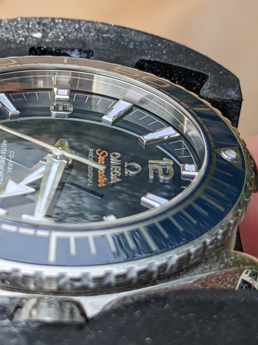

Yep, not much difference on this crystal to be honest, don't think there was too much AR on this one? I removed it of one of the latest 300smp's and you could actually see the colour on the polishing head.
