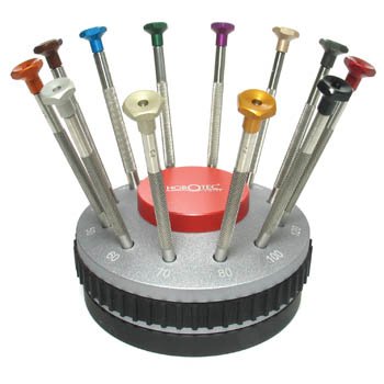

I'm very happy with my sets of Horotec screwdrivers (I think made by Horia). As far as I know, they are very similar to VOH (both aluminum head with ballbearings) but they are easier to find.
30,038
77,547
I've not seen anything to suggest that Horia makes screwdrivers for Horotec. The sets they offer are different.
VOH is a step above certainly, but much more money.
453
1,303
I’ve handled sets by Horotec and Horia, but never at the same moment so cannot be certain. They seem very similar to me.

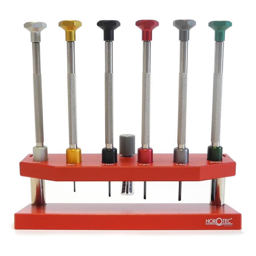

Horotec 1.6mm:

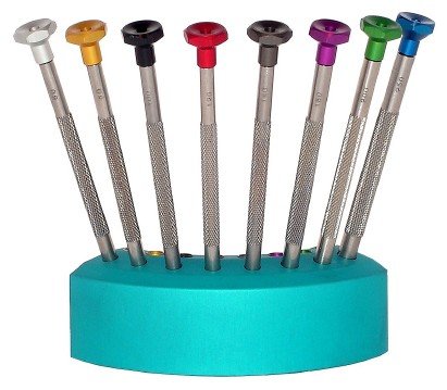

I have both Horotec and Bergeon, I personally prefer my bergeon set, I find the POM bearings on the back just feel nicer, and the knurling feels better on the Bergeon.
The price difference wasnt huge but the Bergeon was a bit more expensive.
I also found the flat box that the Horotec set came in to fit neatly into my toolbox for watchmaking school, I keep the Bergeon set at home, but I have also dressed the tips differently for dealing with different types of movements, where older movements typically have finer slots than more modern movements, and then even wider again for Japanese movements, where this time I just dressed a different set of blades since I need other tools more right now, but a 3rd set is almost inevitable at this point. Always been curious about the VOH ones but yet to hold one in person still.
Having also tried the budget range from A&F I would say give those a miss, perhaps only useful for holding the drive blades i modified into springbar tools for particularly narrow slots. A classmate has a set from a Korean company called Time Lab, and they actually seemed decent for the money, but I only picked one up, haven't actually used them, so cant really say if they are worth it or not.

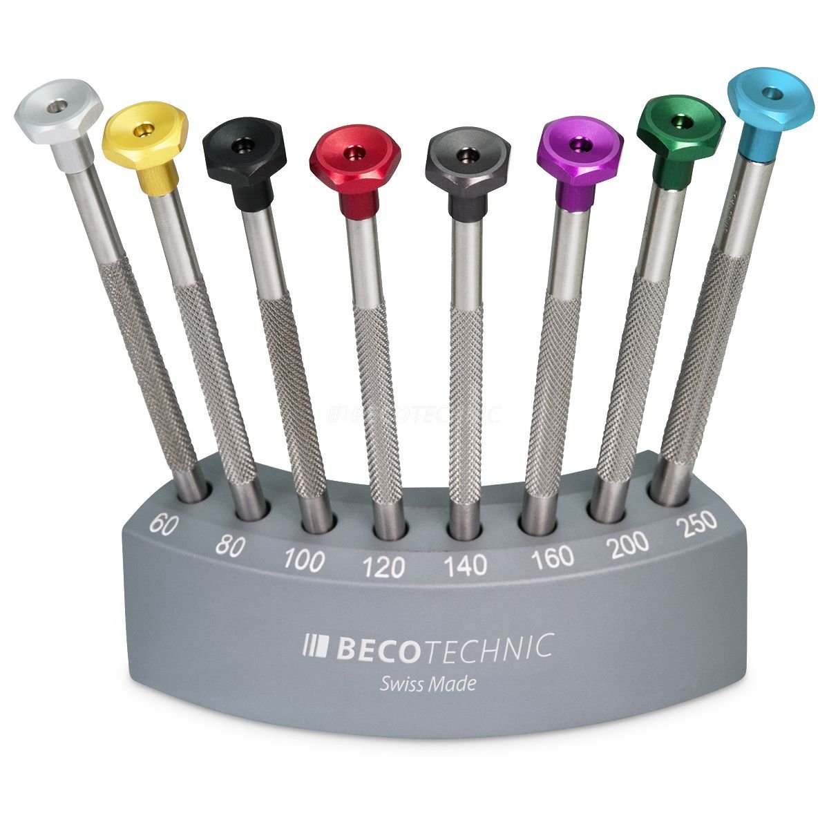

Another set extremely similar to the Horotec and Horia set is by Beco. As I believe Horotec and Beco are mainly suppliers, I would guess that Horia is the company to produce these.
Anyway, it seems that Horotec has also updated its design and they now look a bit different from the ones I posted in this thread.
Beco:

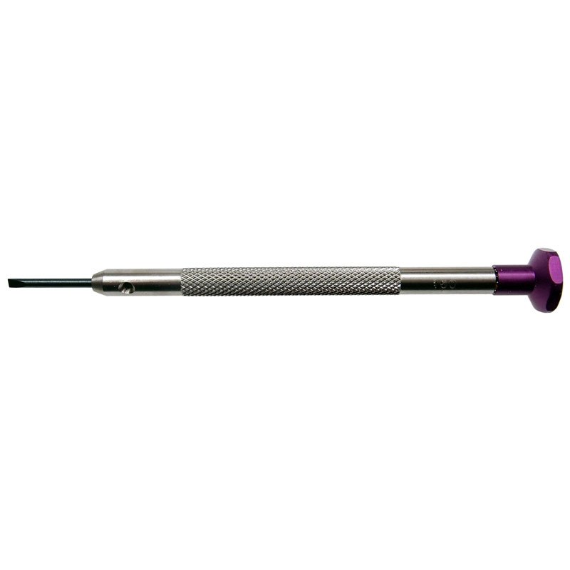

Horia:
