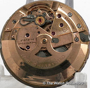

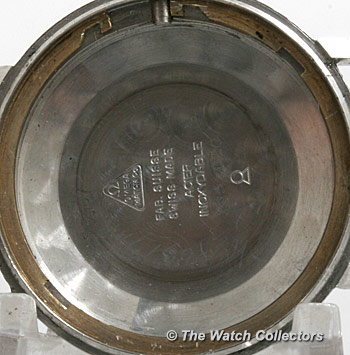

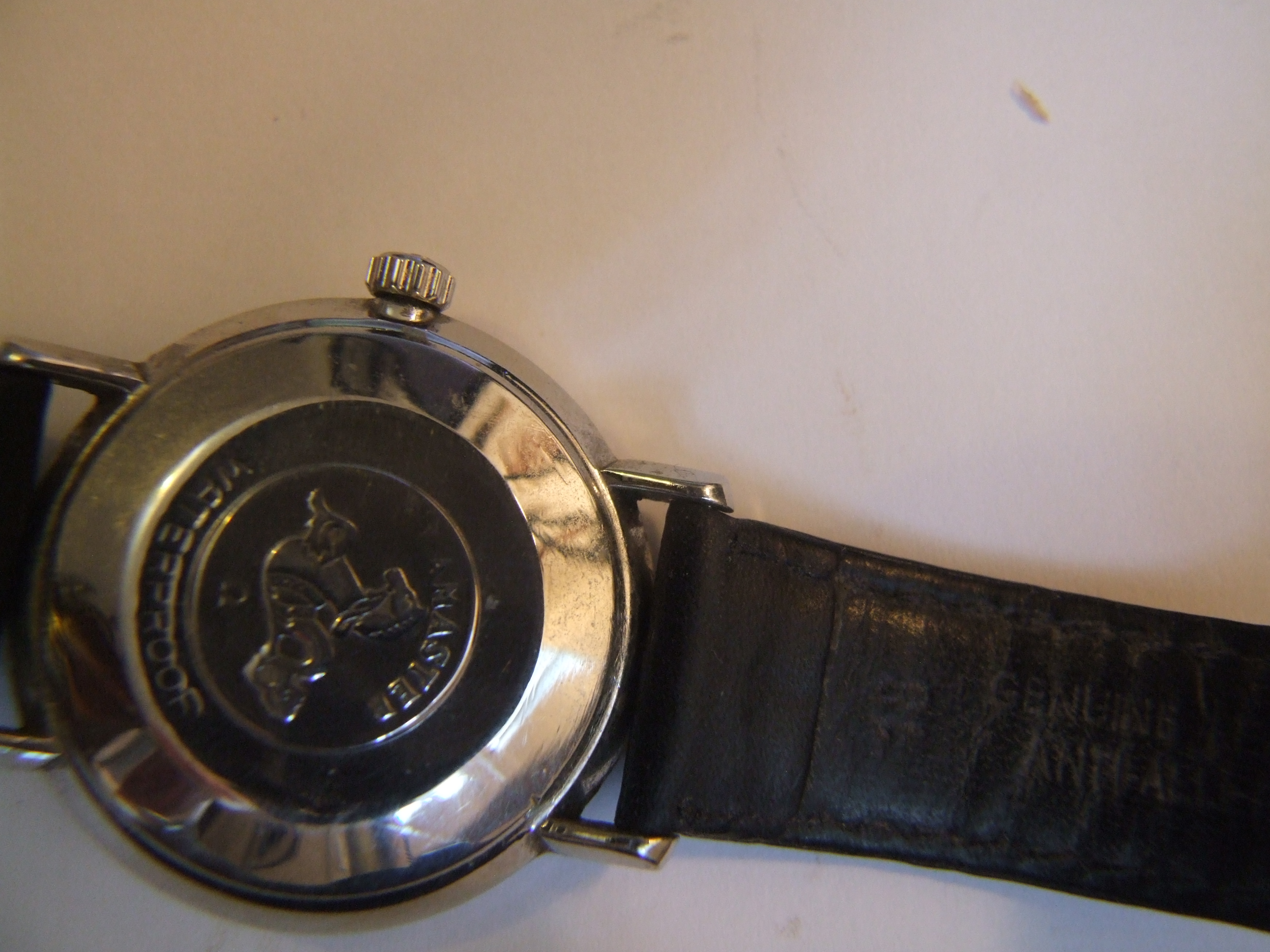

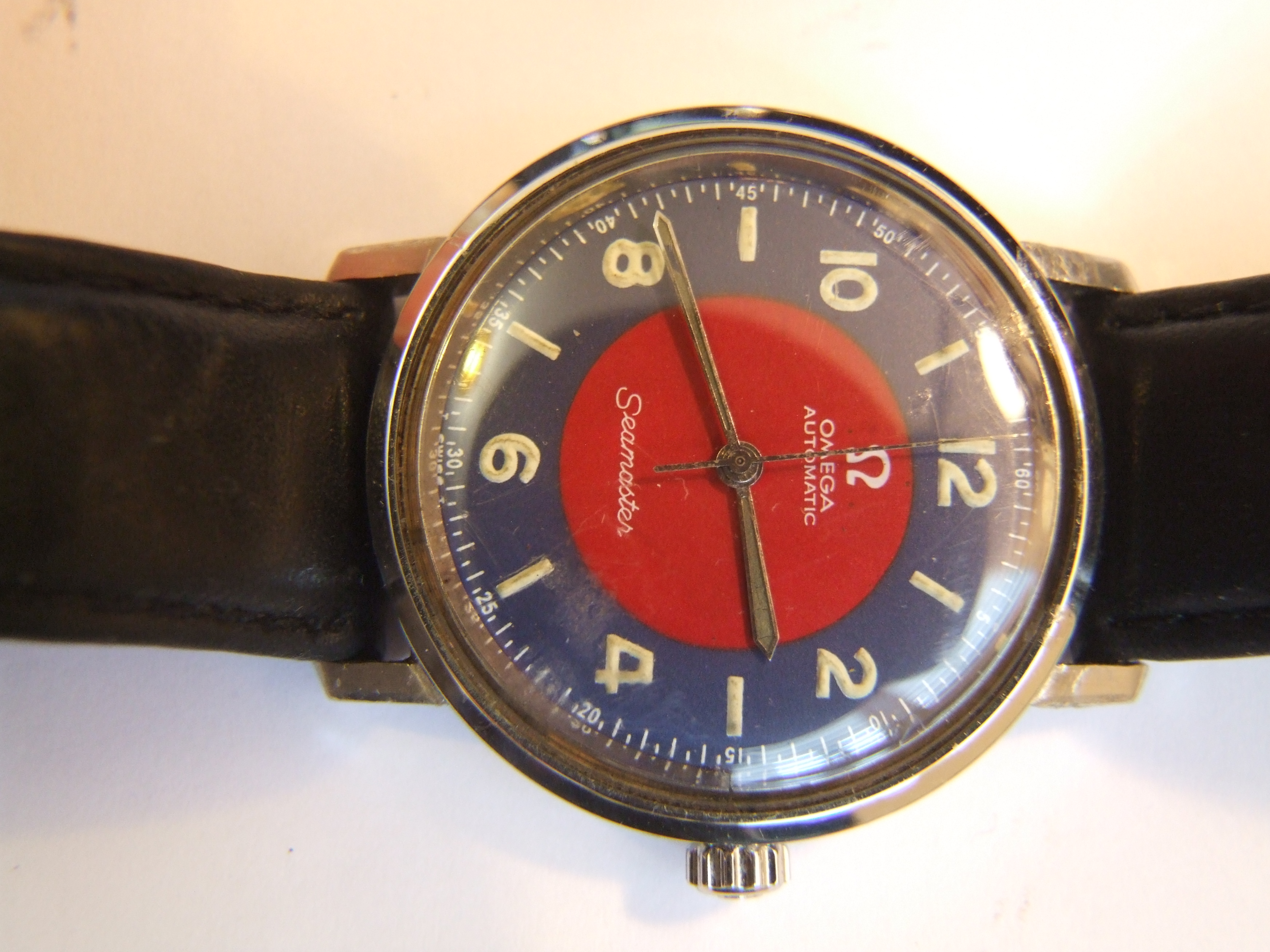

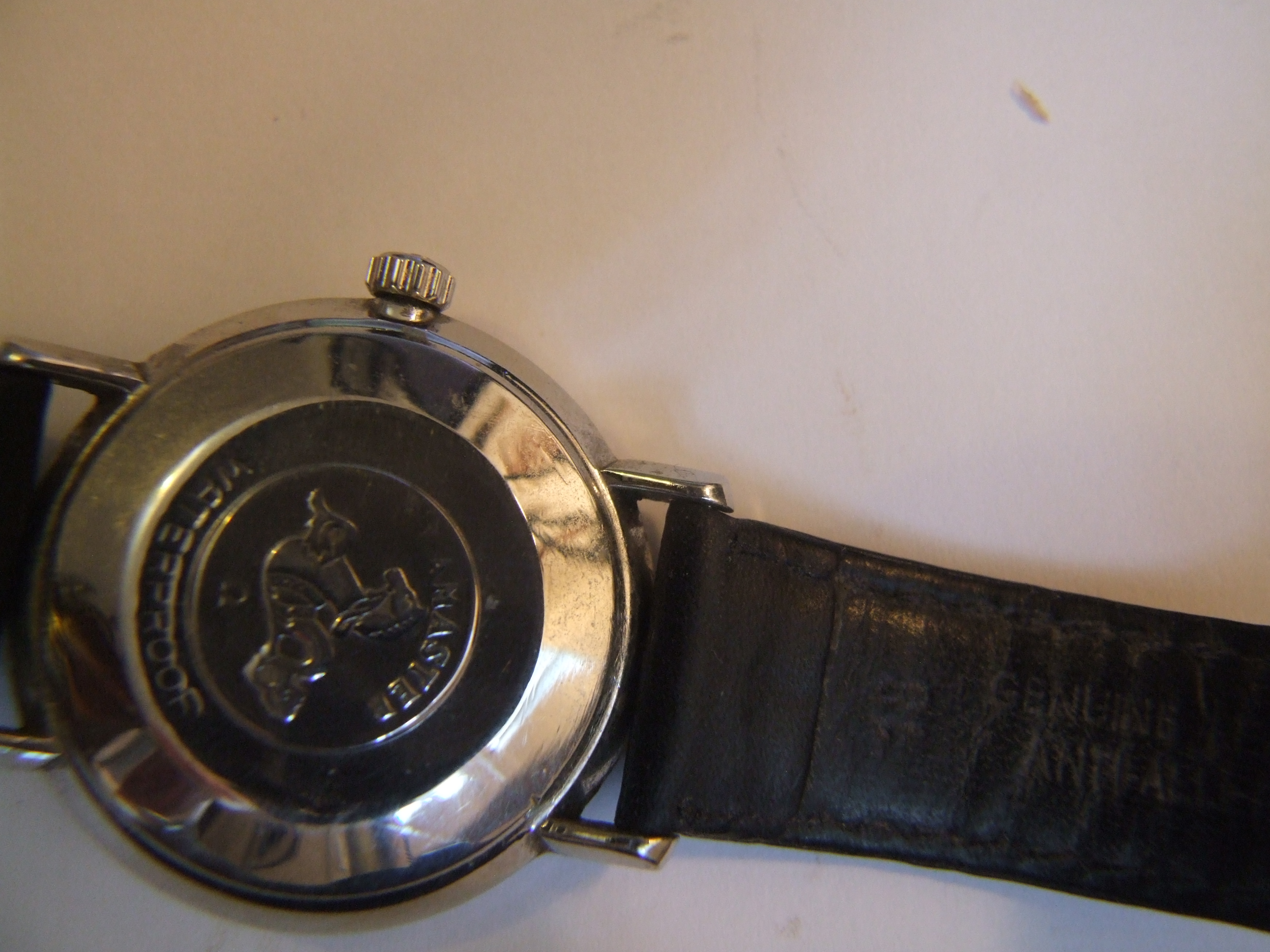

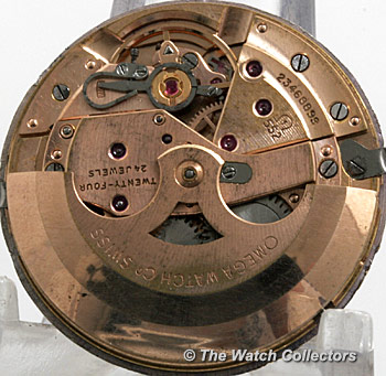

help request I bought this seamaster 1n 1966 from germany it came with photos of the case and movement
Seamaster automatic 23468878 cal 552
I have never been able to open it and need to verify the movement can you tell from the photos if it is pressure or screw back ..(I have assumed it was screw ) can you advise me how to open it.
christian
18,840
39,184

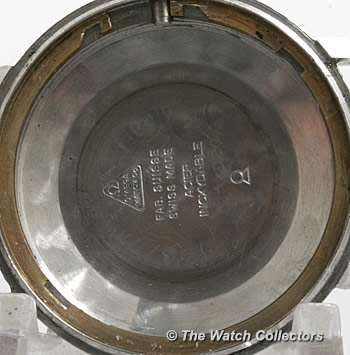

It is neither a screw or snap back case.
It's known as a Uni-shell or Uni-coc where the case is one complete module.
The movement can only be removed by dismounting the crystal or removing the bezel/crystal and removing the movement from the front.

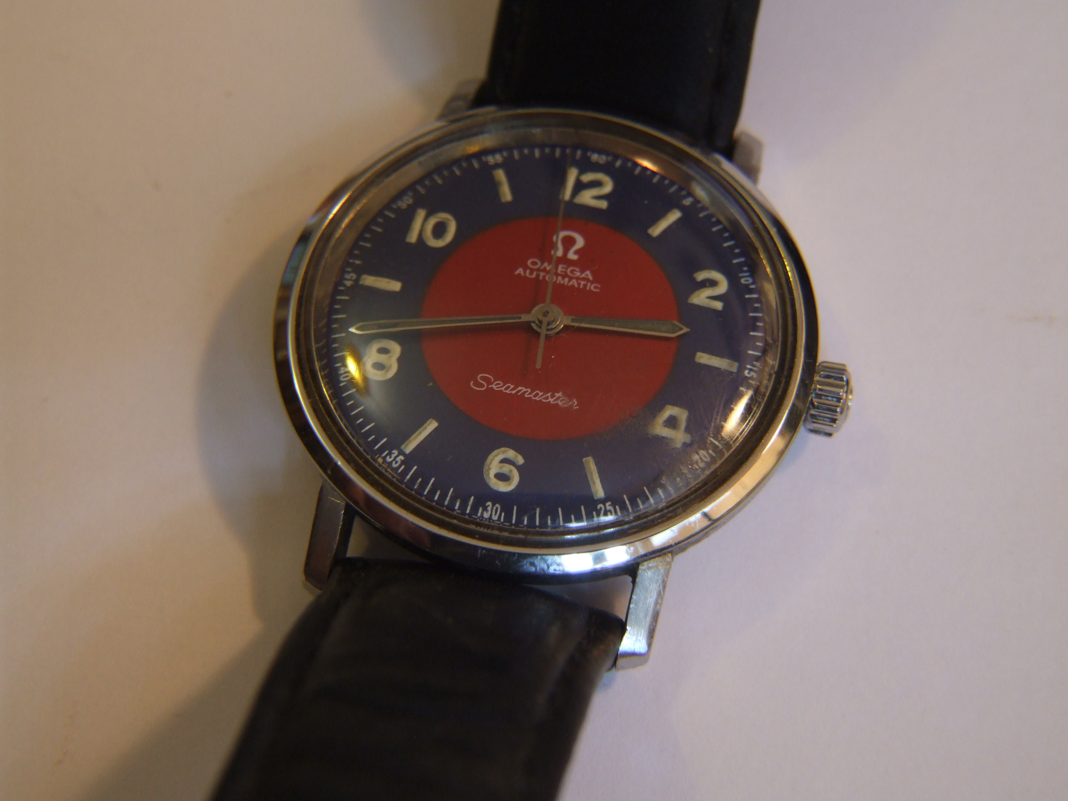

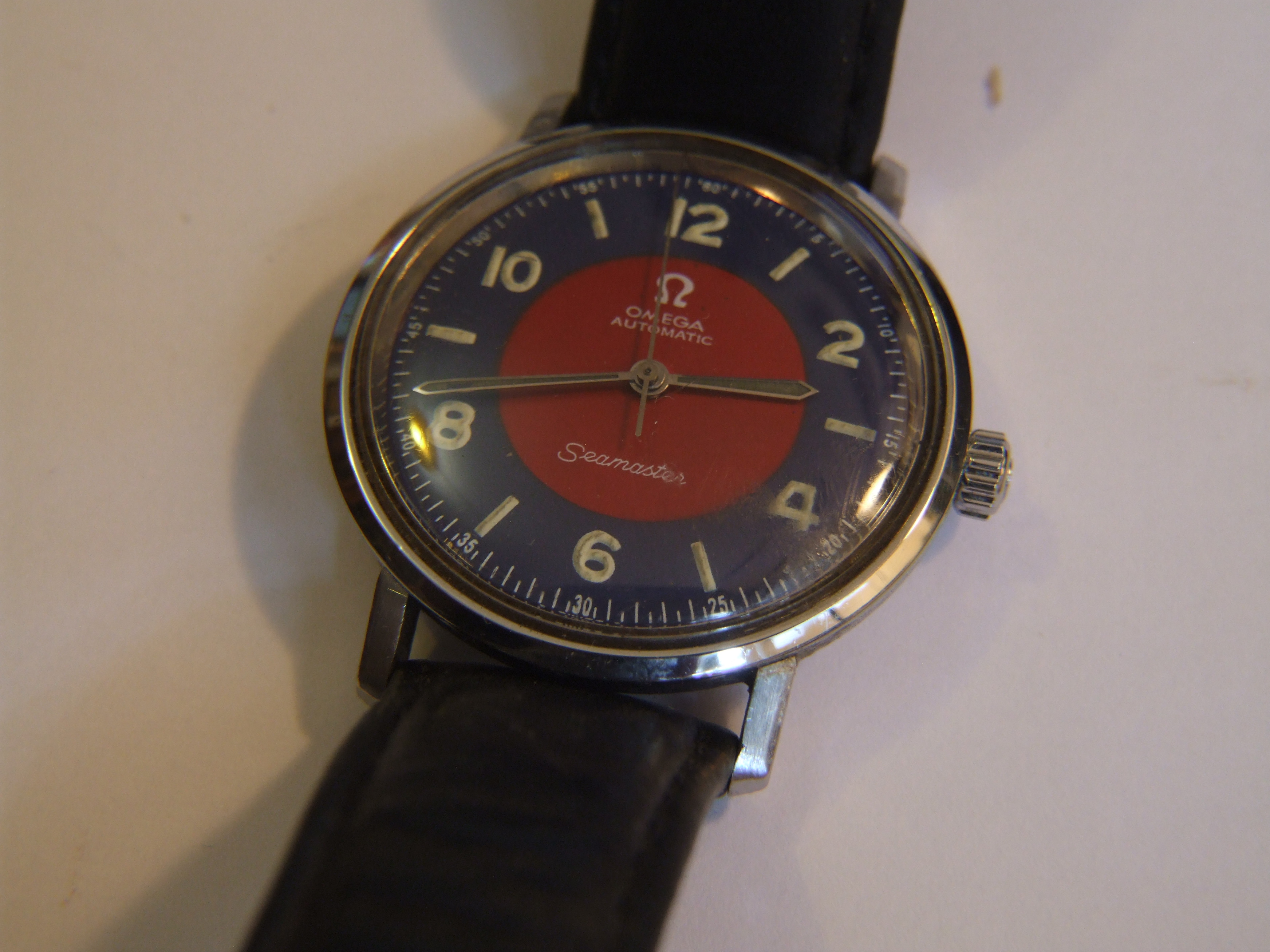

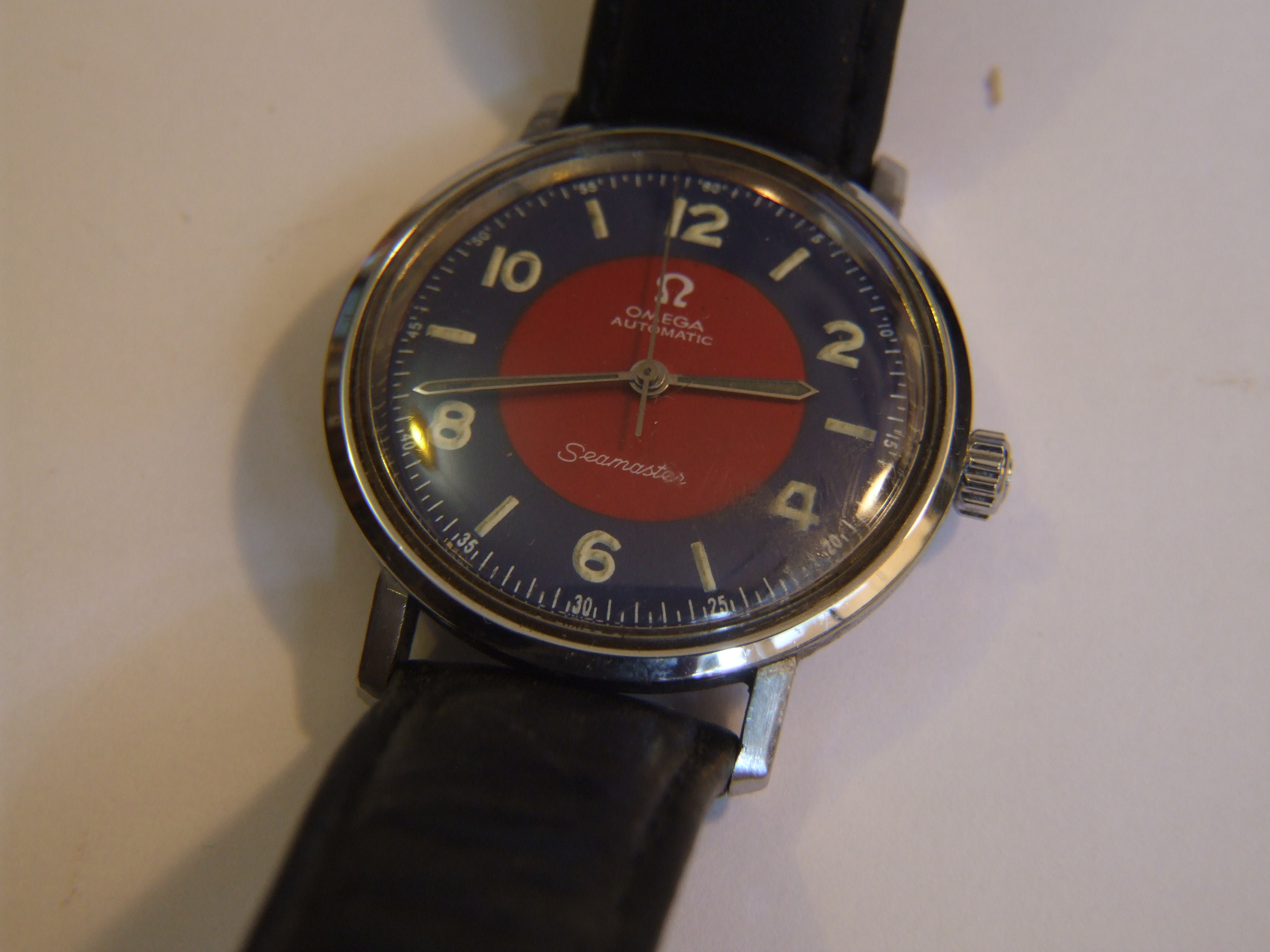

The watch is also a fantasy re-dial, I have never ever seen a dial like this on a Seamaster, but I've only seen thousands of them so maybe this one is a genuine Omega dial.
Maybe?

thank you, never realised omega used additional case fasteners..
one never stops learning on this forum
not sure I want to try to open this one I will go with the supplied images

Movement is average and dial is not close to original.
Haven't bought that design in many years (never a favorite), but it's also not a Seamaster and no reference number inside the case (again haven't owned one in more than 15 years

Reverse the deal. Terrible dial. Points to a terrible watch with more surprises quite possible....
13,556
23,504
With that dial the movement is the least of your concerns.

OK I bought this in germany 2006 assuming it was a redial on a seamaster I still like it and wear it often
are you saying that the case and dial are fake but the movement is original
I want to know what I have in my collection and welcome as much info as possible

Only the dial is a repaint assumably, it's not the end of the world
You need a fine tool that's used to open snap casebacks, but in this case, it's not the caseback that snaps, but the bezel that also holds the crystal, on the side of the watch, there's a very fine line between the case and the bezel, you need to yank it - I've never done it on a SMDV myself, inspected mine but I can't see an easy place to do it either
6,902
10,765
Basically everything original but the dial is repainted

Watch is a Seamaster (missed the back image).
Do a Google search on Omega Seamaster caliber 552 to see what the dial could have looked like.
