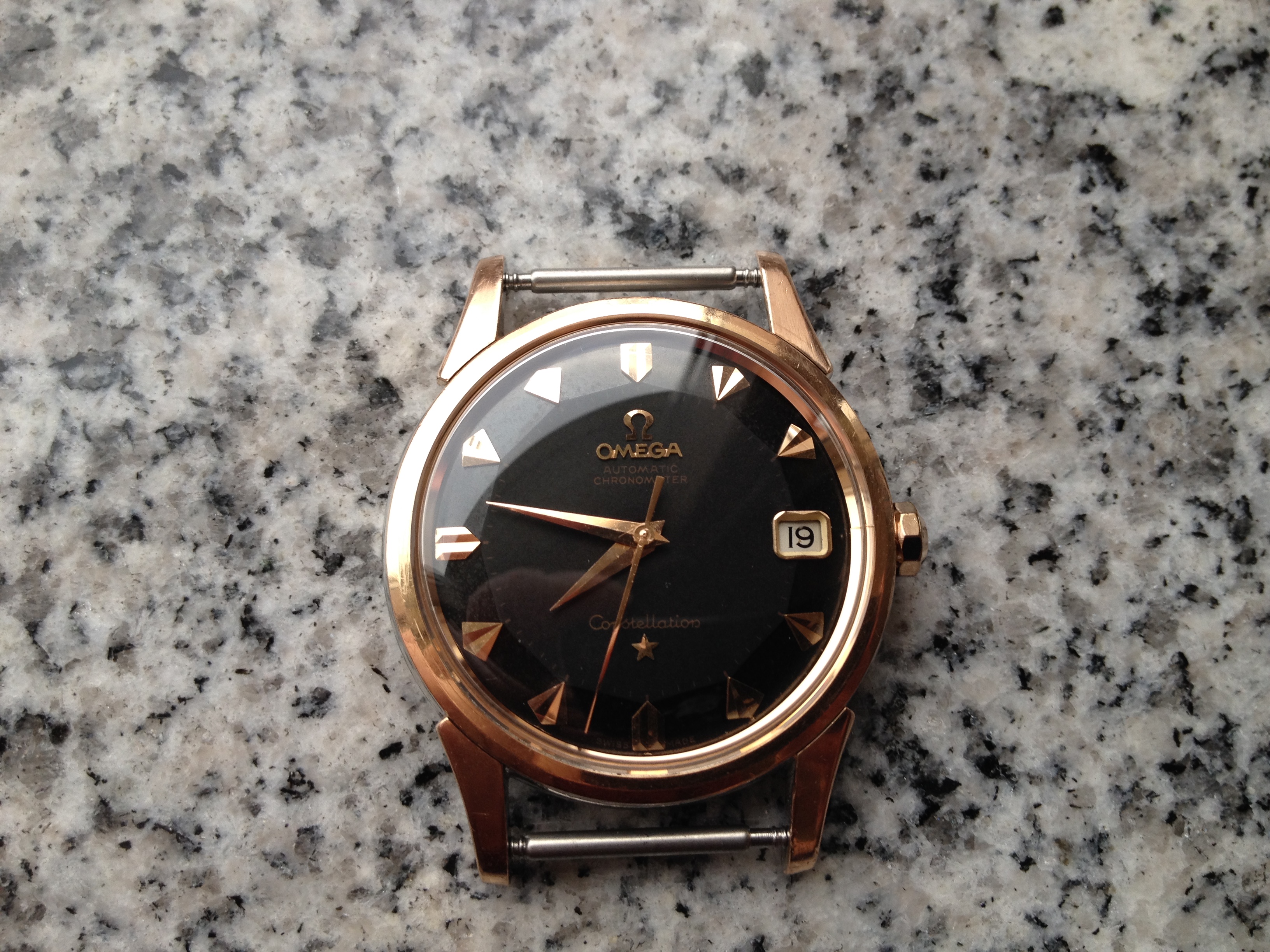

    Hi all,
    Was wondering if anyone knows if the correct pink gold sweep second hand for this 14902 is still available? and if so where could one try? I have sourced the crown, just needing the second hand.
    Many thanks,
  2. hoipolloi Vintage Omega Connoisseur May 4, 2017
    3,516
    5,795
    I have seen guys buying yellow hand set then had them dipped in 14k pink gold.

  4. Furze May 4, 2017
    347
    1,540
    Am i right in thinking that handsets only include hour and minute, and not the second sweep?
    Cousins seem to list a lot of hand sets, but no photos.
    Don't suppose anyone knows the length of second hand I need?

  6. Archer Omega Qualified Watchmaker May 5, 2017
    26,459
    65,595
    Hand is still available...
    066QG1365 | HAND SEC. RED PL. 072 12,7 GS FUS.C

  8. Pahawi May 5, 2017
    1,153
    3,361
    Hi Al,
    Any chance you know if this hand will be correct for a 14393 5 SC too? The one my watchmaker got for my watch is too long and he claims the shorter ones is not available anymore.... Watch in Q.:
    Thanks,
    Paul
  9. Archer Omega Qualified Watchmaker May 5, 2017
    26,459
    65,595
    Yes, the Extranet calls for the same hand on that one.
    Cheers, Al

  11. Furze May 5, 2017
    347
    1,540
    Just copied it into Cousin UK, they have them listed as available, thanks again Al.
