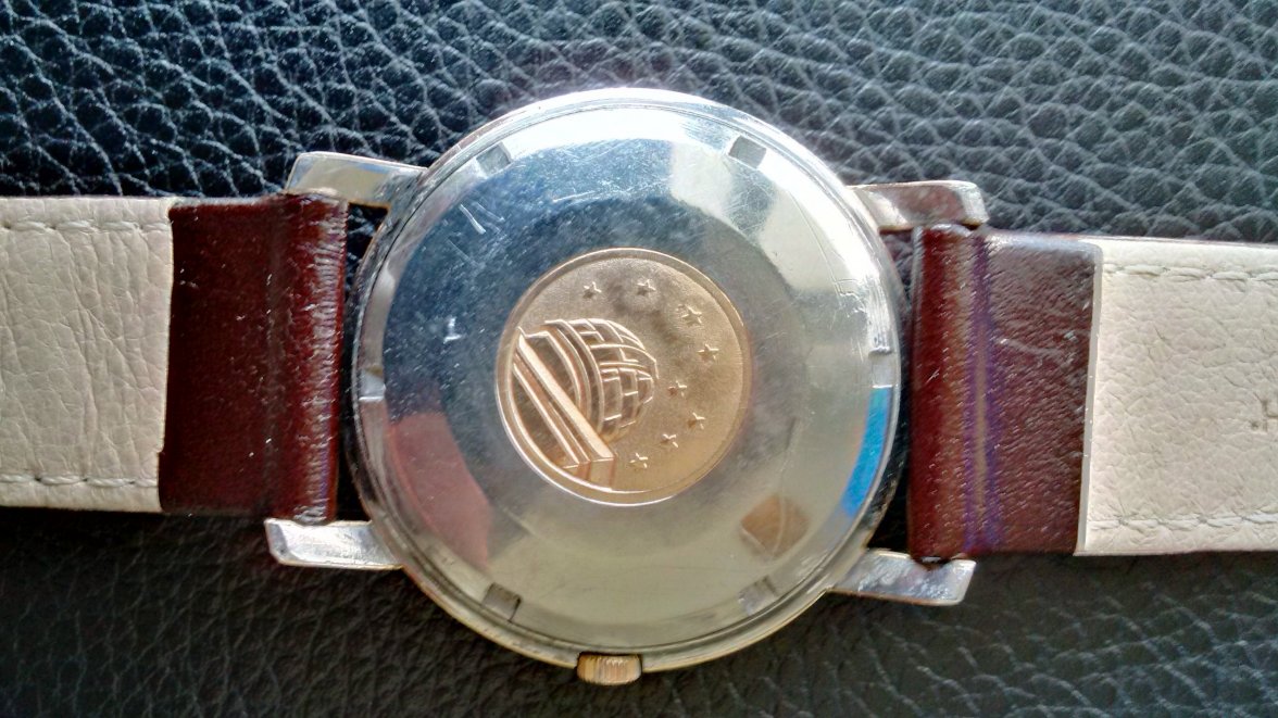

  17. Peemacgee Purrrr-veyor of luxury cat box loungers Apr 10, 2016
    5,127
    7,835
    Pinkgold is notoriously difficult to photograph
    Hers my pink gold cap Connie
    Looks yellow but definitely pink (the medallion is the give away)
    I tend to agree with consensus though the OPs looks yellow
