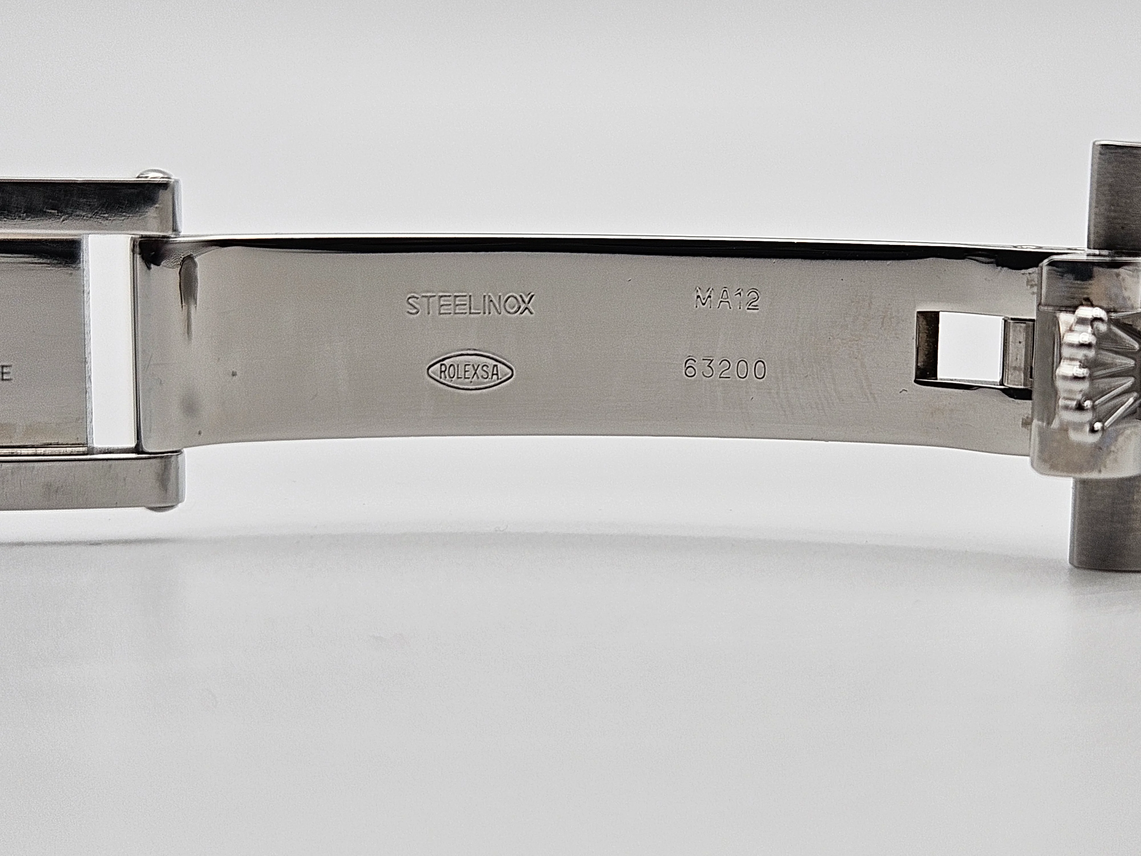

bracelet ref # 63200
Preowned and in good condition

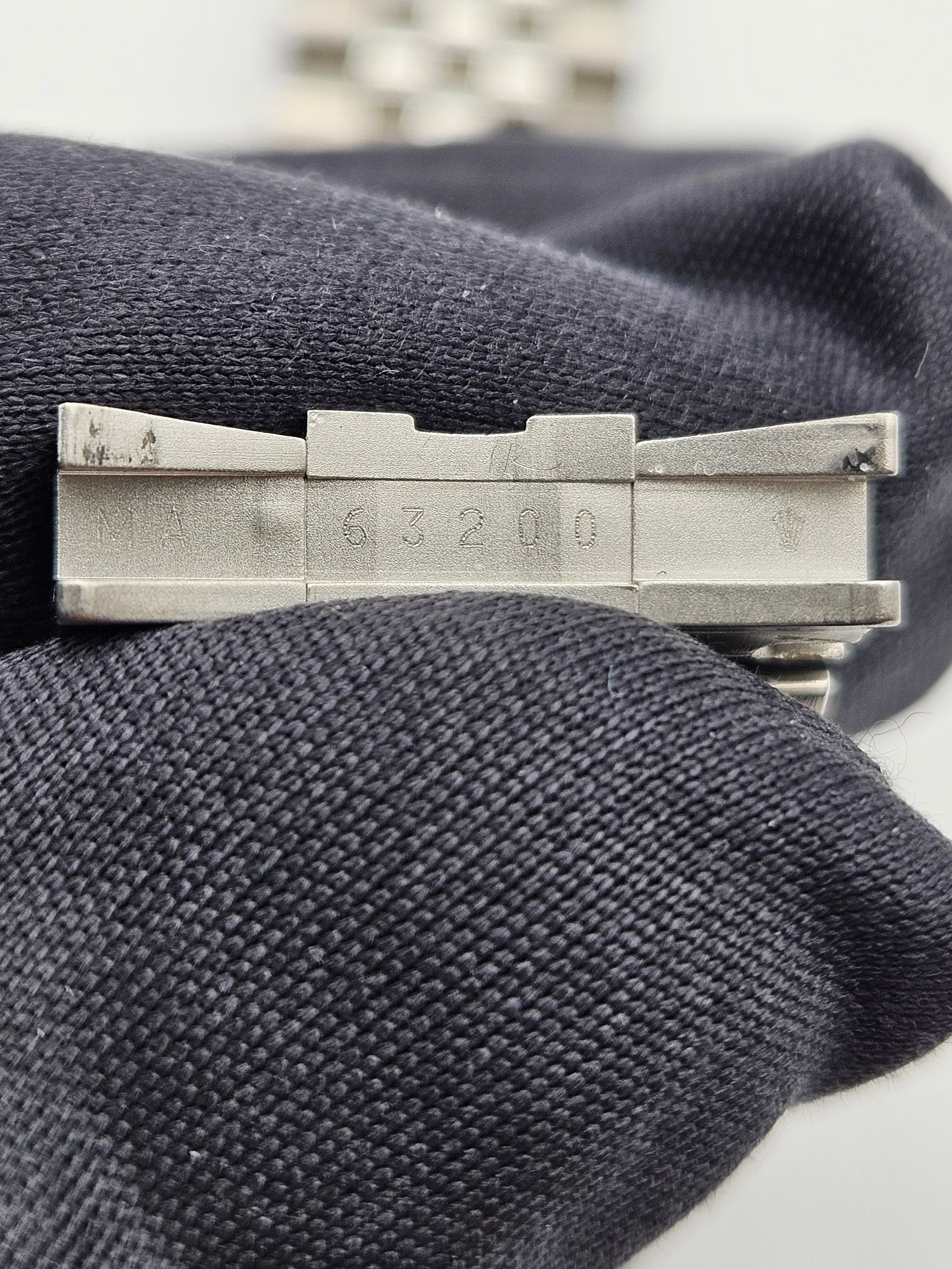

These were/are only available for 116200 and 116234 Datejust watches, but can be fitted to a number of other references, including:
5 digit & 6 digit Yacht-Master
5 & 6 digit Daytona
5 digit Explorer 2
5 digit Submariner w/ date
5 digit GMT Master (this will also fit the 6 digit GMT, but due to the larger maxi case, the transition from the lugs to the endlink is not as aesthetically pleasing as the smaller cases)

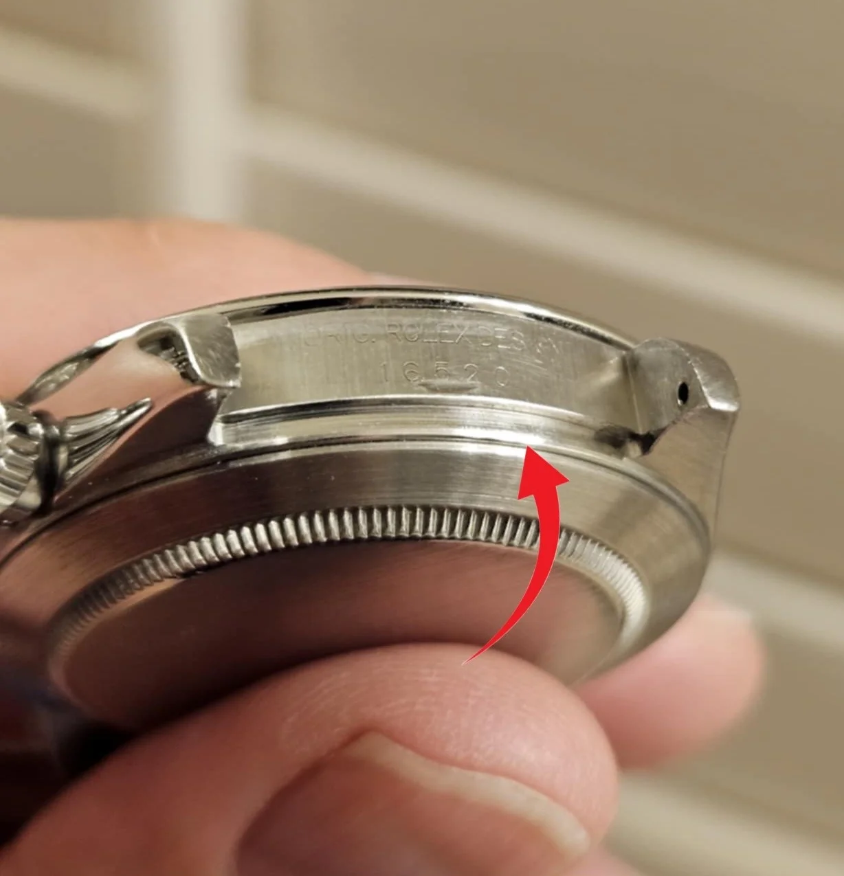

What you'll need to check to make sure this bracelet will fit your watch:

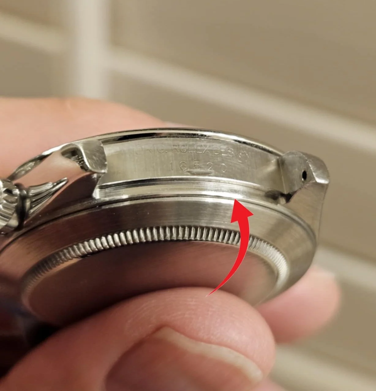

  • you'll need to make sure that your case has the recessed lip in the case between the lugs (see attached pic for an example)
  • If you have a holes case watch listed above, you'll need to source 1.8mm spring bars. The standard 2.0mm springbars that Rolex uses on cases with holes will not fit into the Super Jubilee endlink. Ideal size endlink for a holes case with a Super Jubilee bracelet is: 1.8mm body diameter x 19mm body length x 1.1mm tip/pivot point x 24mm overall length. If you have a holes case, you can reuse the more common size that Rolex uses on the no holes case (1.8mm diameter w/ a 0.9mm tip/pivot point) but the springbar will a small amount of play once fitted to the watch due to the 1.15mm hole in the lugs with the 0.9mm tip....which may result in wear to the holes in the lugs.
