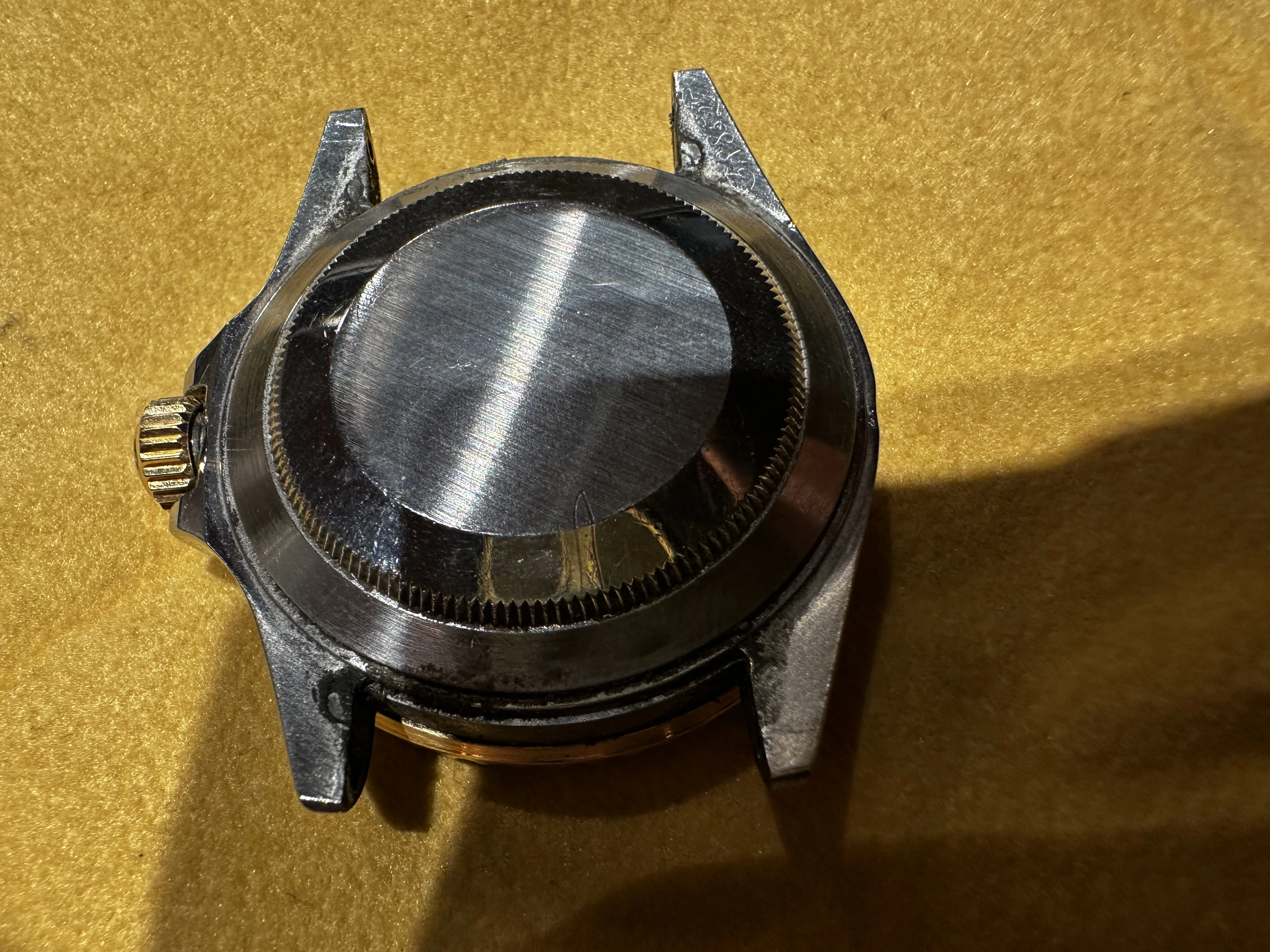

I sent my dads 16803 in to Rolex and these were the findings:

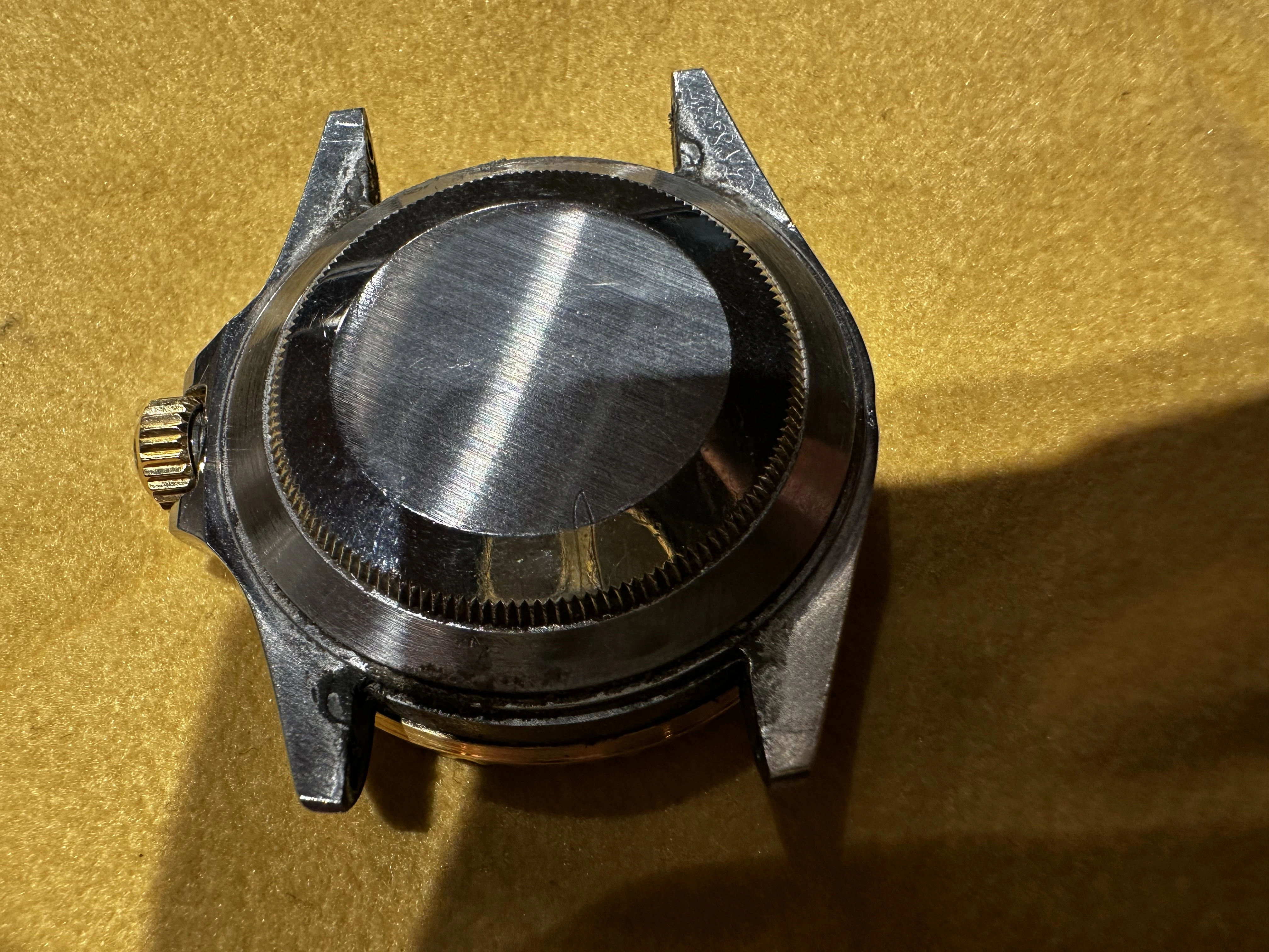

They want to replace the caseback 3000.00.

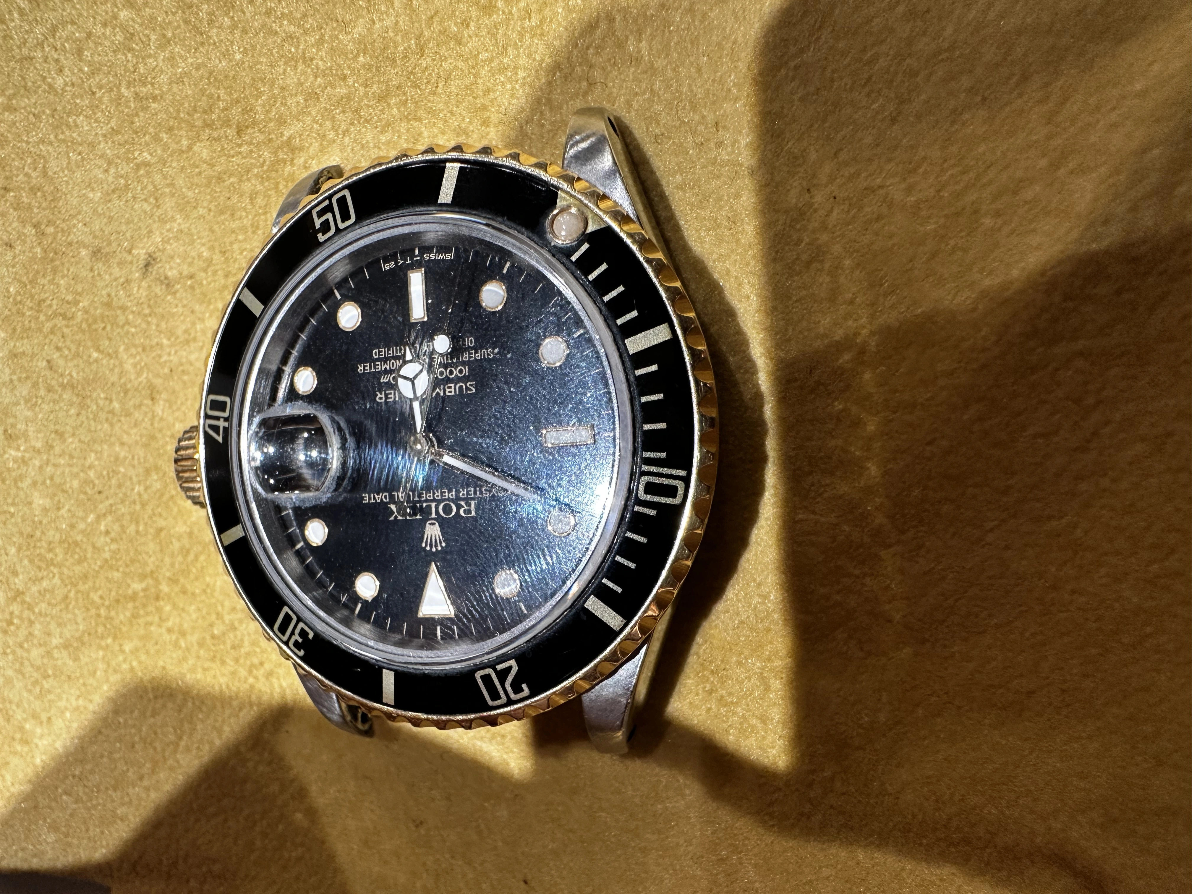

Also they wanted to replace hands/dial/crystal !

I presume you mean the bezel, not the dial is free-spinning. If I was you, I'd reject the changes and have Rolex send it back, then find a GOOD local watch maker with a parts account to do a good sympathetic servicing, and fix the bracelet/bezel for you. Then, your dad can wear it another dozen or so years trouble-free.
I can't imagine why, other than Rolex being unwilling to let anything leave service besides 'good as new' (even if, like in this case, it would make the watch decrease significantly in value for being non-original), that anyone would do any of that.
Dial + hands look fine, case back looks fine enough. The case has had an... interesting life it looks with whatever is going on with those lugs, but if you needed metal added there, you'd have to find a watchmaker with a laser welder.
That said, unless they are structural, I'd have a watchmaker just clean/service + repair the bezel + bracelet. It should run you about 1/10th of what Rolex wants.

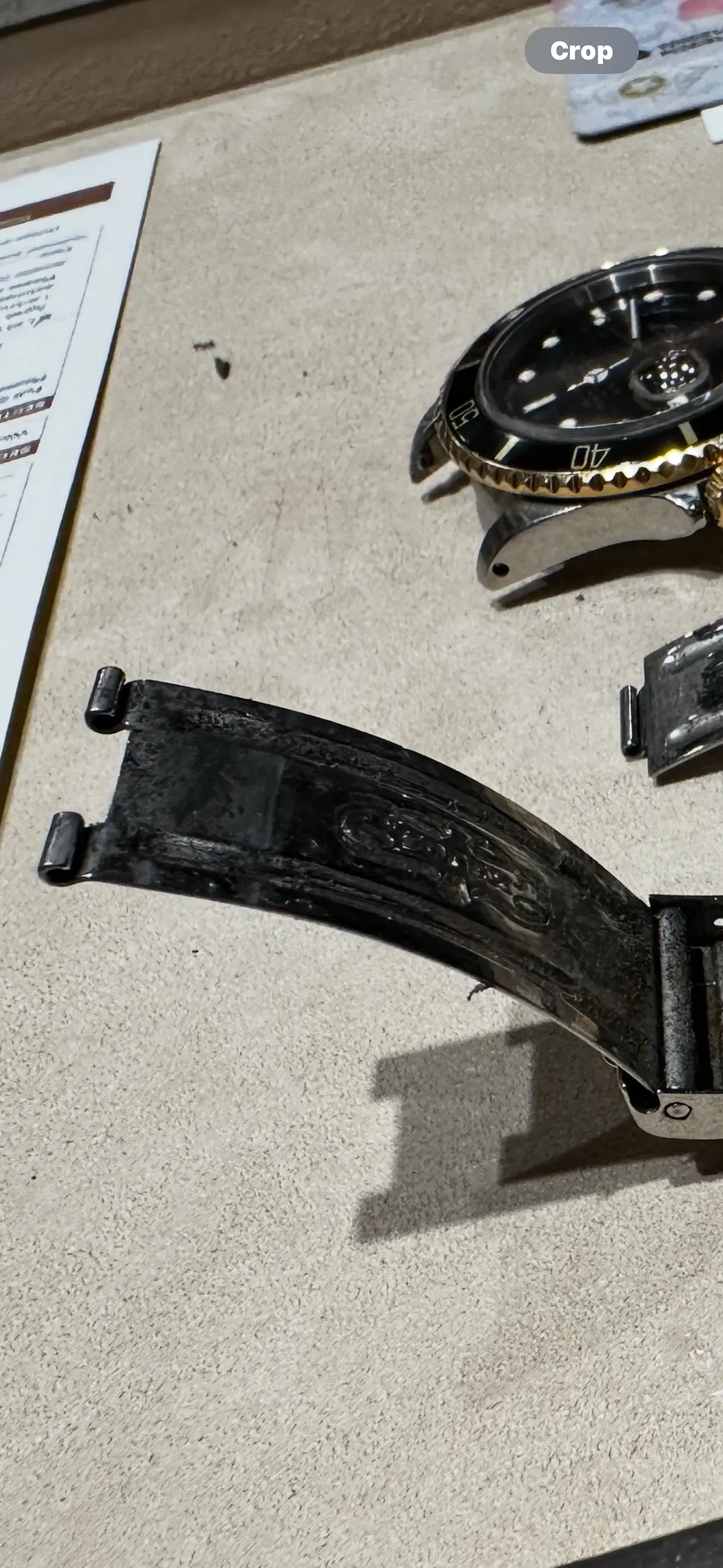

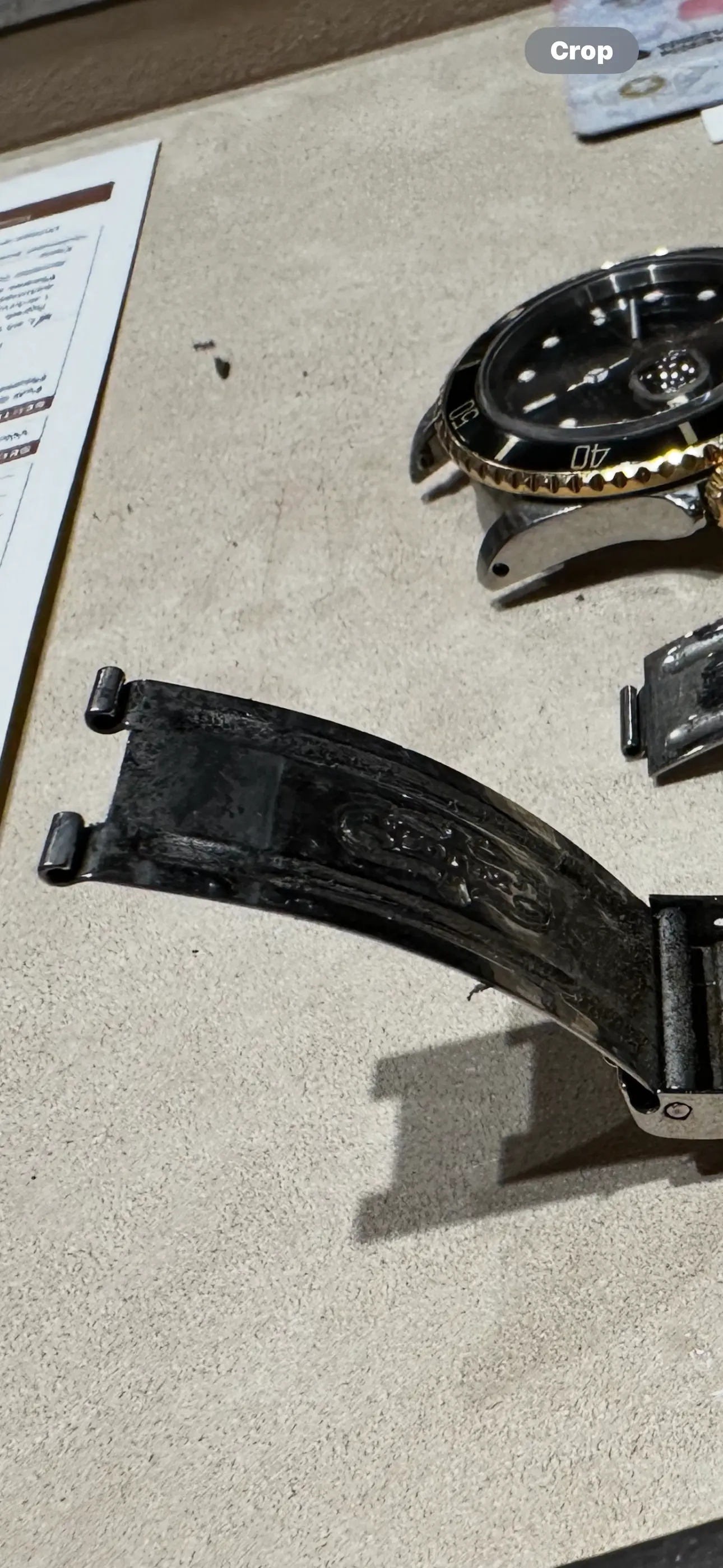

The watch held the bracelet fine. It was the pin in this area that fell out that kicked all this off. (See photo). Lucky for me and my dad he had his hand out the window of the truck… brought it in and it fell off at his feet.

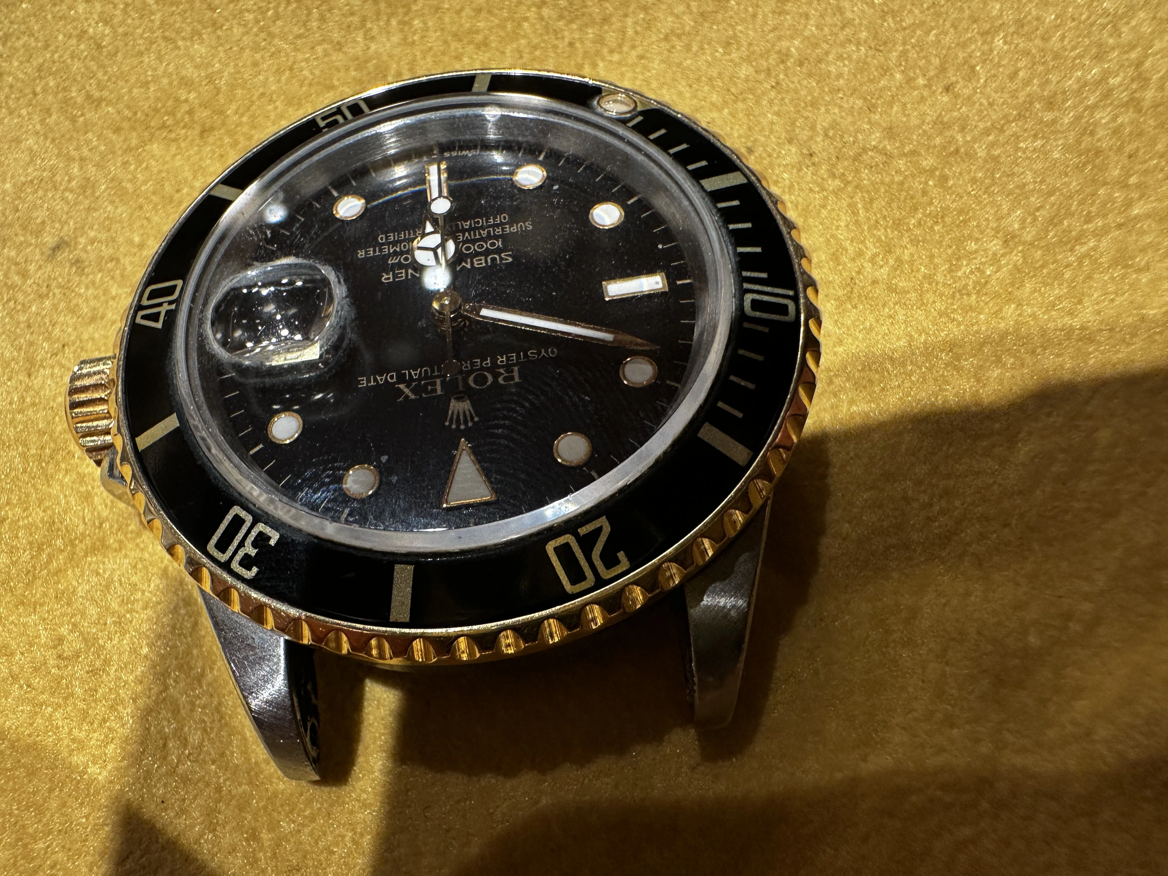

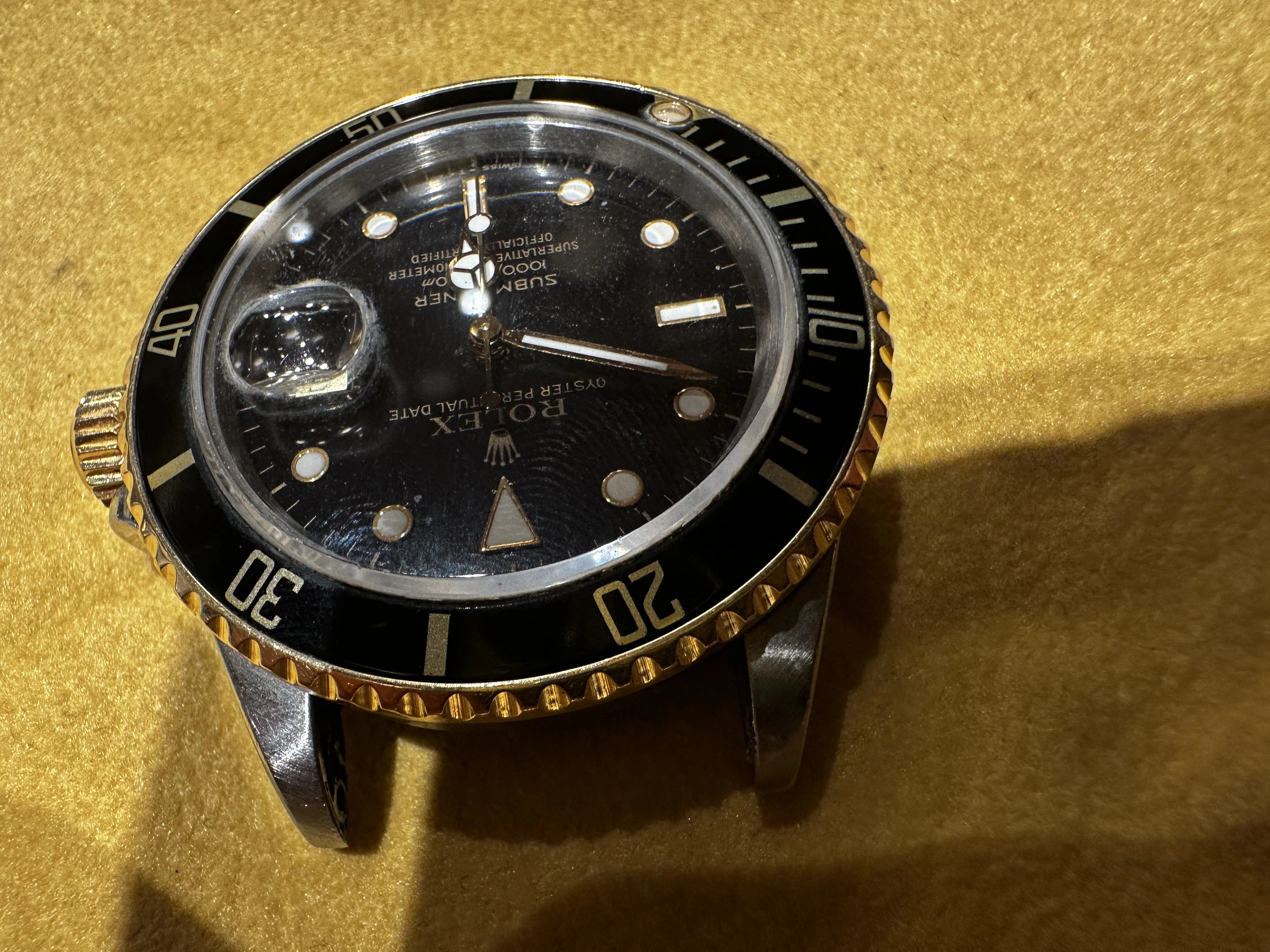

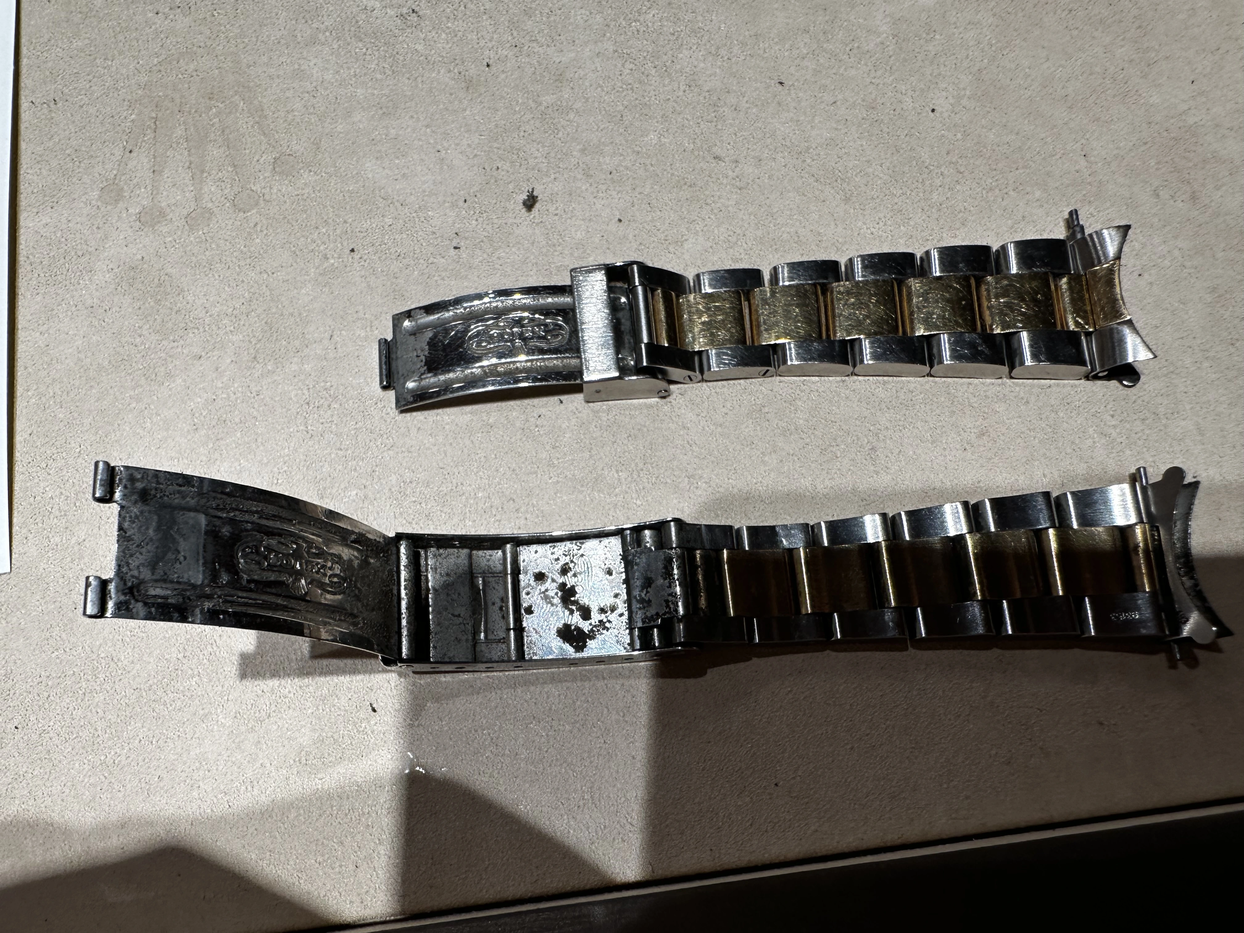

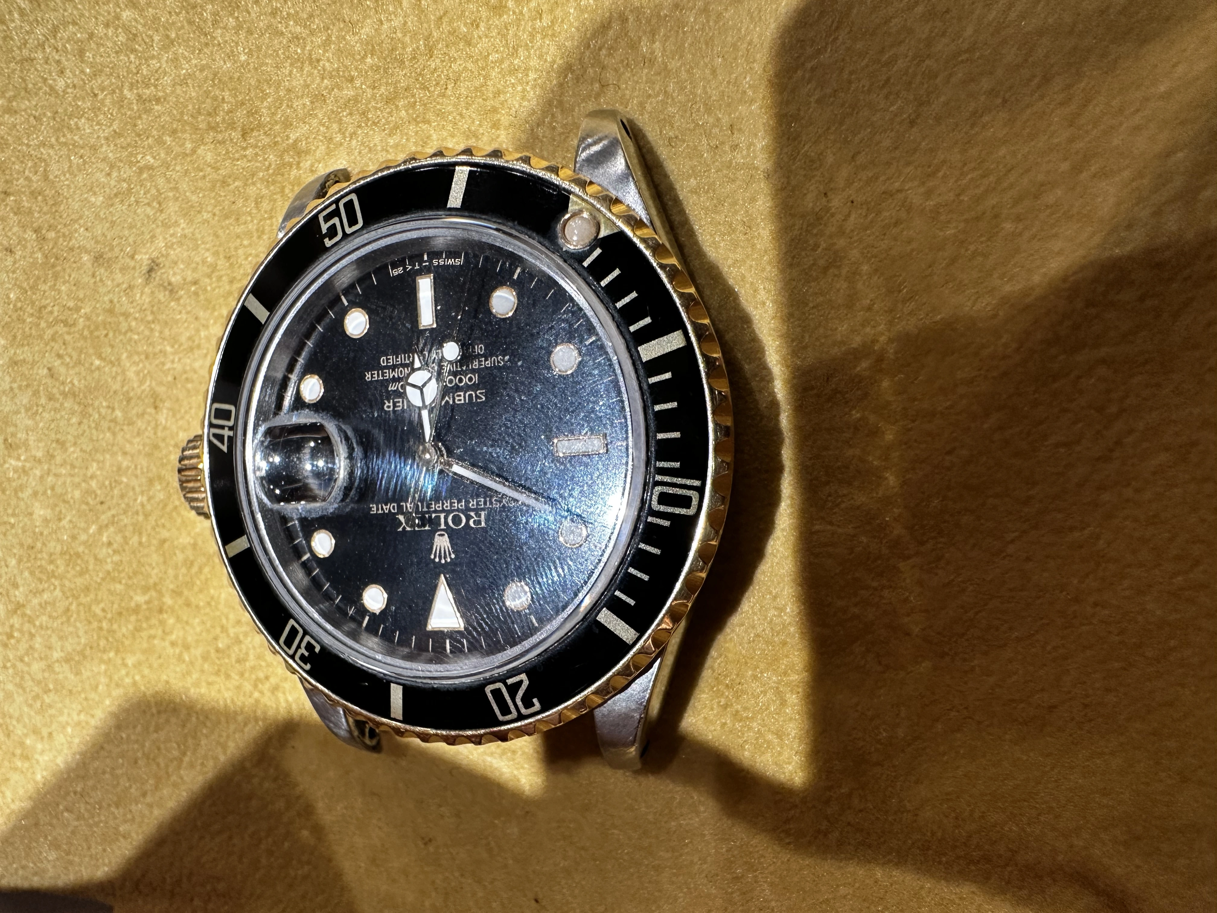

There is a touch of corrosion on the hands. Should I have these cleaned or just leave them alone ?

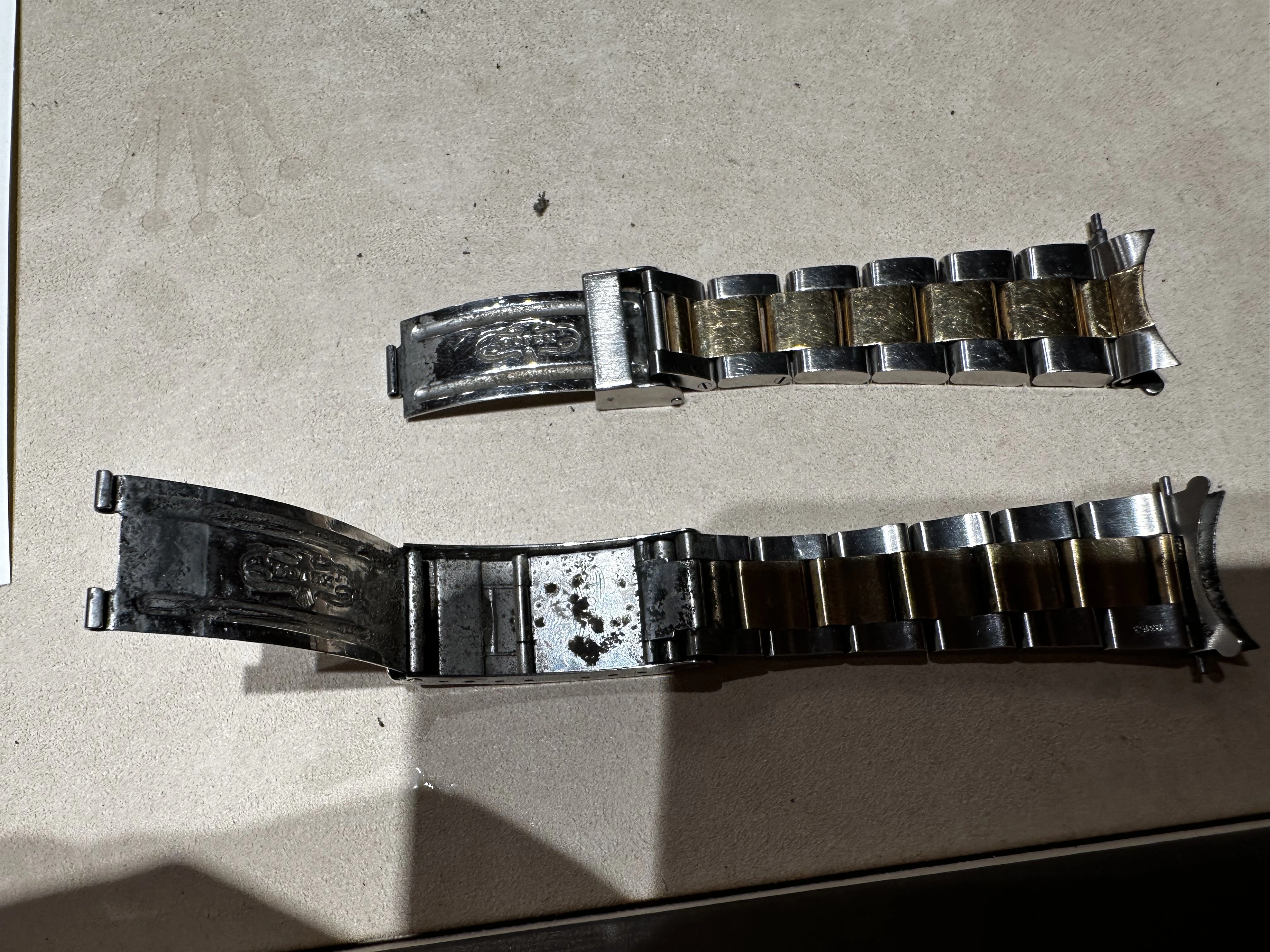

The watch bracelet as it sits is just dirty. Any darkness in these photos is dirt not corrosion. The hands have the only noticeable spots I can tell.

I'm a little biased in that I discovered Nesbits from Seattle a few years ago and have had several Omegas, and one 16610 serviced by them (all with outstanding results). Their servicing fee is not out of line with what the RSC would charge (in that it is about the same for a basic service). However, they will respect your desire to maintain as much originality with the watch as can be. That said, if the corrosion on the case back extends into the oring groove, not replacing it may render the watch not as water resistant as it should be. If it's bad enough, it might not seal at all.

Nice watch. Your Dad's lucky, and not just about the window and bracelet. That gunk will corrode steel. Happens. Good idea to get that cleaned.

Agreed about going to RSC on this one. Nesbit, Rollieworks and a bunch of others are capable of doing whatever repair needs doing (I'm guessing it is whatever happened to the back of the lugs), or leaving it imperfect.
IMO that damage is part of the Watch's story, so as long as it wasnt functionally problematic, I'd have it left that way.
But the above two could very well laser weld the case and grind it back.

I’m eager to get it back. I don’t remember the lugs being such a big deal. I’ll post better pics. I don’t know how those lug marks /damage could have even occurred???? I’ll update with the work
282
456
I honestly couldn't care less if it's just the lugs. It's part of its history and has no functional risks.
Avoid RSC, for sure. Overpriced and they'll destroy the originality.
Find a good independent watchmaker. But not just anyone (any watchmaker will do Rolex, but not everyone does it well). I'm not in the US, but I'm sure there are recommendations here on the forum. If nobody local is recommended/reputed, send it somewhere.
