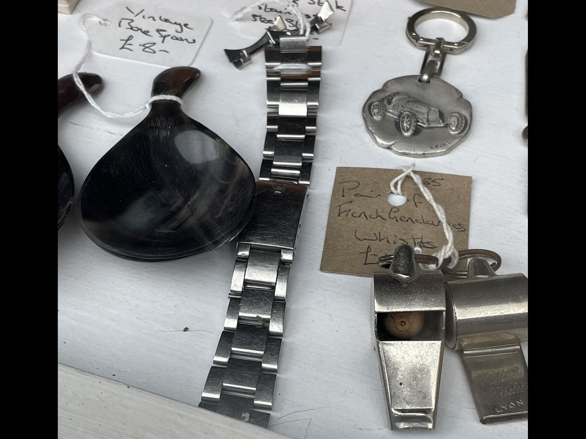

Not much to go on, but is there enough info in this (admittedly) poor photo to deem this fake please ?
thanks in advance, cheers paul

No, you really need to look at details to authenticate Rolex bracelets. Please post good photos of the inside of the clasp, showing all details clearly (scrolls, coronet, engravings, date code, etc.), when you have them. There should also be a reference number on the back of the last link (e.g. 78360). Even when the bracelet is legit, one or both endlinks are often aftermarket, so post good photos of both end link engravings also.

Thanks Dan. Will do. The seller ( a one man band) is away on vacation at the moment, so I cant handle the bracelet, but will post more photos when he returns
cheers paul

The end links that displayed together with the bracelet are for sure not correct.
The condition of the bracelet is also very bad. Very worn and stretched so depending on what the price is I would for sure look for something in better condition.
