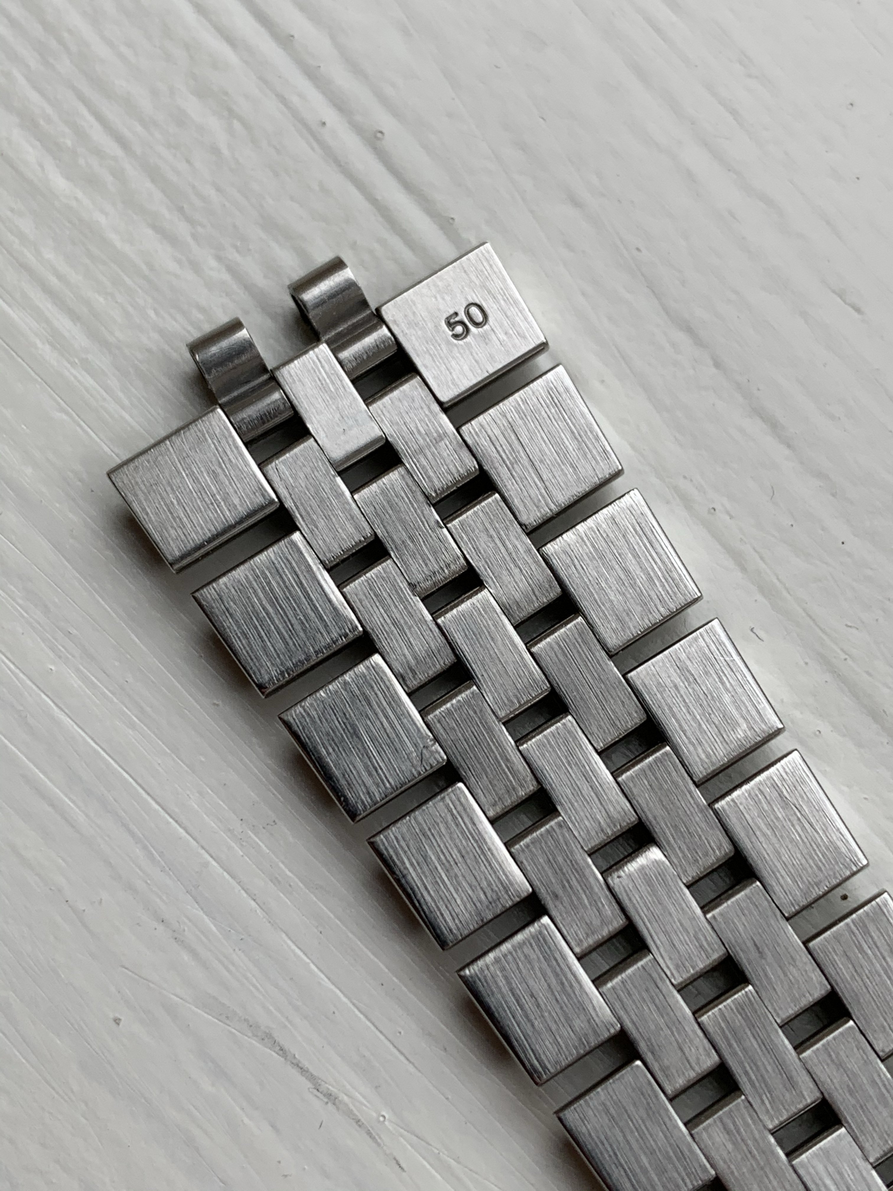

As an aside- if I recall the 62510h that was designed for the 550 and the 2mm spring bars has a specific stamping on the first link (think it was 50 or something like that), it was specific to just these endlinks for the 16750 as the rings were bigger. A standard 62510h won’t work Trying to cobble this together may be harder than you think. But someone correct me if I’m wrong.

This is the stamping for the correct bracelet as far as I read.
I don’t have personal experience here as my 16750 came head only when I got it, but I researched this about a year ago when I got the desire to try a Jubilee on it after reading so many rave reviews. I have a regular 62510h on another watch and ordered a set of aftermarket endlinks (shhh, don’t tell anyone), the fit was fine with 1.8mm spring bars (perhaps a little more gap than there should be), but after wearing it for a day or two I found it to be a bit too precious for the watch- didn’t quite suit it for me. So went back to an Oyster. Luckily I didn’t have to spend big money to find this out so make absolutely sure that you love the combo in the flesh and on the wrist for a few days before you spend this kind of money.
