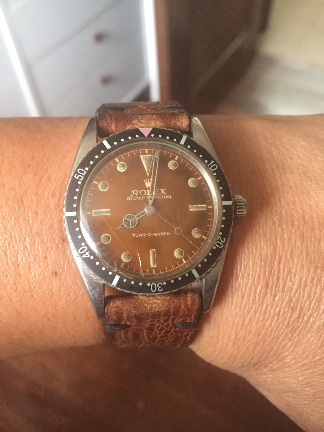

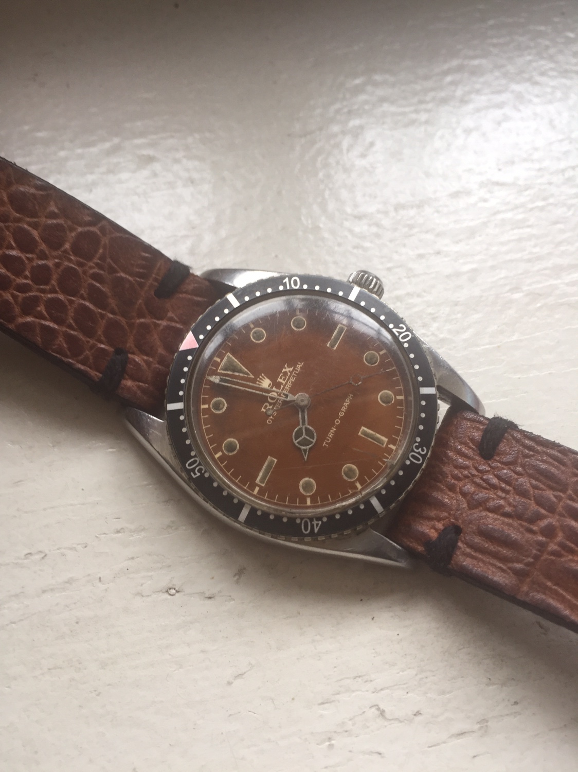

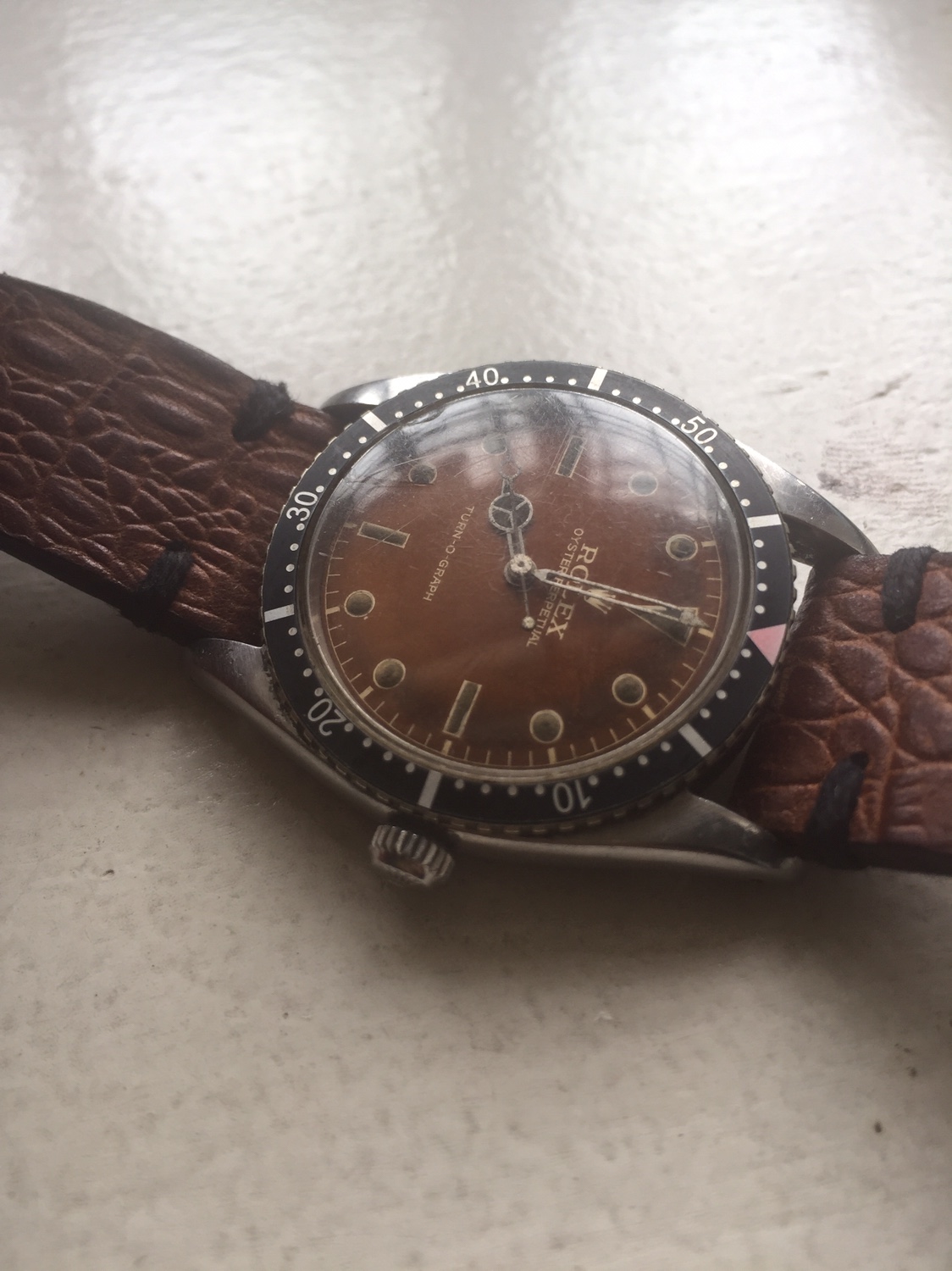

This Rolex Turn o Graph is being offered to me. The watch case looks to have been polished before. The dial is a beautiful tropical. The bezel looks like from a later model. The crystal is severely cracked. Movement shot will follow later.
Can any of our experts here spot a red flag? Thanks.

I could be wrong, but I don't recall any Turn-O-Graphs w/ Mercedes hands. If they did have them, they were rare compared to the other models and hence would be more valuable.

never see like that before... what reff number this rolex?
6202 as in the title 😉
Nope they are acceptable from my research. But it's noted" as example exist"

The hands are perfectly acceptable, the bezel insert is aftermarket.

Does it say Swiss T<25 at the bottom? It kind of looks like it to me in the photos. I'm thinking it should say Swiss. Also it should have a hyphen between Oyster and Perpetual.
