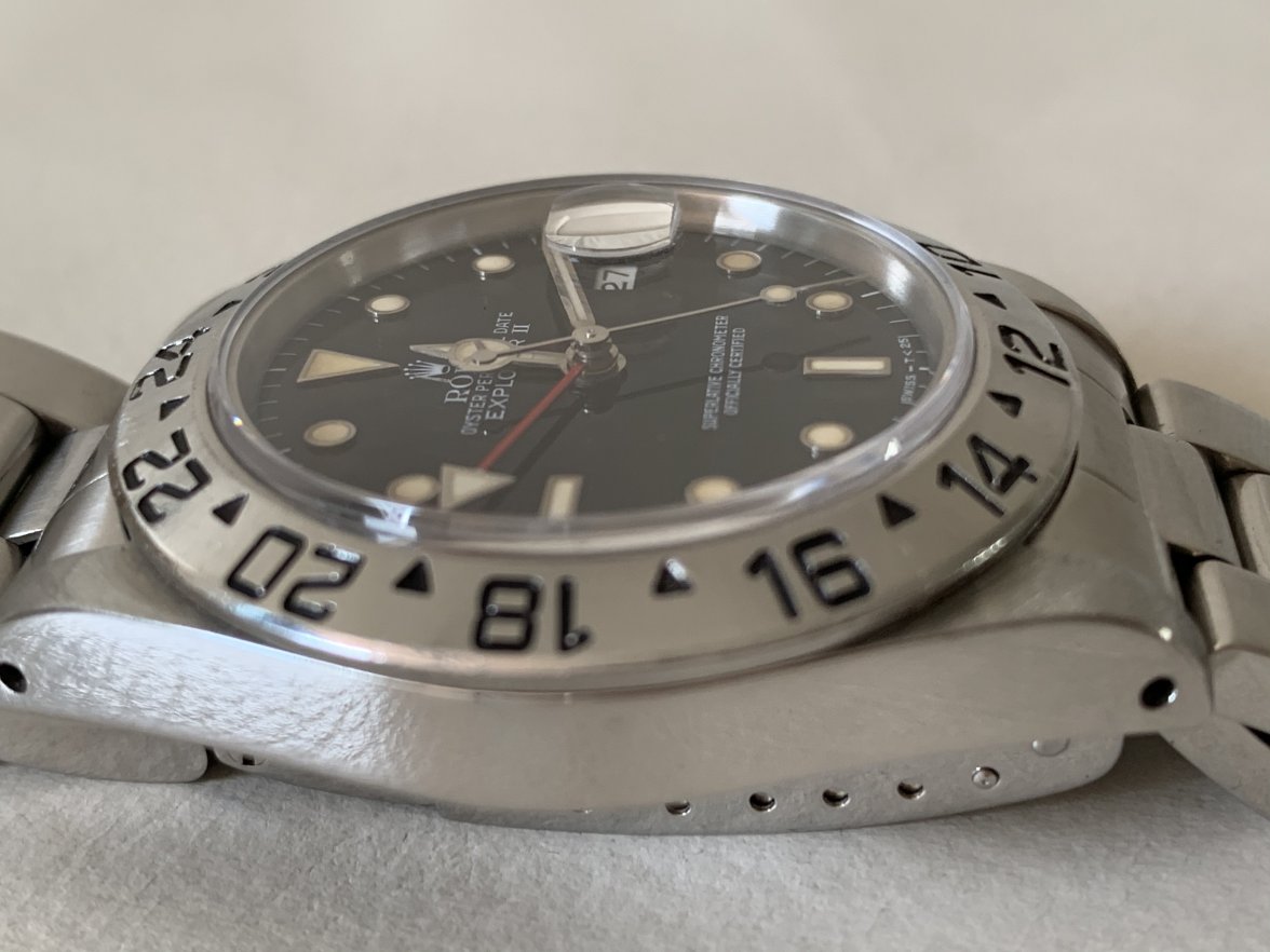

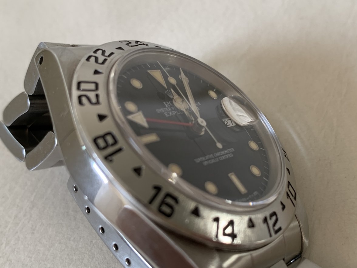

Recently I realised my 16570 has been stopping at 12’oclock after the power reserved had been drained up and its consistently been on that spot all the time and I’m wondering is it a concern for me. It’s keeping excellent time and power reserve is a 2 solid days. I notice the second hand placement might be higher then usual is that a concern or normal. Pardon for the lousy shots on my iphone.

Not sure what you are implying here
Certainly, the seconds hand is the closest hand to the underside of the crystal
are you implying that the second hand constantly stops in the same place, all the time, even when fully wound?
Or just that it seems to stop at 12o’c when wound done ( by chance)?

Thanks Sherbie, you are correct the second hand stops at the same spot all the time after a full wound. I look through a loupe it seems like the second hand is slightly curve at the tip and I’m too sure is it touching the crystal at 12’clock position hence causing it to stop. I’m not too sure either whether the crystal is original to the watch and the correct dimension of the height or thickness. How to determine the crystal is original? Thanks alot.

I can't imagine your second hand shifting, it can happen but usually on much older pieces.
My suggestions
1). Give it a good full wind (40 spins or till it gets tighter even though with the clutch it shouldn't get tight BUT if it does don't force it)
Set it down beside your bed with a note indicating the time you did this. Leave it for 2 days and make note of the time it stopped on the dial, subtract and see how long your power reserve is lasting. It should be between 36-42 hrs. If its not anywhere near there take it for service.
2). If that all pans out and looks normal repeat the process and now after 24 hrs of sitting see how much time it has lost or gained.
If the second hand is indeed loose I imagine you would see a shift if you turn the case over but I don't think that's likely.
