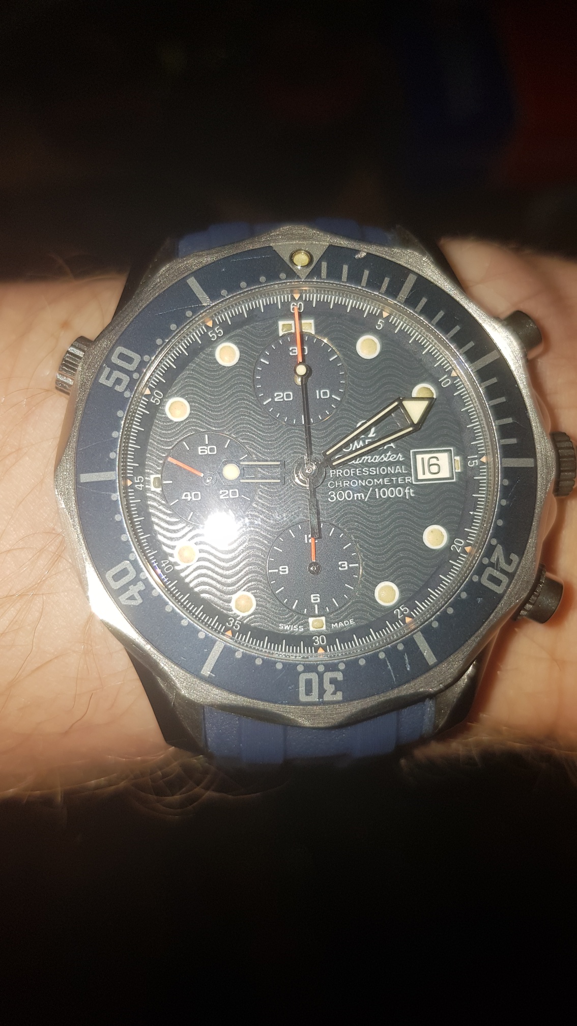

Recently I bought Omega Seamaster Professional Chronometer 300m through chrono24. The watch was originally bought in 06/2000. I discover that luminous material is missing in one place on the dial or turn black (9 position) and rest of them practically are not glowing any more.
Any idea how much would cost me to restore that luminous material on the dial and watch bazel?
Any recommendation would be greatly appreciated 😀 (UK)
Thank you.

It has an original tritium lume dial which is no longer glowing. The hands have been replaced at some point by those with Superluminova lume. You can get a replacement dial with SL lume which will glow but its not cheap. Think maybe £150 for the part and then you need to pay for fitting. The watch will have been manufactured prior to 1998, that is when the transition to SL lume was completed.

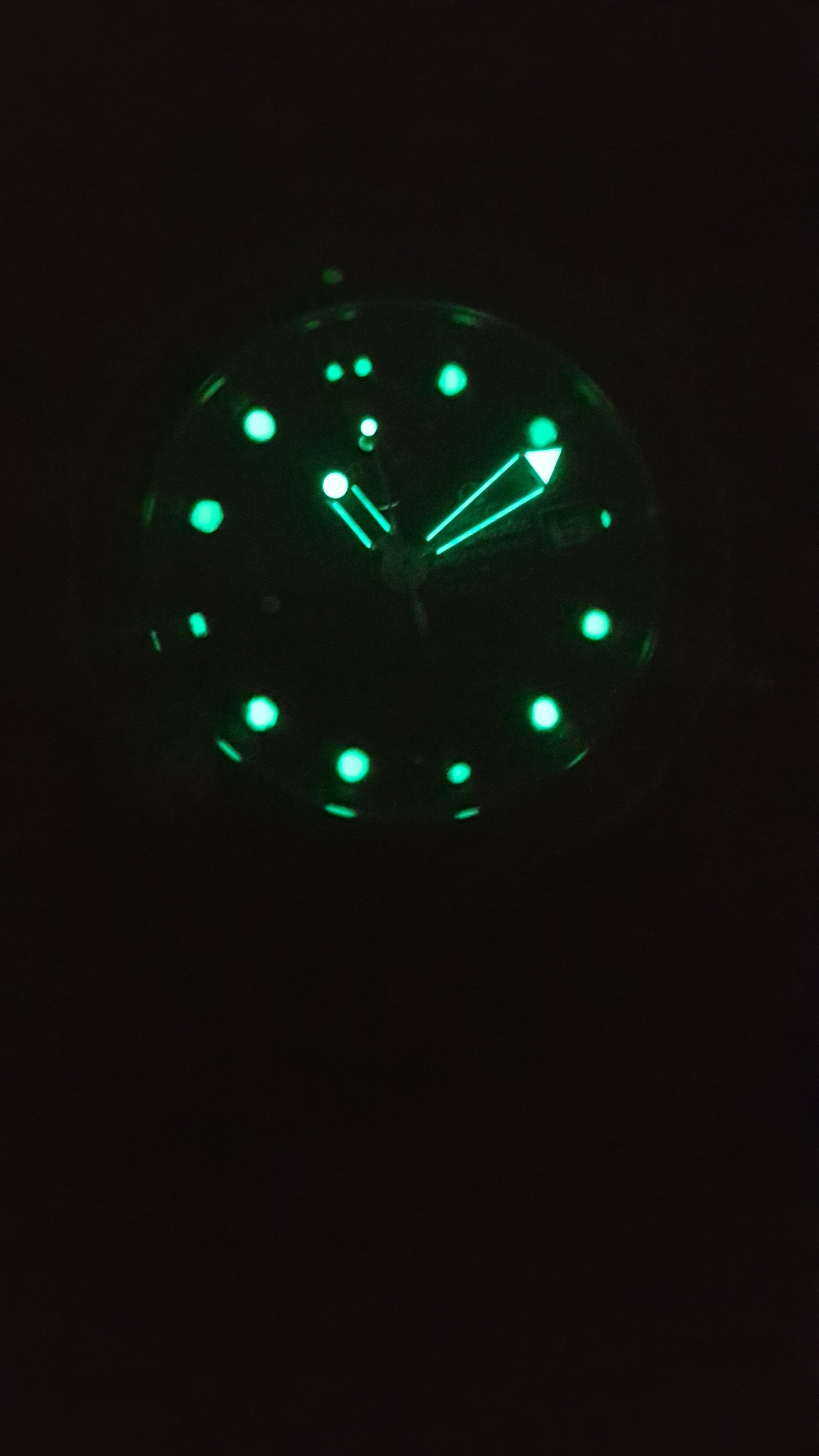

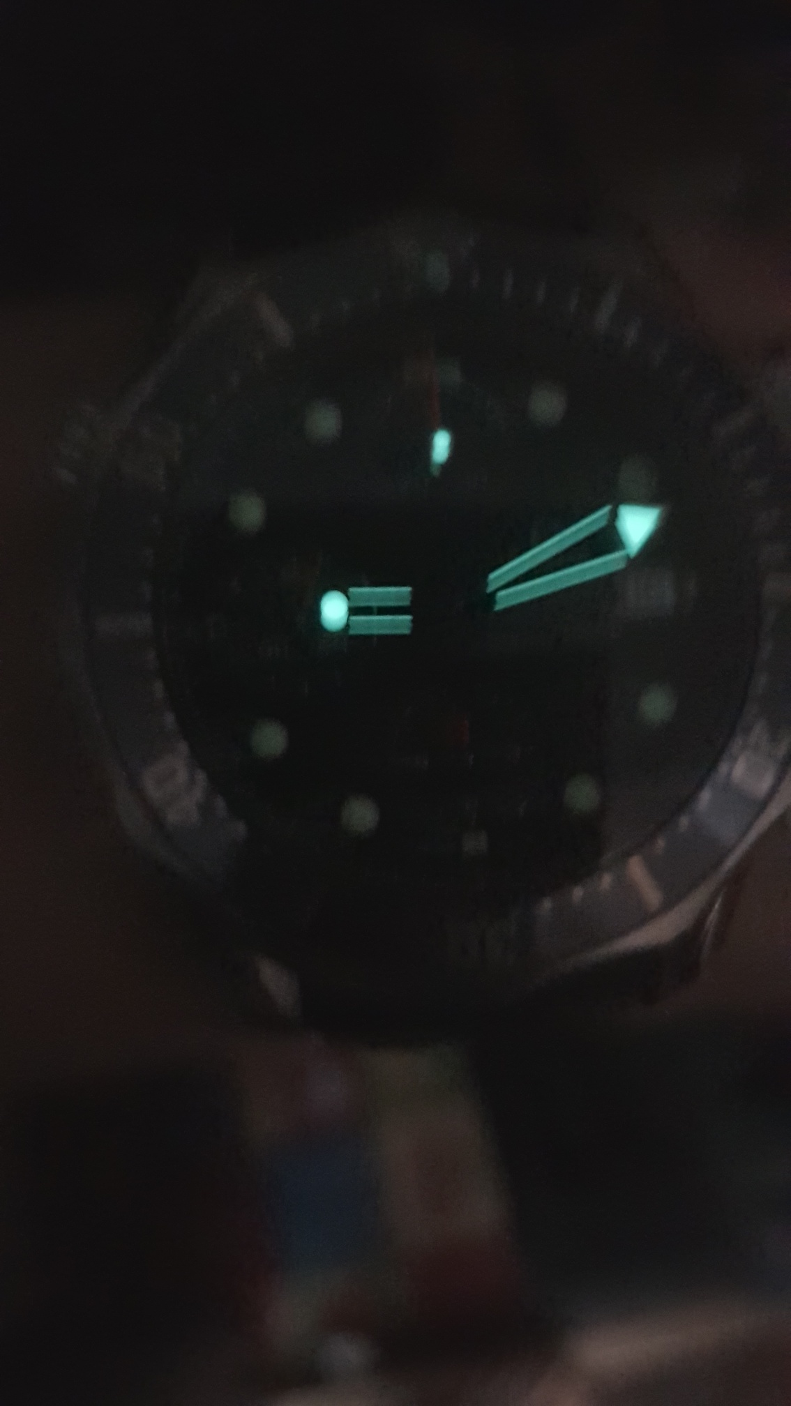

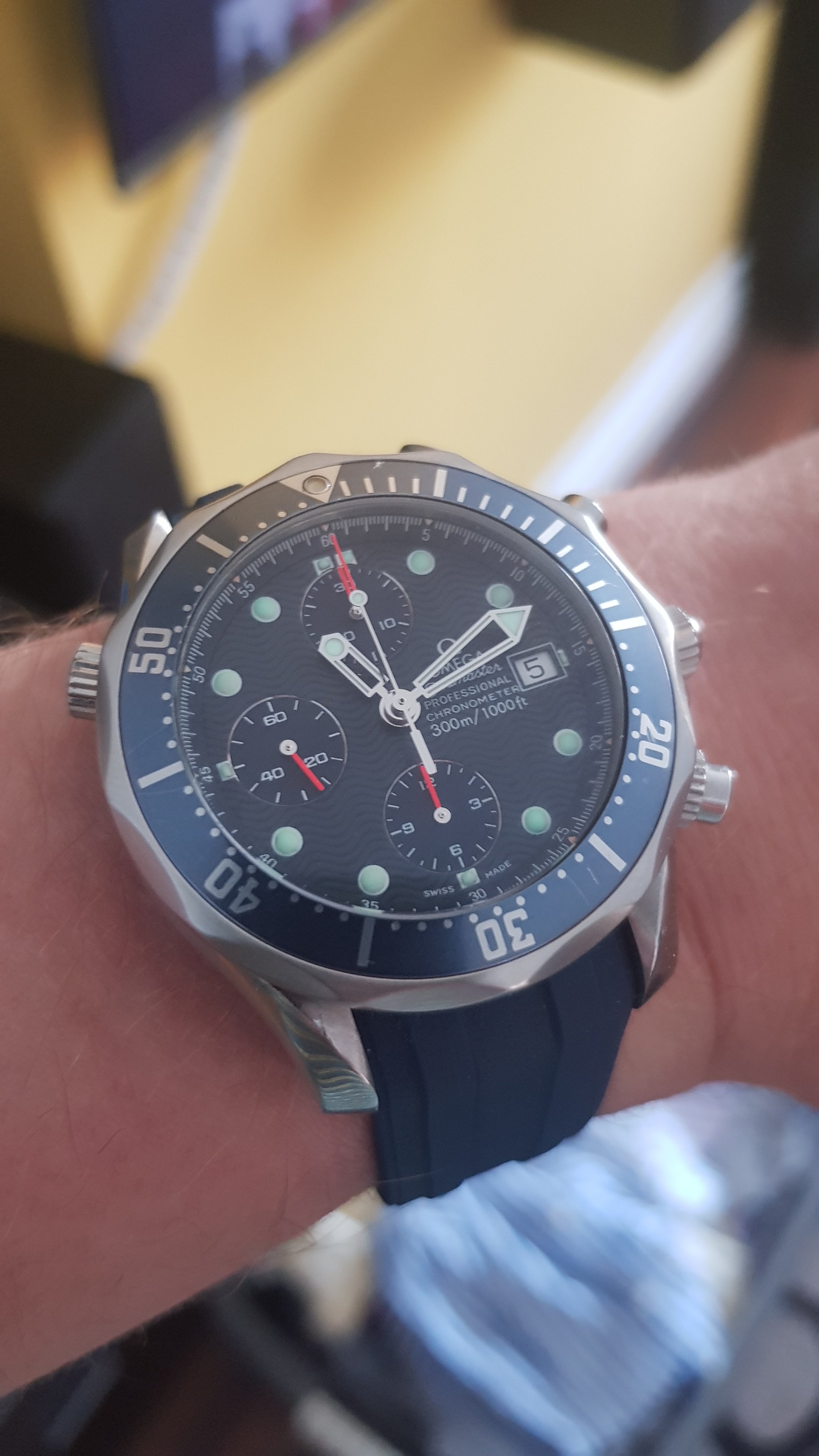

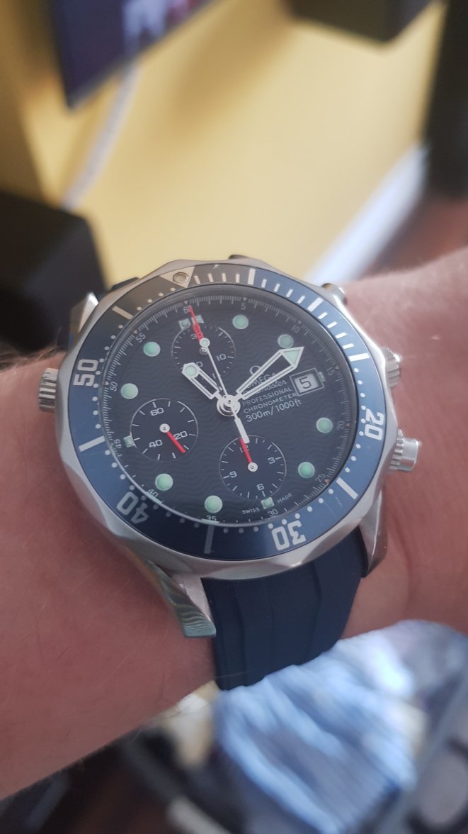

The watch was restored and it looks beautiful😀. I also replaced chronograph hands.
It was done by Arnold from London (https://www.watchserviceuk.com). Full service cost me £240 including dial re-lumination so I think it was really good price. I paid extra for chronograph hands.
I hope he will help many of you in the future.

Hi, the watch looks great. Did they do a case polish as well?
361
559
Looks splendid. Did you replace or repaint the subdial hands?
419
185

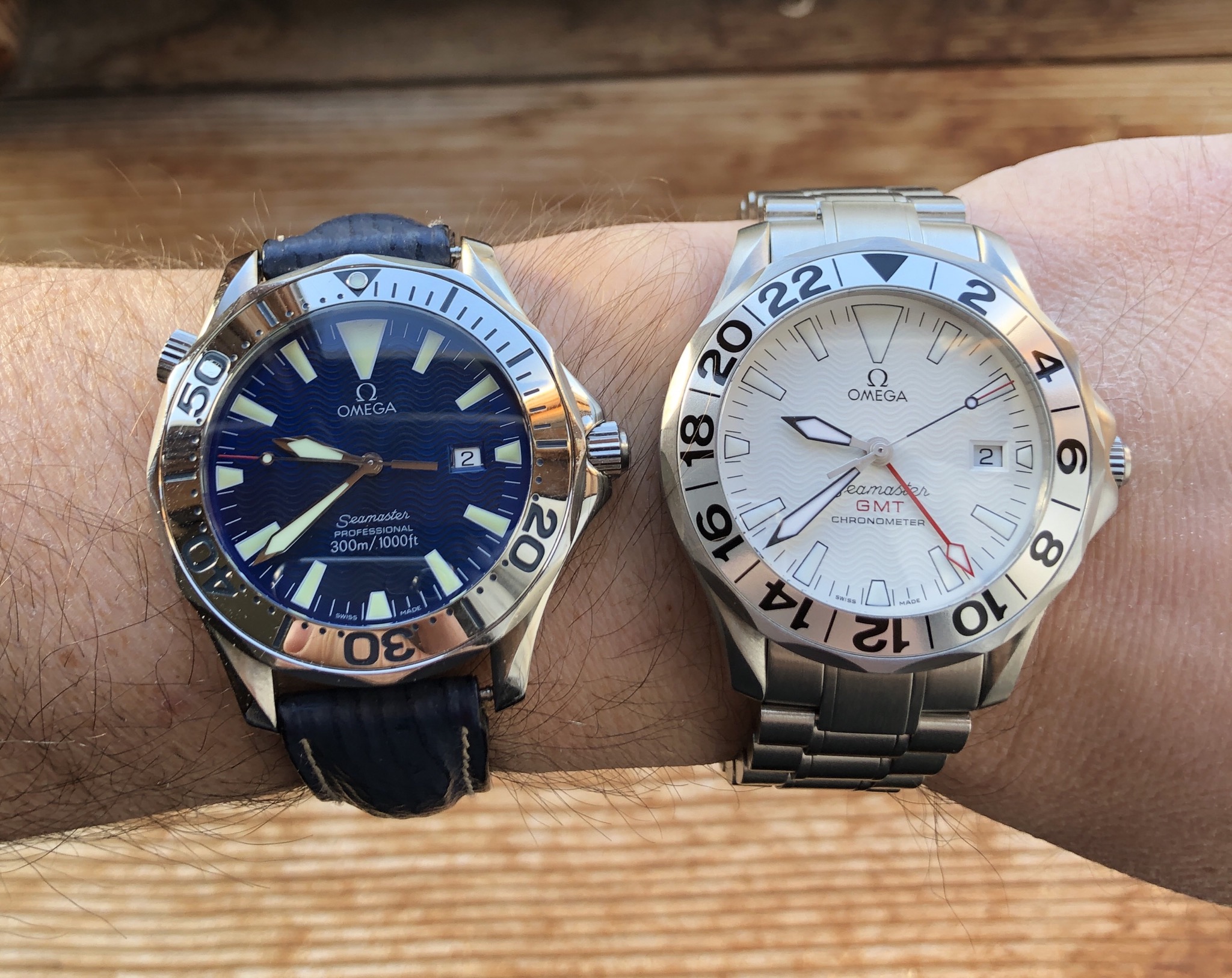

Did you have a choice on the colour of the relume? That new SL looks greenish (in daylight), the same as the new Omega stuff. Personally, I think pure white would look better, and wonder if this stuff just only comes in green tint.
10,305
16,126
You can get pure white SL. It comes in many different shades but the colour with the highest luminescence is the yellow/green shade Omega use. Hers an example of whiter lume (RHS) next to the std yellow/green:
