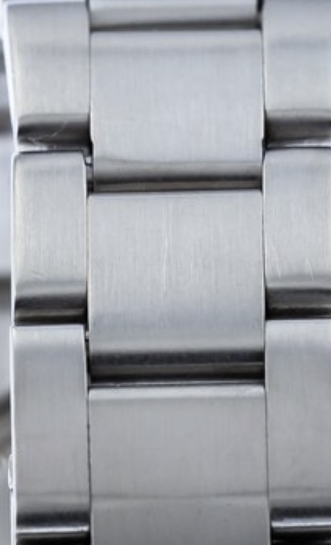

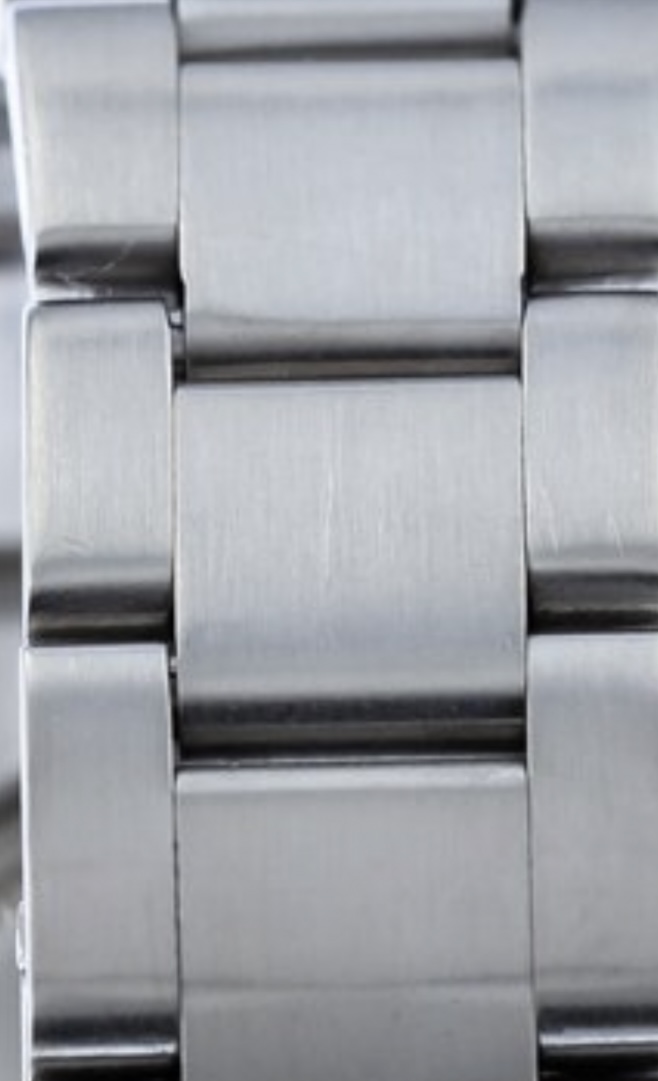

I was actually talking about this kind of lateral wear
But sleeves make sense inside the links as laser welding in there would be tough I’m sure.
24,801
55,084
Yes, laser welding is done to fix the cosmetic issues, and other approaches are used to tighten the links. Rolliworks also puts a lot of effort into restoring the shapes of individual links, which are often bent/kinked when the bracelet is disassembled. My sense is that good bracelet restoration takes a lot of skill and experience. It's not just replacing pins.
