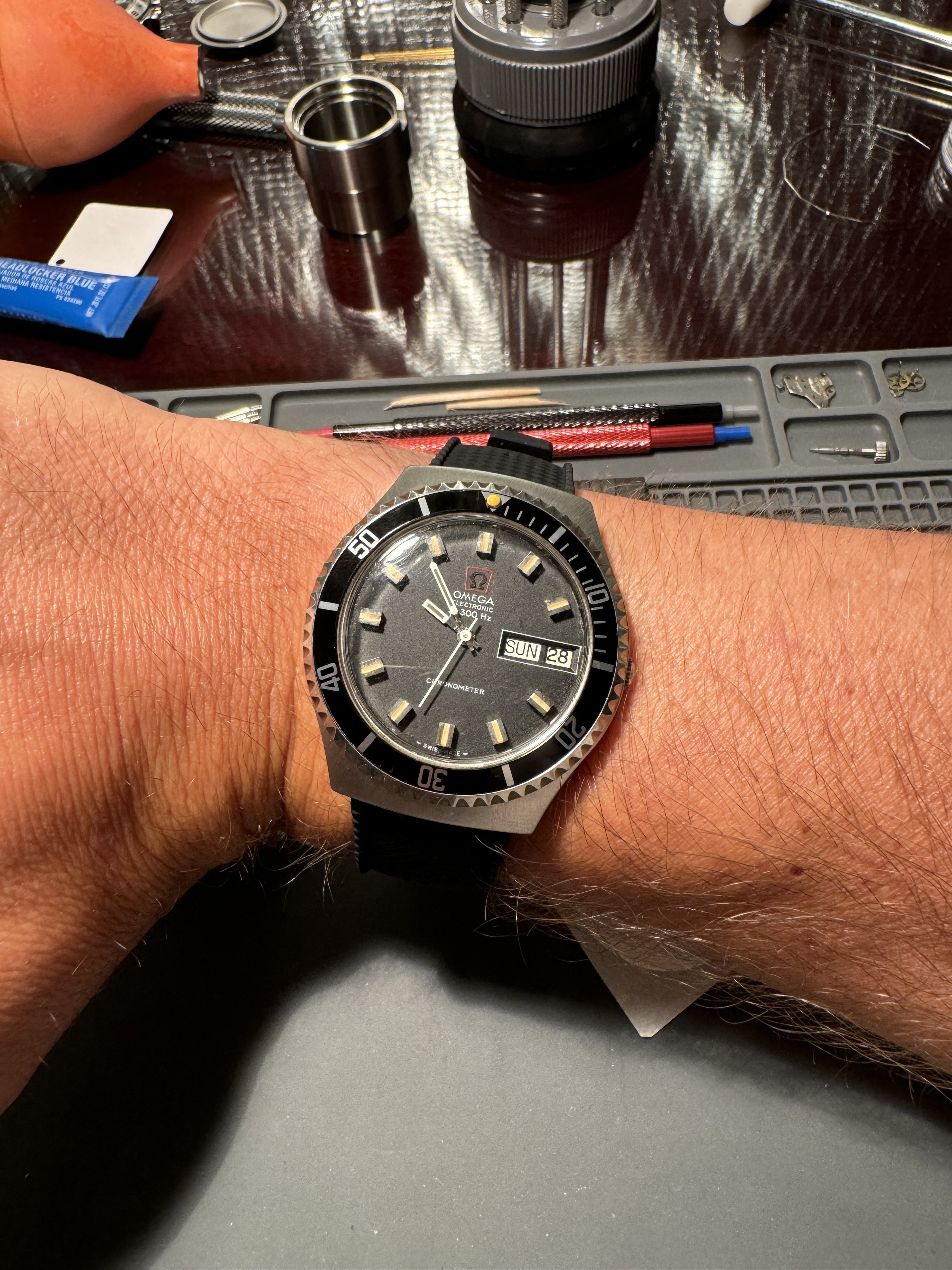

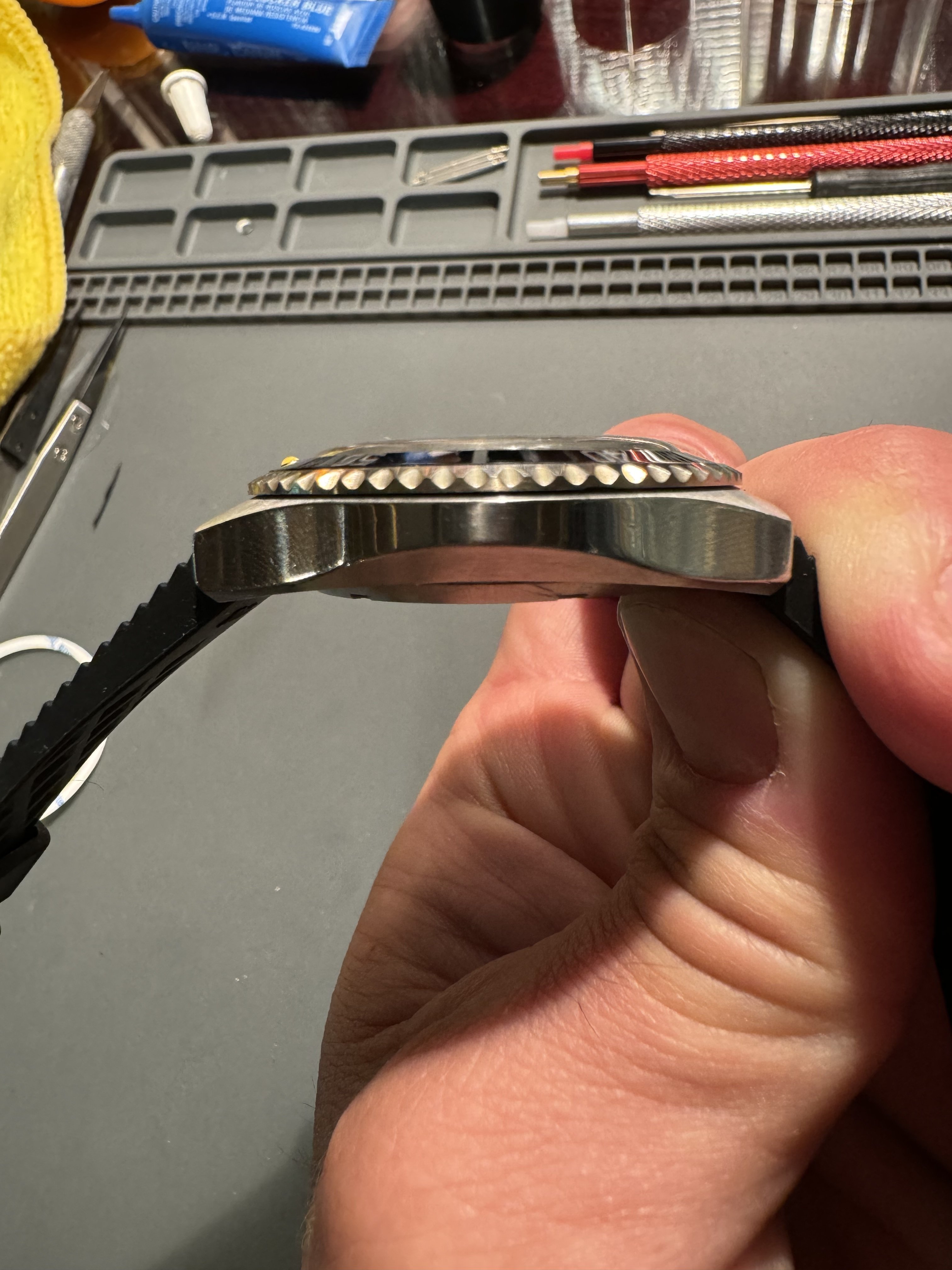

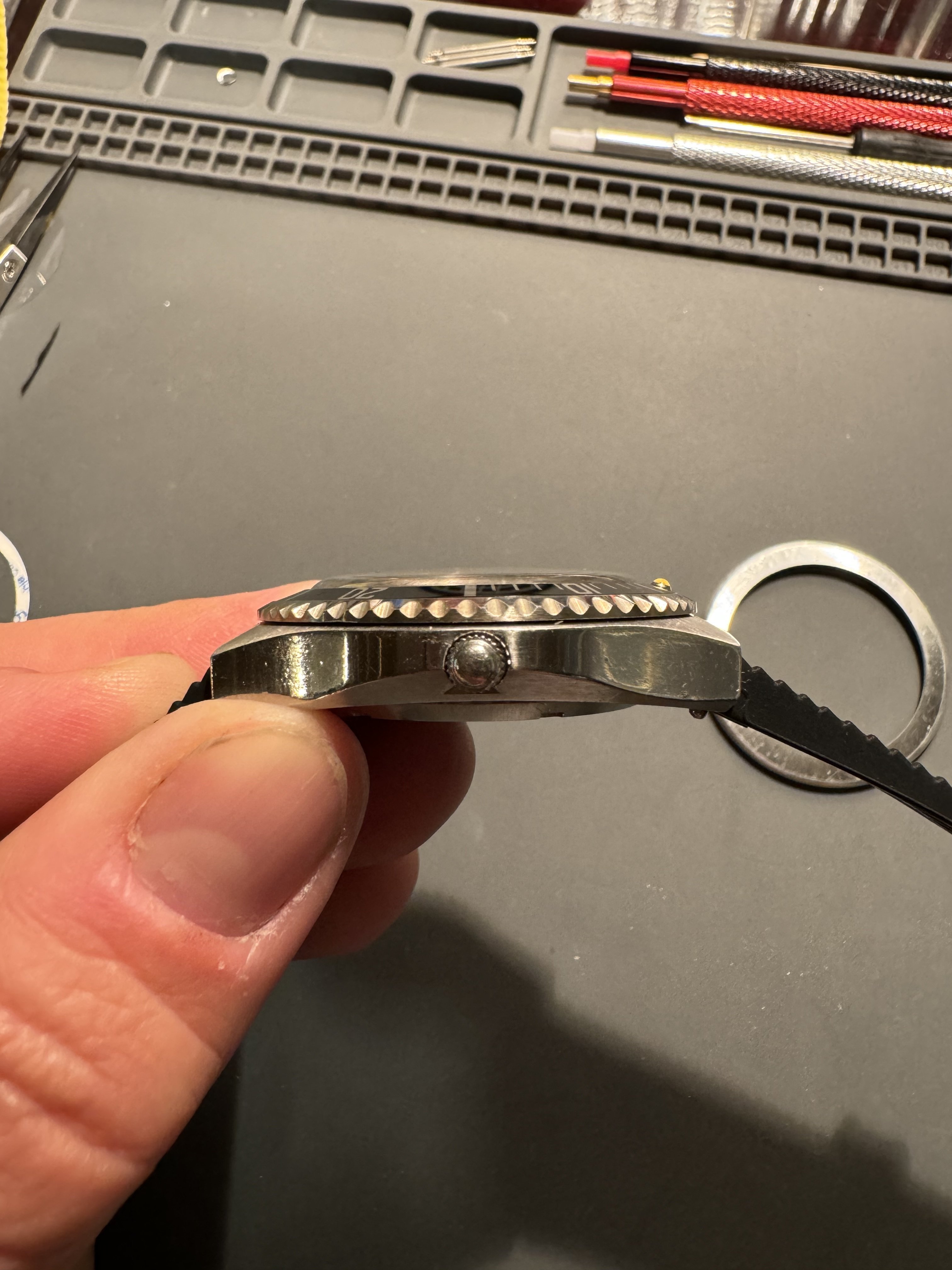

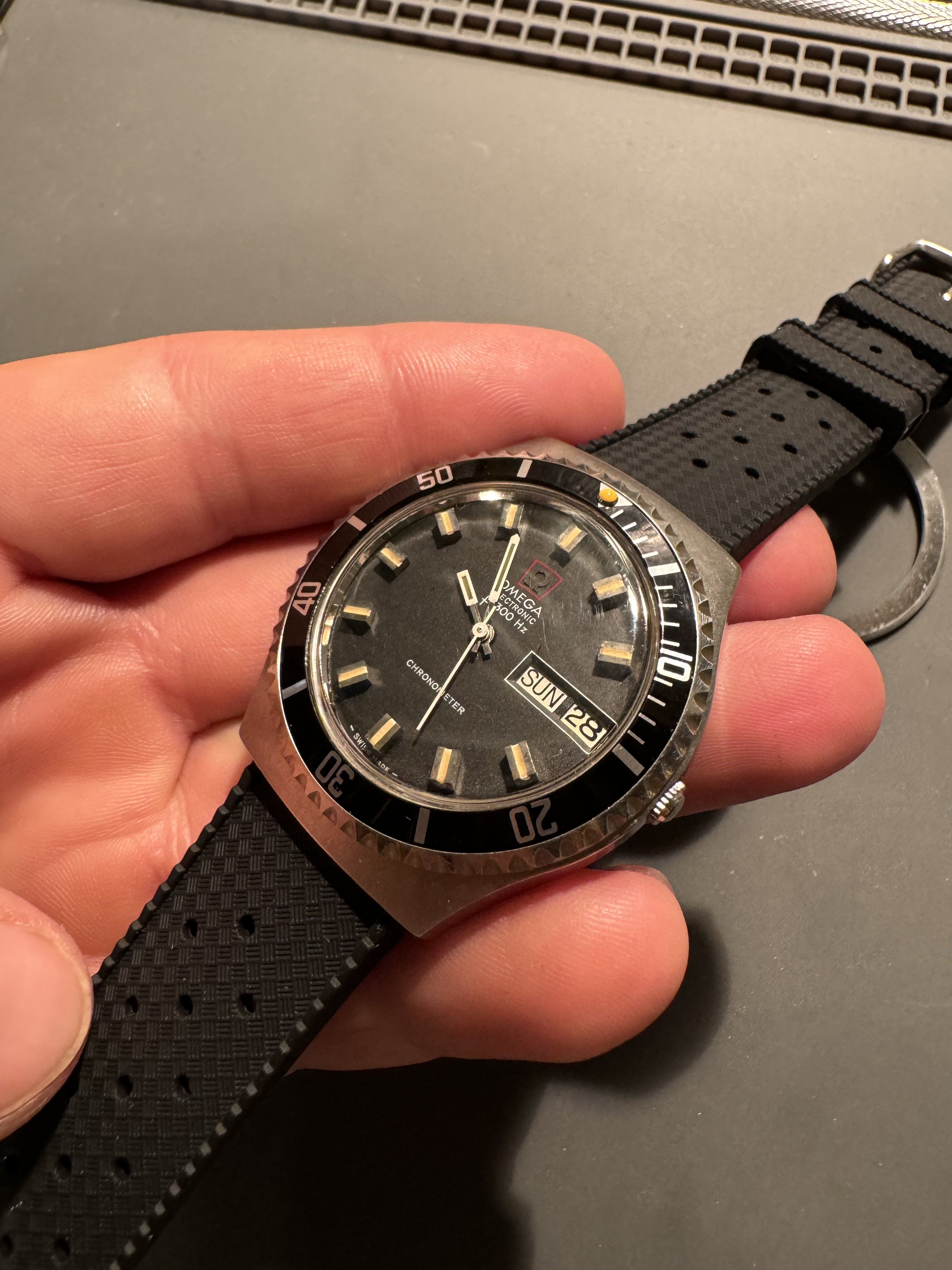

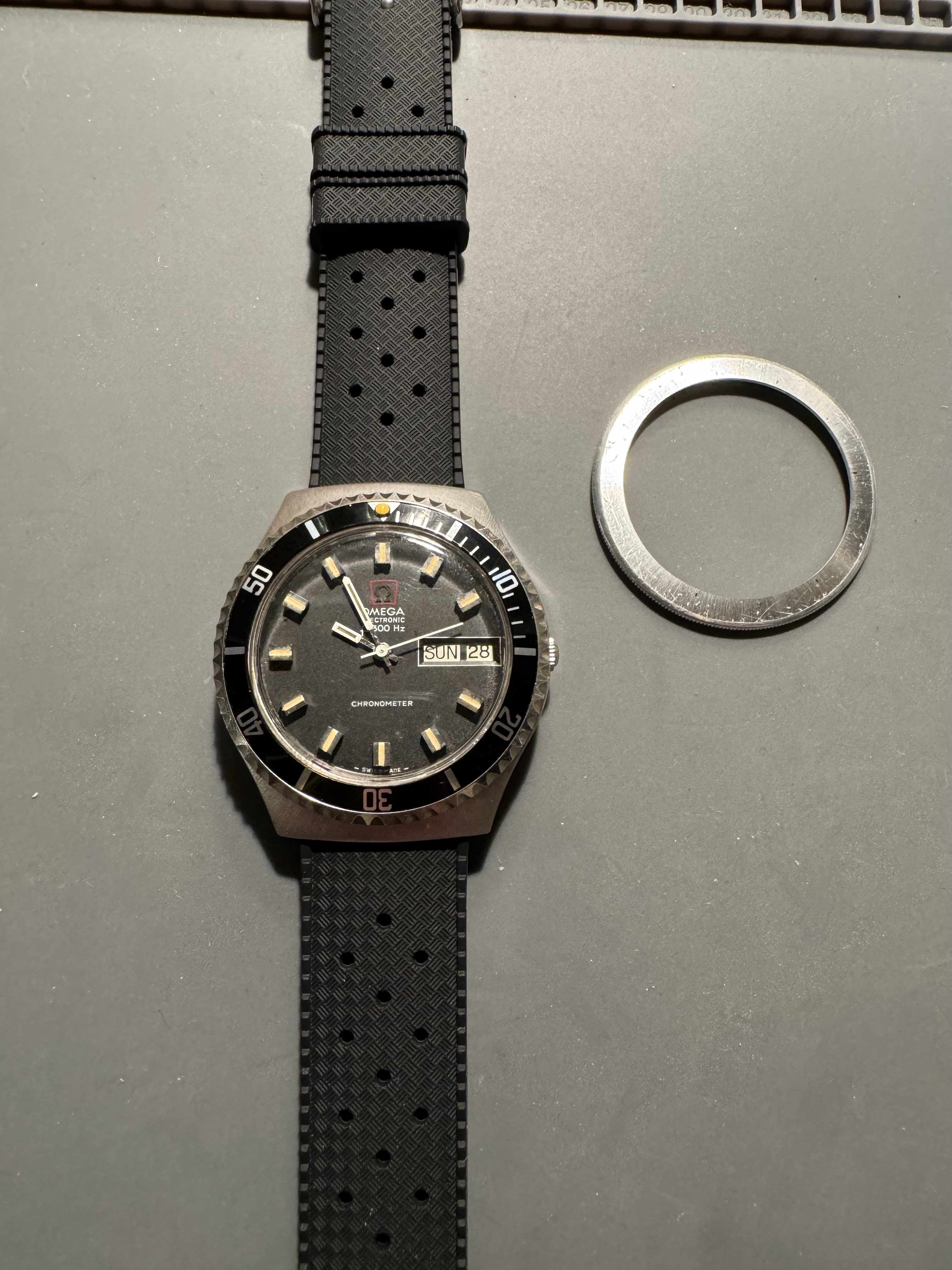

Old bezel was worn (like most) so I decided to make a custom bezel. I still have the original bezel to restore to original condition but I think this looks nice for now. Let me know your thoughts!

For watches like these where a factory bezel isn’t available (I assume like the SM120, don’t know this model), I see this as the only way to make them whole again. Nice hack.

What bezel did you use to replace the worn one? I have the same watch and want to do the same thing.

It looks like a sub bezel on the watch. Its a nice mash-up and one I would consider myself. Well done.

39.5MM Vintage Case Sapphire Glass NH35 Watch Accessories For Seiko NH35 NH36 Movement Watch Case For Retro Submariner Oyster
https://a.aliexpress.com/_mMKaBvQ
Here is the case I used that I took the bezel from. I then had to use a dremel and various grit of sand paper to thin the bezel enough where the locking ring would fit and hold the bezel in place (you will end up removing all of the clicking steps and a bit more to make it fit). The original bezel didn’t have a click feature either so it stays true to original functionality. Hope this helps.

Looks good, did you notice the parel pip is not centred 😀

You should hang out with my brother.
“You did a great job painting your house- did you intentionally not paint those shutters on the back?”🙄
