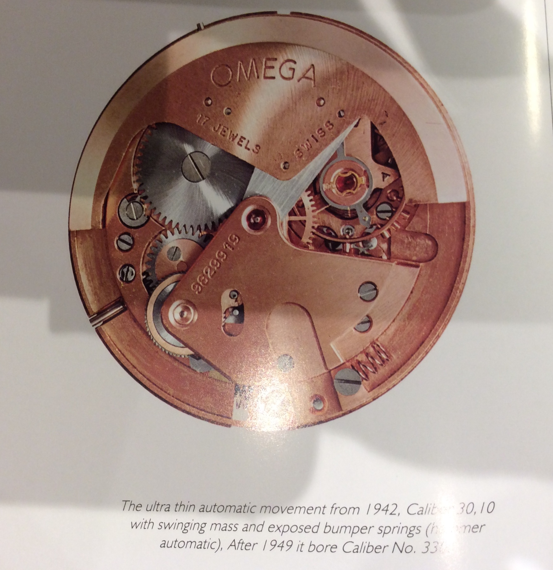

From reading Kreuzer’s - “Omega designs”, I believe the first omega self winding movement was the Cal 30,10 which was first put into production in 1942 and became the cal 330 in 1949. This was a “bumper” movement. Not sure what on line sources are out there to read.

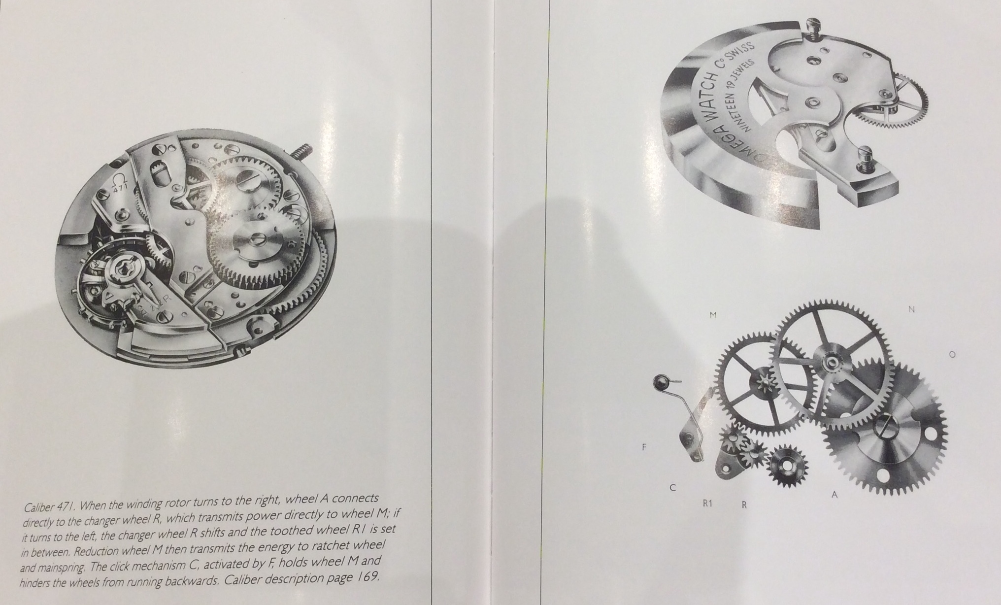

In terms of full rotor winding I believe the Cal 470 (modified to 19j or 20j - 471) was the first omega bi-directional rotor winding movement but the 455 ladymatic was actually the first omega rotor winding movement
