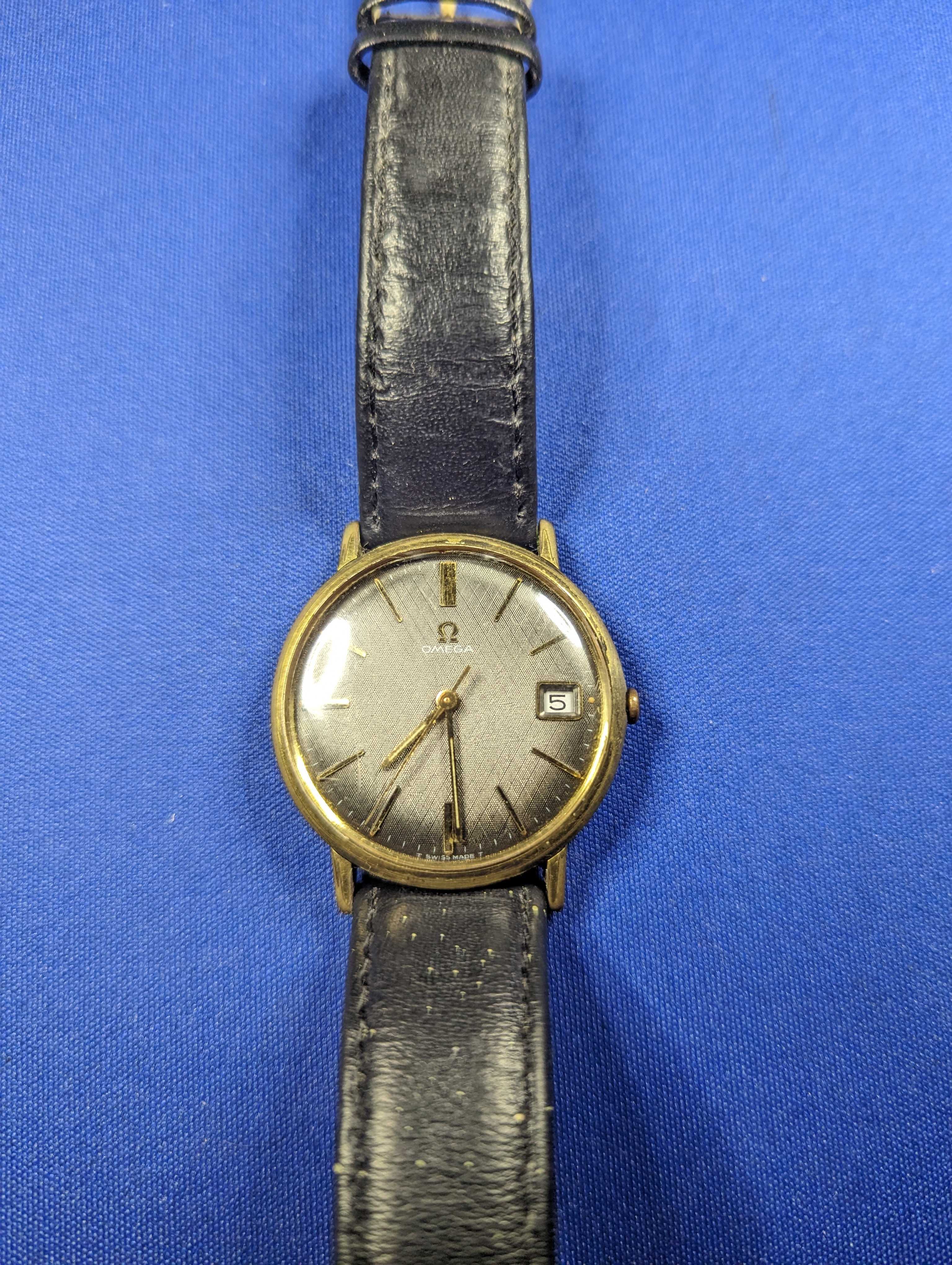

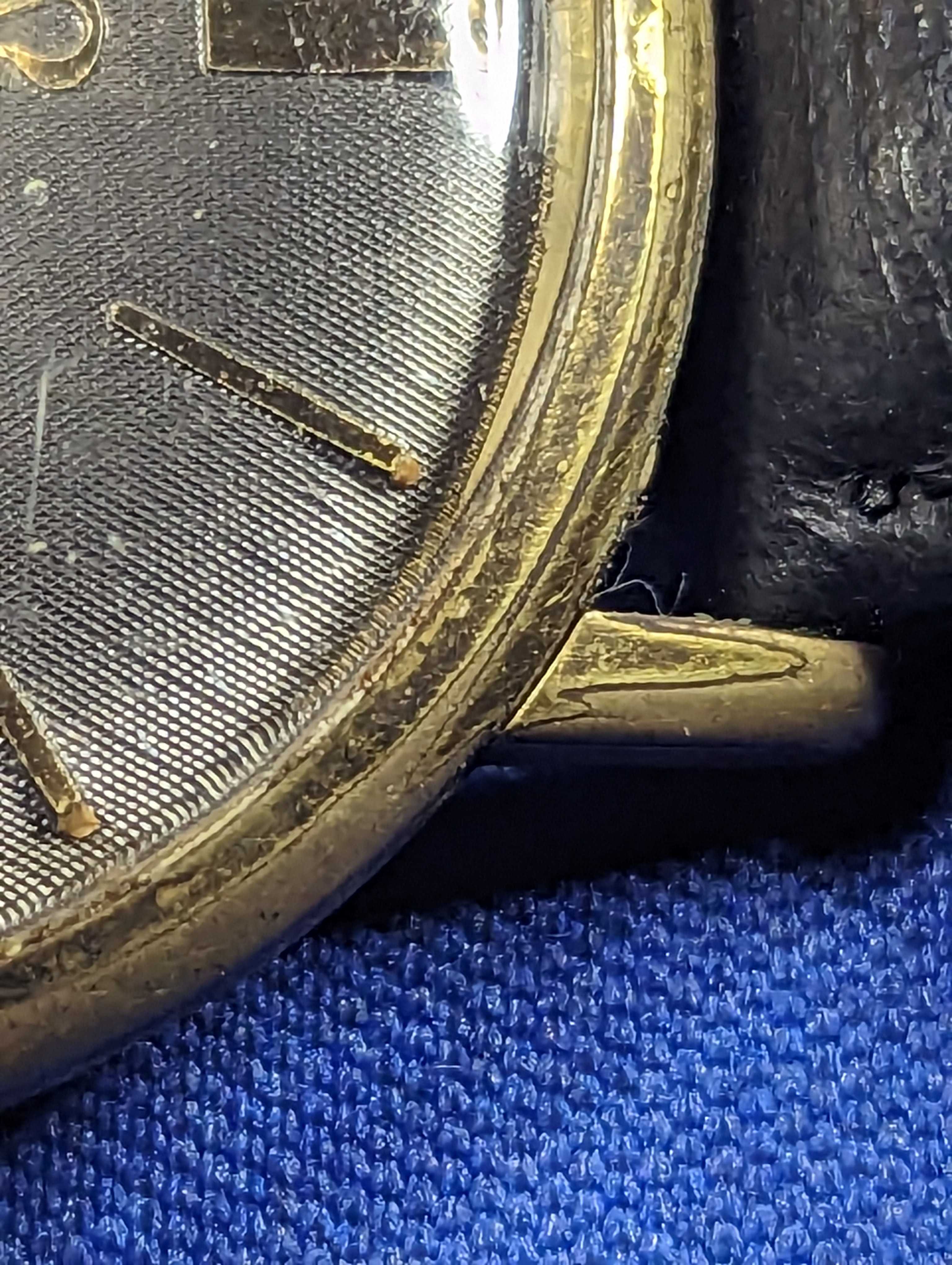

Hey All,
Continuting my journey of learning to service and fix my own watches i've FINALLY found a watch with a nice waffle dial. The movement is a Cal. 611 which i'll be servicing shortly (any tips or things to watch out for would be great?!).
However the case is beaten; it's been polished so hard that there is very little of the plating remaining - my question is should I try and find somebody who can re-plate the case or admit defeat early on and find a replacement case?
From my understanding the Cal 611 is based on the 601 series so should be able to find something close?
As always i bow to this forums god-like knowledge on these vintage watches so any info, thoughts, or laughs would be great 馃榾
Thanks,
Toby

I think the issue with most jewellers doing it is the prep work. It鈥檚 relatively minor when rhodium plating a ring, but to get a good finish on a watch there鈥檚 a lot of prep work involved to get a good finish.
it might be worth talking to some uk watchmakers (WatchGuy, Mitka etc) to see if they have recommendations for case guys.

Perhaps someone might jump in and let us know if they have ever had an object electroplated that resulted in a durable, wear resistant , long lasting result. I don鈥檛 know how the case would have been plated by Omega (or the case maker), but I am 99 44/100 % certain it was not simply electroplated. Let us know what you decide to do. Oh, and, the Omega movement you have chosen to service might prove to be a challenge, depending on what your watchmaking experience has been. Best of luck!

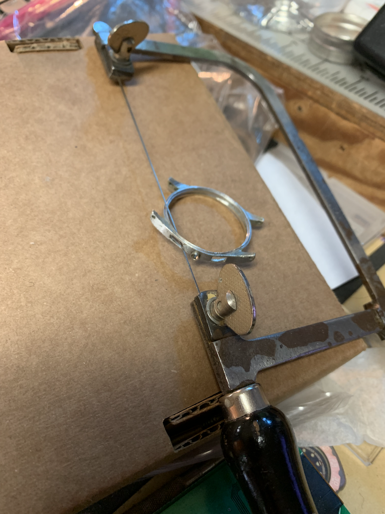

One mistake I made in the 1990s was not buying more cases. I bought movements. I often use the rule that if it was expensive then it will more likely hold value. (electronics excepted.) In a lot of ways I am finding that some of the less desirable stuff sells for about the same as it did 30 years ago.
There were a lot of cases scrapped when the regulations changed. So there are more movements than cases. I am still looking for a case for my 351 bumper automatic. Only been searching a month. I suspect this will be quite competitive.
I had 3 or 4 chrono cases and 8 or 9 movements. I did get a lot of chrono case parts. None are drop in replacements. The stuff out there seems quite picked over. I actually took a jewelers saw to a case today. So I can get the pusher to align.
This is the case I took the lathe to as the movement was a bit large. Most likely this case was for a Valjoux movement. I have landerons. There is a slight difference in the pusher angle and movement size. Curiously I keep getting cases for cheap what fit the Valjoux movements and offered as landeron. I only have two Valjouxs as they sell for 5 to 10 times the landeron.
Once the back and bezel are separated from the core, it is impossible (or really difficult) to know what sort of watch it goes to.
In the case of my butchered case I am going to need to sand off the plating, then solder back parts I removed so the plates I do have will fit.
The other issue was to get the new case cores, I also got more worn out plates. I am still on the fence as to which is more difficult, case work or hairspring work.
Anyway welcome to the club (One of the more exclusive ones.) I look forward to seeing the progress on this.

Yeah ive just spoken to a really handy chap who explained, while he can do it, its REALLY quite simple (plating stainless, not brass) and that a kit would set me up for years to come so i spoke to a gent who sells the kits and hopefully have one coming next week. He talked me through the whole process and seems rather easy to be honest as long as one is somewhat used to working with metal. I'll update the thread on how i get on.
I've also found that several other cases which look super similar fit the movement and dial so thankfully ive some options while i work on the movement 馃槈
55
53
So to update this thread for anybody reading it:
Movement was serviced and to be honest was pretty simple, had to be careful with the tiny spring bar and sort a jewel out but was otherwise a treat to work on. Watch is now running nicely with 215amp and +2sec so happy with that.
Case - I ended up getting the plating kit - it's fun and really quite easy. One has to be sure to mirror polish the surface (SS) before even attempting plating. So a set of diamond polish and dremel does a pretty solid job. Then it's just a question of cleaning the part heavily with detergent and then running through the plating process (I bought a three stage set from a UK company - https://gsplating.co.uk/ - the dude was SUPER helpful, send instructions and all sorts of tips. I'm really happy with the results and have now replated several watches. I've got to the point that i choose to keep some of the heavier original scratches in and polish out the lighter ones to leave some patina in. If you're considering giving plating a go then you should try - for less than the price of a 70s Deville you can get the full kit with everything you need which will easily do 50+ watches with the solutions (some of them are somewhat reusable).
I'll try and post some pics of the watch this week.
Now to find me a decent crystal press and finally get the hang of fitting those pesky tension ring gits!
