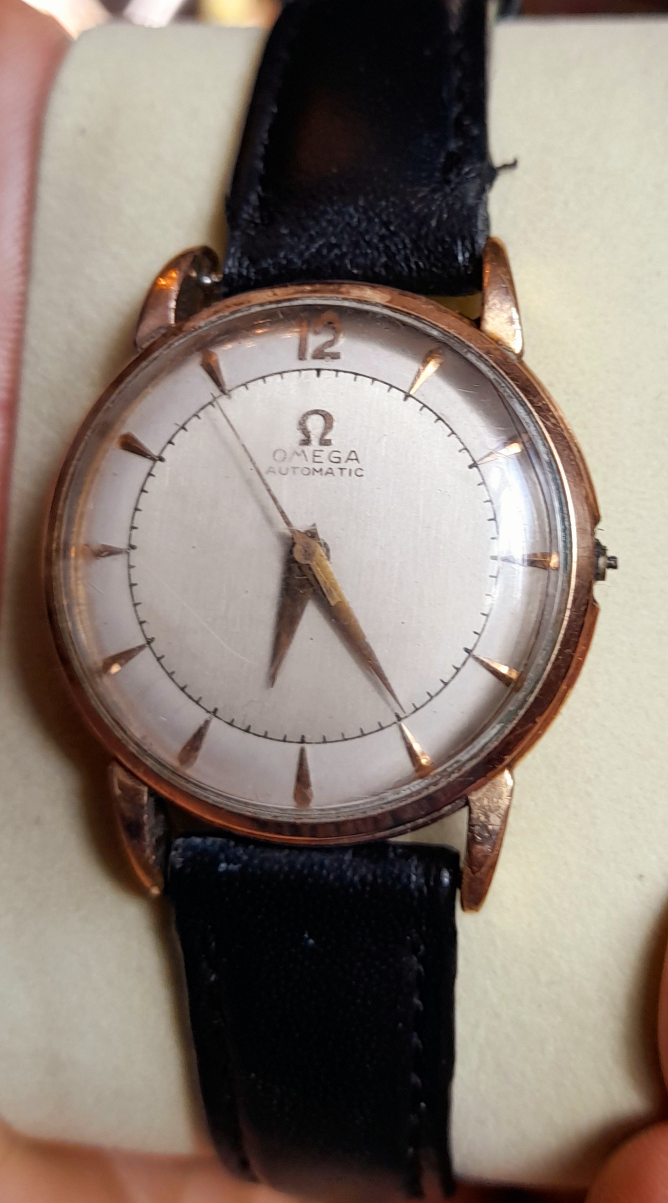

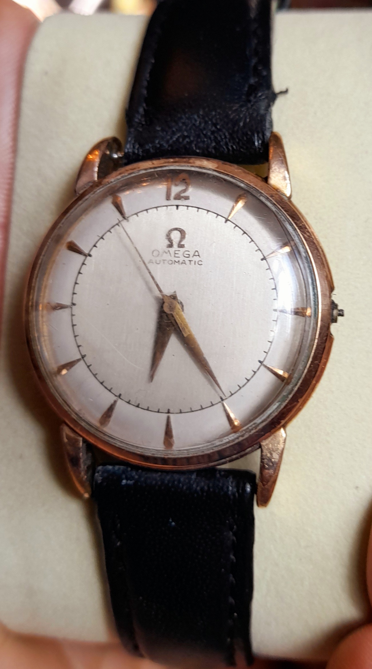

Hi eveyone
I have lost the crown for my 1958 Omega Cal 501.
I want to get an orignal replacement am I correct the crowns of this period were plain?
Also how do I now what size (thread etc) I need to order and who from in the UK?
Thank you.

1958? Plain? No, signed.
Thank you I wasn't sure as my 1946 one is unsigned so I assumed they were the same.
8,284
29,296

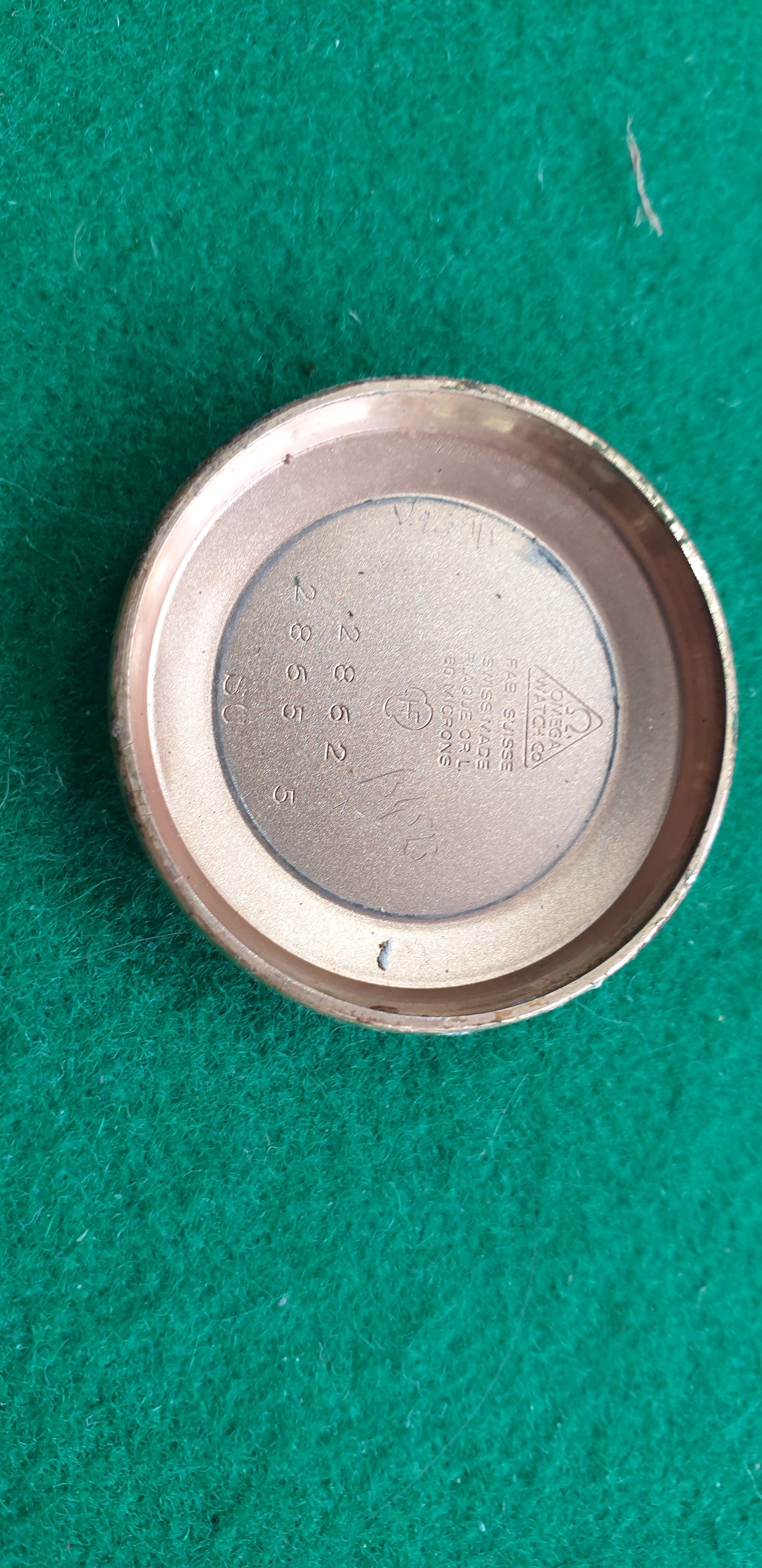

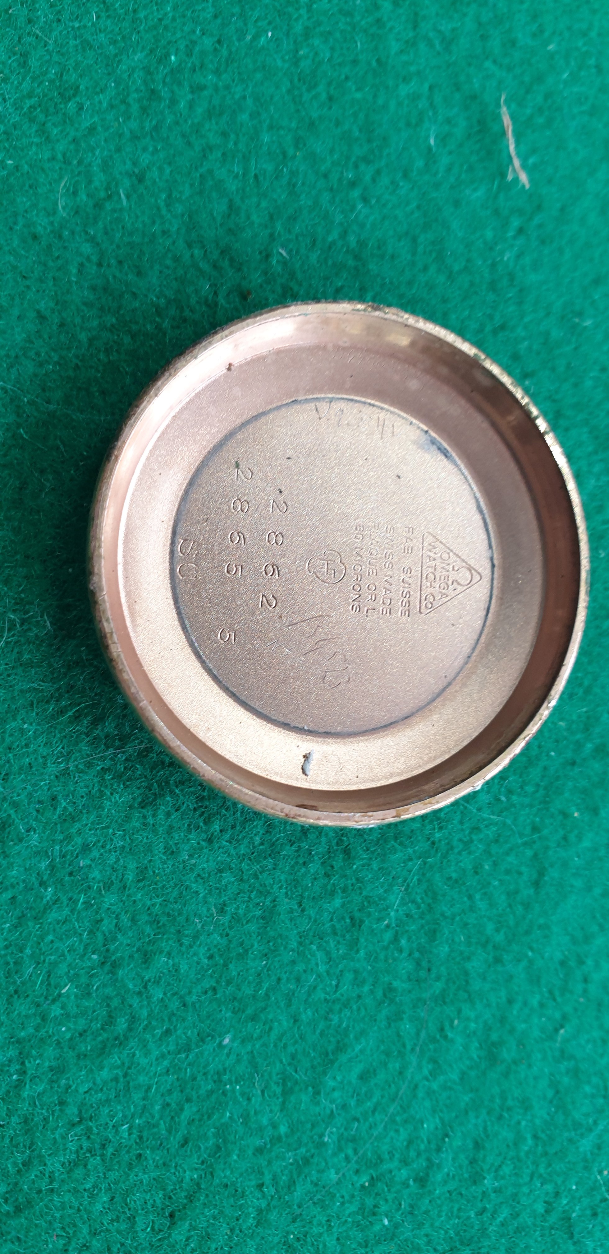

It is possible that a small number of dress models featured unsigned crowns as late as '58, but I doubt that would include the one that you show. Do you know the case reference?
8,284
29,296
Yes, those are the numbers. This is a bit unusual, as there are two references, but it simply means that the case style was used for both.
So, searching Google images for ref. 2865 or 2862, I find both signed and unsigned crowns, though clearly more of the former. Here are a some examples:
https://www.chrono24.in/omega/omega-classic-automatic--id22908141.htm
(the ones below have the same double case reference)
https://www.watchuseek.com/threads/...bseconds-cal-491-incl-omega-box-1958.1540762/
https://www.ebay.com/itm/274798008206
https://watchcharts.com/listing/609...intage-20-jewel-cal-501-auto-case-2862-2865-5
https://www.catawiki.com/en/l/42230019-omega-1954-automatic-cal-501-2862-2865-1-men-1950-1959
I would say that this supports the suggestion that the original crown would have been signed.
