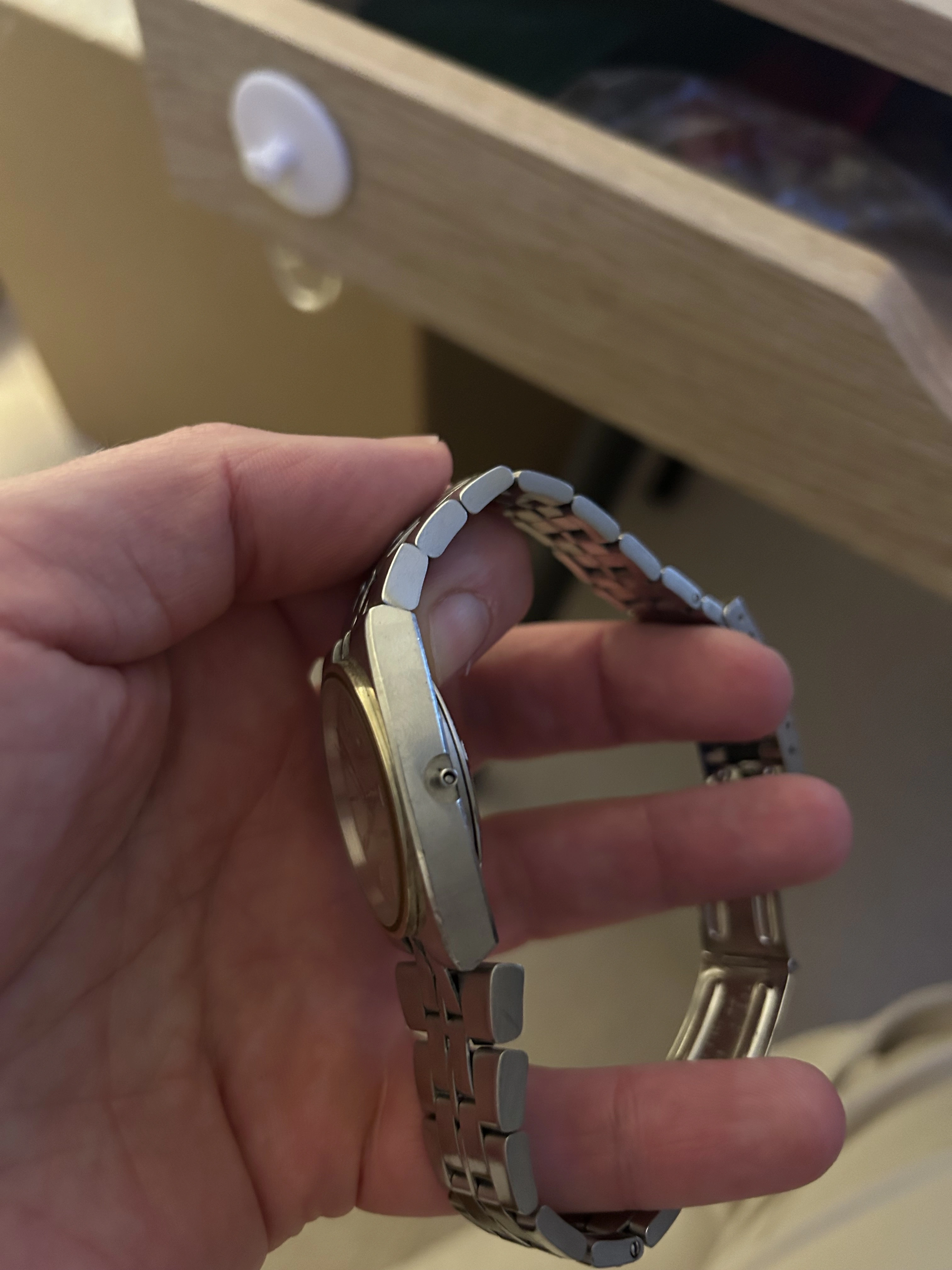

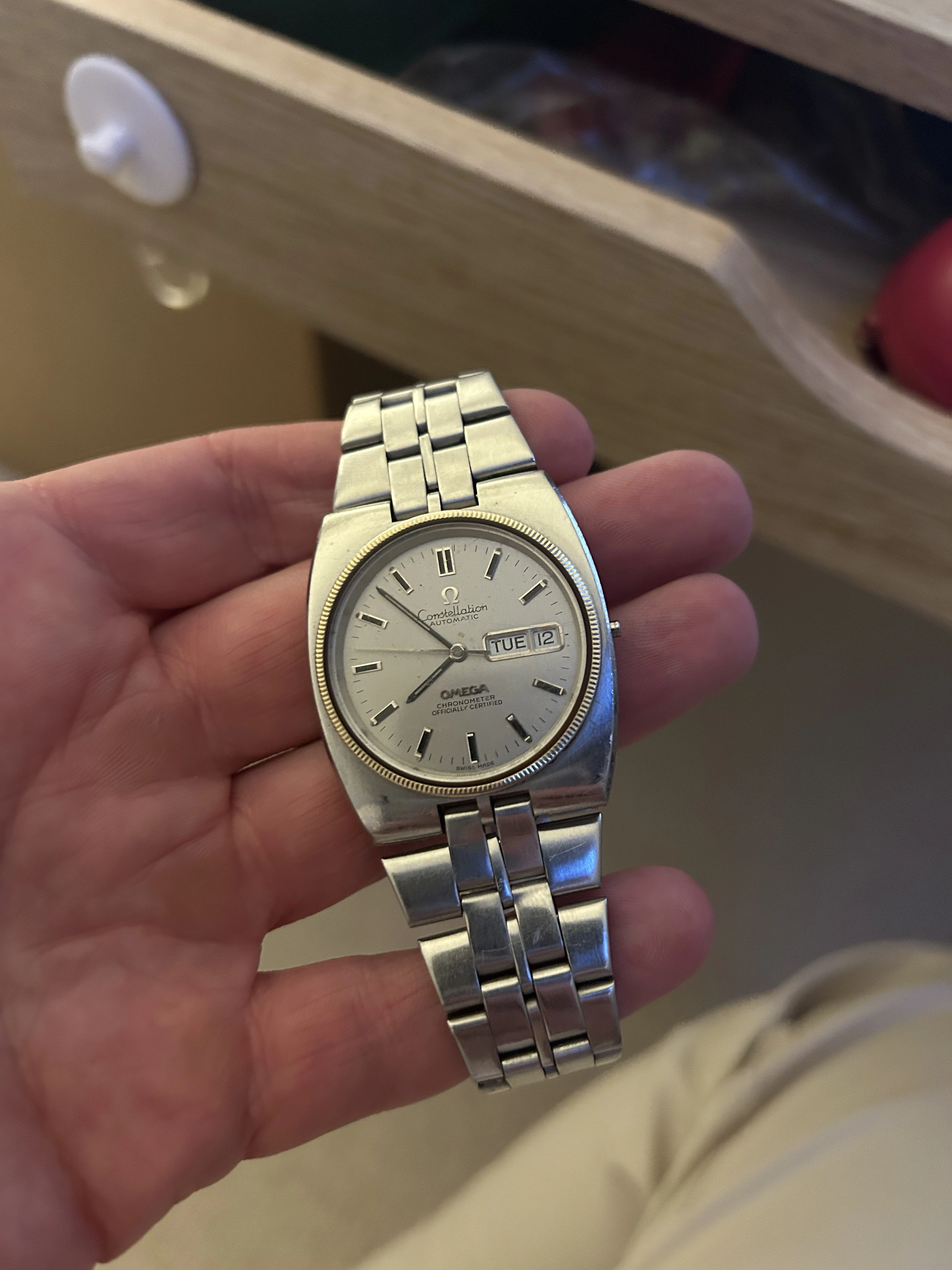

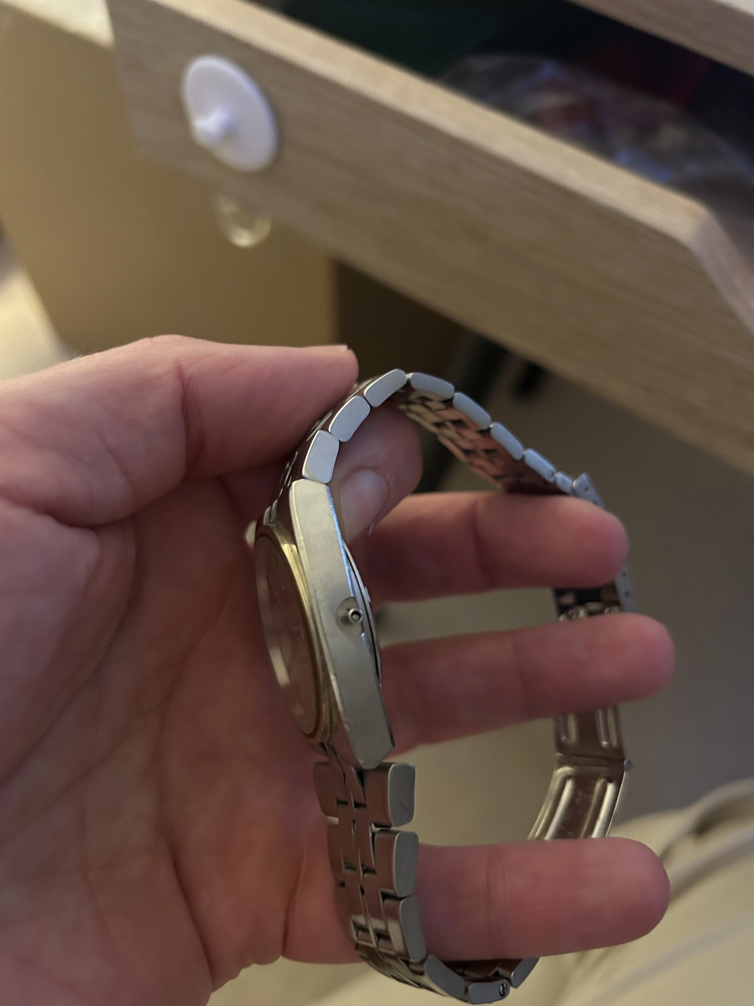

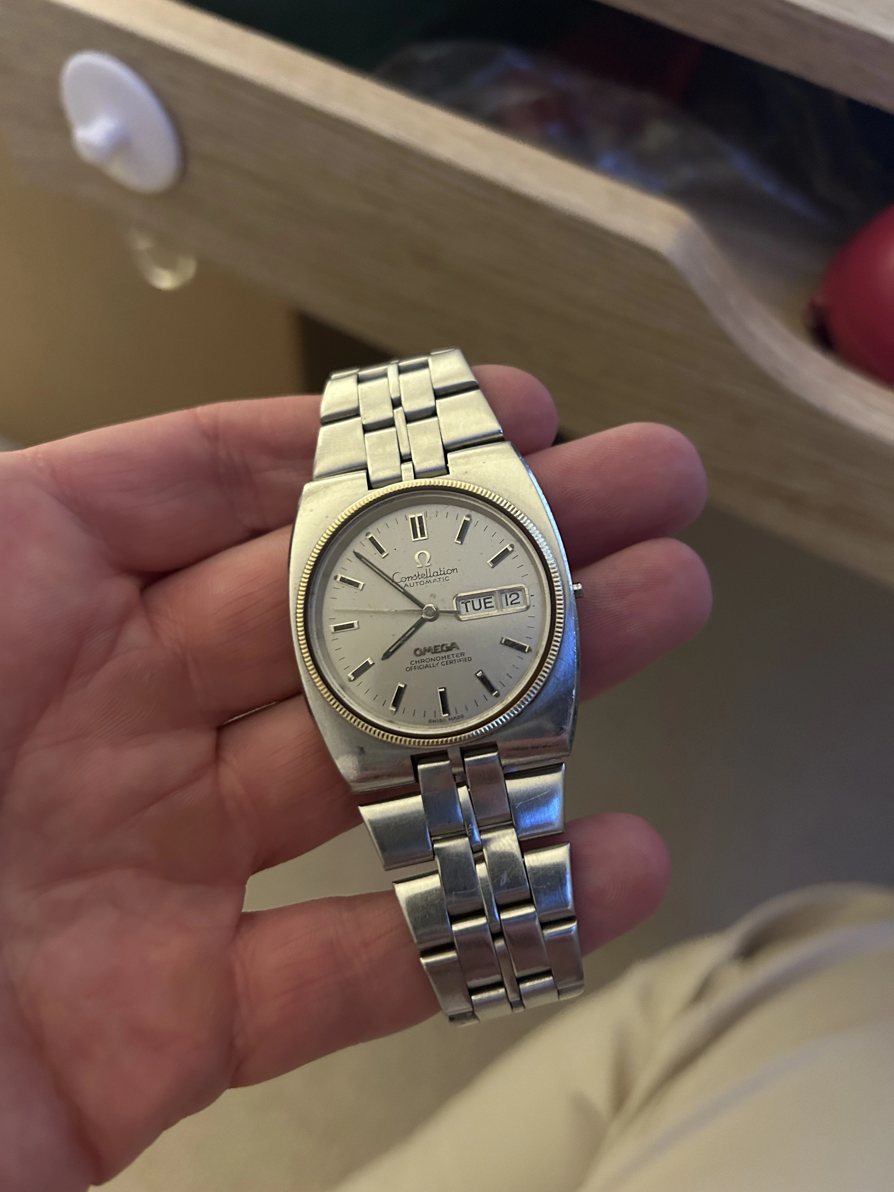

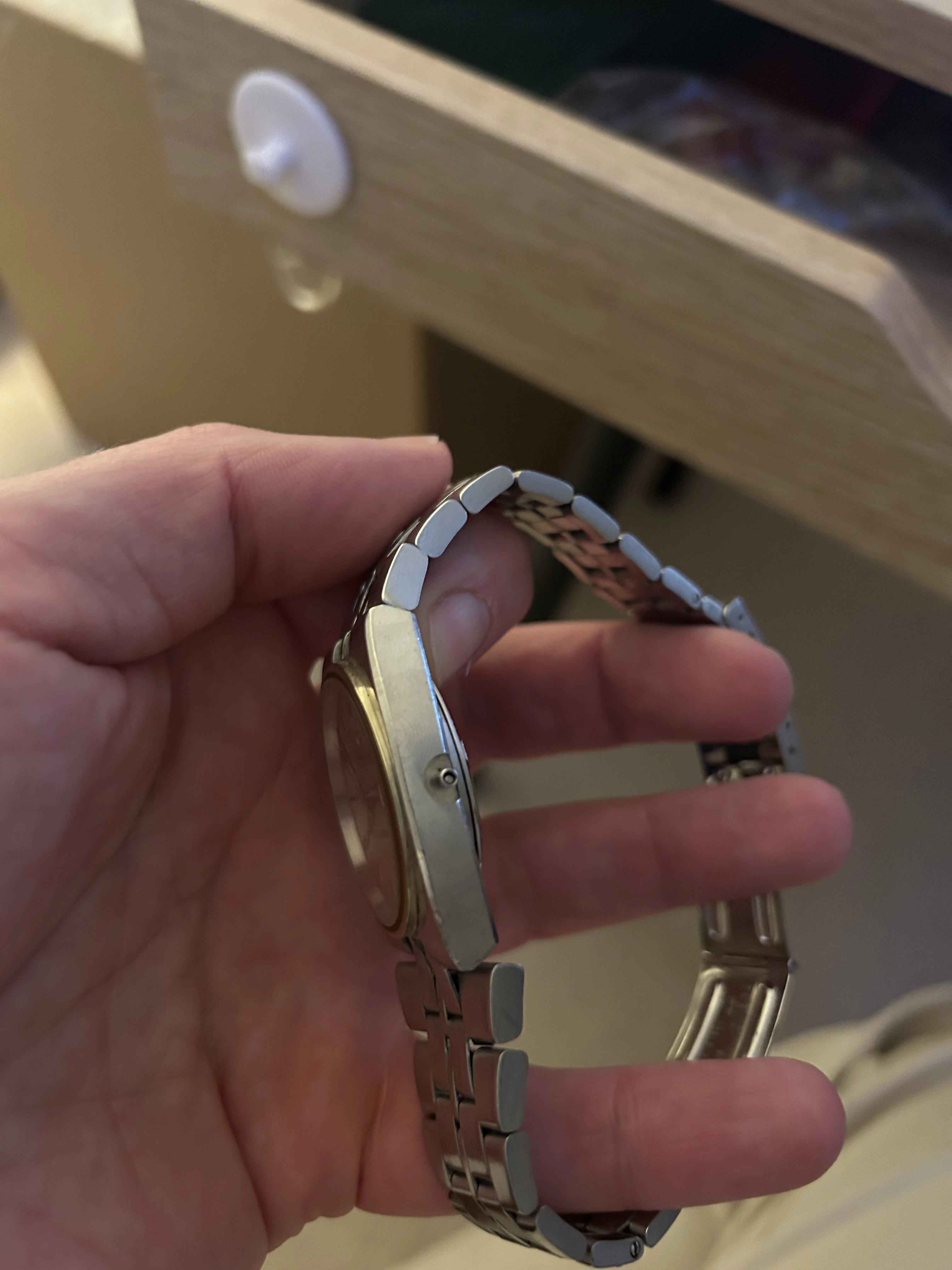

Hello,
The crown fell off my constellation (see photo attached) and I would like to buy the correct parts so that my local watchmaker can repair.
Can anyone advise what parts I need and where I can source them?
Thanks in advance
2,346
1,475
Watchmaker can open the case and get the reference number on the inside back
With that and caliber number. Can order the correct crown from any supplier
Also order a new stem just in case
24,827
55,218
Did your watchmaker ask you to do this? Most watchmakers consider ordering parts to be part of their job.
