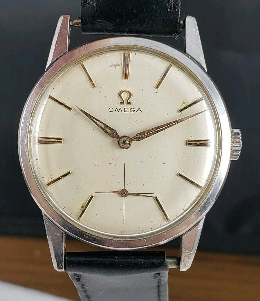

All,
I recently was able to pick up a spare case that matches this 14713...
The case is in nice condition but the crystal is missing.
Looking at replacement crystals it looks like there are a lot of different choices with regard to base and profile.
Can anyone tell me what make/style crystal would be the best match to the original?
Measuring the opening in the top of the case, I read 29.6 mm. My understanding is that the size should be 0.1 - 0.2 mm larger than the opening. But not familiar with these older-style acrylic crystals.
Many thanks,
-Paul

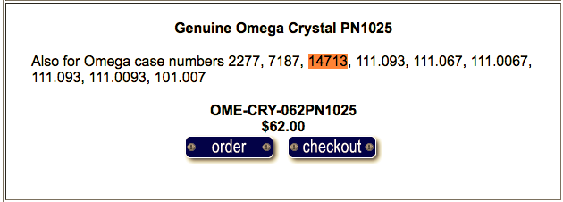

Proper crystal for this watch, according to Omega, is 062PN0298 | GLASS PLEXI D29.80 H3.10

Ah - okay.
I was wondering - because I could see from the part number and description that you posted that the diameter was probably 29.8 mm. Which agrees with the opening + 0.2 "rule" that I have heard for the "plain" acrylic crystals.
Thanks,
-Paul
