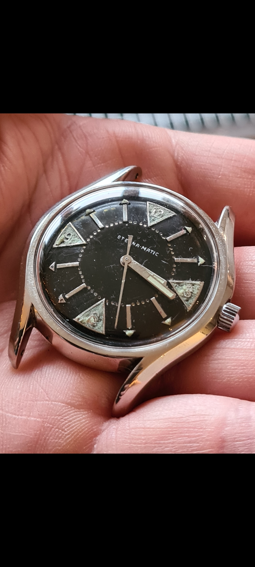

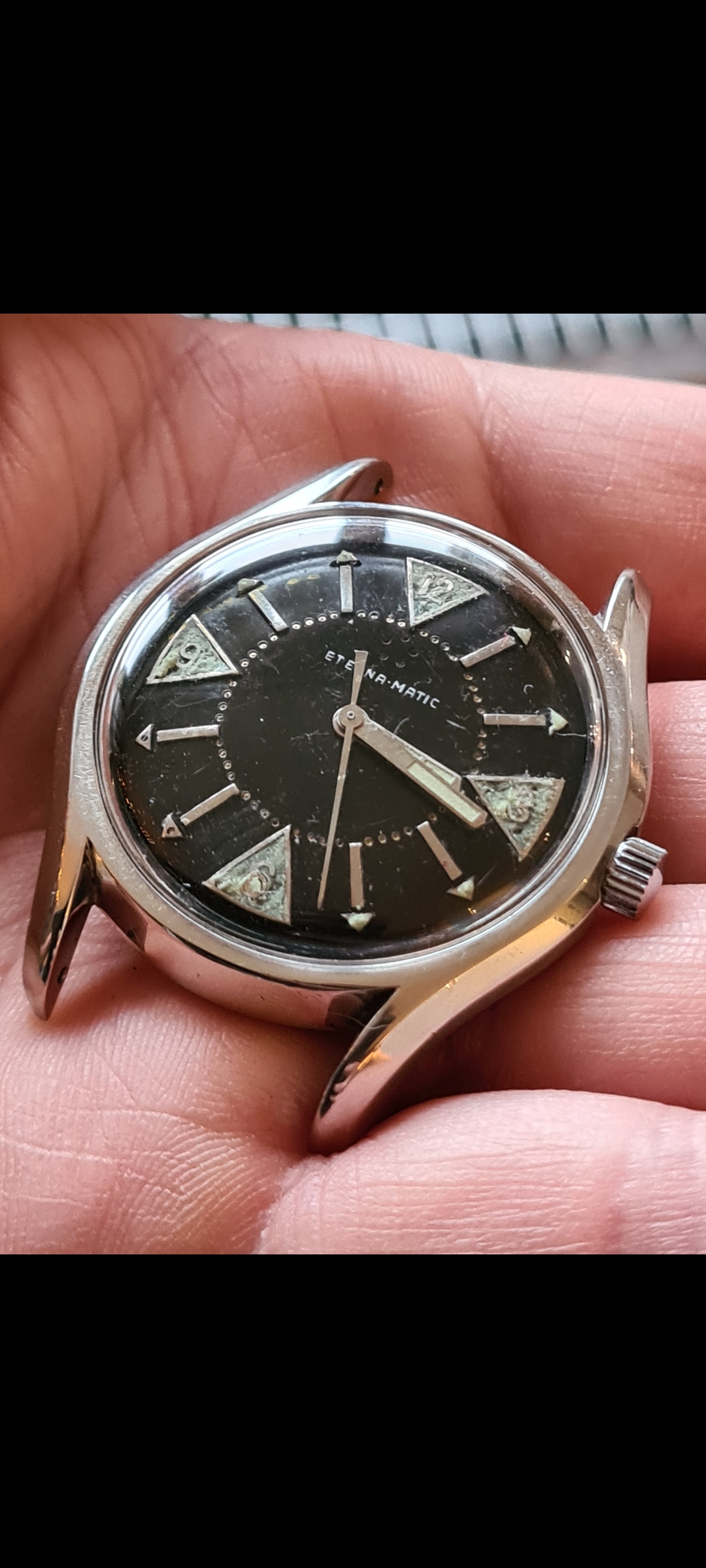

Yea I’d agree but not hard to solve, the case is quite sharp and clean though so its worth getting serviced and up to snuff
When you say "Not hard to solve" regarding the missing lume hand, could you elaborate on what you mean? I have a Seamaster 166.028 with the concentric circles, orange second hand and both hour/minute hand are missing lume. Is there a way for an experienced watchmaker to relume these hands with Tritium lume that will look close to the patina of the hour indices lume plots?
