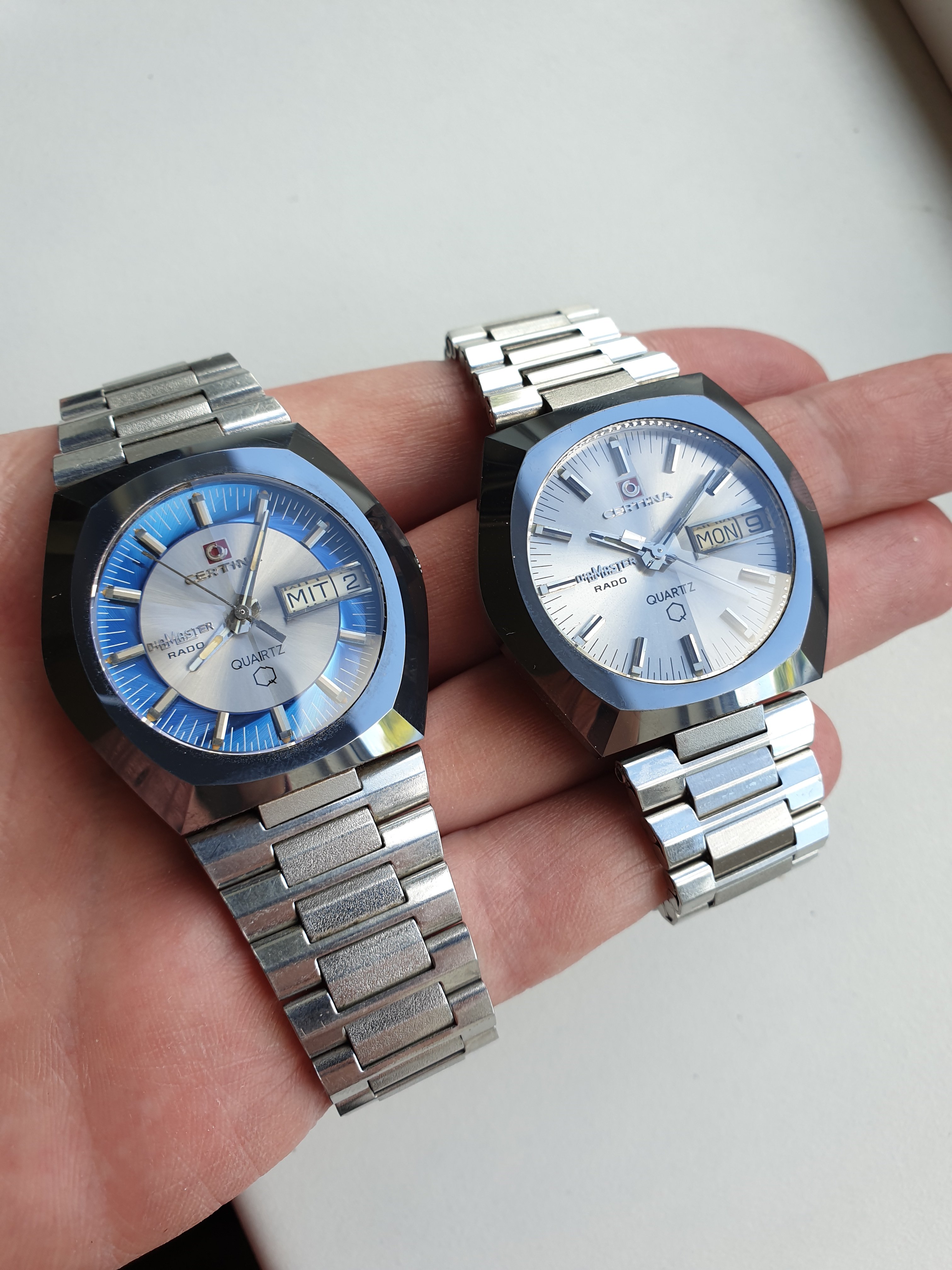

A fairly boring WTB this one - I am simply looking for some Renata 354 or similar from Varta etc. to some of my quartz Certinas.

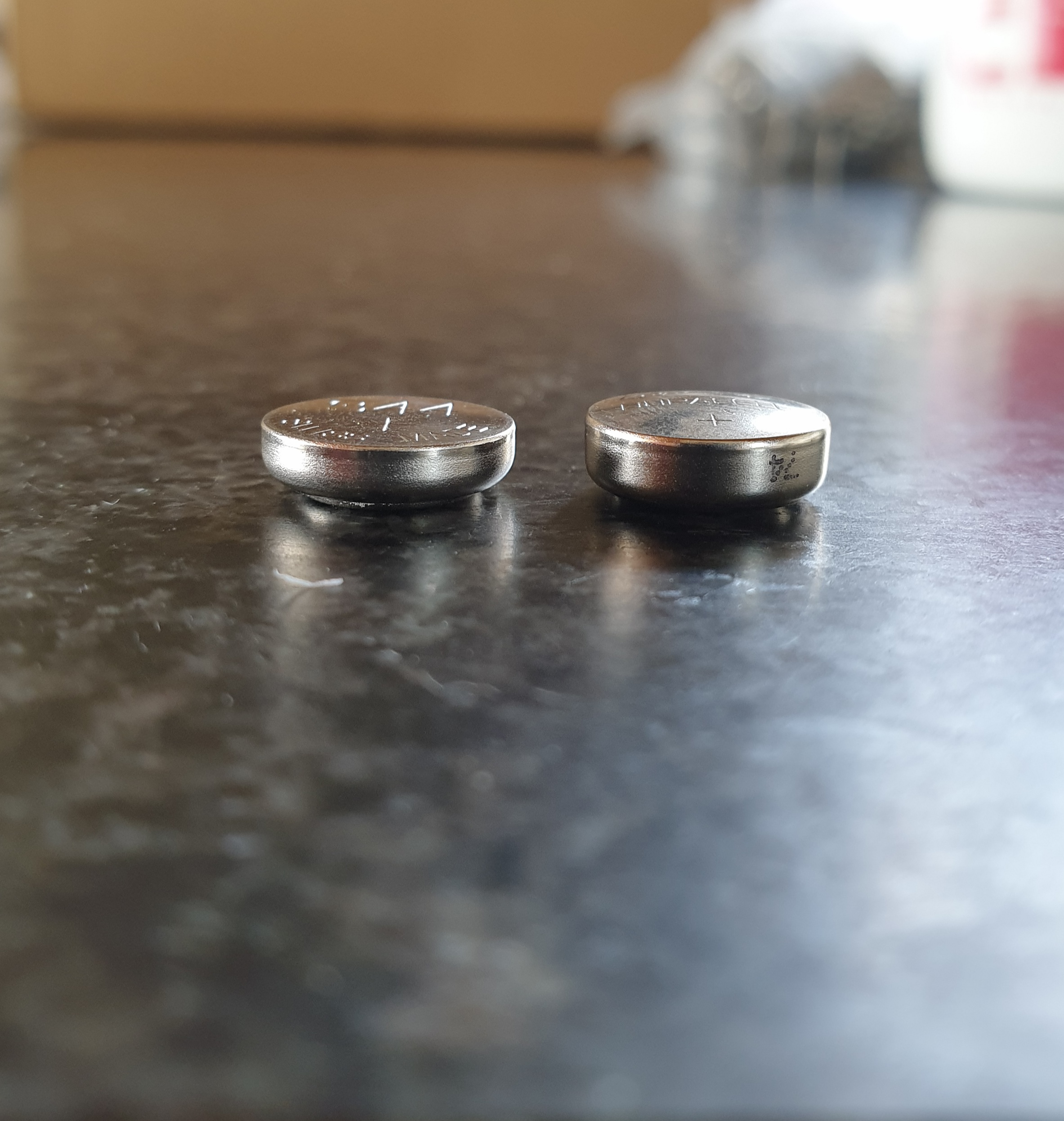

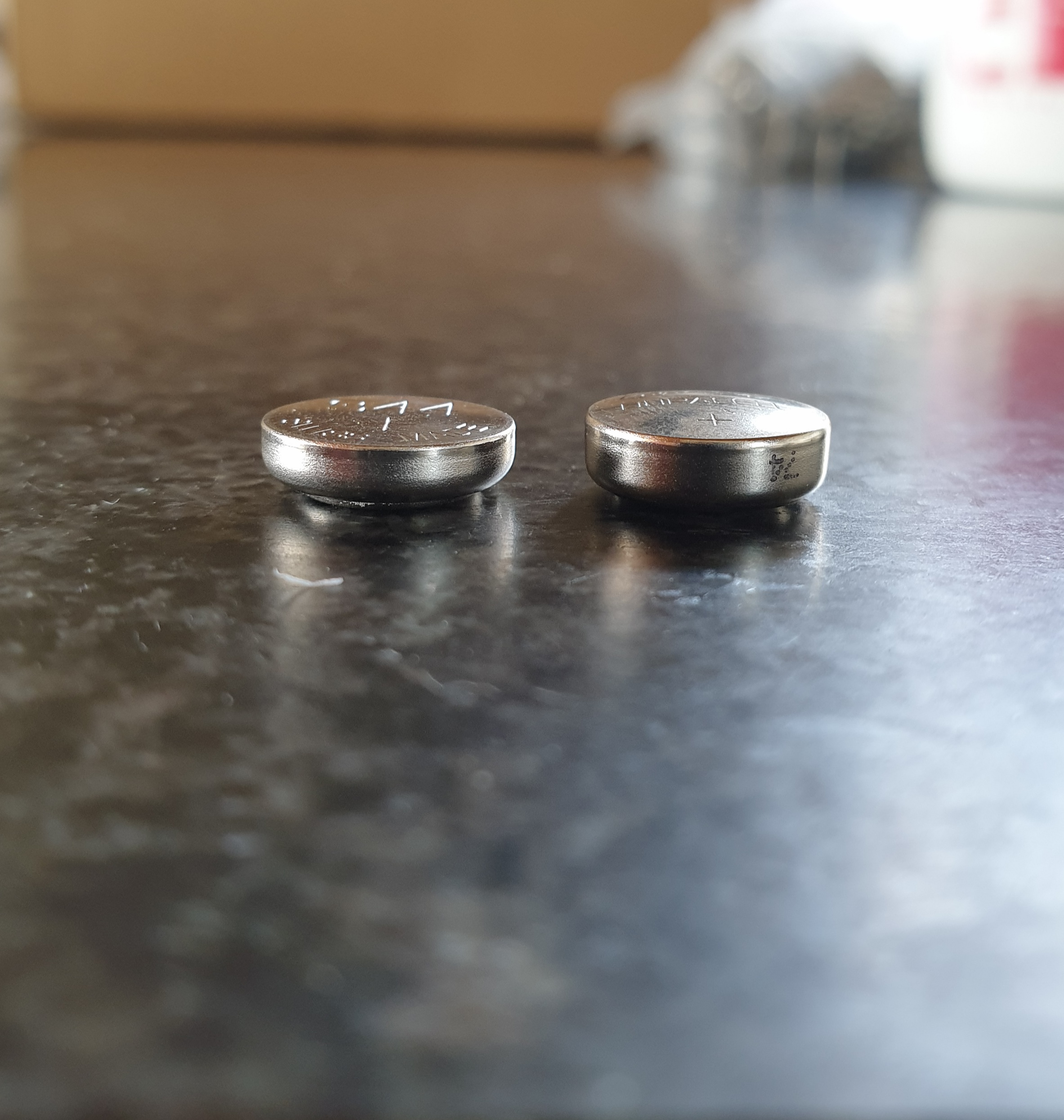

Thanks for all the help - I resolved the issue by, you know, actually opening the watches...
Interestingly, none of the two had 354s or equivalents in them, but instead a 344 (the one watch I knew was running prior to the battery going dead) and a Duracell 43 (the watch was bought as a non-runner due to dead battery, but the seller wasn't sure of anything about it...).
As you can see they are fairly different in size.
As coincidence would have it, I had two 344s available - the only watch batteries I had lying around, funnily enough - and I gave it a go. Hey presto, both watches are now running 😁

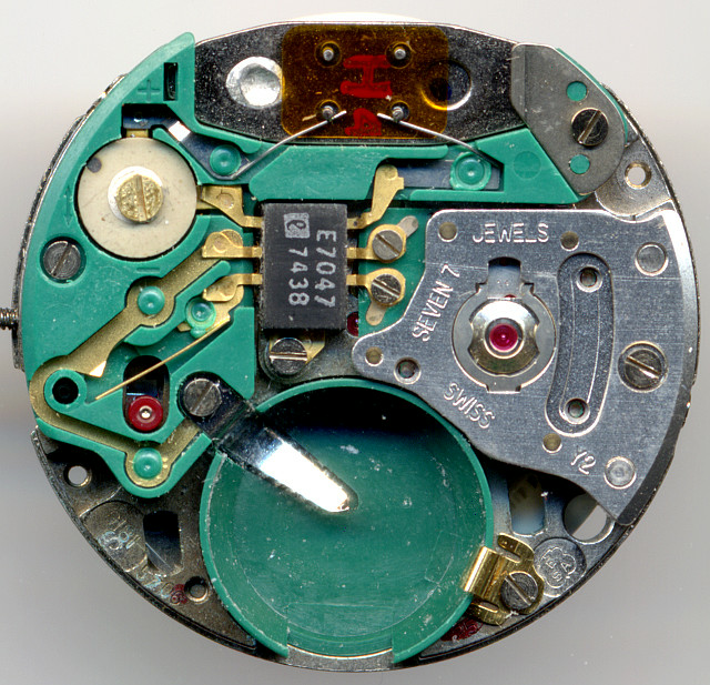

I’d be interested in seeing what movement is used in these watches.
9,588
27,705

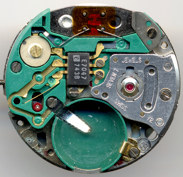

It's called 29-252, which is a Certina-branded ESA 9181.
Photo from 17jewels.info
15,951
47,908
@ConElPueblo
Thanks for that. I’ve never seen one of those movements before. Glad to hear you’ve found cells that work.
