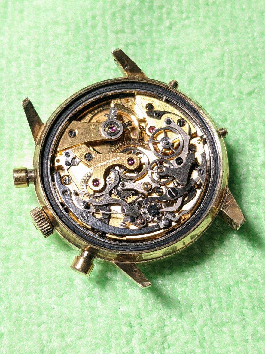

I need a bit of help figuring out how to release the 730 movement from my recently acquired Wakmann housing? The hour counter hands has popped off and it needs reattaching. I've got the stem out but this one isn't as obvious as my 321 or 1040. Many thanks in advance.

I would put the crown in winding position, unscrew this screw 1-1/2 turns +/-, and pull the stem/crown out once it’s released.
It looks like the movement retaining tabs are all ready removed so I’d expect the movement to fall out when turned over or given a gentle tap.
30,062
77,609
No dial side photos, but if as you say the stem is already out, and the clamps have been removed, if it doesn’t come out the back it may need to come out the front after removing the bezel or crystal.

@mzinski Thanks very much for the tips and crown is already out (and no retaining screws) hence my confusion for the Valjoux movement not moving?!?

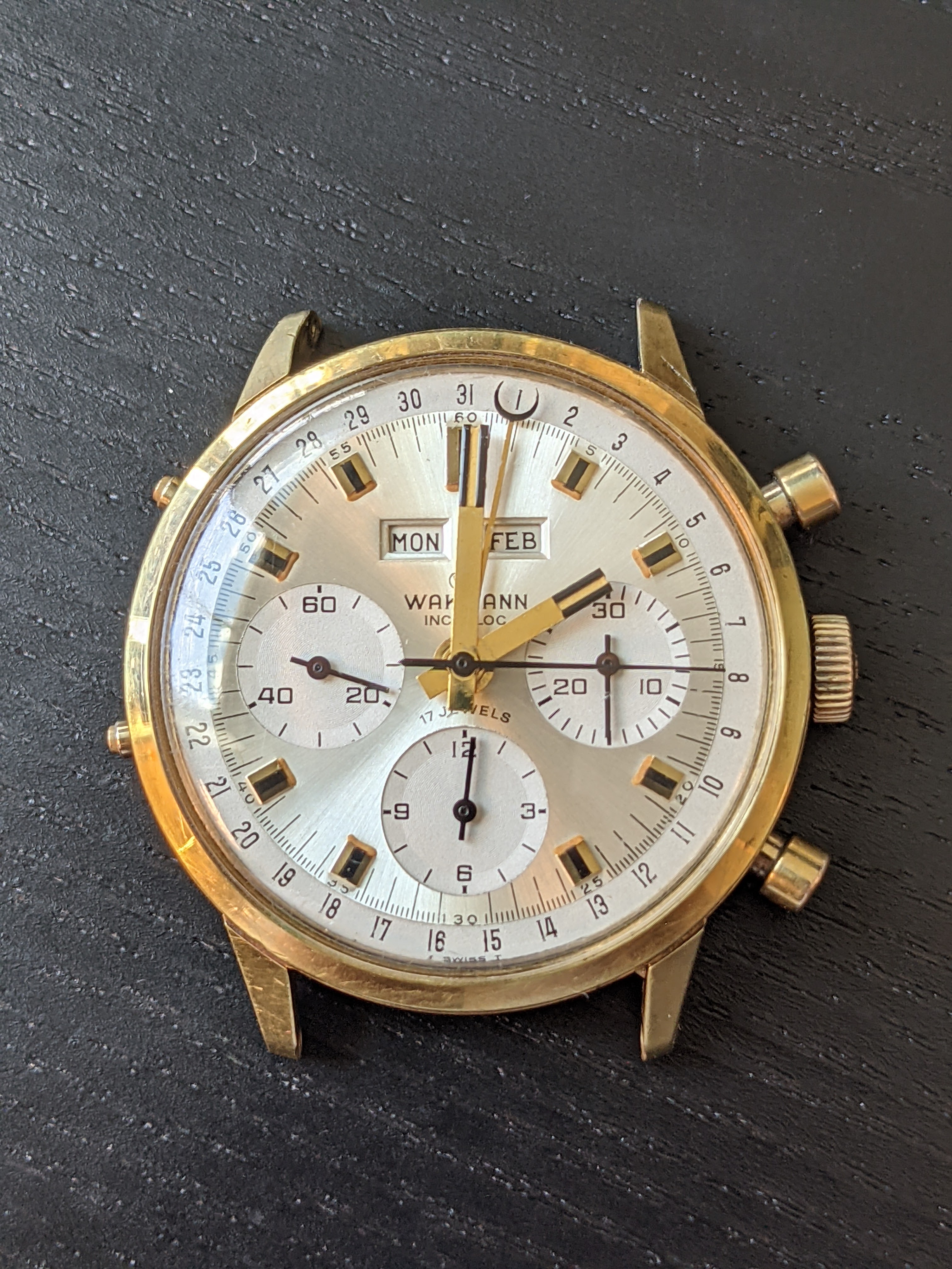

Dial side pics for @Archer (pre loss of small hour hand) and the help is very much appreciated!

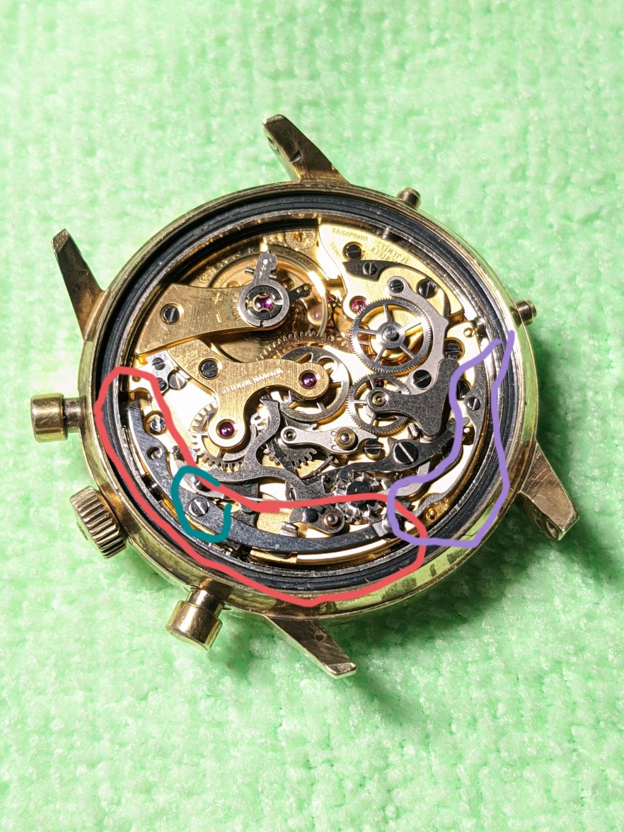

On my Valjoux 22 I have to unscrew the chronograph "lever" (circled in red below) In order to "free" the pusher otherwise the movement is not coming out (mine has to come out of the front as well. I was stuck exactly like you after removing the crown and retaining screws. The movement was not moving and it was die to the top pusher. I do not know if there is another way without removing that long lever but in my case unscrewing the screw (circled in blue) and removing the lever (carefull about the "spring" circled in fushia, I actually removed it as well) made me able to pull the movement out.

You have the watch in front of you, so if you look at the size of the opening in the back, then look at the diameter of the dial, does it look at all like the dial will fit through the opening in the back?
To me, it looks like a front loader, but it should be VERY easy for you to tell with the watch in hand...

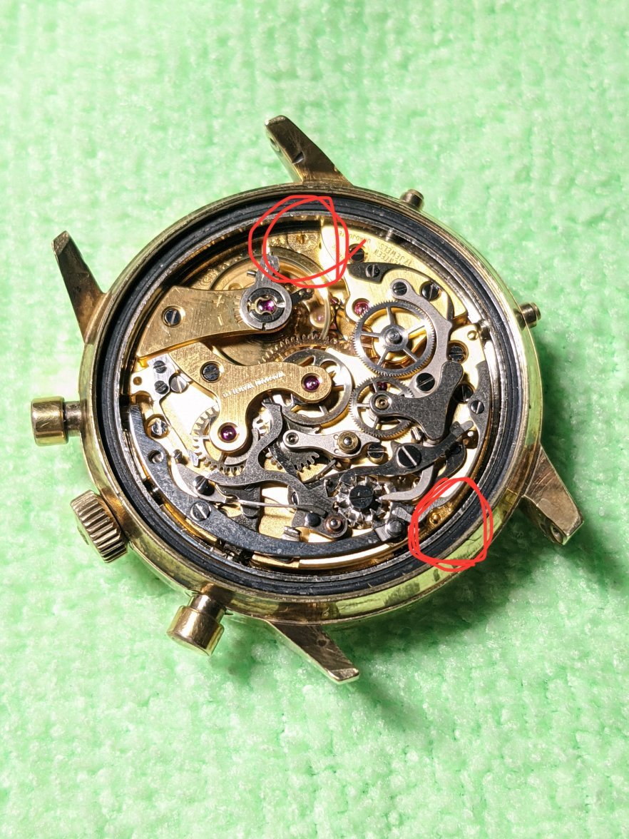

Thanks for all the help, I was finally able to get the movement out the back after removing the thin black gasket covering the movement ring. Unfortunately the gasket was so thin and dry it snapped, so if that was a rubber material it had dried out and was long gone! After a lot of wigging and gentle prying, the movement ring finally came loose, up & out the back!
