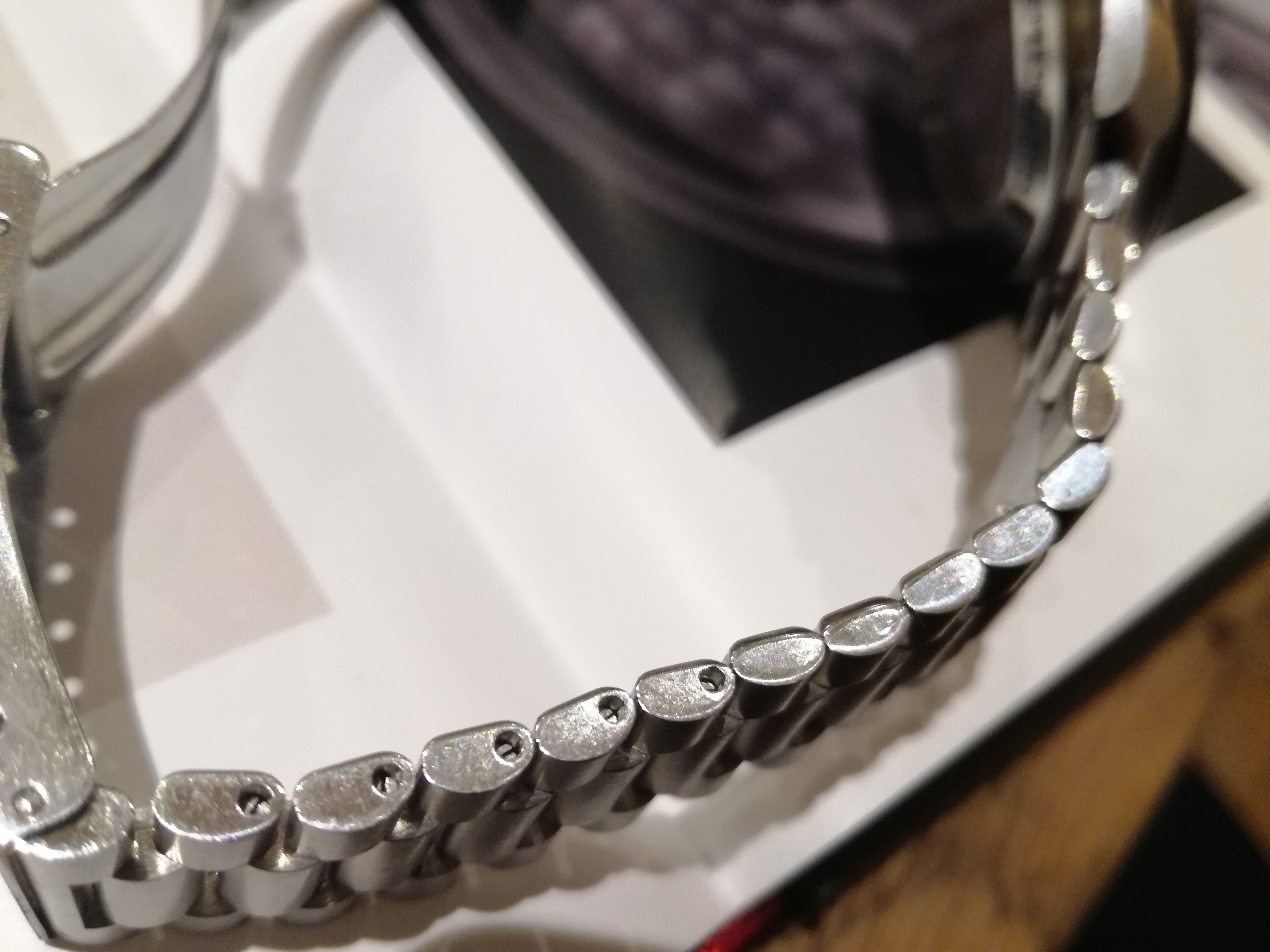

    So, the bracelet is an 805, here is a picture - as you can see, there are no arrows indicating which way the pins should come out:
    Here is the side where the ends of the pins look like screw heads:

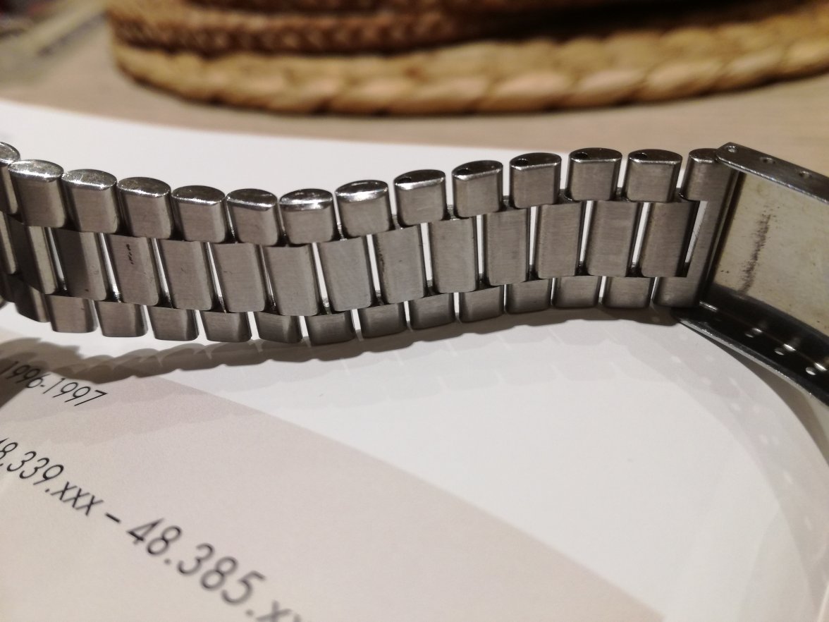

    ans the other side where they just look like pins:
    So, I'm not sure if they are micro screws or just push pins with grooves cut into one end.... thanks in advance any help.

  4. nurseford25 Dec 29, 2017
    1,119
    5,981
    Push pins

  5. Malthus101 Dec 29, 2017

  6. wsfarrell Dec 29, 2017
    2,441
    4,133
    Push from the side opposite the slot. I don't think there are collars, just a friction fit.
    Also better if you tap it out with a pin tool and hammer. If you don't have a pin tool, a drill bit will work. Support the bracelet in a non-marring vise first.

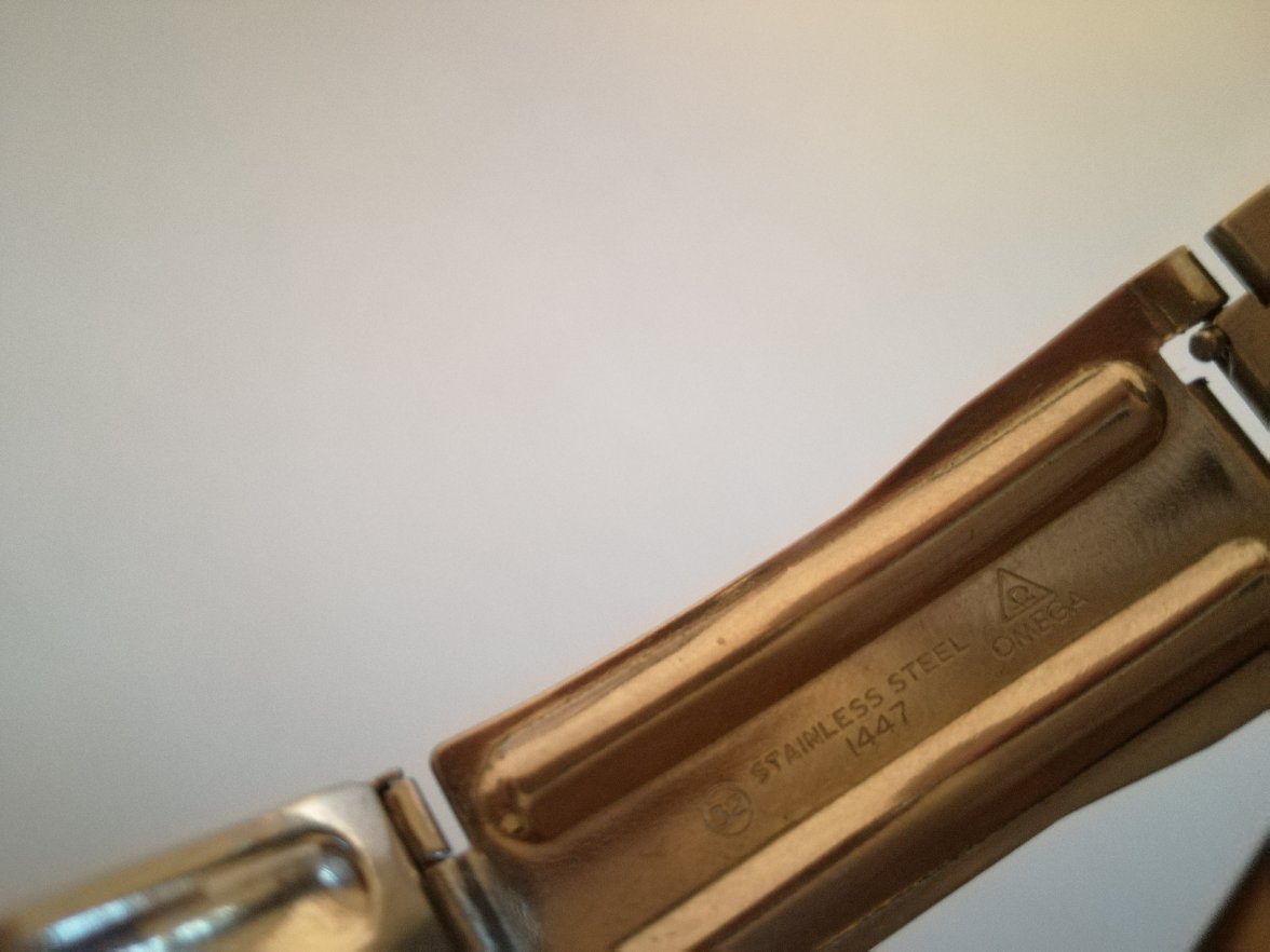

    These are folded split pins - not sure I have ever seen these used by Omega on a bracelet as these are typically used on very low quality bracelets. Most use pins and tubes, so it's possible someone has replaced the original pins with these. OP says the bracelet is an "805" but I'm guessing that's the end link. Is there a number on the inside of the clasp?

  9. Malthus101 Dec 30, 2017
    200
    288
    1447 - this seems correct:

  10. Archer Omega Qualified Watchmaker Dec 30, 2017
    26,463
    65,604
    No tubes called out for the 1447, so it only calls out the pins - part number 128ST1447, but no images available to show what they look like. Going to order some in the New Year to see what they look like.
