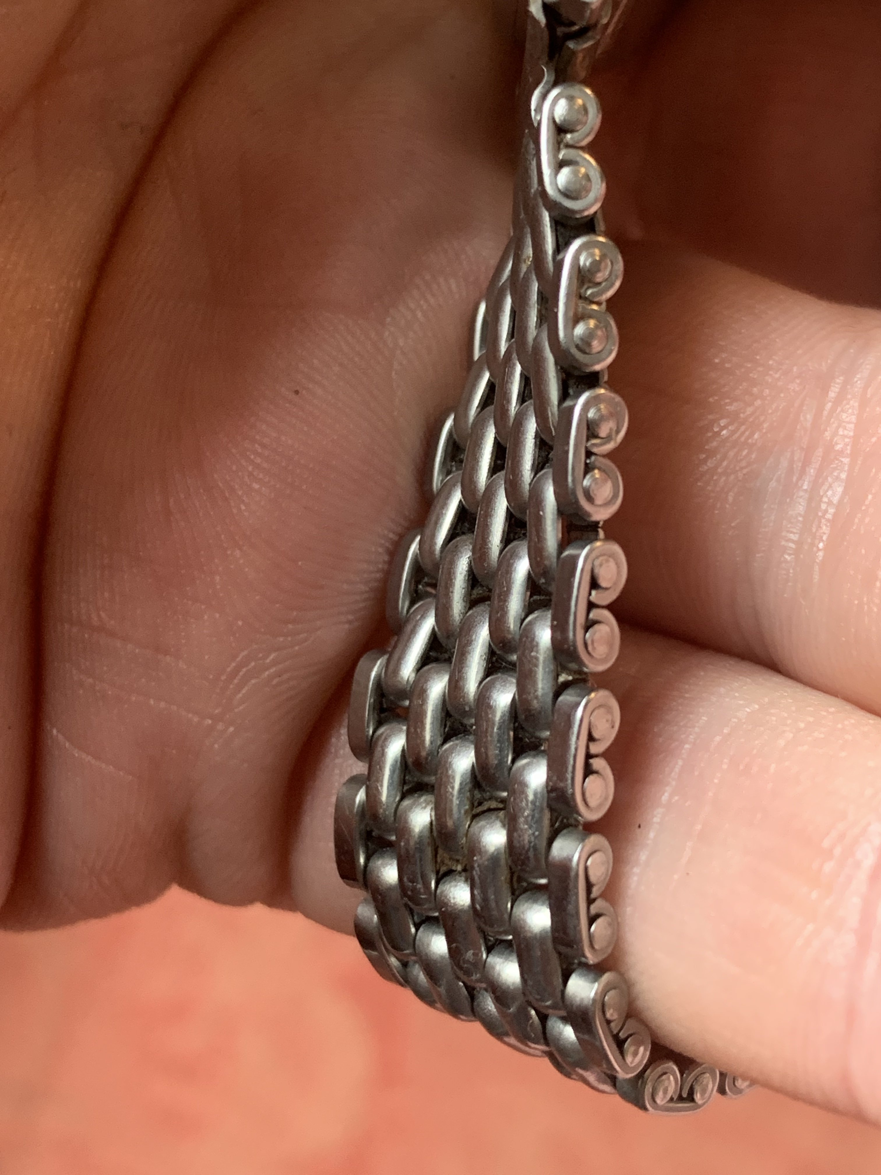

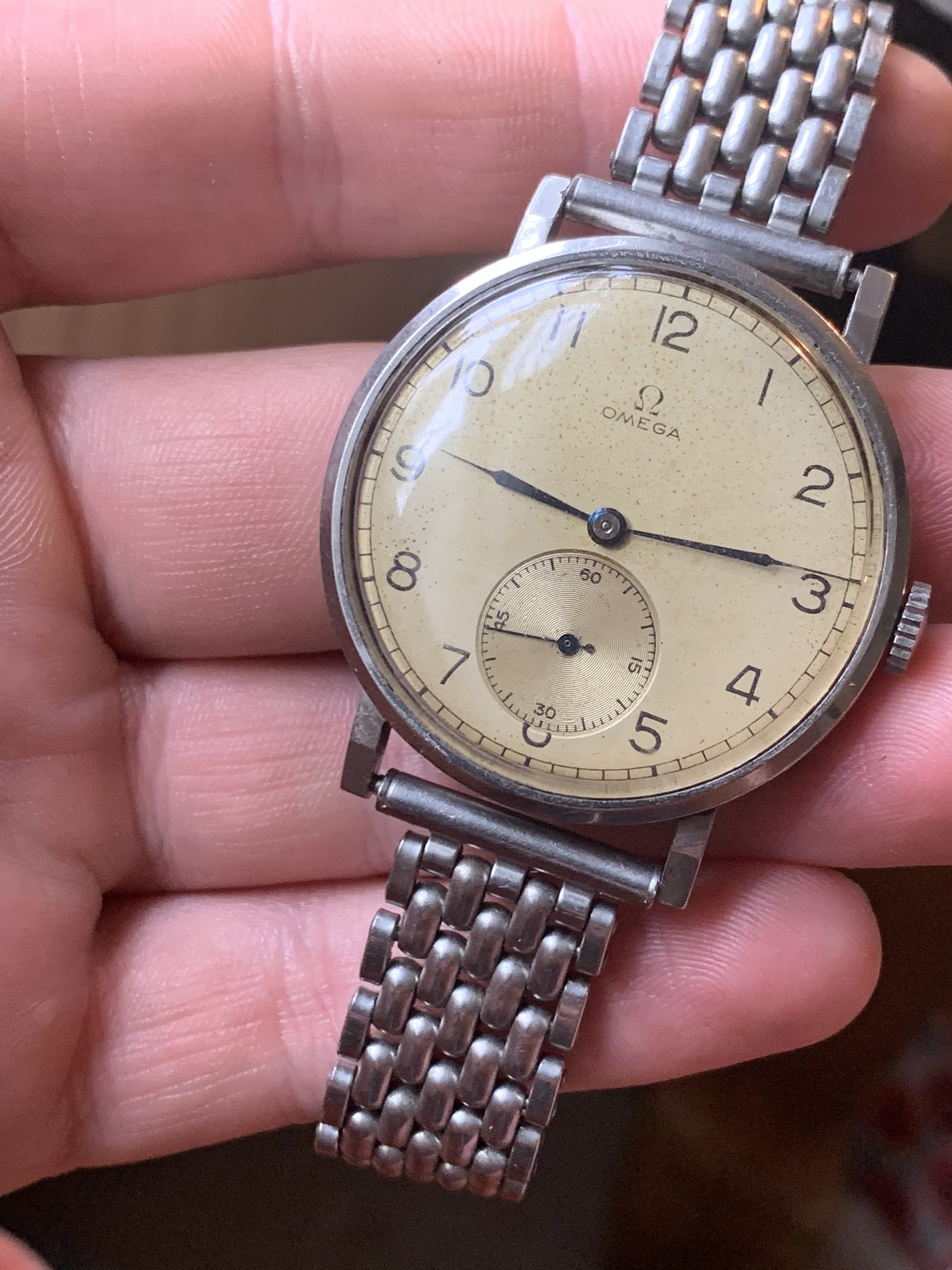

Hey guys,

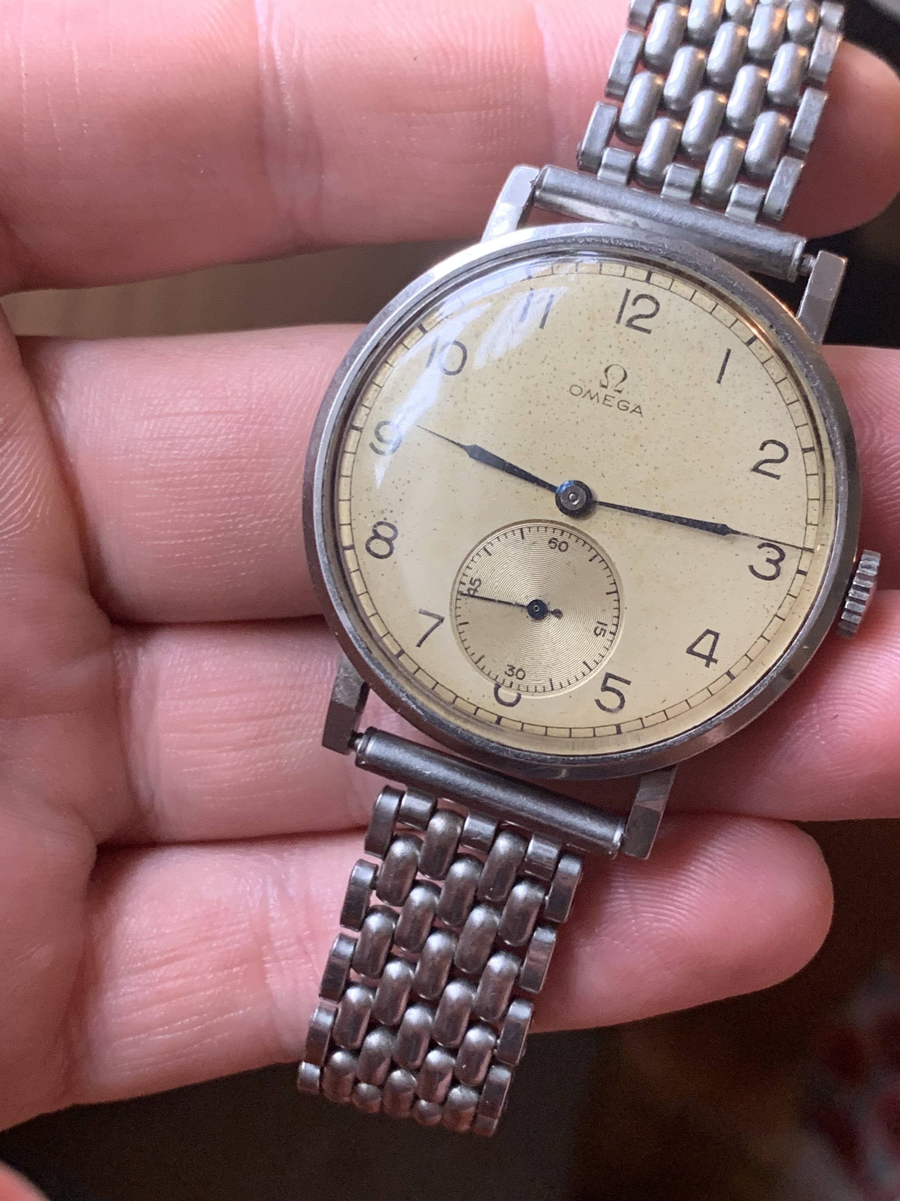

I have this old bracelet circa 1940/50s and it has a sliding clasp. This means it can get bigger but even fully closed it is about half an inch too big for me and is not comfortable flapping around.
The links appear to be riveted is there anyway I can remove 3 or 4 links to shorten it slightly?

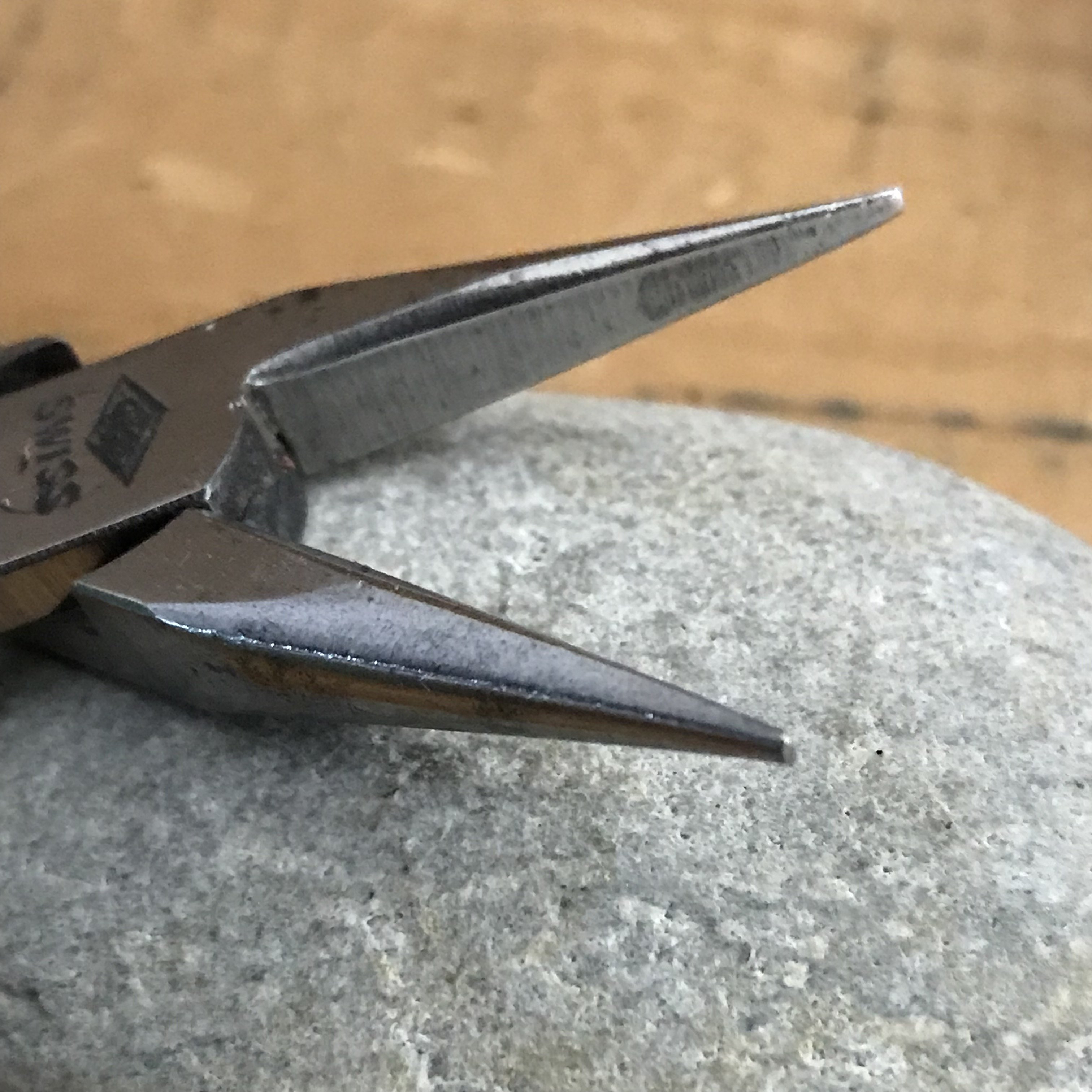

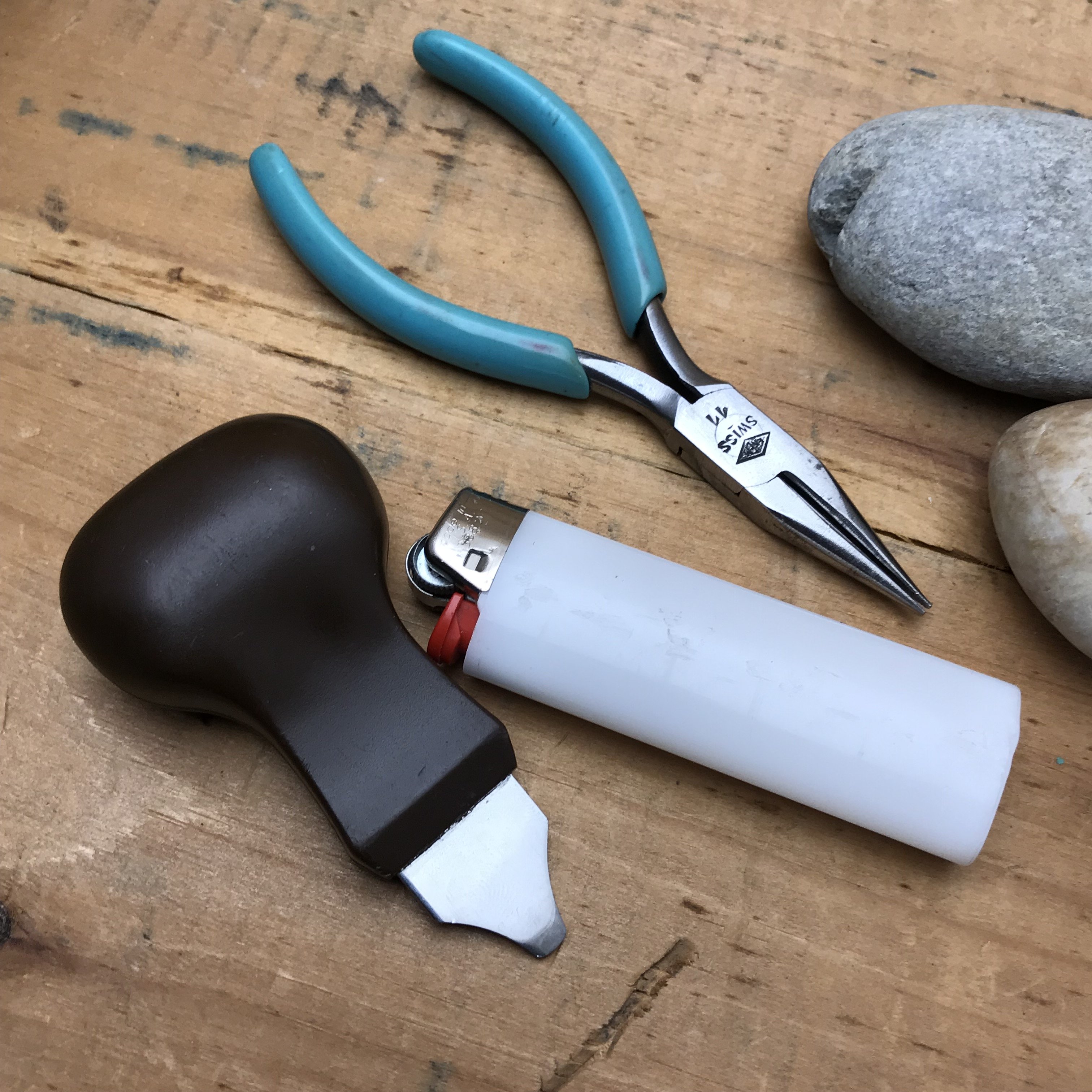

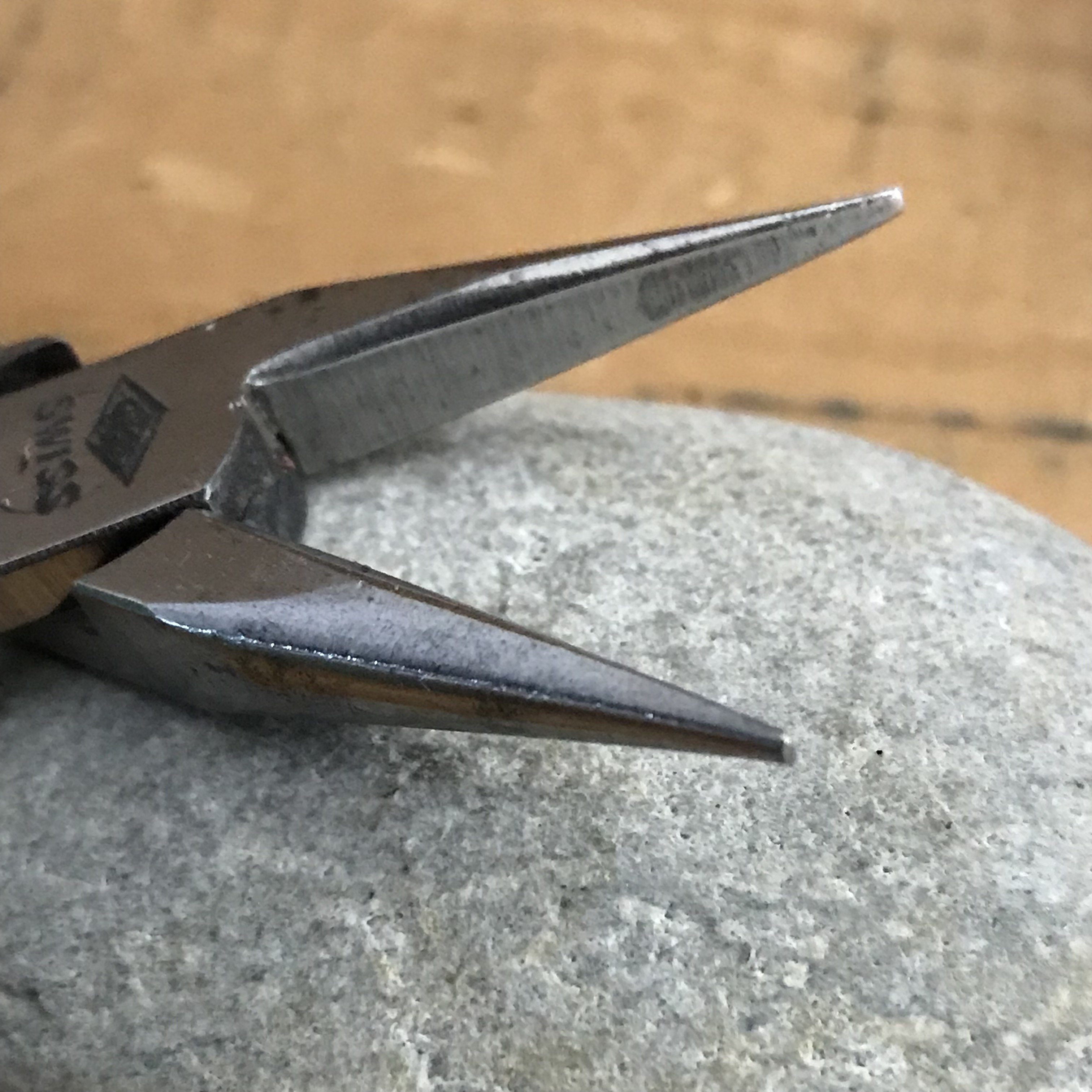

I shortened the exact same bracelet using a jeweller flat tip screwdriver prying apart the 3 beads to remove links. Be very careful and only open the bead enough to remove link. Once a link is removed use a slim needle nose flyers with some tape around to close the beads back up.
1,037
11,947
take your time, make sure you can see what you're doing, for mean an optivisor and smooth-jaw pliers are indispensable.
a case-back opener with a smooth wide flat blade can be helpful when closing, use the flat side of the blade and push carefully.
a bic lighter or something like it can also be useful.
try to make the metal travel back into position in the same way it was opened.

You’re using the lighter to warm up the metal to make bending easier?
1,037
11,947
no, can be used as a tool to push things back into position, it's non-marking, easy to grip, and sometimes the curves can be helpful in getting the pressure just where you want it.

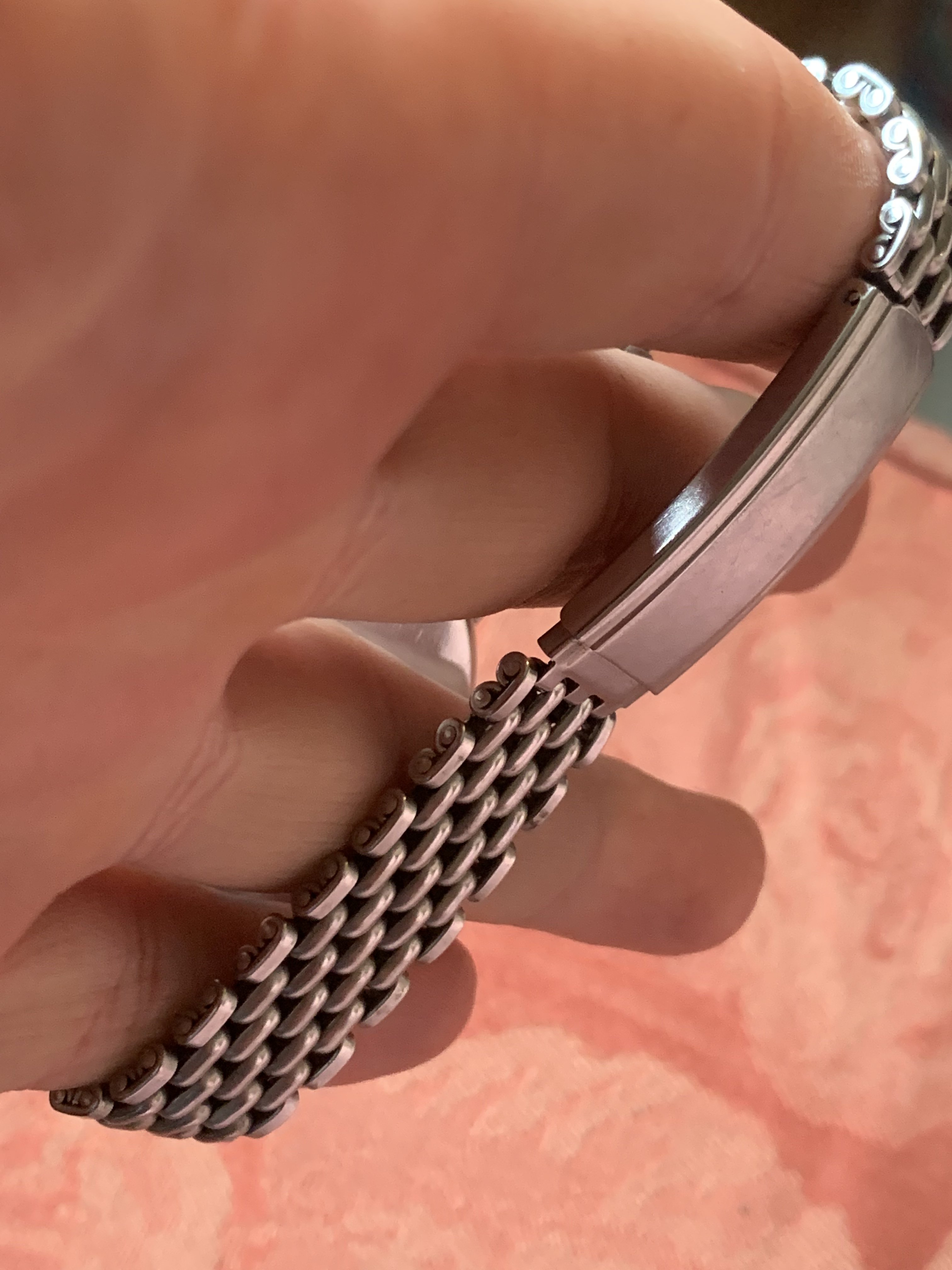

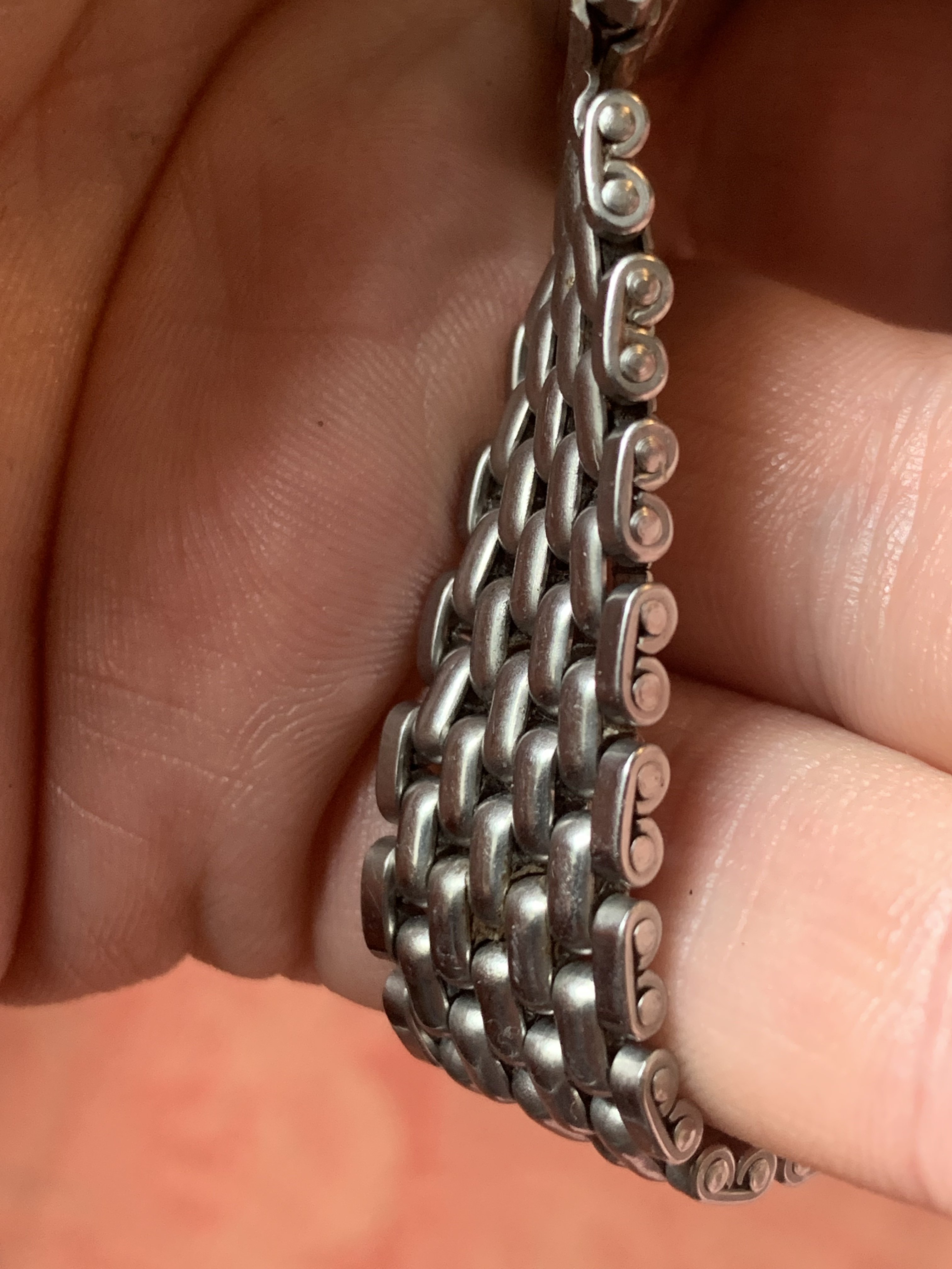

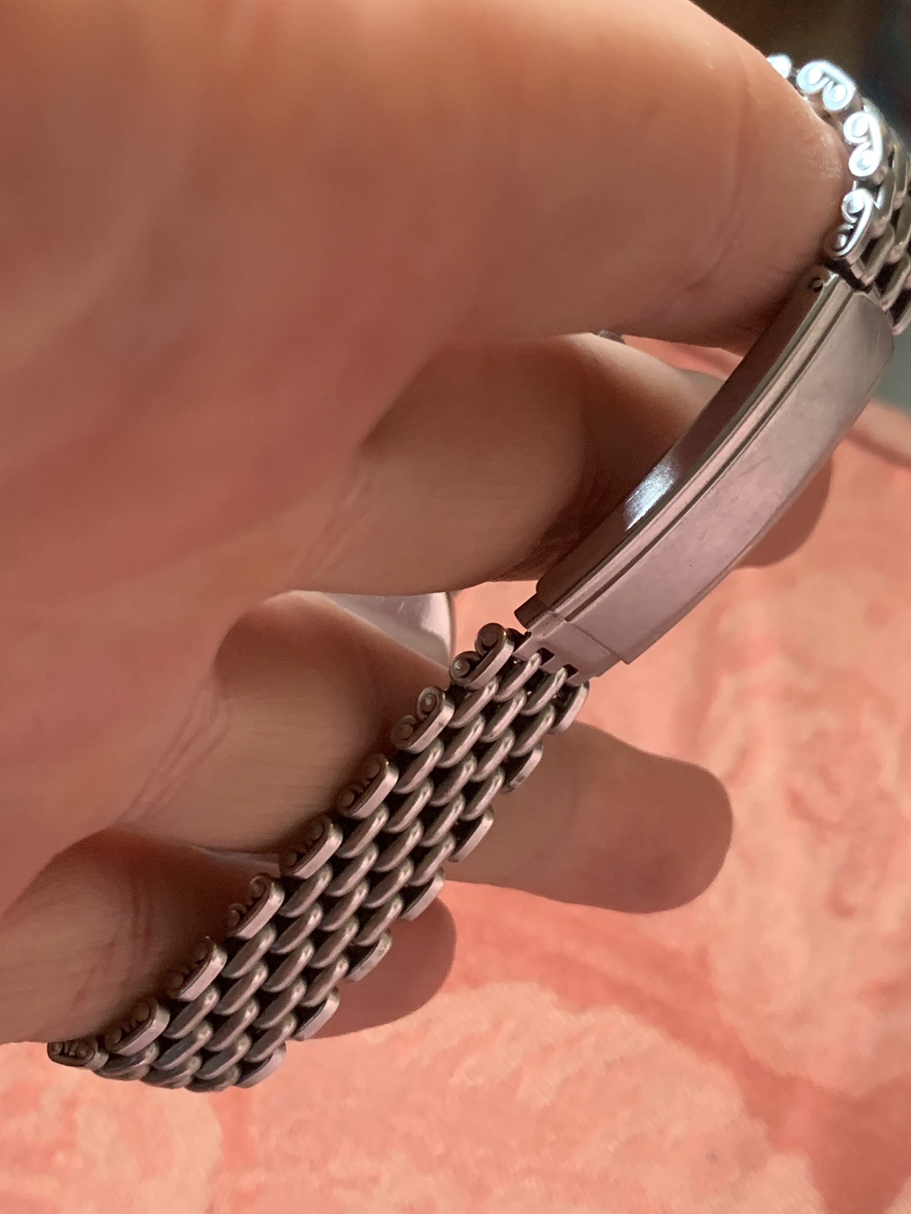

Wow so a couple of hours on from starting one side is shortened. I used a loup throughout the entirety and now I feel like I can barely see hahaha!
It’s probably one of the most fiddly things I’ve ever done. But I guess practise makes perfect.
So one side down, one to go.. having a 10 minute break to try and regain my eyesight and then I will go for round 2.

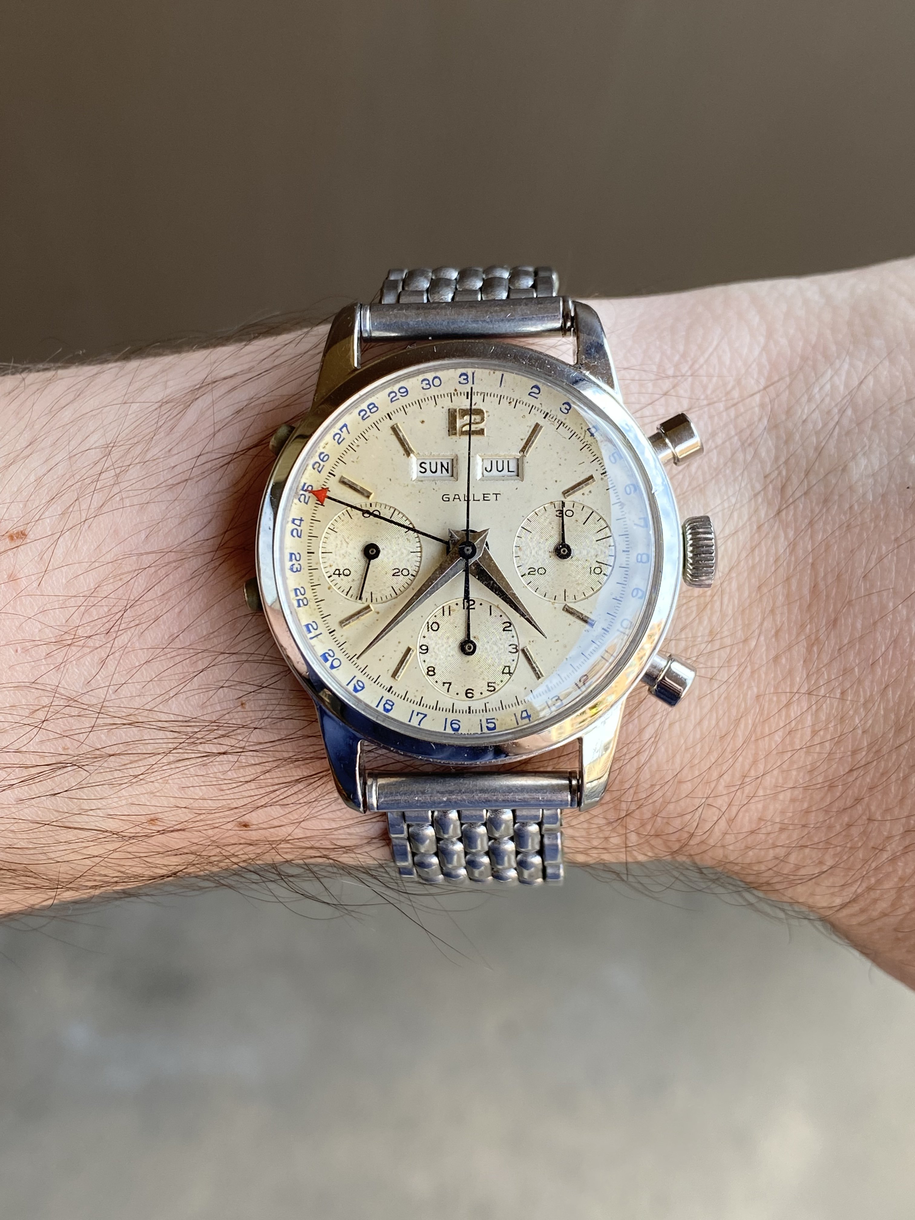

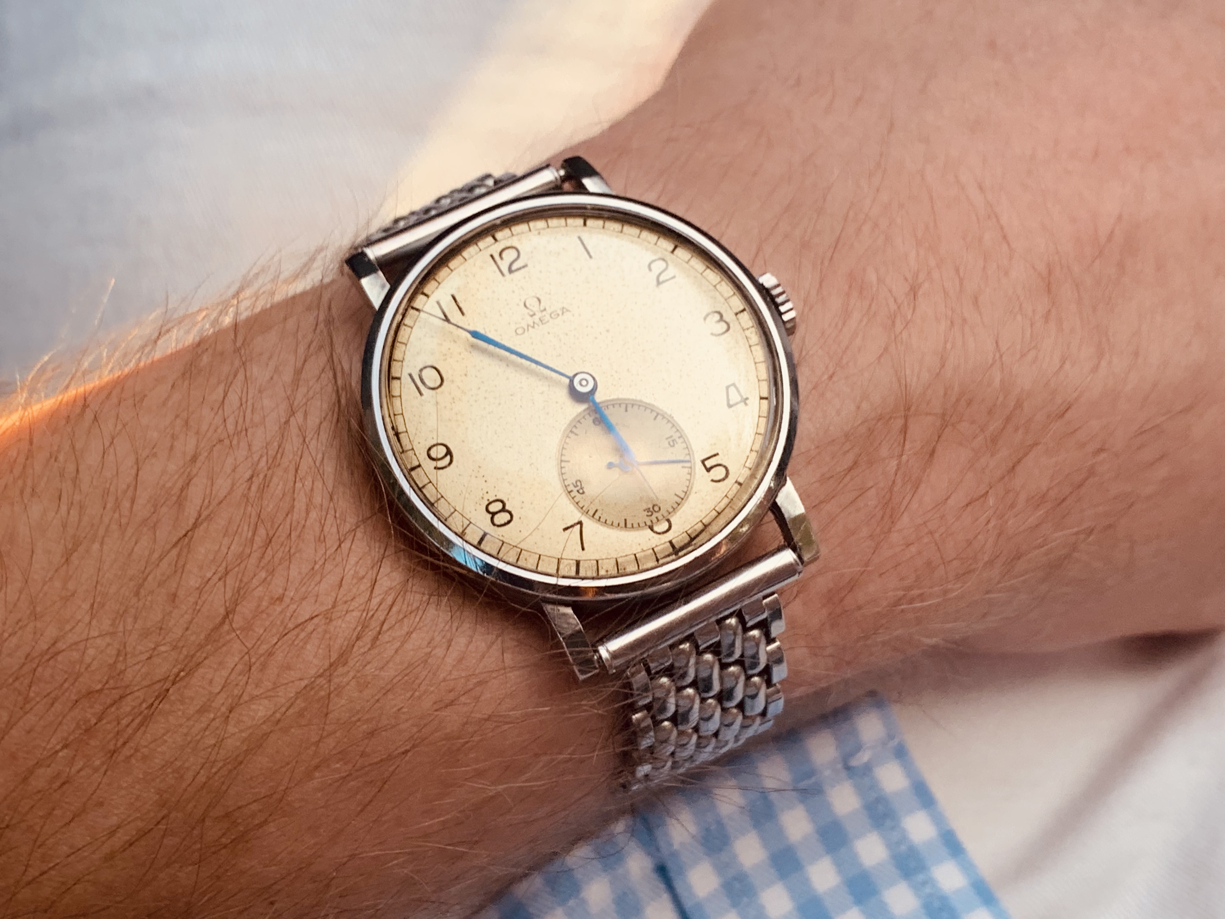

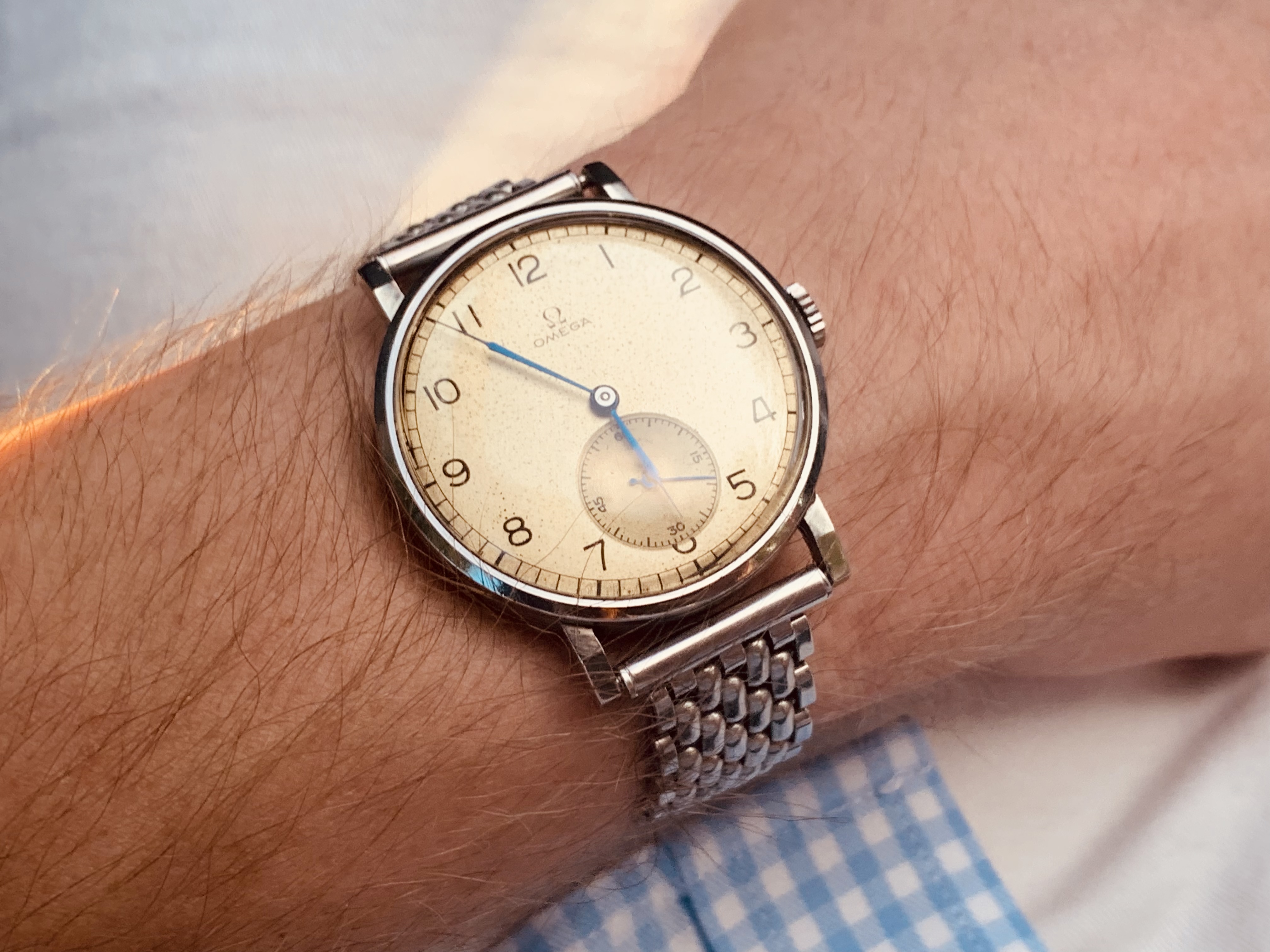

Well whilst reducing these bracelets is certainly not for the faint hearted. After 3/4 hours I got a result I am very happy with (maybe next time I’ll just pay a jeweller though)
If yours is sitting in a drawer not being worn becuase it’s too big you’re missing out! Shorten it

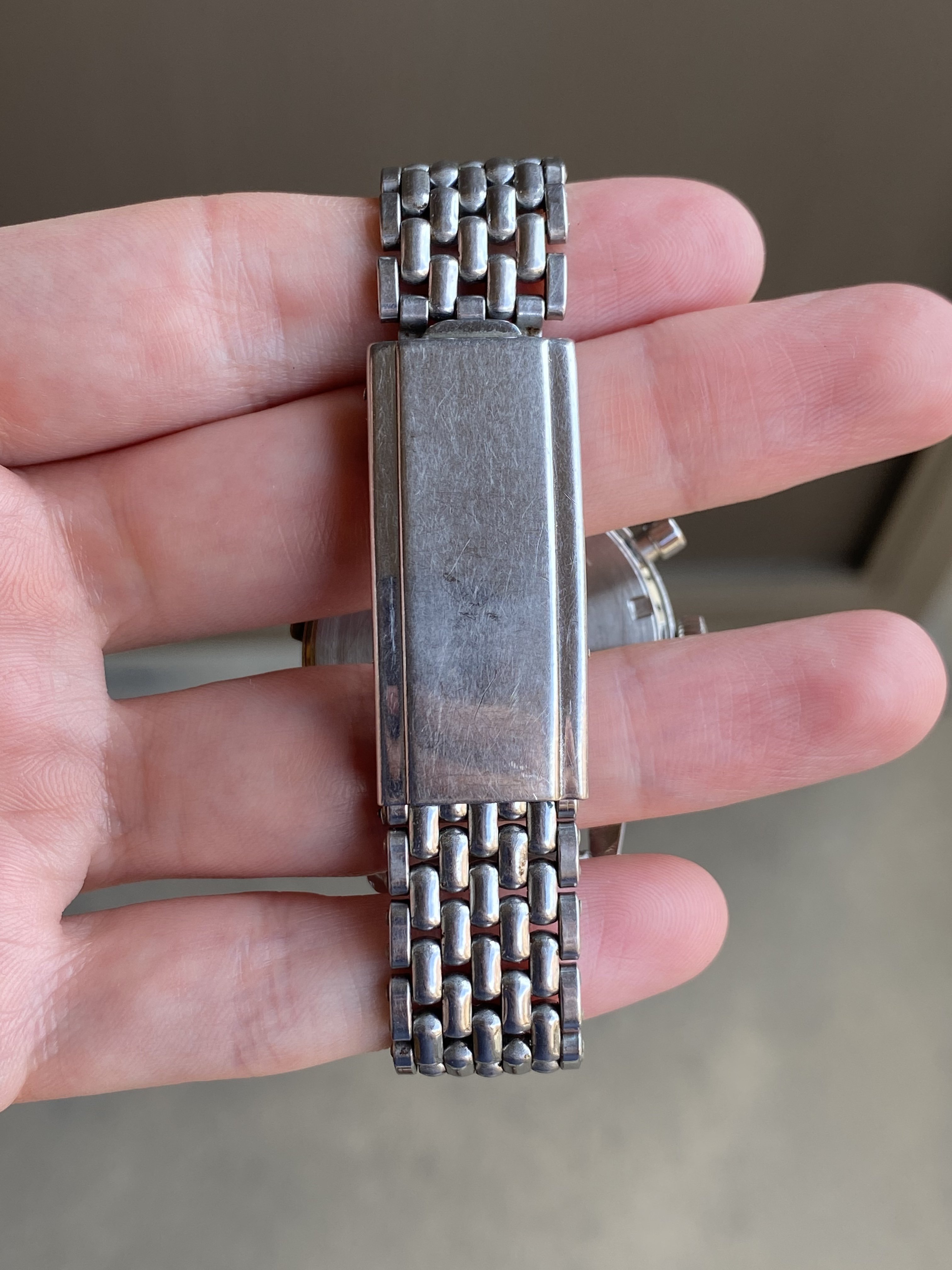

Omega has been using that on some of their bracelets for many years. 😀 Not a ratchet clasp though, maybe yours is?
1,453
3,023

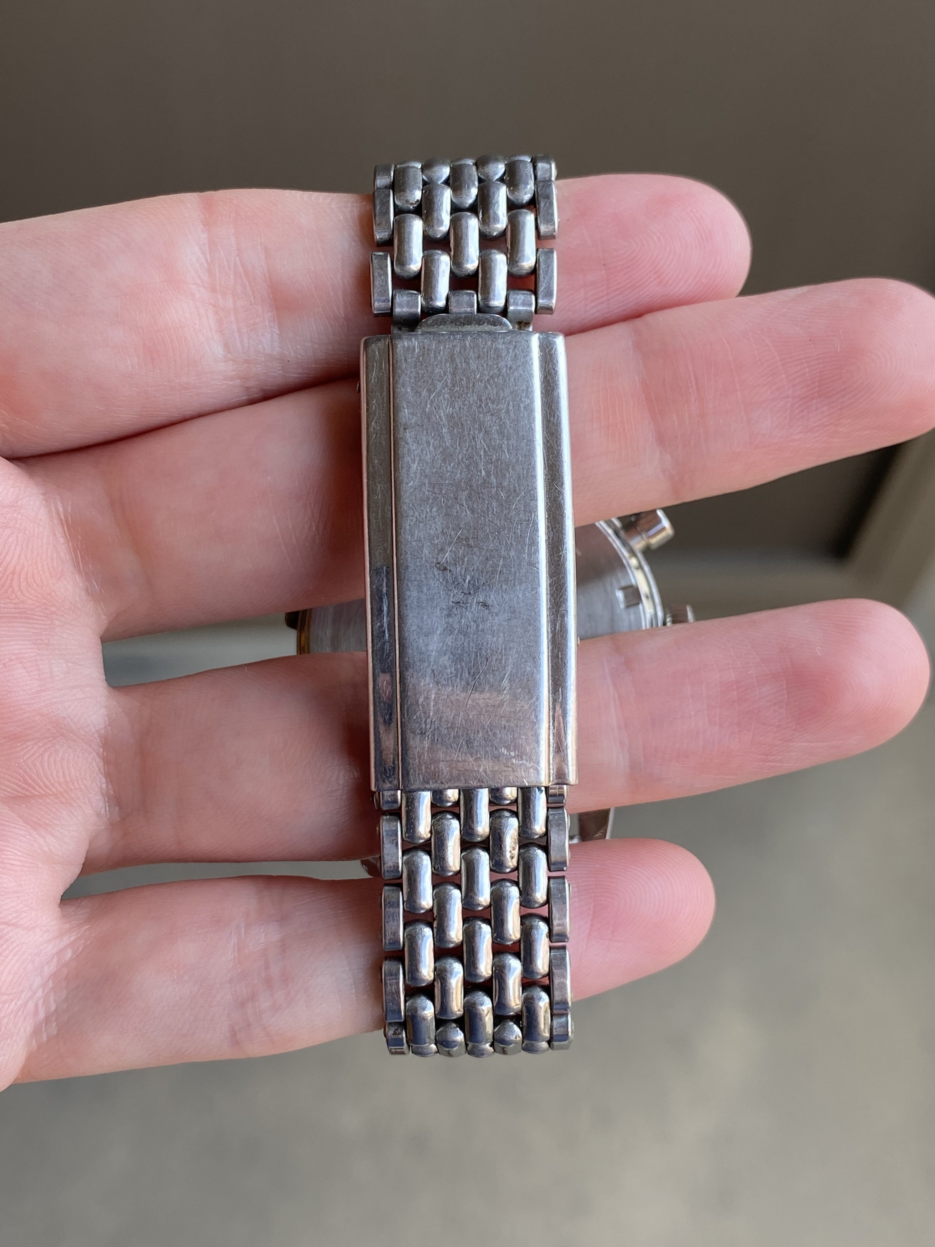

Yes I suppose that is exactly what I am referring to, as I slide it closed it clicks and locks in place until I feel comfortable.
