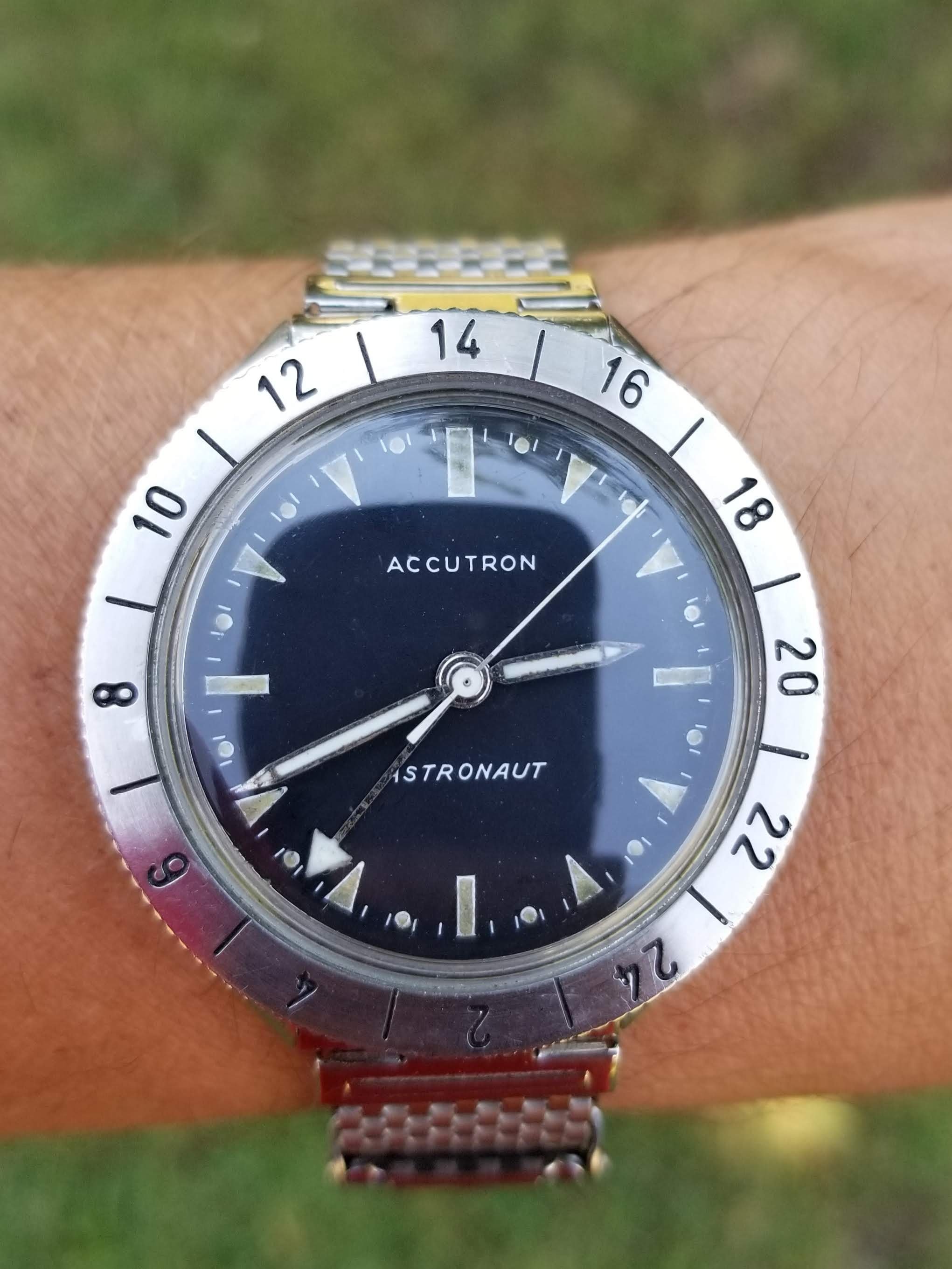

I had the hands done on my Astronaut. Yeah, there's a difference between the hands and the dial, but it's not nearly as noticeable in person.

For sure the narrower the handset the less noticeable especially on the Astronaut with pretty slim hands at about 38 mm dia. (unless it's pink or something silly), but when blown up like this it looks pretty obvious (no offence meant) I seem to remember the second hand on these also was lumed? maybe they changed on later versions??
